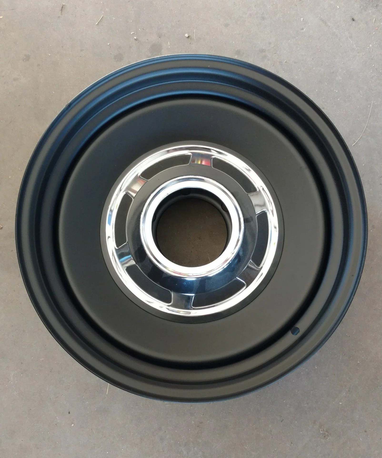

no just hoping you were on to something cool , i am leaning towards 17s . to fix my brake overheat . i found some 17 shells and may just make another set of factory look wheels .
You widened a set of 15"s, eh?
Let me know if you need a new home for them...
That a Wheel Vintiques??? Looks good.
US Wheel Bob.

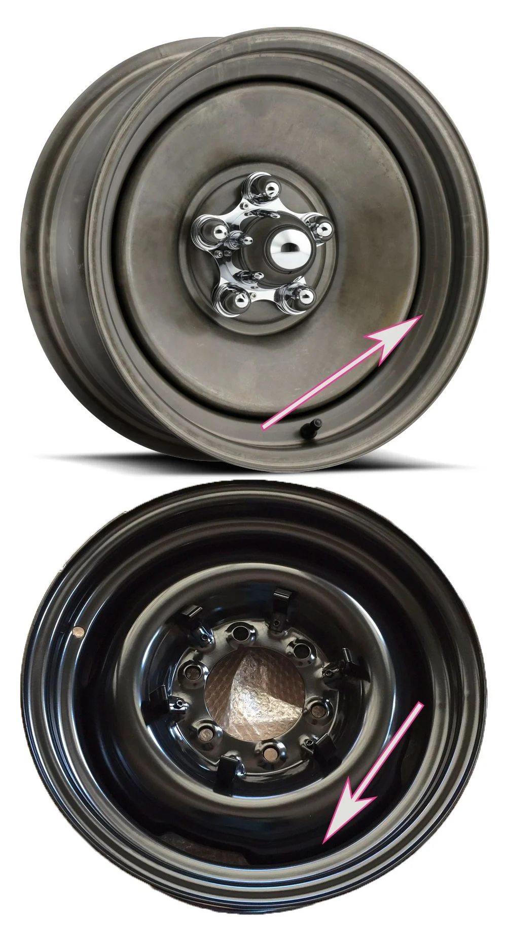

This might help you see the difference in wheel construction and why these wheels have a large air gap on the back side.
On the “factory” style wheels the center section rolls back and crowds around the caliper, on a 15” wheel this is a close fit to the point that it limits your caliper options and I would bet hold quite a bit of heat.
On the US wheels the center section goes straight out to the point where it attaches to the outer and this creates a bit more of an air gap not to mention the extra 1” for the 17” rims.
Hope this helps you visualize what I’m talking about TJ.

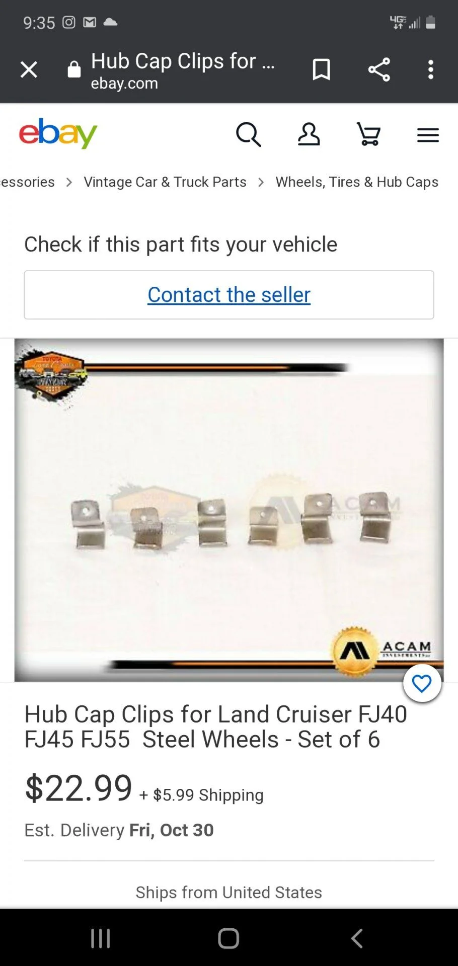

I did the vw junk also, no go. Try these out from ebay. I used them on my splits rims. I also cut a center section out of an old fj40 wheel t use as a template to drill the holes. I can mail that to ya if needed. I used something very similar to these.
Mike
Thank you @mmcinnis and @scrapdaddy but I'm leaning towards going back to plan "A" and just bolting them on. If you know anything about me you know I can turn a simple 10 minute job into a long drawn out redesign and I really only bought these wheels and tires to see if I'm going to like the look of 17" wheels and hubcaps.

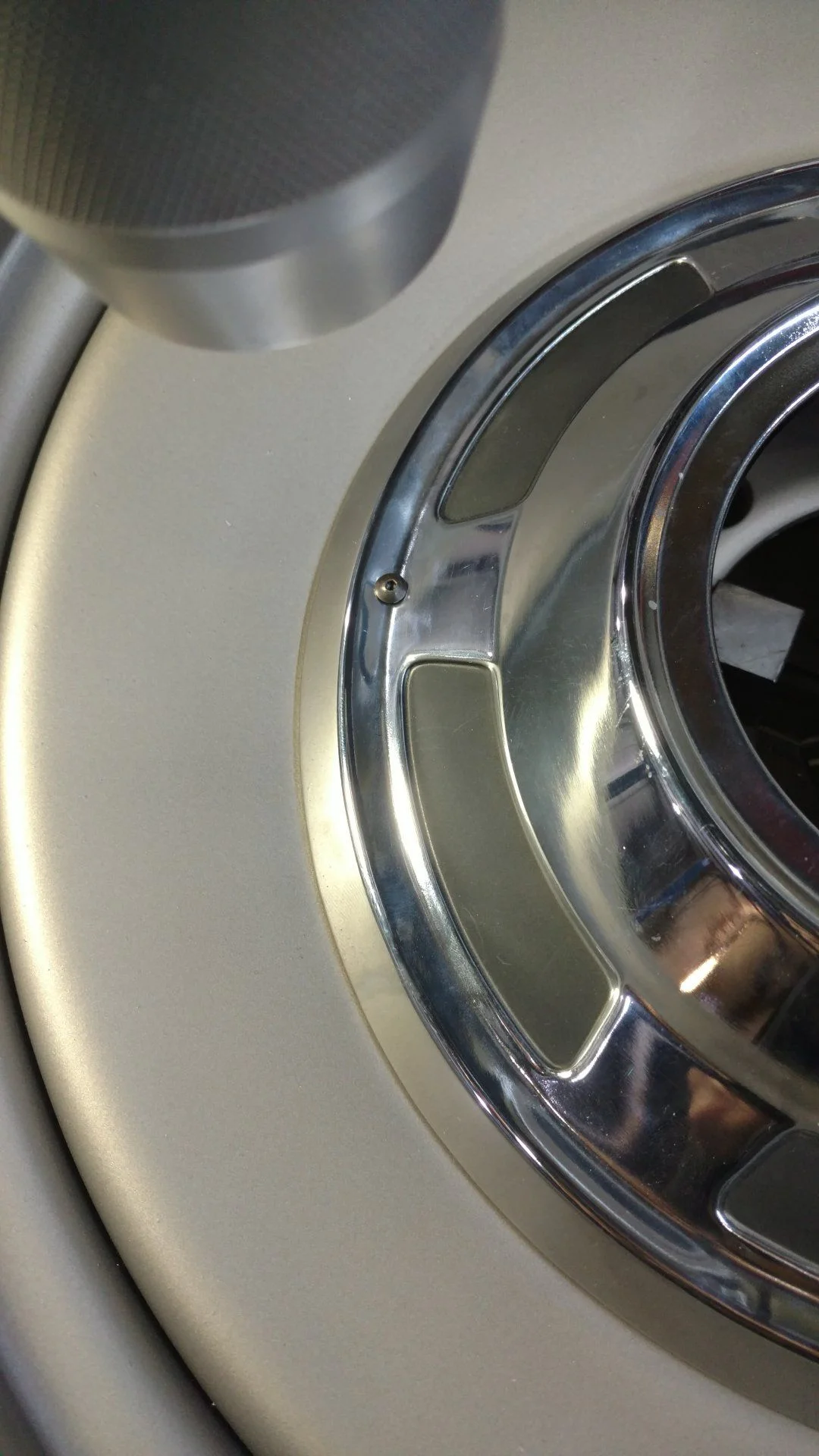

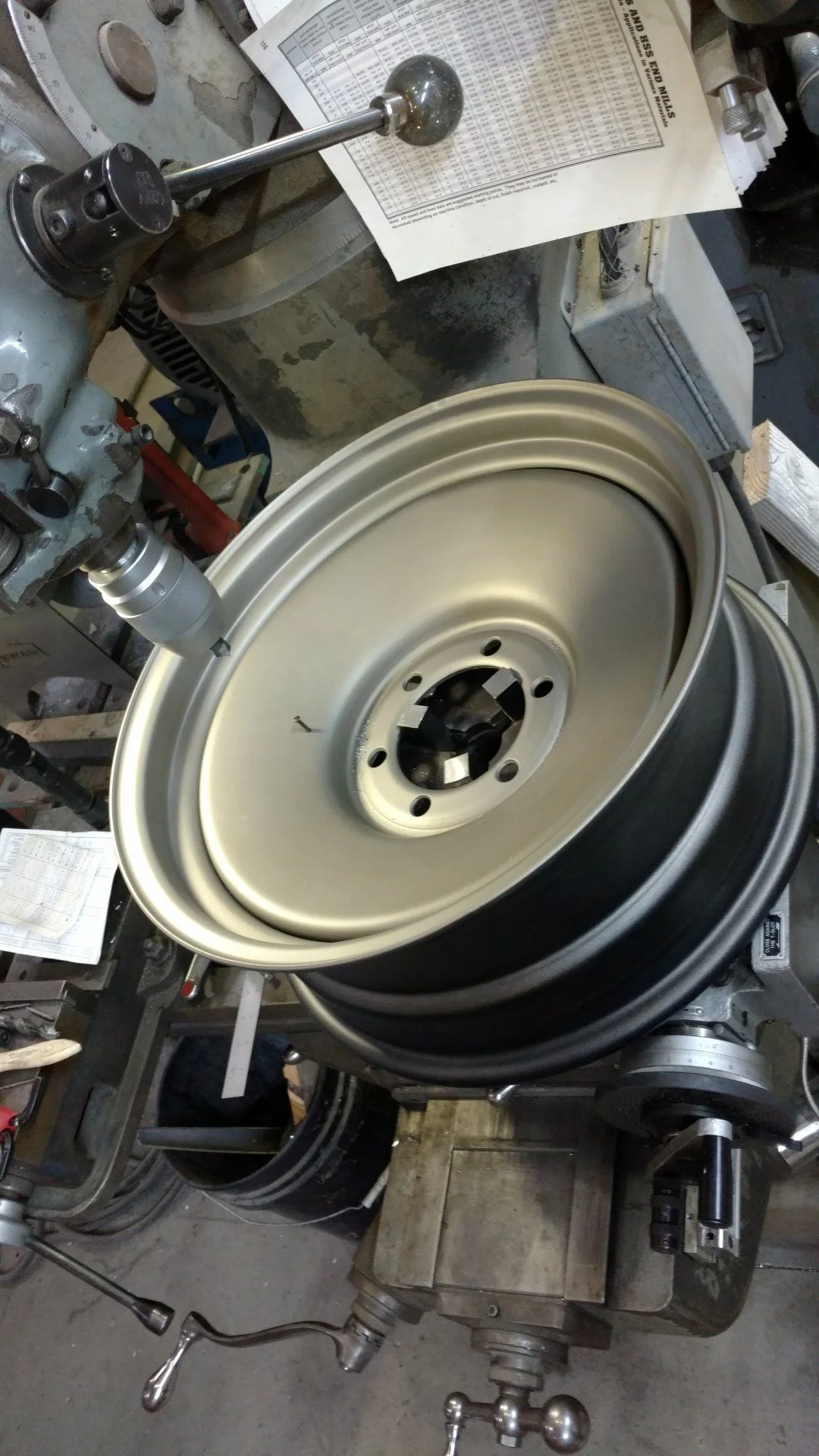

I converted a 3Jaw chuck I had laying around to fit on my rotary table so I could drill the hubcaps and wheels the same (3x9.25") in the hope that the caps will spin true'ish.
No flat spots on the cap but I think I can make this work.
I'll put three screws per cap and hope for the best
