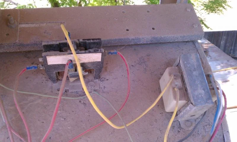

My mother has an old swamp cooler set up in her house. It has not worked for a while due to an electrical issue that she can't relate to me (the previous person that was helping here was not exactly the greatest).
I went up there yesterday to see what was up.
The Swamp cooler is controlled by a older mercury thermostat in her house. In the swamp itself, there is the motor, and I believe a relay/contactor and something else I am not positive of function. But it looks to cause the contactor to "turn on"
The contactor will start the electric motor if you hold the middle down, but it does make nice sparks when you do that, so I think it is dead. The other piece I cannot find online because I have no clue what to call it. The white and blue wires are also not hooked up to anything on the piece to the right. The setup seems to run by a 12 V circuit.
From what I have read already, this is not exactly a conventional setup. But it did work for a very long time very well.
Any ideas?

Hey Mace,
Check the voltage output from the 12v transformer. The transformer puts out 12v and closes the contactor providing 120v power to the swamp cooler motor.

Need to verify input/output power specifications for the transformer before you buy one.
Test it with a meter to make sure it is not working. Also, check connections on the contactor to make sure they're not corroded.
ya check for power to the transformer, to the contactor on the line side as well.
Then try and see if the thermostat and controls will put power to the relay (it should make a click sound when its energized).
By the amount of crap on it, I would guess it could be a corroded connection somewhere. So check those first, with a meter to see if there is power as there should be, then disconnect the power and check the terminals.
If you do find a part that is toast, they are pretty simple parts and should be easy enough to replace from an electrical wholesaler (so pull it out and take it with you, a knowledgable salesman should be able to find a replacement), though you may need to know the horsepower for the relay (before you make a trip)

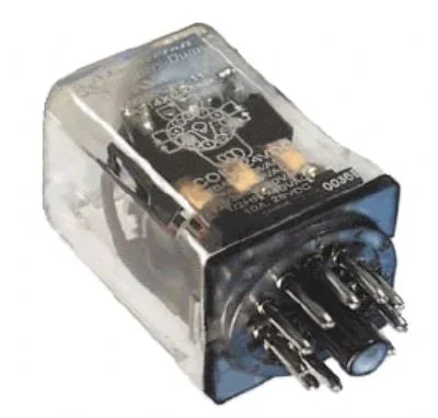

Looks like all that is mounted on the squirrel cage, not the best environment for contact points. If it were me I would relocate both the transformer and contactor in an outdoor box outside of the cooler. Ice cube relays are also an easy to replace option over the contactor. The base is screwed in place, all you need to replace is the 'cube' when the contacts fail.:)

Picked up a new transformer and contactor. Got the installed without letting any smoke out. Tried the thermostat, everything clicked, and hummed. I gave the motor a push start and it started spinning away.
Looks like the starter on the motor is not working properly. No big deal..
So I pulled the cover off of the wiring section of the motor and found this..
lol
Someone else let the smoke out a while ago. One of the main power leads to the motor was arcing out on the case of the motor..
Looks like a new motor is going in lol
