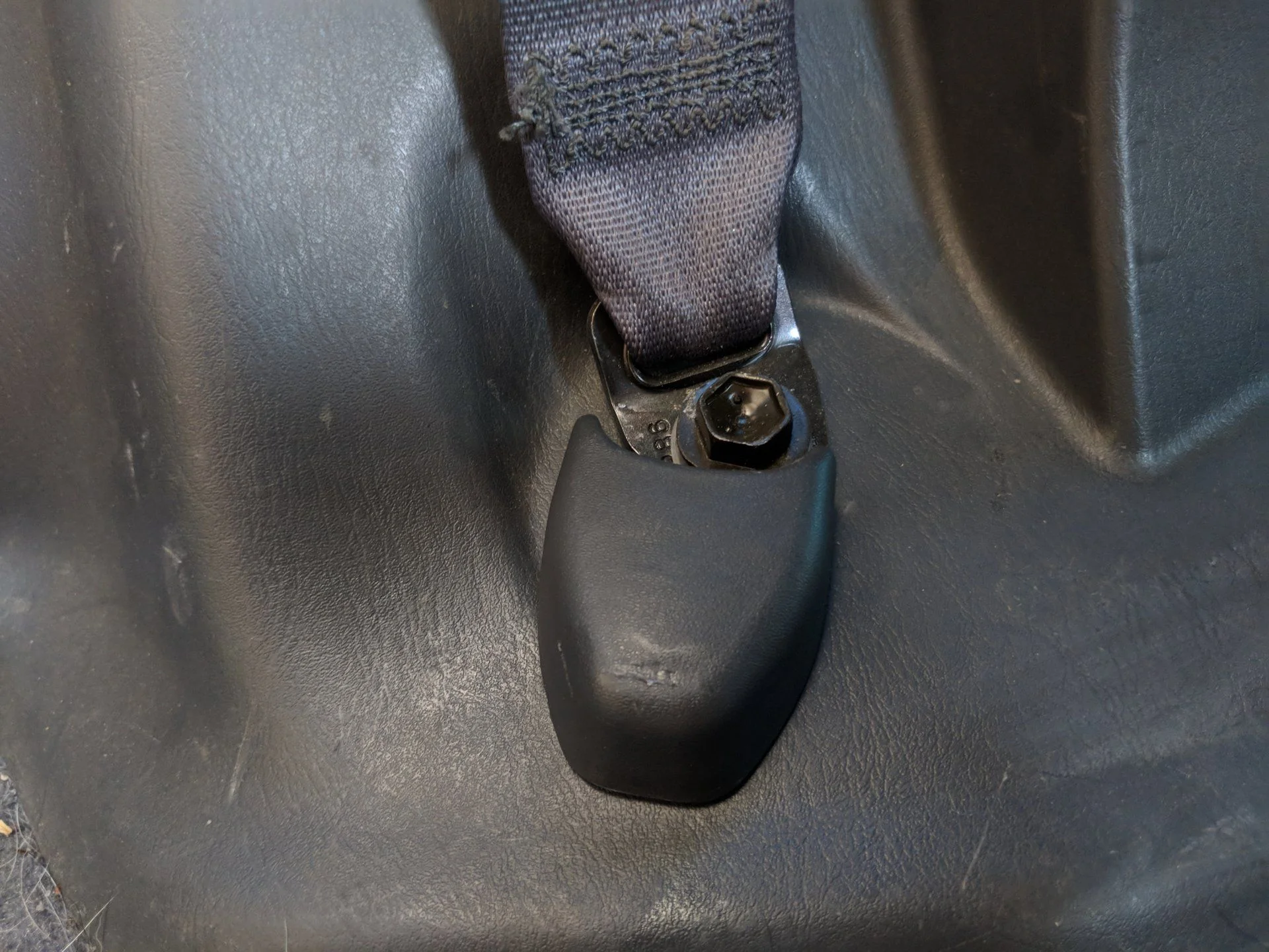

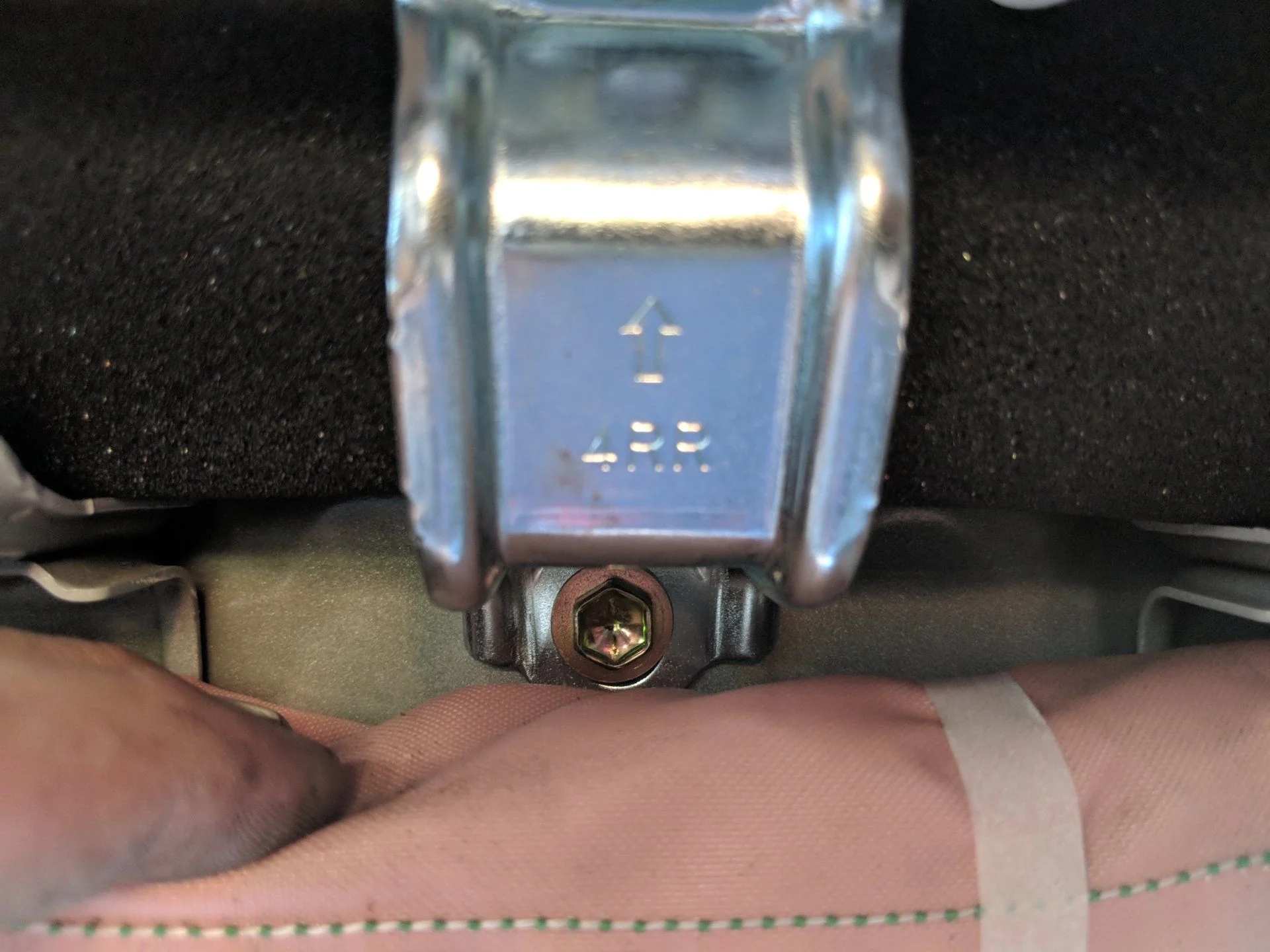

6x seatbelt covers and bolts (label them, they're not all the same)

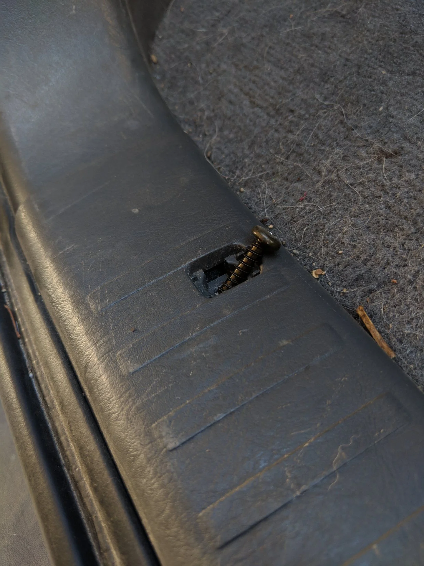

Rear quarter panel has some screws under the carpet

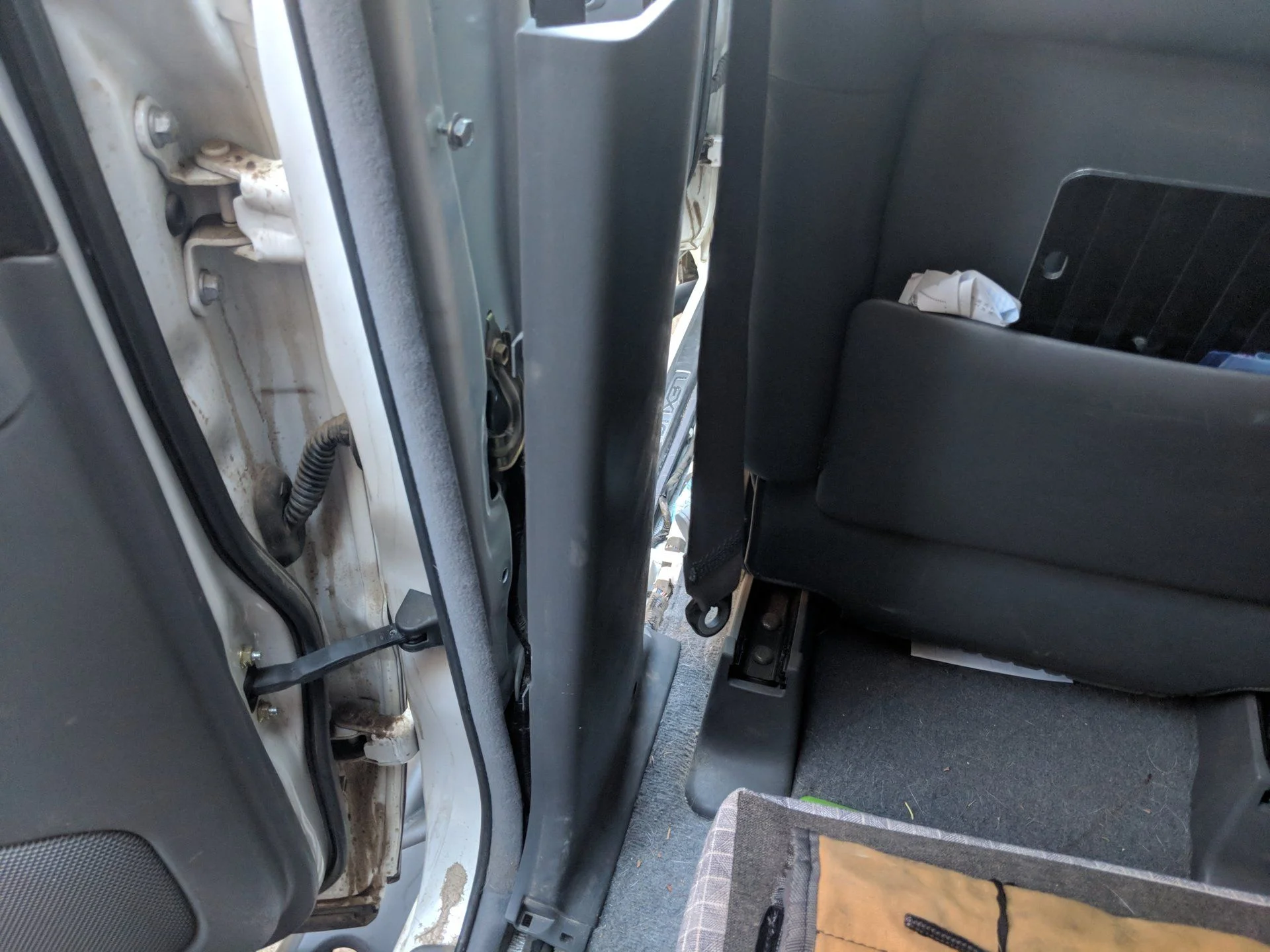

B pillar

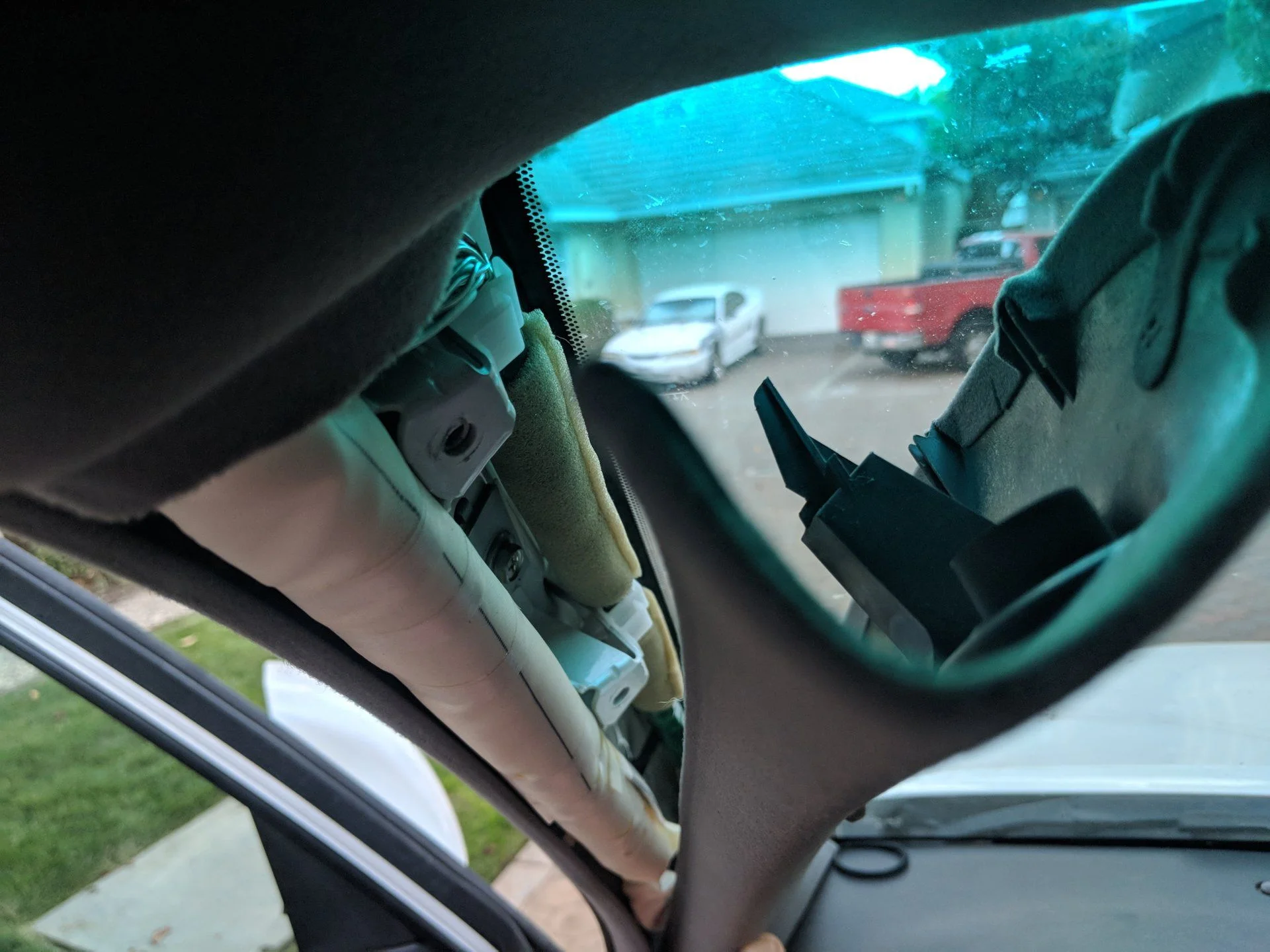

A pillar

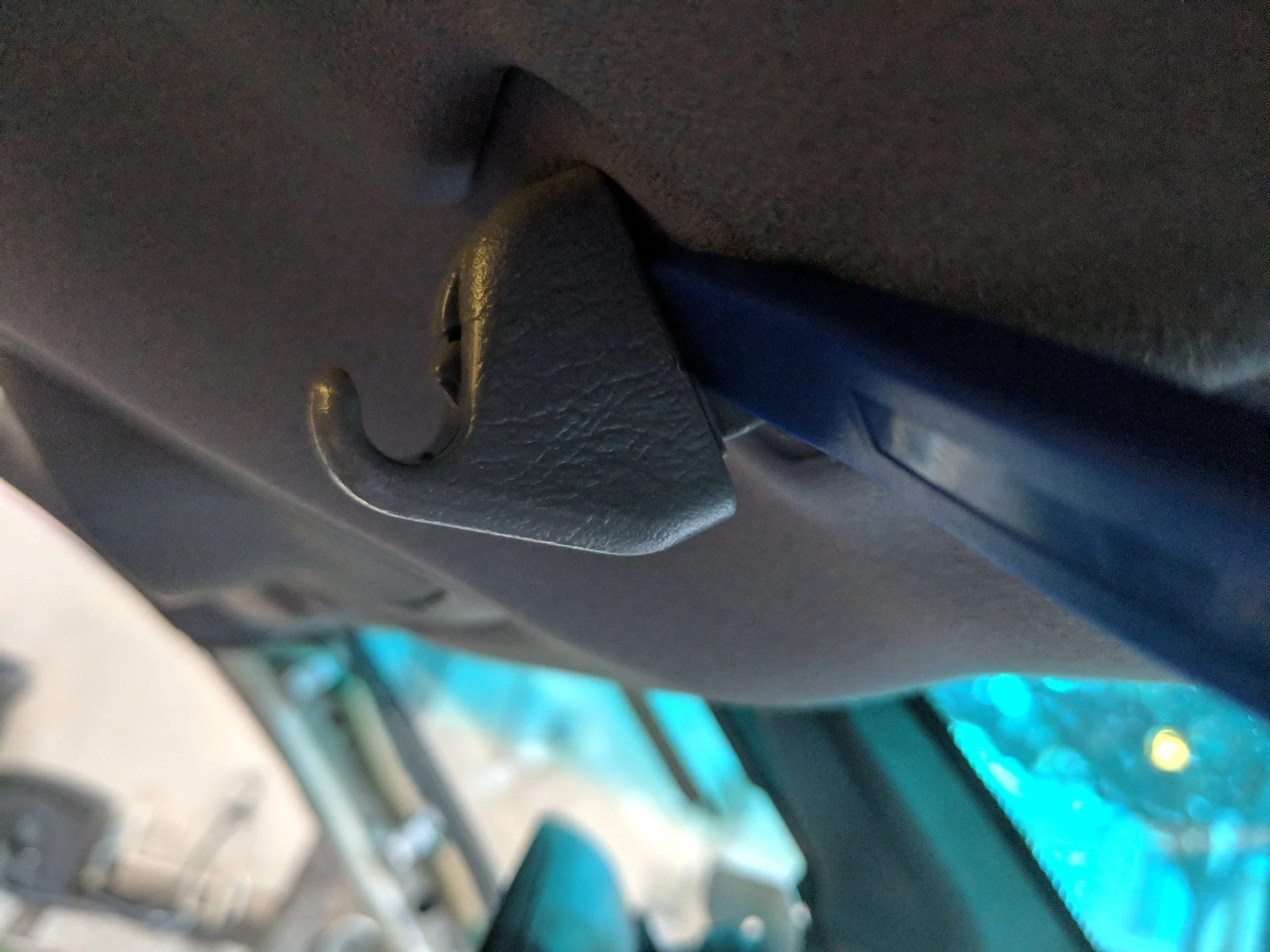

Visor screws

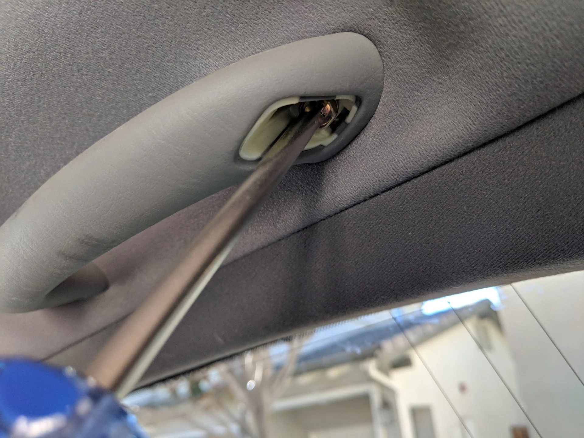

8x oh-s*** bars

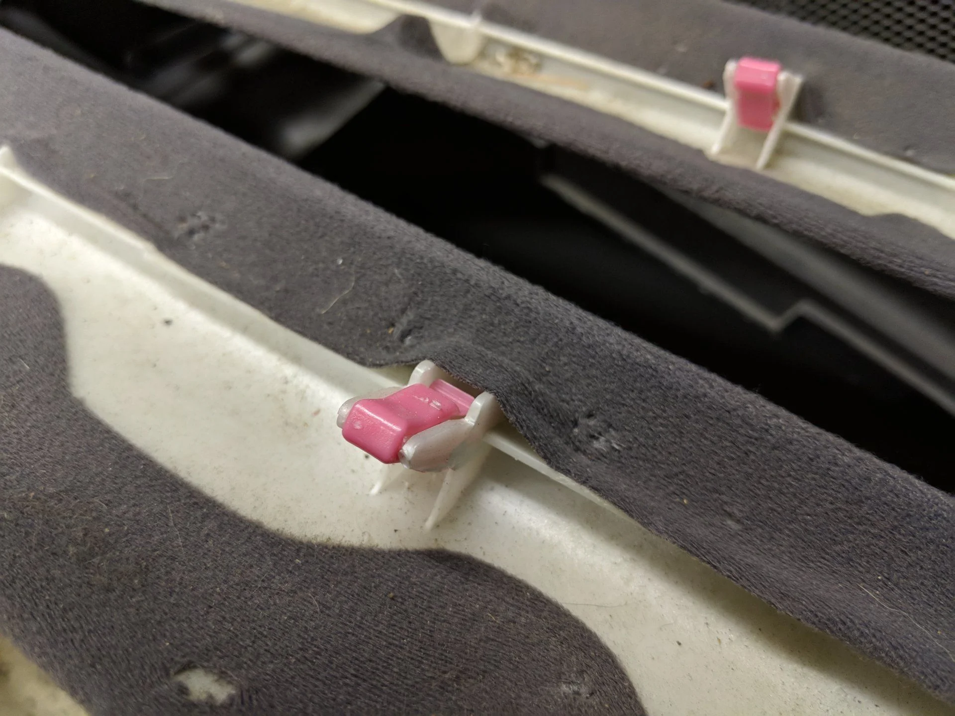

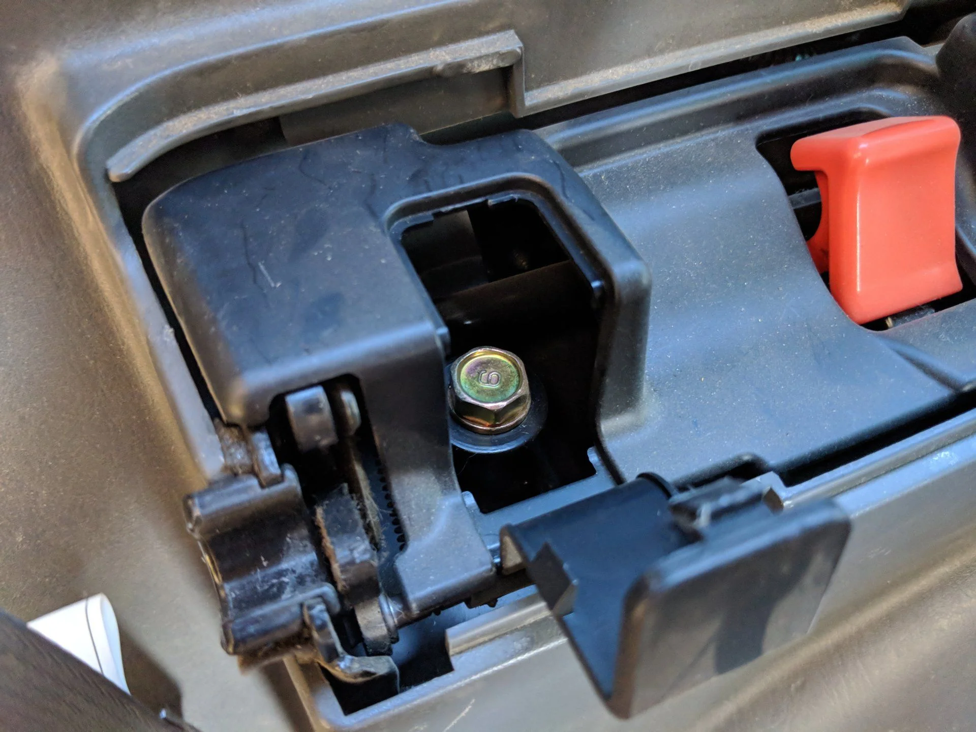

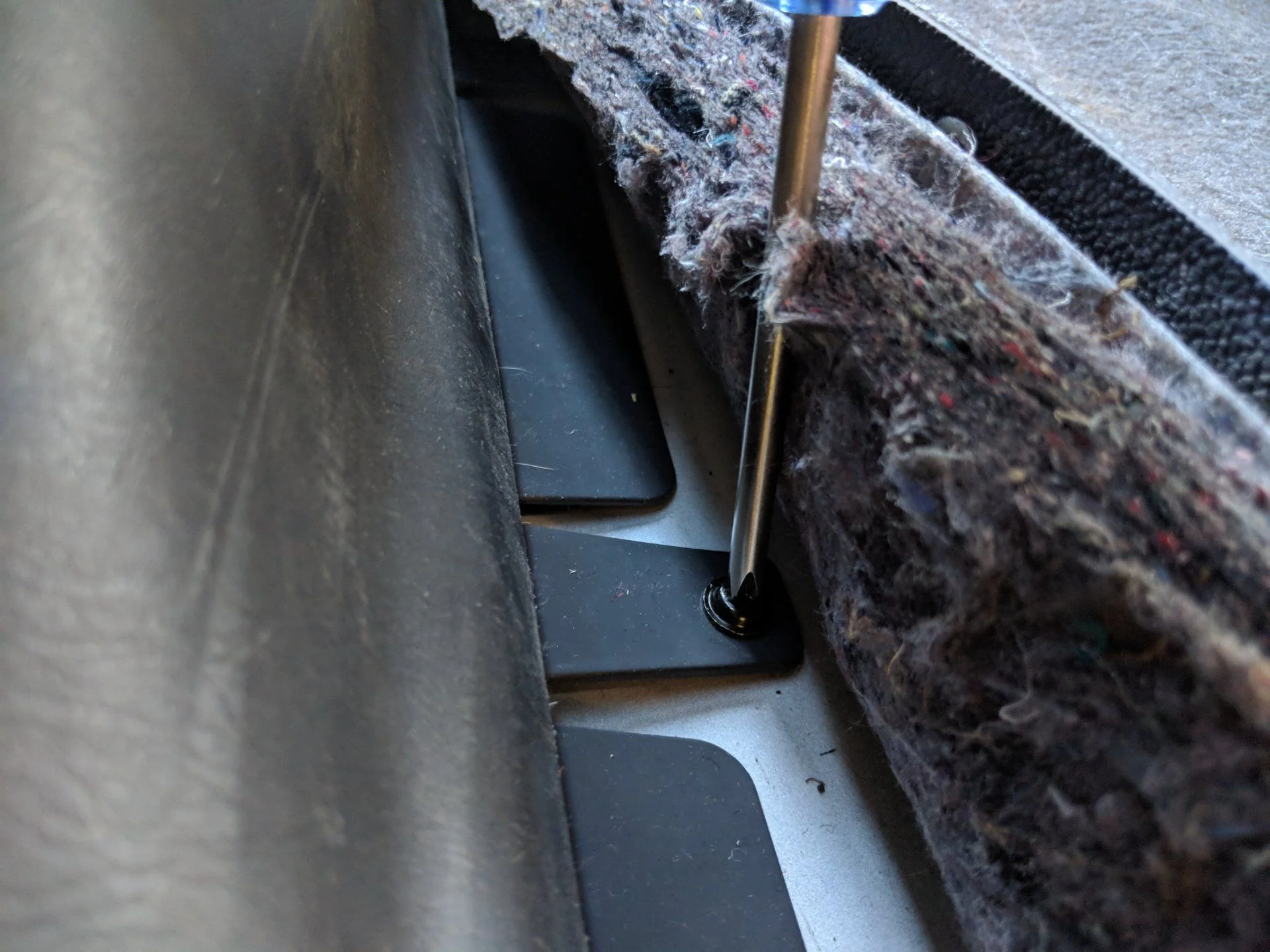

The rear upper quarter panels have these two clips along the roof rail that were super annoying to remove. I resorted to jamming my hand behind the panel with a screwdriver and prying the red section off the white clip. Not sure that's how Toyota would do it, but it's all I could think of. Hardest part of the removal for me by far.

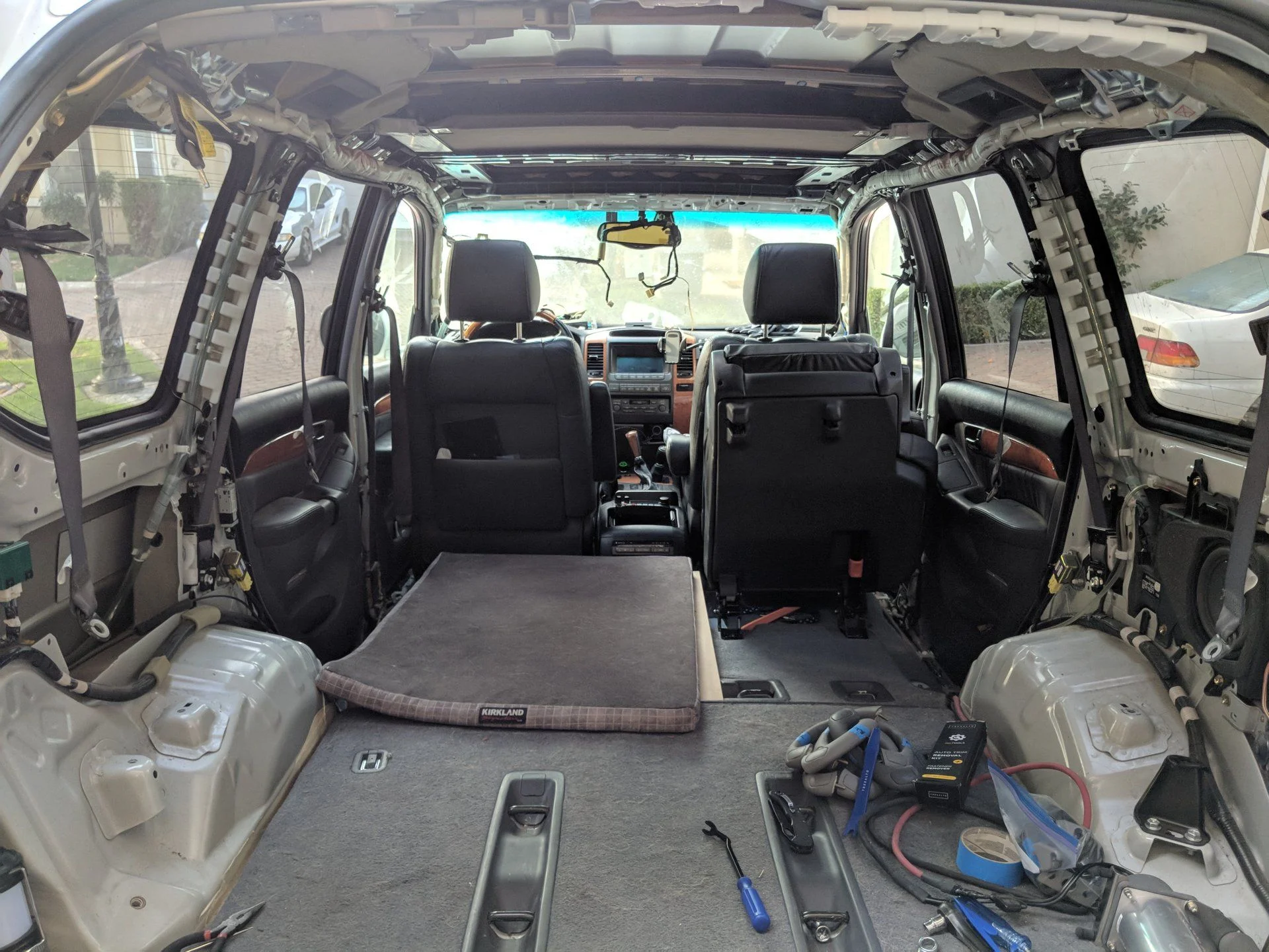

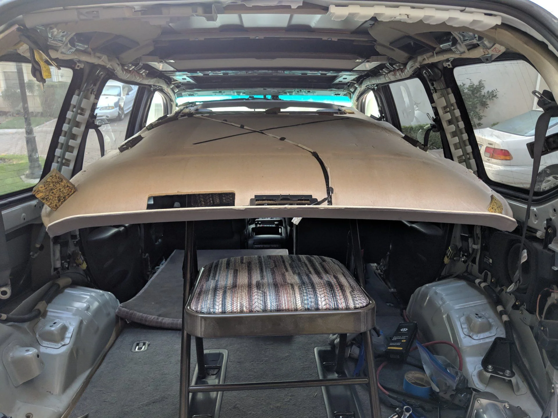

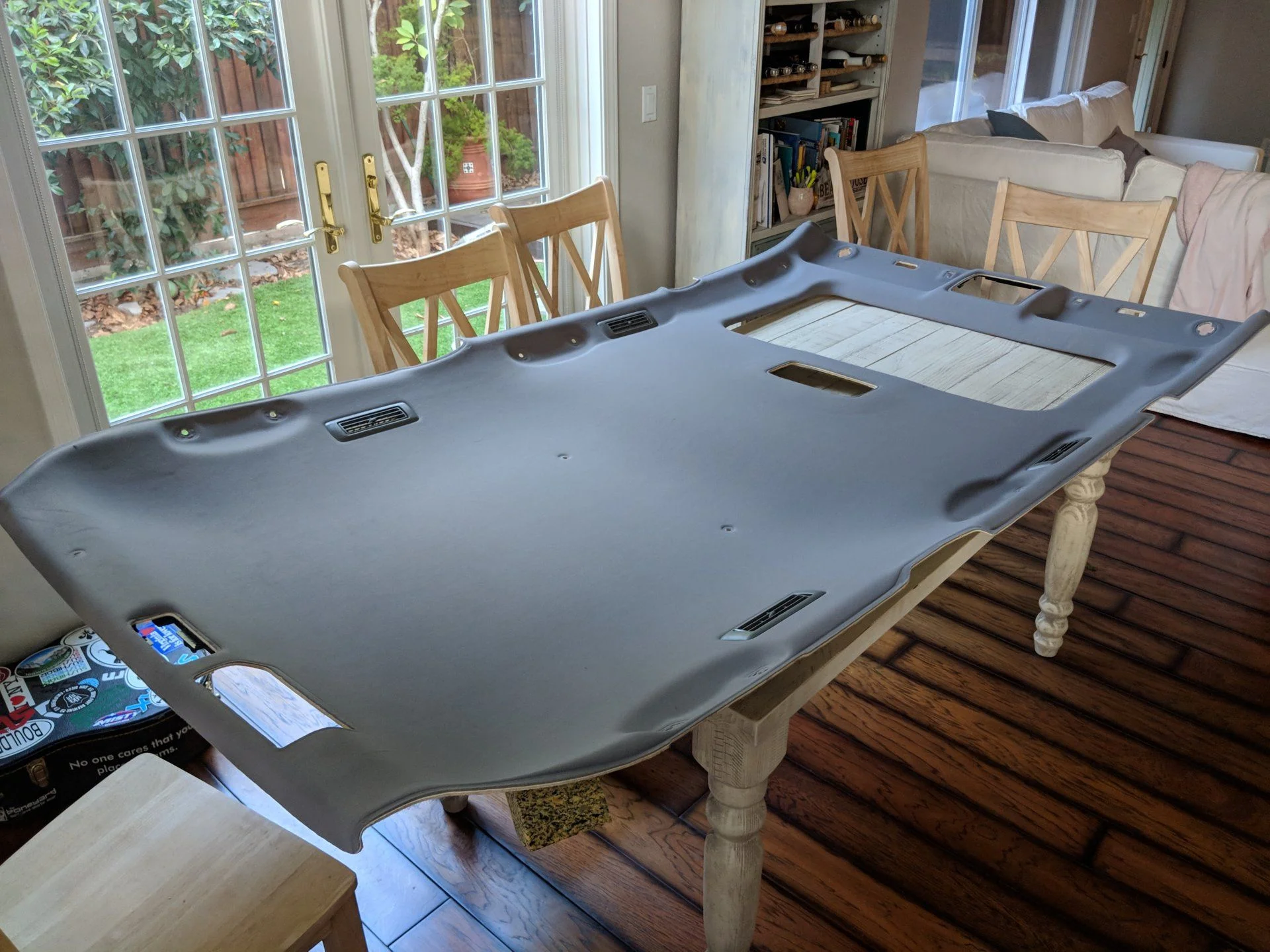

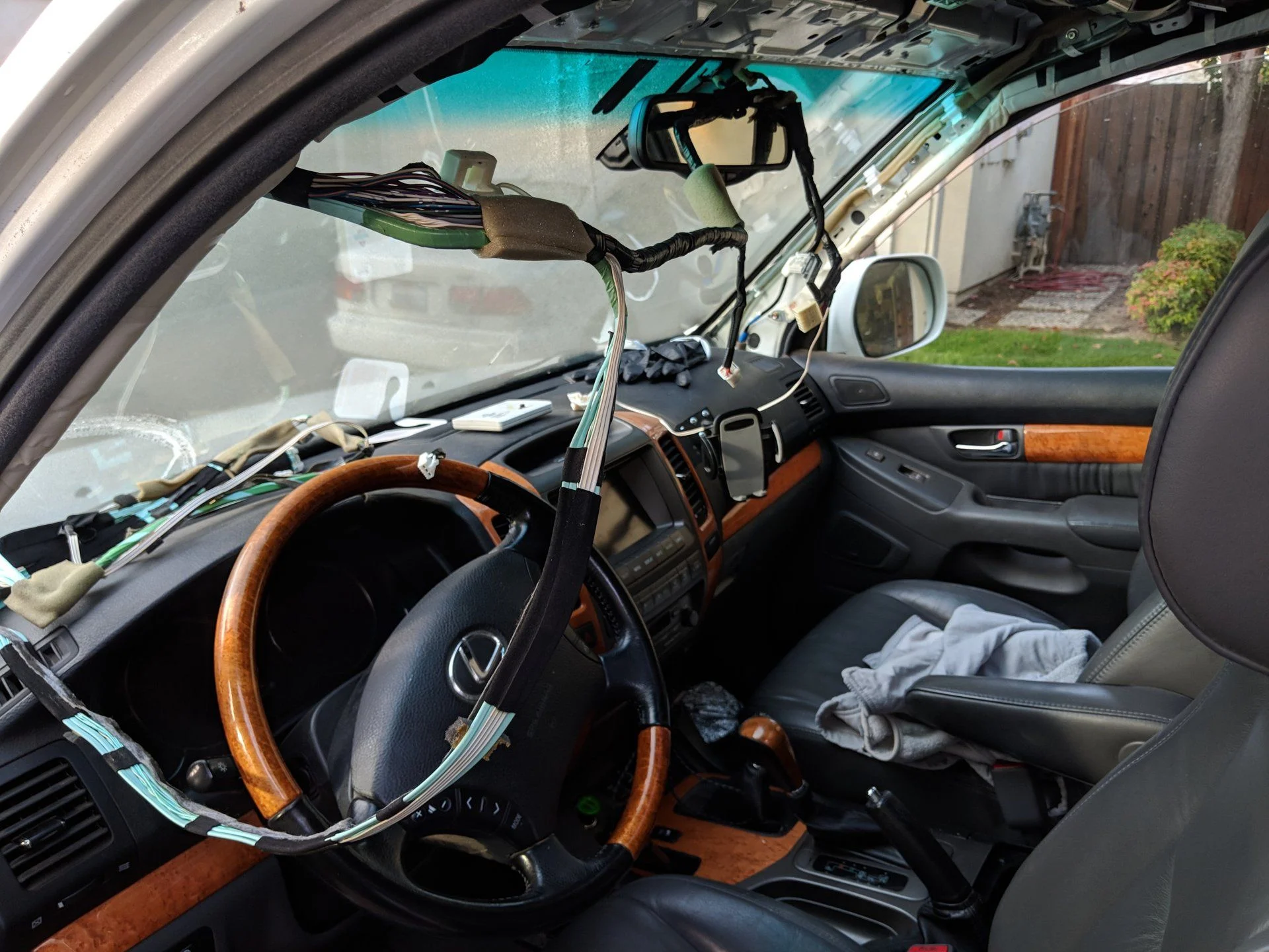

After there's no interior of your GX left, you can drop the headliner! I had a friend help in exchange for a few beers and some grilled chicken
And then you have to pull the wiring harness off so you can remove it
Empty!

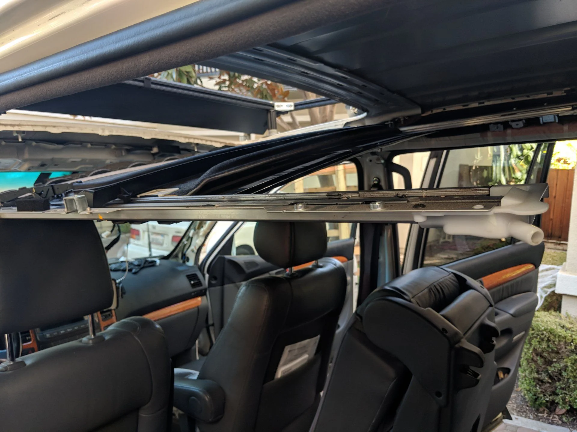

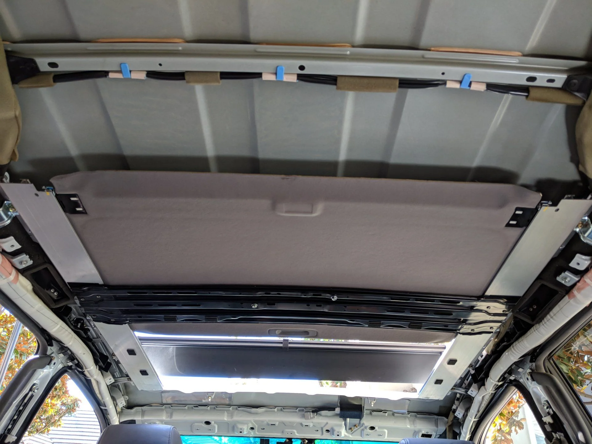

Remove the 10 or so bolts and nuts holding the sunroof tray in

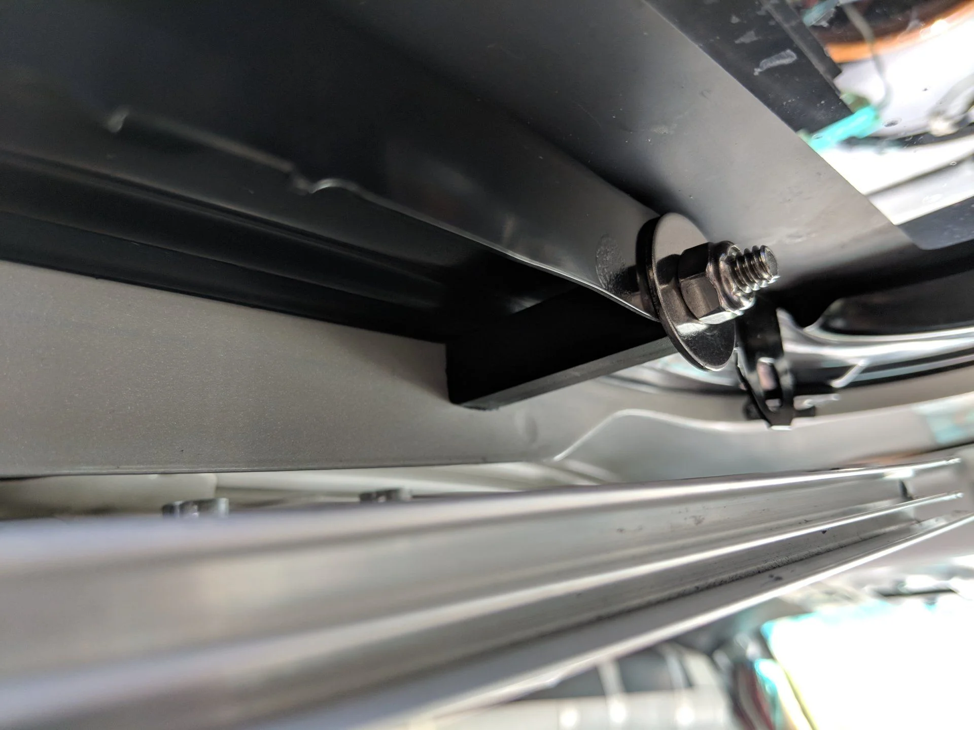

There are 4 brackets (2 front, 2 rear) that support it from the bottom. Loosen the bolts that hold these to the body to move them out of the way.
There are also several welded roof bolts that hold the sunroof up. This in combination with the brackets makes it almost impossible to drop on your head as you loosen it, but it also makes it tricky to drop out unless you completely remove the 4 brackets.
No more sunroof! Just a big hole

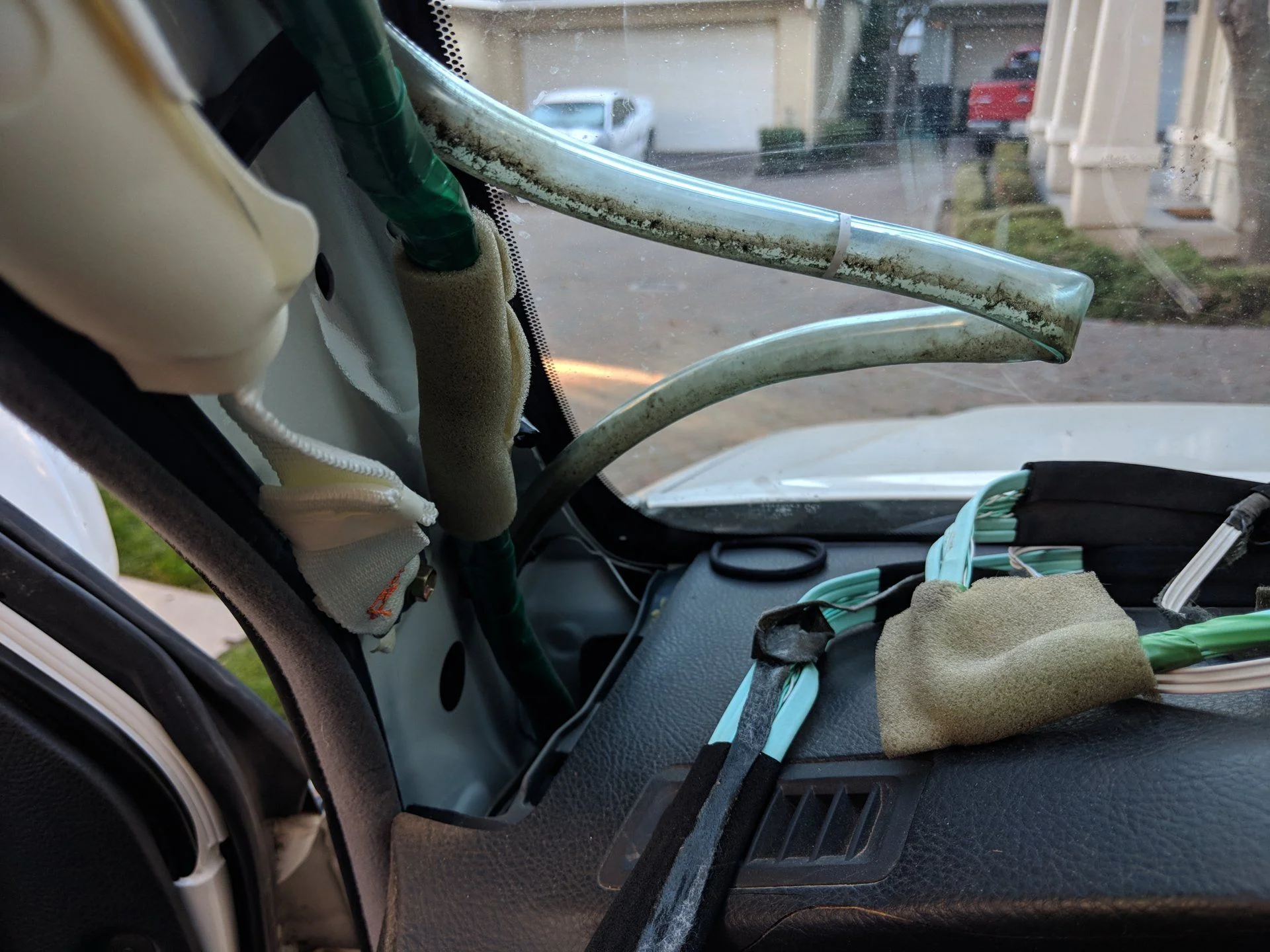

Also time to get that nasty drain tubing out (x4)

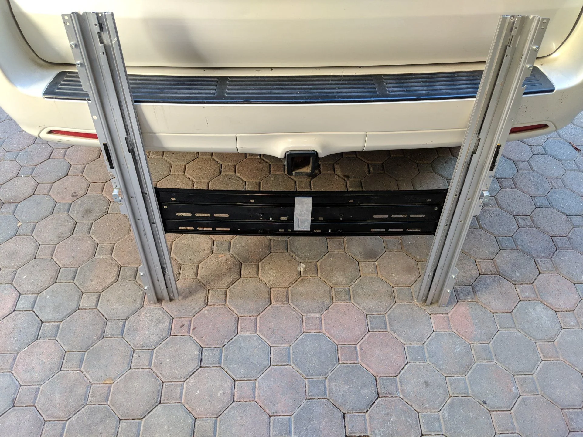

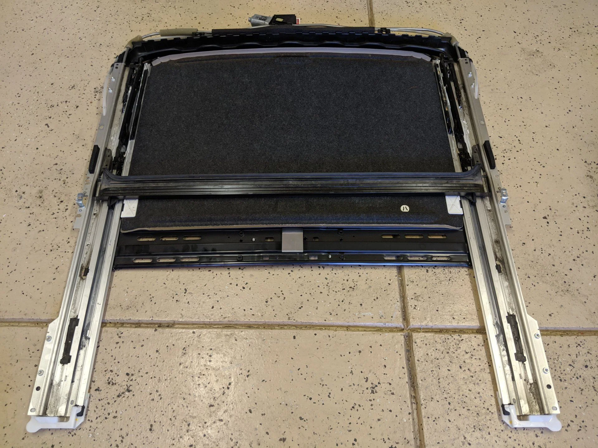

The guilty, i.e. rattling, culprit
Now stripped of the motor and all moving parts (like-new sunroof motor for sale!)
But for us fair-skinned or heat-adverse drivers, you might want the sliding shade back!
Bolted back up on the roof feeling a little simpler and lighter

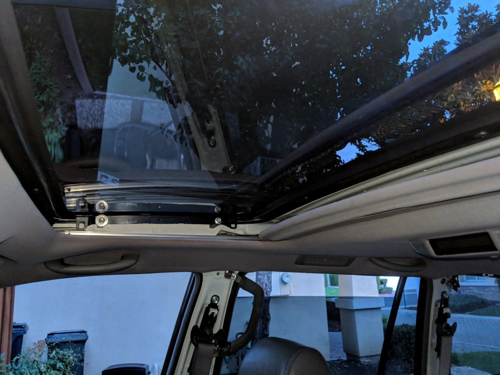

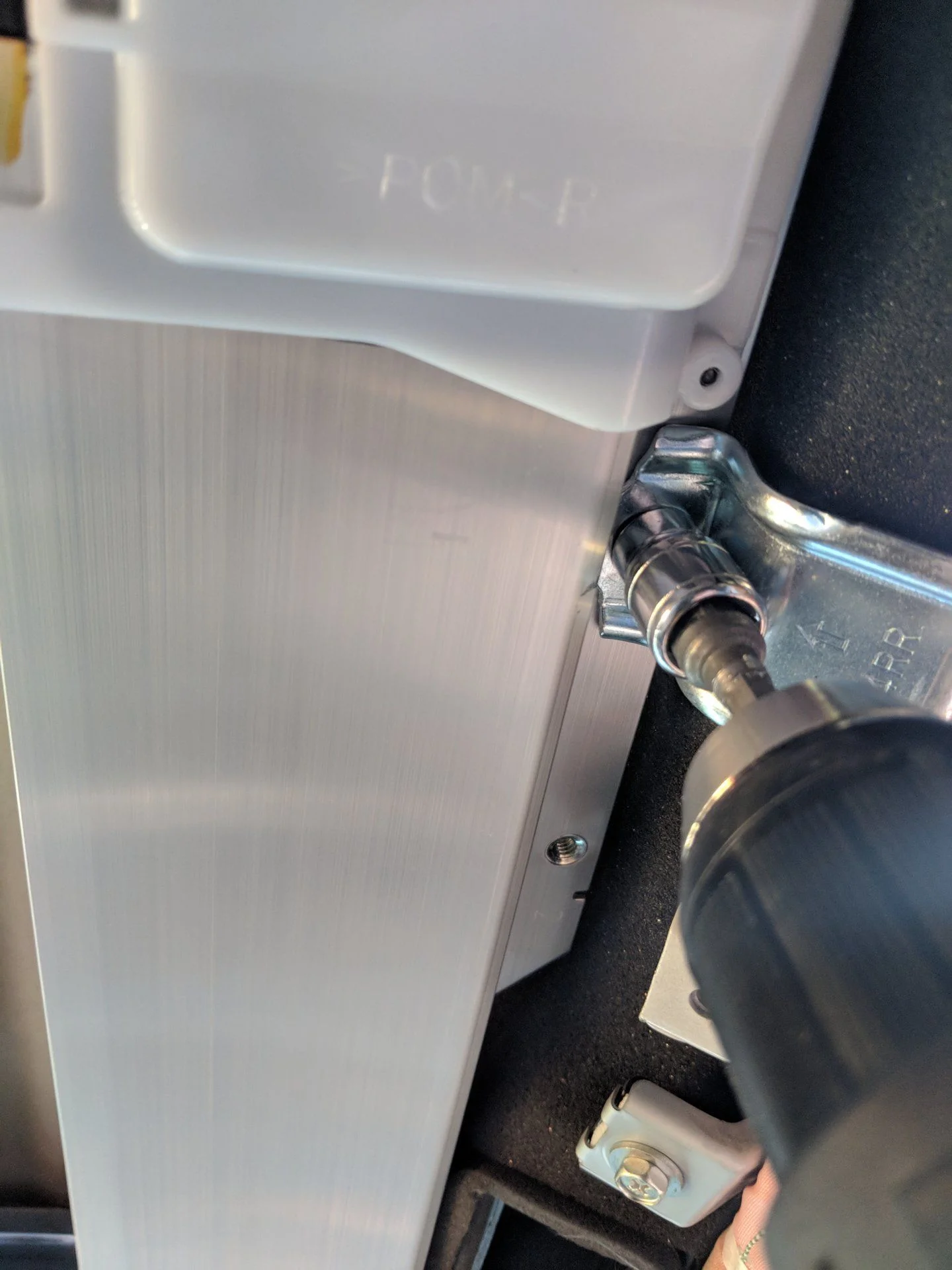

Now for the genius part (obviously not my genius, I stole this idea straight from the T4R guy). The sunroof glass has a metal bracket with two pieces that run front to back on the side. The roof of the GX is folded in on the sides of the sunroof hole to form two nice, parallel sections of sheet metal that act as the mounting points. Using the 4 inner rectangular holes (not the ones you f***ed with to try and adjust the height), you can bolt the sunroof glass directly to the roof:
Hold the glass in its native position, mark the location of your drill holes and make some sort of spacer. I had some tiny square steel tubing laying around to cut into 2" (rear) and 1-5/8" (front) spacers.
Once the glass was bolted up I put the original track back in. To me it serves two important purposes: It holds the sliding shade and bolts for the center overhead light. The T4R guys just put a non-sunroof headliner in but we don't have that option, so might as well have a skylight! Of course if you don't want your skylight to leak, you either need to keep the whole drain setup or just seal the sunroof glass. I opted for sealing because I wanted simplicity, less parts, etc.
