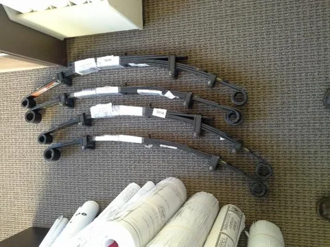

Anyway, springs were delivered to the office yesterday and were waiting for me when I got in this morning, so I think all the pieces are there, now just need to get my happy butt in gear.
I think they're just going to paint them purple and call it good! :lol:
For you Steve :flipoff2:
SPRINGS!!!!!!!!!!:bounce:

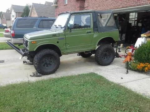

Rear springs are on. Got right at 2" on the "good" side. Gotta finish brakes and get driveshaft in and should be ready to turn it around and start on the front.
I had lots of fun.:rolleyes: Will post a better update later.
Gonna need some bigger tires.

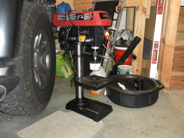

Here is on of several new toys. I read on Amazon that this was the best bang for the buck and Lowes had one on the shelf.
Skil Drill Press.
http://s84.photobucket.com/user/mrtucker80/media/SAM_1369_zps5a935dc0.jpg.html

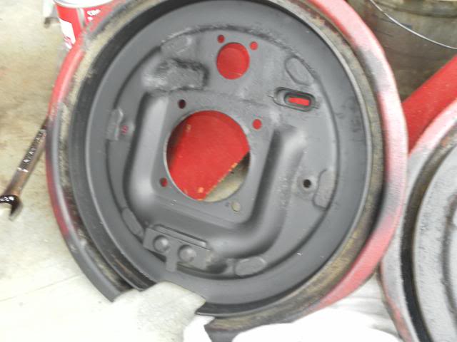

Which when coupled with a 3" hole saw got me these
http://s84.photobucket.com/user/mrtucker80/media/SAM_1366_zpsb098e467.jpg.html
Learn from my experience and measure before you buy a new tool. You will notice the notch that I cut in the backing plates to let me actually get it onto the press to cut out the center. The bench-top press was not deep enough to get all the way to the center of the plates without the relief cut....

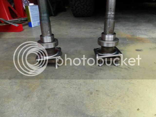

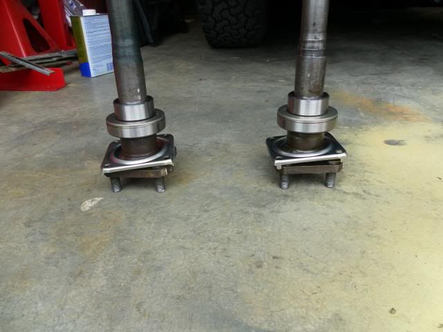

Pressed on new bearings and backing plate mod
http://s84.photobucket.com/user/mrtucker80/media/SAM_1365_zpsf5213a9f.jpg.html
Then with a little FIPG and it was ready for tires.
