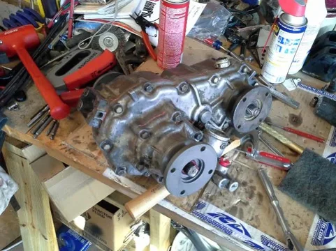

Today's family event is brought to you by Clutchee. Tore down the new 4.16 today to install the Twisted T shift rails. Went petty well taking it apart and then removing the pins from the forks. Got the long one done and then onto the short one. Found that the 2x4 shift fork opening was longer on the new one so we did some asking around and decided to mod the fork to fit the opening. Got that installed and found that when we rotated the input shaft reverse it was hanging. Realized the shaft shim may not have had the notch placed in the housing precisely. Took it back apart and seated it correctly and back together it went. Seems good. We will have to wait and see if the mod to the fork makes a difference when trying to shift. For now gonna wheel it like that. There's a whole thing with the small and large flange sizes and decided to swap the rear flag out to large and leave all the rest small. No benefit from one size to another. I came in to do mom/wife things and he's working in the driveshafts now.
Little better picture of it back together. More later.

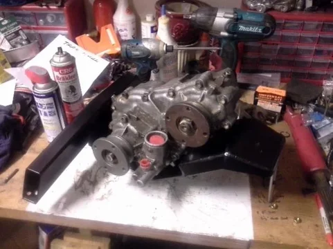

I couldn't wait, so I went ahead and loose bolted the case into the new cradle. Pretty beefy looking little dude.
