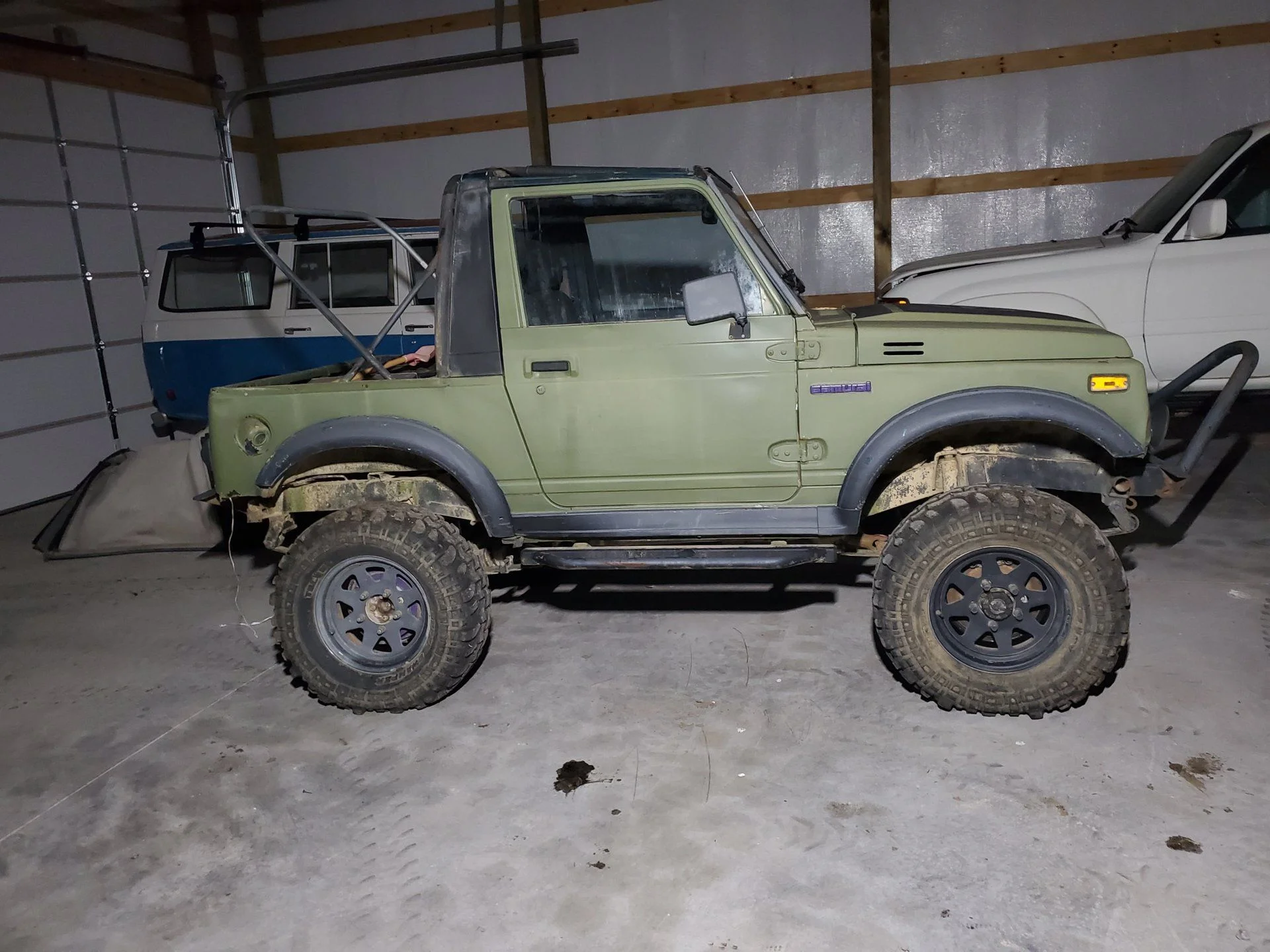

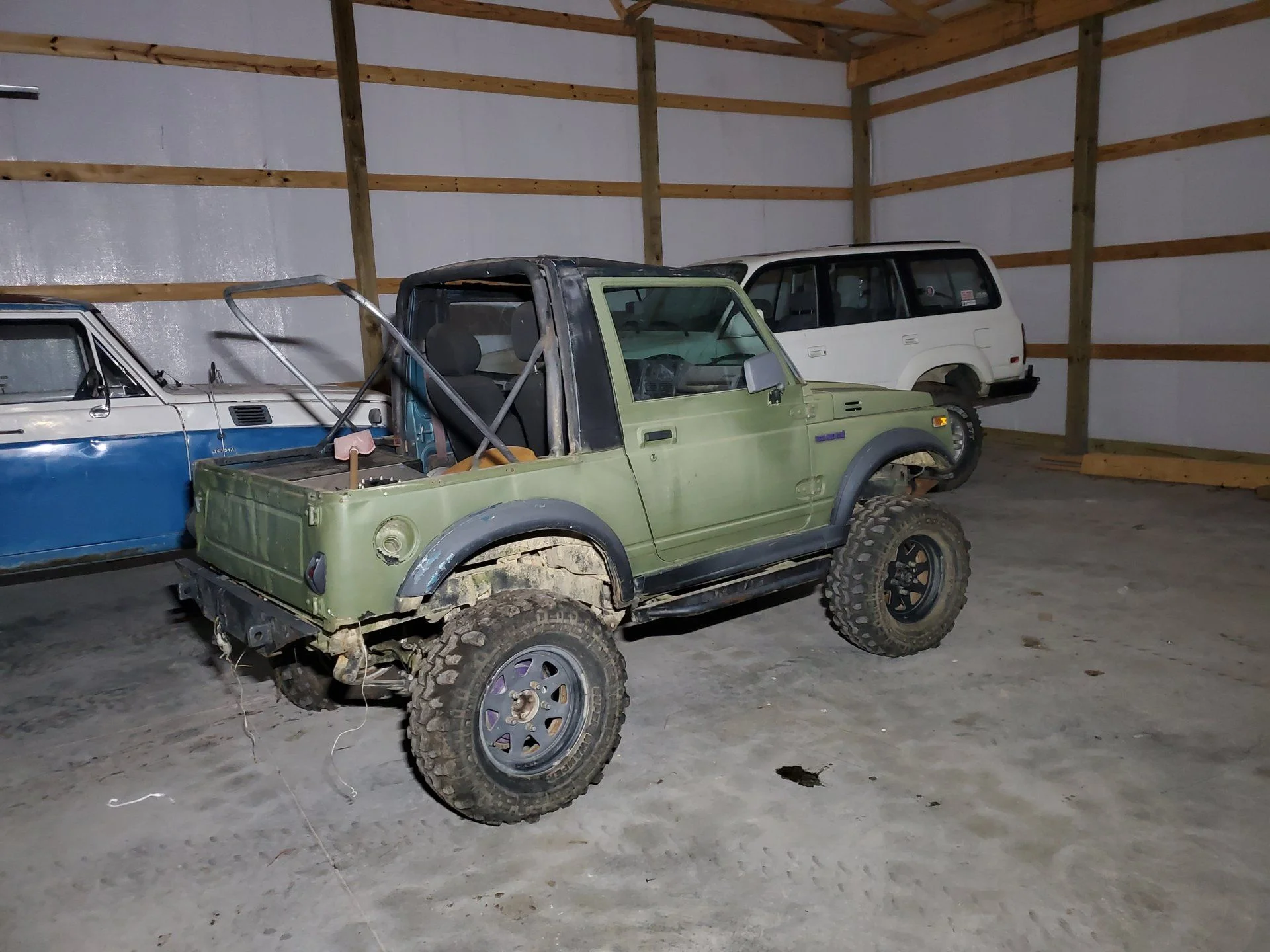

Erin drug'em into the shop this afternoon ahead of the rain. I took the opportunity to peel the crusty top off. Now that it can be kept under cover, probably going to ditch it completely.
We have a set of 31" bfg at k02s in the barn, so other than the fuel system work, going to see about breaking down the tires, cleaning the beads and then having the k02s mounted.
I still need to rebuild the driver's side knuckle and have shock mounts to install. Maybe we'll get him up and going again soon.

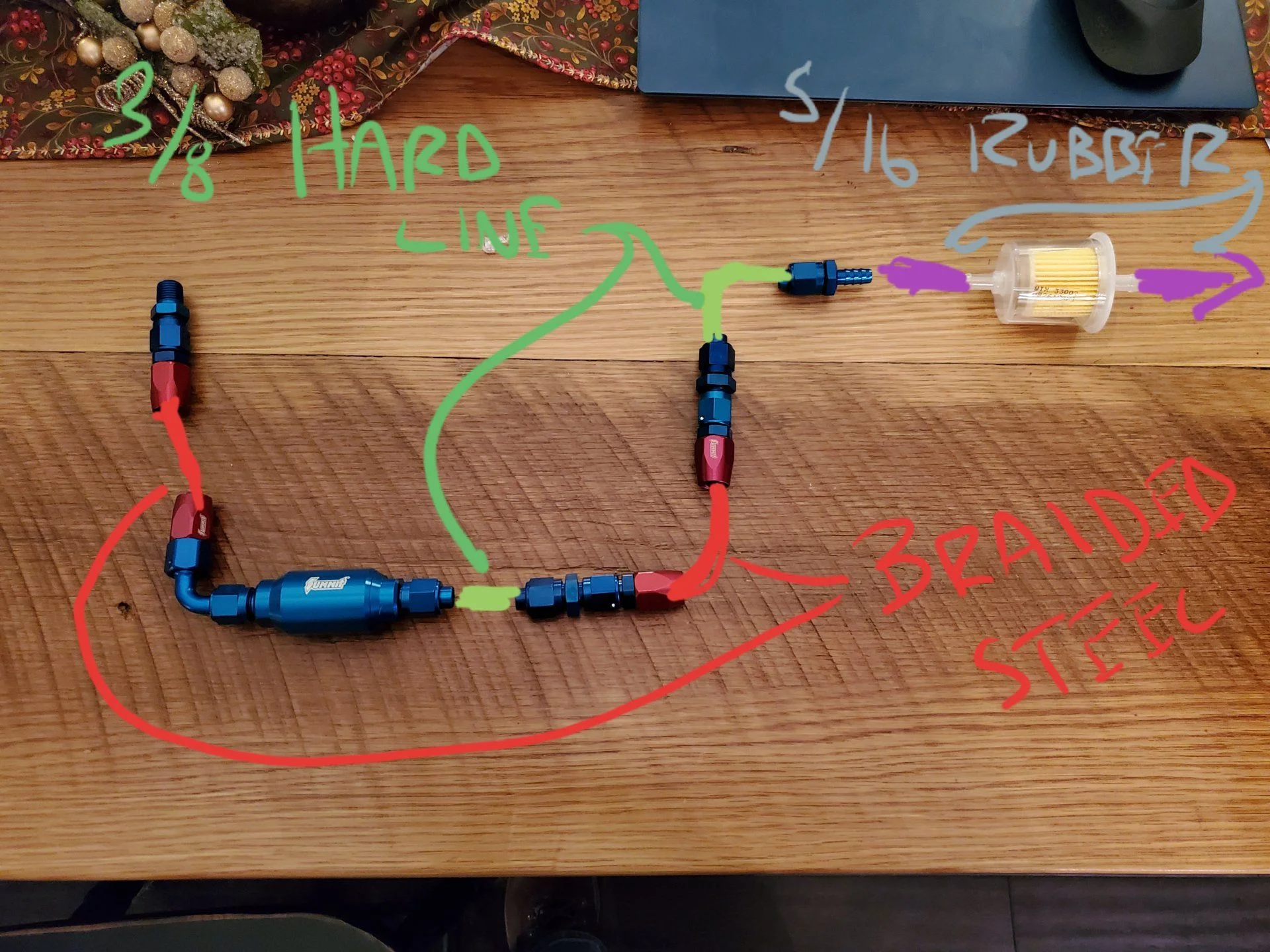

Here is the layout.
Got the 3/8 hard line and braided in the garage, I'll pick up the 5/16 rubber tomorrow when I get stuff for an oil change.
Pulled the janky hoop off the rear after I pulled the top. Not sure it it will get a full top or if we will just do a bikini. Pulled the PS door off and will pull the DS tomorrow.
I got some 5/16" fuel line and flipped the inlet on the weber and ran a line from the pump to the carb. I need to pull some vacuum and coolant lines out of the way so I can get the old fuel lines to pull them and start plumbing.

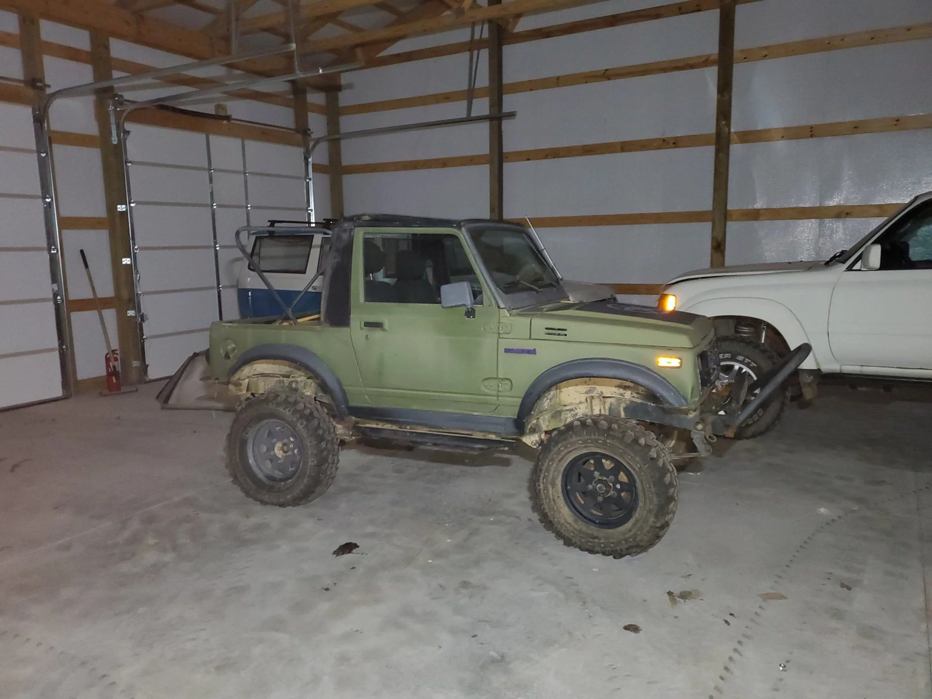

The tailgate is coming off and I'm going to build a set of half gate ambi doors for Erin to make getting stuff in and out a little easier for her.

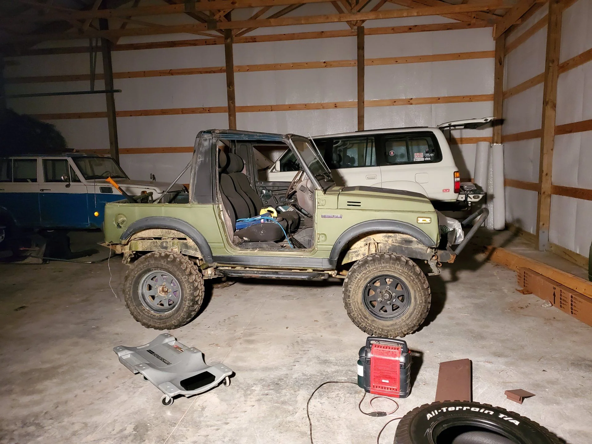

Also aired all the tires up so I could roll it around inside the shop.
Other than the fuel system, I gotta get the trans pulled so I can replace the wore out clutch.

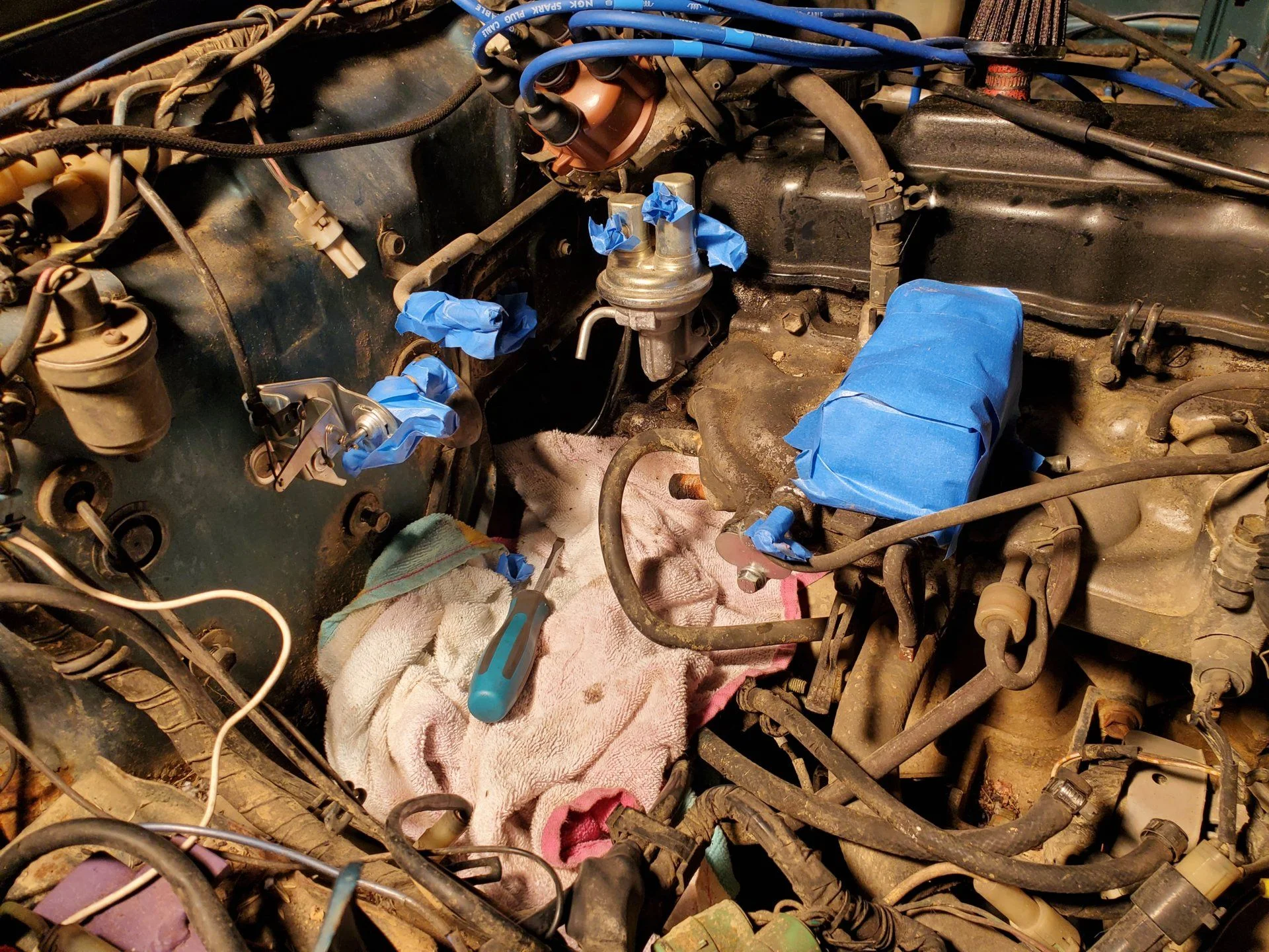

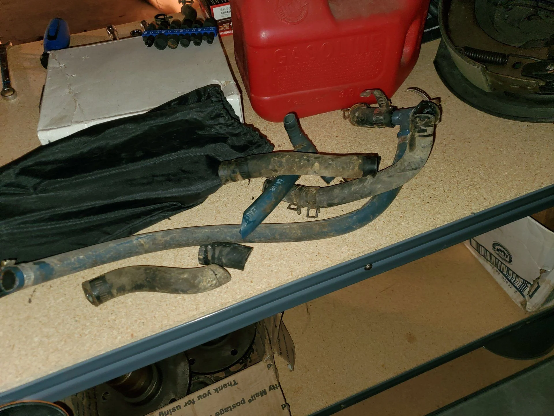

I like to have never got the inlet hose off the heater core. Ended up taking pretty much everything on that side off, including the old charcoal canister. Finally after cutting and pulling and cutting and pulling more I got everything free and clear.
I bought some hoses from the parts house, but they are no where near right, so I'll be returning those and trying to find some OEM hoses. Had to pull them to replace as they had been hacked in half to install the heater lines for the old propane regulator.

And here is what used to be in said hole.

Anyway, gonna order hoses and hopefully get them buttoned back up soon. I'm ready to get this little mule up and running again.
