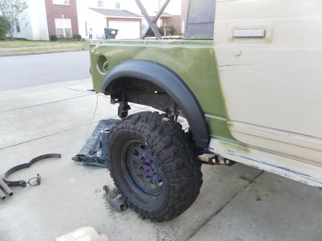

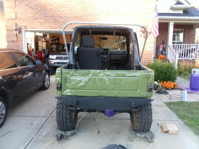

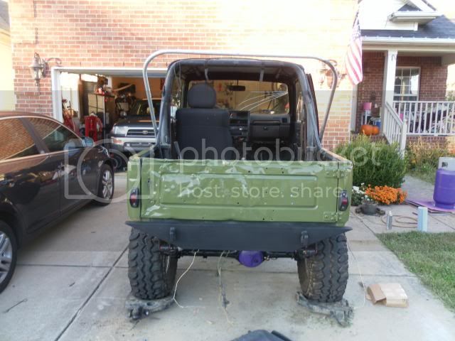

Rear quarter panel and crappy tailgate painted. Janky mounts for the propane tanks removed and air tank removed. Now room for better mounting and a beer cooler. :beer:
It doesn't look as funny as I expected with the extra height. Still will need bigger tires but that can wait for sure.

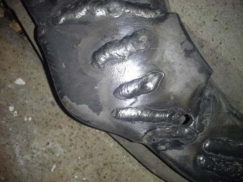

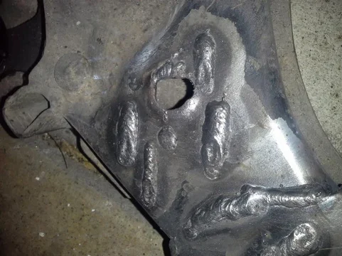

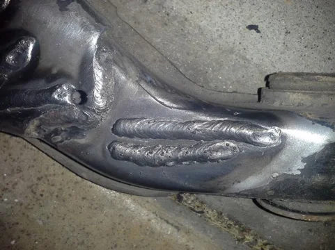

Sorry no update as promised, but I finally decided it was time.

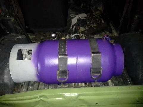

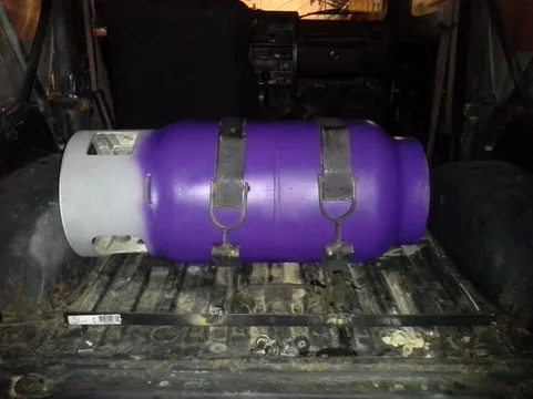

Yep, fired up the miller tonight to burn a little steel. The long one in the last picture is the last one. Not bad for the 120v side using flux core wire.... just imagine what kind of damage I could do with 220 and some gas. I'm kinda proud for the first beads in about 5 or 6 years. Tomorrow I will be building a mount for the propane tank.
And hell, I can weld .120 wall... now I just need a bender and a notcher... :hhmm:
I also offered to finish weld on the front stinger, the Mrs declined. She is determined to put on a show for you guys.

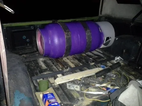

Well I got the tank mount finished tonight. Just need to pick up some bolts and washers to get it bolted to the tub.

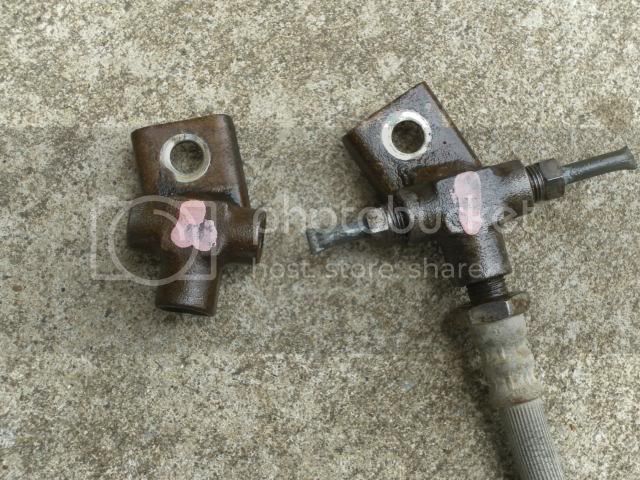

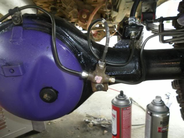

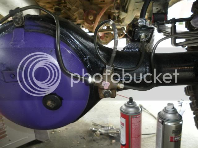

So I started Saturday Morning with a trip to the pull-n-save a few miles from the house for some brake line fittings. Aparently a M10x1.0 female double flare brake Tee is not readily available item in the local parts stores, including my beloved NAPA. Anyway a few minutes and I had these little jewels cut out from under some late 80's and early 90's Toyota Pickups.
http://s84.photobucket.com/user/mrtucker80/media/SAM_1420_zps28d5f394.jpg.html

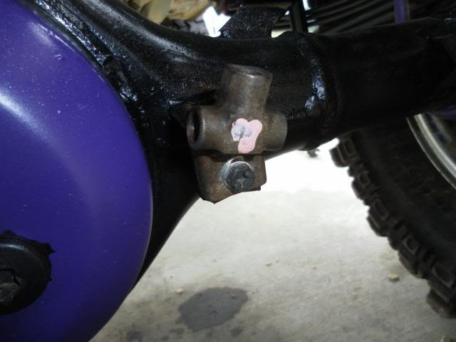

A little grinding and I was able to mount it directly to the old E-brake cable mount.
http://s84.photobucket.com/user/mrtucker80/media/SAM_1421_zps4620dc43.jpg.html
And using some stock length lines I managed to get it all plumbed up. No leaks.
http://s84.photobucket.com/user/mrtucker80/media/SAM_1422_zpsb2b4a125.jpg.html
I know it isn't pretty but for stock length lines I think it turned out OK. I will clean it up later if the need presents itself.

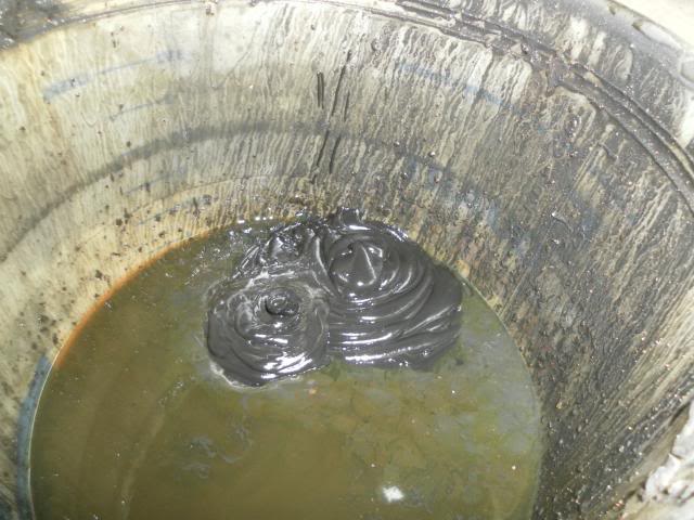

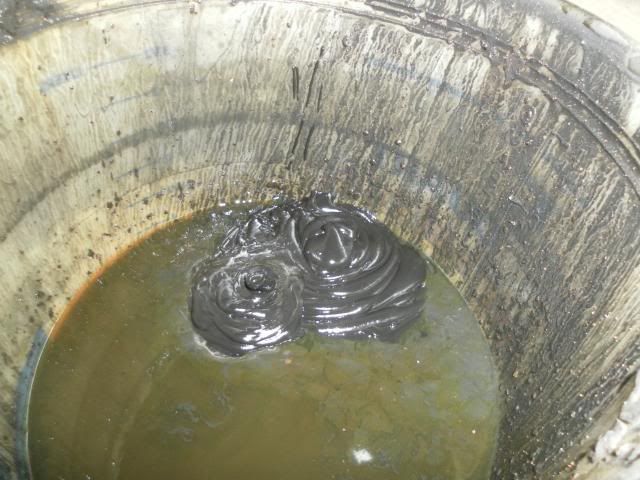

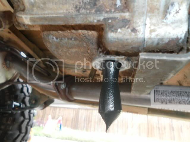

So with that task checked off, i moved onto swapping out the T-case, got everything un-bolted and when I pulled the plug I got this.
http://s84.photobucket.com/user/mrtucker80/media/SAM_1425_zpsadcaf2cd.jpg.html
As Ted noted earlier, it came out exactly like you are thinking.
http://s84.photobucket.com/user/mrtucker80/media/SAM_1431_zpsd06f6d44.jpg.html
Reminded me of a nice fresh cow pie in the spring when you turn them onto the new grass. And it STUCK!!! I mean the most terrible gear oil smell ever.
I went ahead and put the plug back in because there was no chance that was going to "spill" on me while I was removing it.

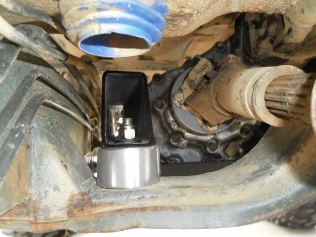

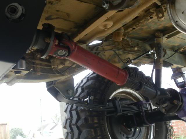

Then in with the newly rebuilt shaft.
http://s84.photobucket.com/user/mrtucker80/media/SAM_1433_zpse843a9d3.jpg.html
Then I took it up the street to make sure everything was going to turn and not burn. Well after a couple trips up and down the street, I did get a little smoke in the cab. The shipping labels were "burning" themselves off the new exhaust. It sounds MUCH better with an actual exhaust on it.

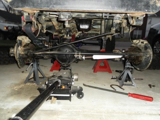

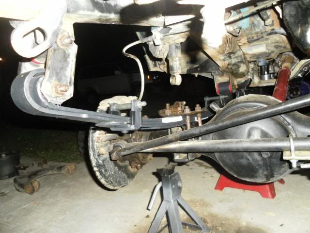

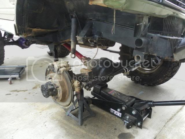

So with that all squared away I got started on the front-end.

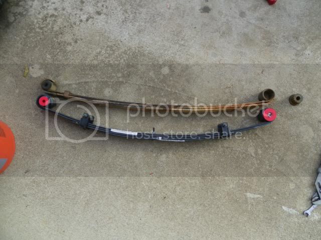

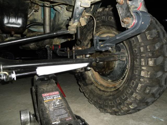

All jacked up with the front passenger spring gone.
http://s84.photobucket.com/user/mrtucker80/media/SAM_1437_zpsa32ad6e5.jpg.html

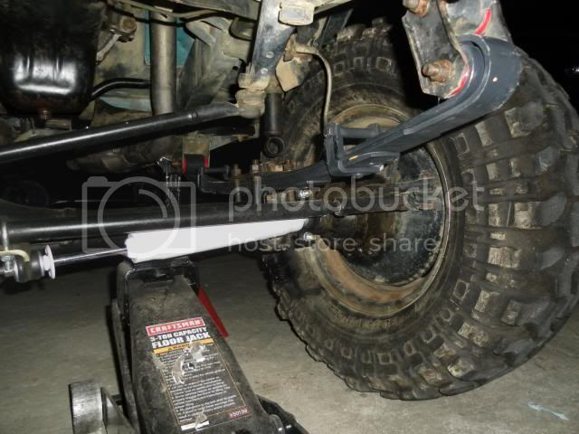

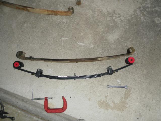

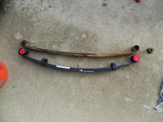

New vs. Old
http://s84.photobucket.com/user/mrtucker80/media/SAM_1438_zps36fc2f2b.jpg.html
One down
http://s84.photobucket.com/user/mrtucker80/media/SAM_1445_zps90870006.jpg.html
Drivers side, Old vs. New
http://s84.photobucket.com/user/mrtucker80/media/SAM_1443_zps1da304df.jpg.html
Two down
http://s84.photobucket.com/user/mrtucker80/media/SAM_1452_zps9bfe208a.jpg.html

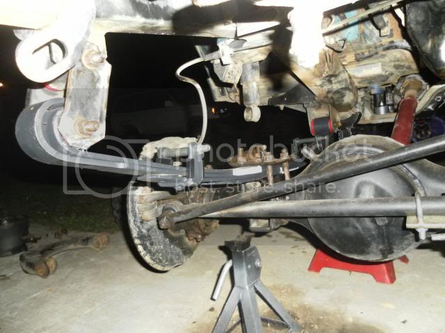

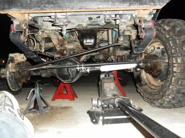

Passenger side
http://s84.photobucket.com/user/mrtucker80/media/SAM_1450_zps06f81634.jpg.html

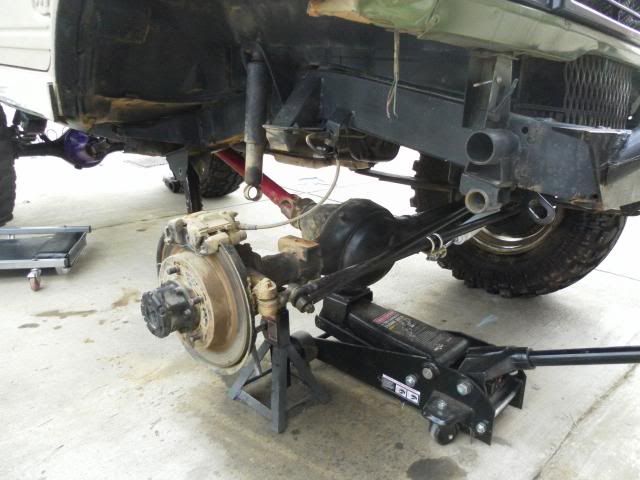

Drivers side
http://s84.photobucket.com/user/mrtucker80/media/SAM_1449_zps4e6c1261.jpg.html

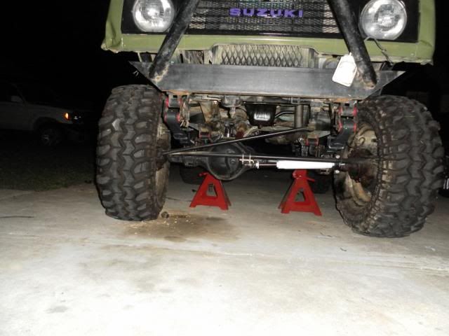

And where it was left Saturday night, back on all fours.
http://s84.photobucket.com/user/mrtucker80/media/SAM_1454_zps7f564d61.jpg.html

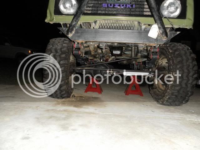

Note the terrible angle of the draglink now, which is why I got the Sky crossover, high-steer ordered on Monday.

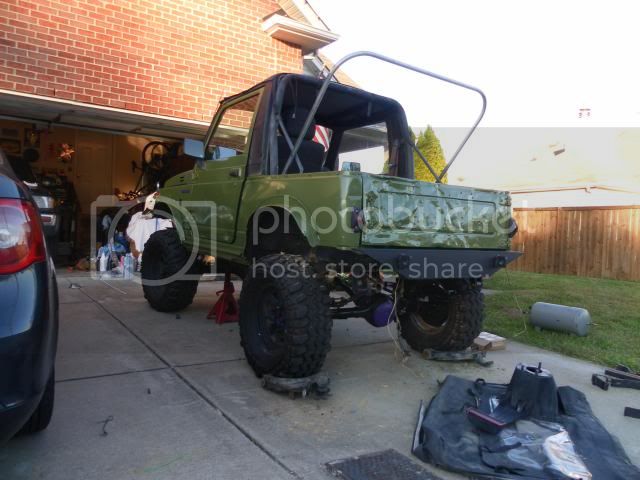

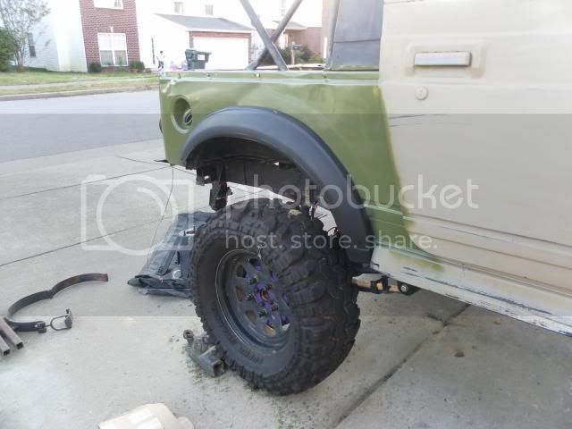

Got the tailgate and passenger rear fender painted along with the rear flare. So it is officially 3/4 of the way painted.
http://s84.photobucket.com/user/mrtucker80/media/SAM_1455_zps0f99e59d.jpg.html
http://s84.photobucket.com/user/mrtucker80/media/SAM_1456_zps2f1fef8d.jpg.html
http://s84.photobucket.com/user/mrtucker80/media/SAM_1457_zpsa30b7e06.jpg.html
I will get the door and rest of the passenger side when I pull the door and finish up the new guts.
I went ahead an got the air tank pulled out as well as cut out the old propane mounts. As you might have noticed above I took the old mounts and used my new found welding ability to make a new single tank mount to bolt horizontally to the floor in the rear.

Yes!!! The guys at Essentially are awesome they did this in like 2 hours! Tested them out with the high lift and ended up with this much front flex. That's gonna be fun. .
It actually picked up a rear wheel before the front came off the ground...
Just need a little paint and they are good to go.
