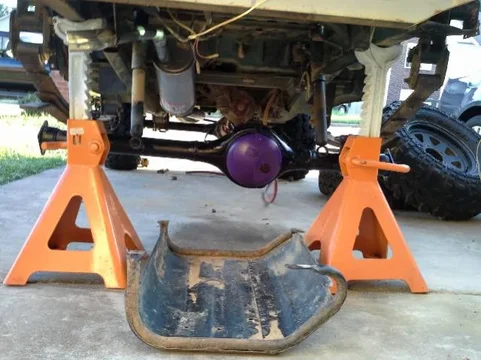

Well we are getting the rearend started today.
This work is a little above my pay grade so he handling it. Ask him how much he hates the bearing retainers.

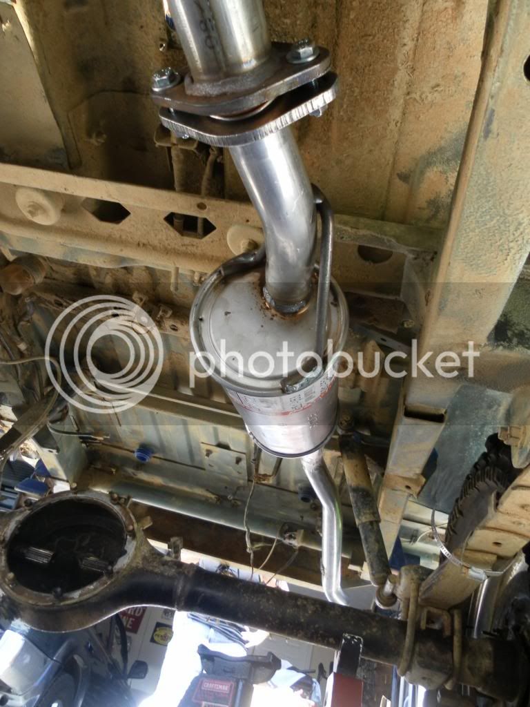

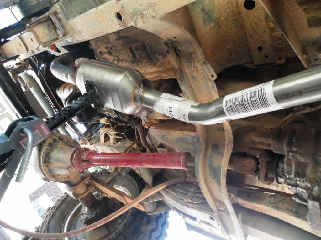

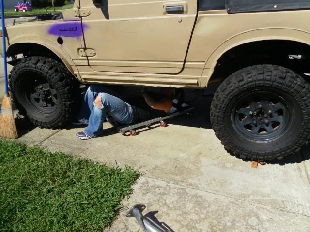

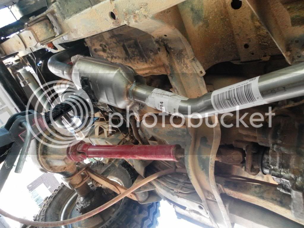

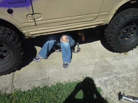

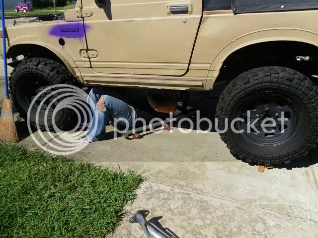

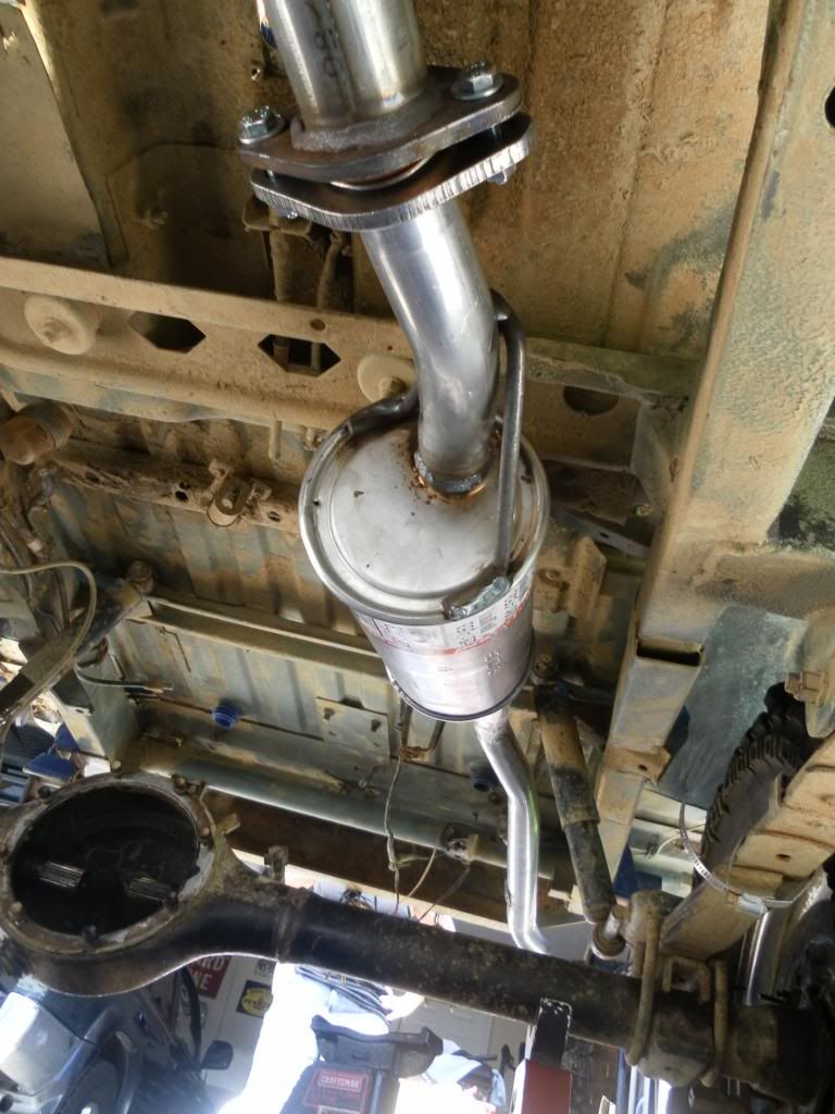

Well, yesterday we threw down the gauntlet. Exhaust was a hot mess, so that got replaced with a complete new Bosal System from the manifold back.
I put Erin (Mrsjynx) to work on that one.
http://i84.photobucket.com/albums/k8/mrtucker80/SAM_1340_zps9f3e99be.jpg

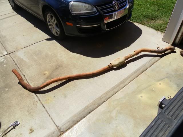

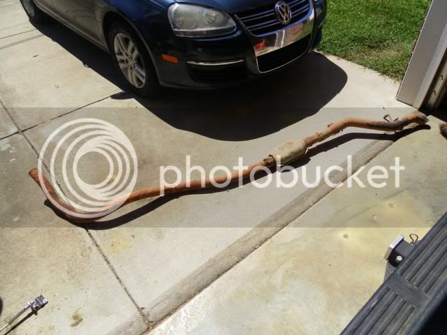

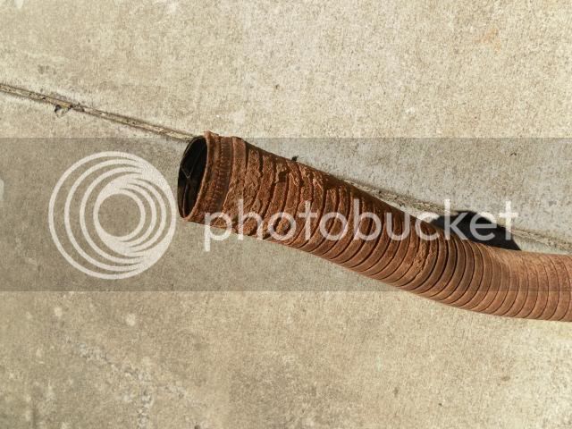

Two hose clamps and a couple ground tack welds and this was free.
http://i84.photobucket.com/albums/k8/mrtucker80/SAM_1346_zps763559f6.jpg

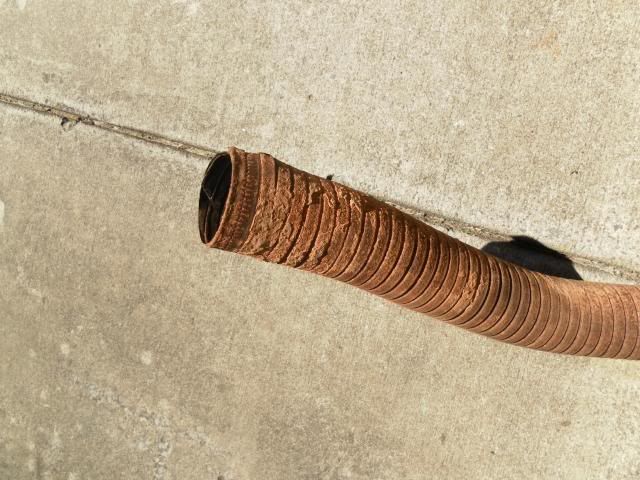

I assume this is flexible exhaust, but it sure looked like flex electrical conduit to me...
http://i84.photobucket.com/albums/k8/mrtucker80/SAM_1347_zps0e1dbb66.jpg
Replaced by this:
http://i84.photobucket.com/albums/k8/mrtucker80/b6f31b77-9a4b-4f4a-9dee-23d9808ffc05_zpsa060309e.jpg
http://s84.photobucket.com/user/mrt...3-41c3-9ab2-cf547cae3ff8_zpsc891f8e0.jpg.html
The effin manifold flange bolts are those spring type and were a serious :censor: to get started and then because the Bosal Flange was a good bit thicker I had to be careful not to turn the springs inside out...
We were going to start it up and see how it sounded, but the battery had a whooping 2.34A, so I guess I need to add that to the list.
But on the positive side, the system is tucked nicely and should be well protected.

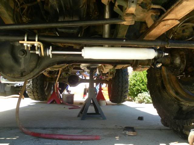

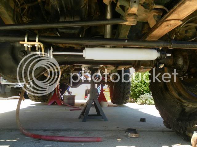

Then we moved onto the steering stabilizer. Pretty straight forward install. May have to adjust it after we get it up and going again.
http://i84.photobucket.com/albums/k8/mrtucker80/SAM_1342_zpsd1179d4b.jpg

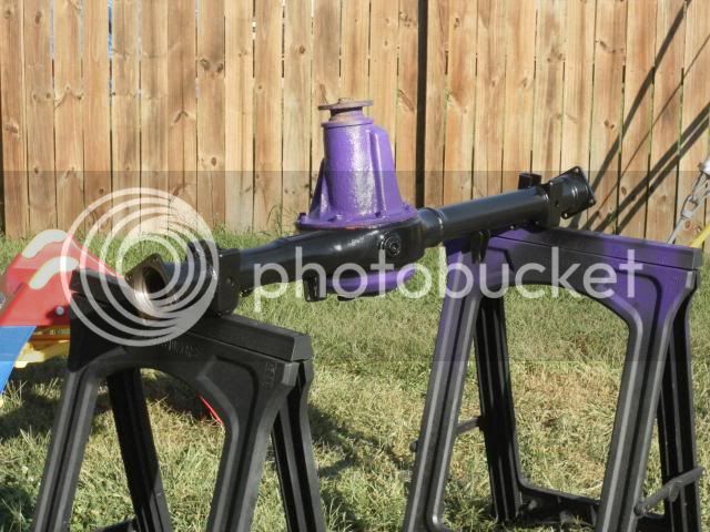

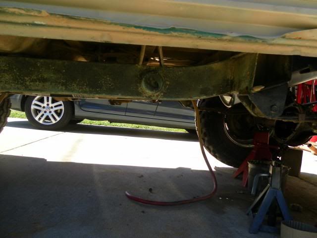

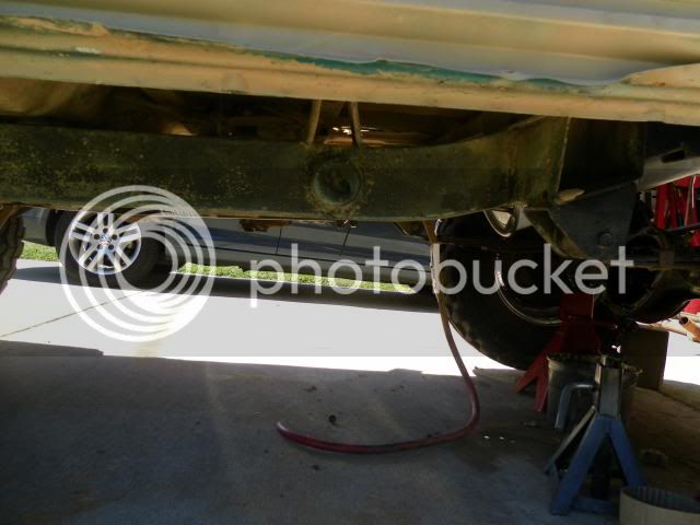

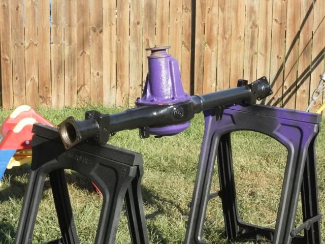

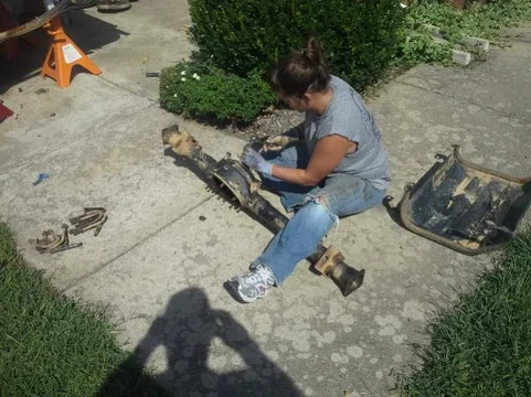

Anyway, we started out pulling the axle. We took a trip to the $0.25 car wash with a bottle of Super Clean and pressure washed the :censor: out of the housing. I really wish I had gotten some before pictures, but if you remember what the bearing caps looked like in the first couple posts, just picture that inside the housing and tubes.... Super Clean is easily my new best friend, the housing is squeaky clean now inside and out. With the tubes cleaned we did see that they apparently burned thru the tube when doing the SOA and then had to "fix" it.

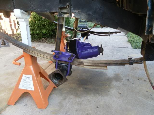

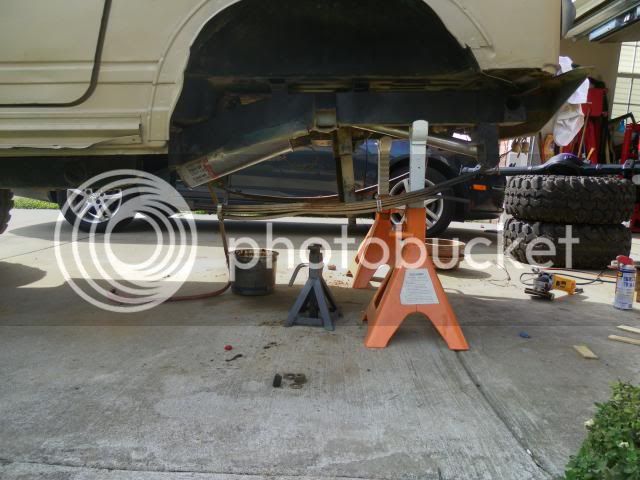

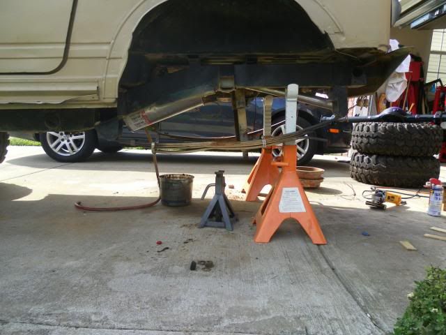

Here you can see the terrible spring again and the 12T stands keeping things up where we can get around underneath.
http://i84.photobucket.com/albums/k8/mrtucker80/SAM_1360_zps51ffdf5b.jpg

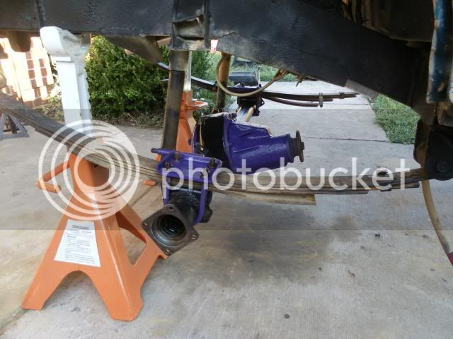

Little fresh paint on the housing
http://s84.photobucket.com/user/mrtucker80/media/SAM_1357_zps91b6e17a.jpg.html

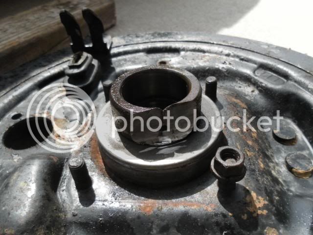

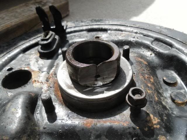

Then while that was drying I went onto removing the old axle bearings. Had to grind down the retainers and then use my newly acquired press and splitter to press them off. Major suckage :bang:
http://i84.photobucket.com/albums/k8/mrtucker80/SAM_1351_zps383762e0.jpg

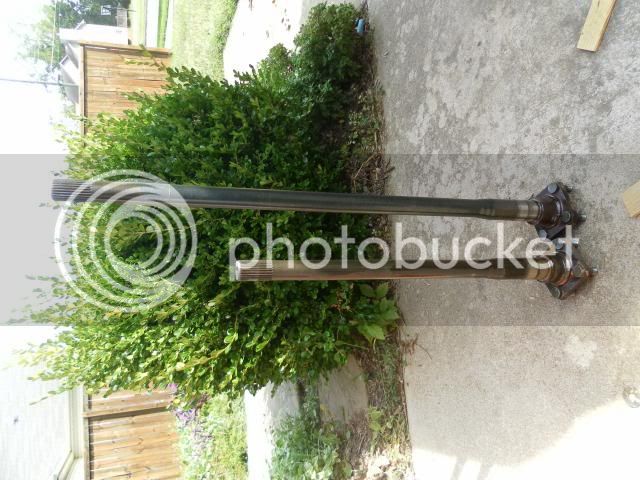

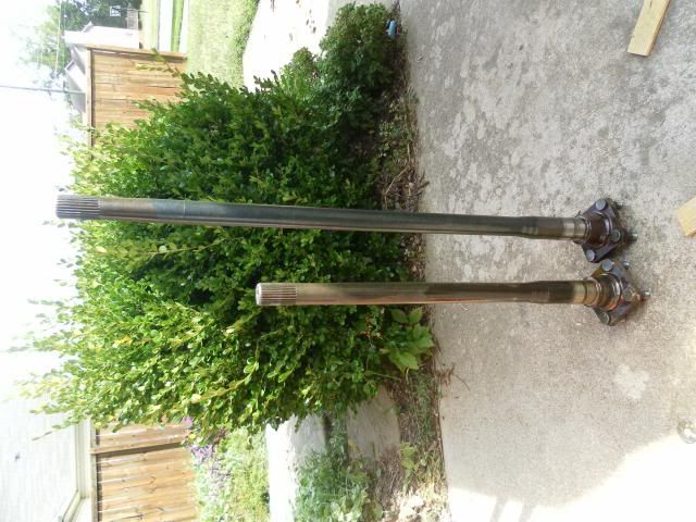

Got the shafts stripped and ready for the new bearings.
http://i84.photobucket.com/albums/k8/mrtucker80/SAM_1358_zps62645438.jpg

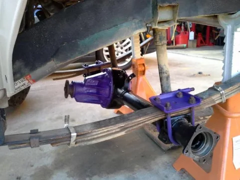

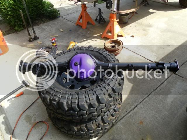

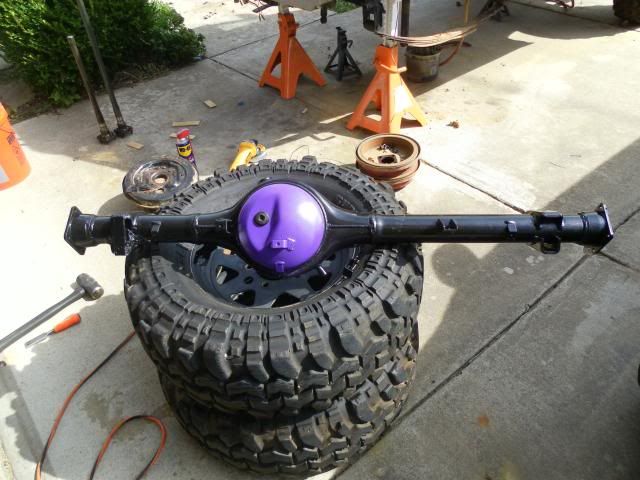

I am doing a axle retainer mod which uses a smaller square retainer plate along with a modified brake backing plate which will allow for the axle to be removed without having to disassemble the rear brakes. The retainers are on the order with the springs so the new bearings are on hold until those arrive, but we did go ahead and get the new chunk cleaned up, painted and dropped in.
http://i84.photobucket.com/albums/k8/mrtucker80/SAM_1362_zps704dc4f7.jpg
Sealed it up with a little Toyota Red FIPG :cool: So that counts right. I decided not to throw a lot into these chunks right now, I will fiddle with them as needed until I get ready to do the Toy axle swap.
So we went ahead and slung them back under the rear so it didn't have to camp in some random place in the garage until the springs get here.
http://i84.photobucket.com/albums/k8/mrtucker80/SAM_1364_zps3a9dd356.jpg
So when the next order gets here getting the wheels back on the ground should be pretty quick.

Those are super secret inverse flex springs!! The hose clamp retainers are patented and trademarked :flipoff2:
Yeah, like Erin said, we have a new set of rear springs and bushings on the way. I wish I had gotten them ordered sooner so we could have had them here for this weekend. I think we could have had it back on all fours by now, oh well. Of course we are still searching for a rear D-shaft before it will actually be able to move.
