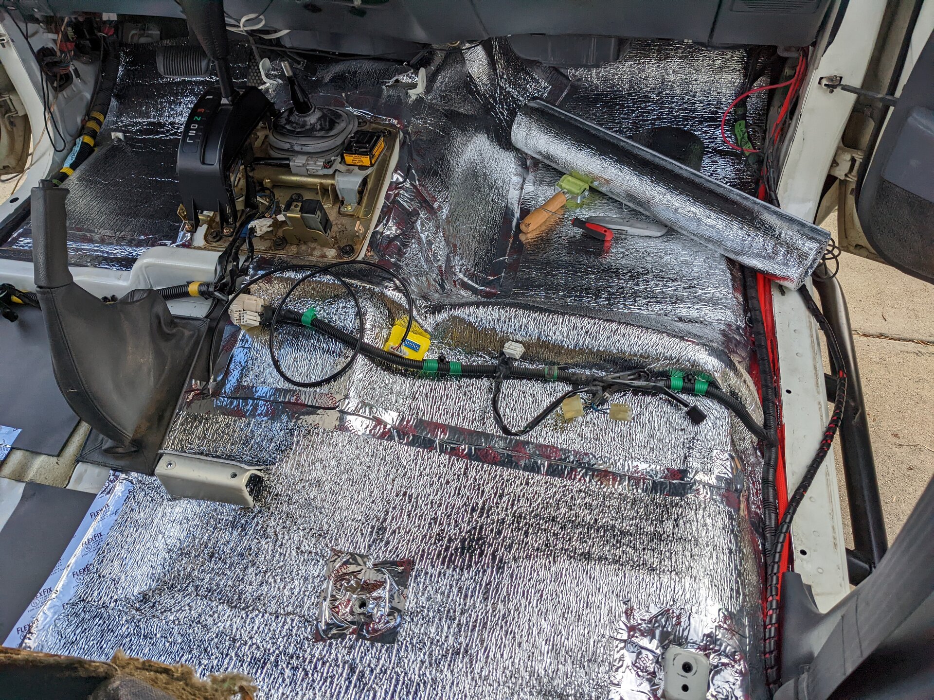

Last year I put the sound deadener, some adhesive foam, and then covered it all with some reflective heat shield stuff. Seats still fit (though it was a little tight) and I left the factory deadener in place. And my wife doesnt get the heat from the cats nearly as bad anymore.

To stop heat you want layers and reflective material, and something that captures layers of air. I used 1/4 thick foil backed EVA foam previously with good result.
Foil side to the heat.
This looks very similar to what I've done in the past.
Taping every joint and eliminating gaps is worth the investment in time.

I added the foil backed rubber tiles along the floor and topped it with a MLV. Also did the same treatment in the doors and rear fenders. Going around and tapping on the doors give a solid dense sound and feel. I also added a reflective MLV on the passenger side front seat area and around the transmission area. That made a huge difference in temps.
