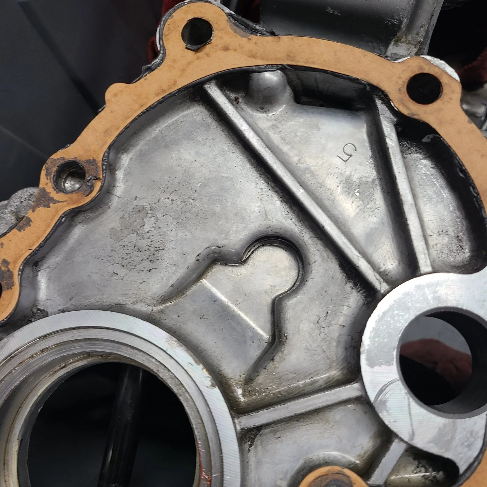

Incidentally, the 5th gear oiler indent in the Tcase housing from your picture earlier in this thread (from many years ago) actaully looks a little wider, with more space for a shaft to sit. It also has an additonal bolt hole in the housing versus what mine looks like. Here's a recent pic from my Tcase housing.
You have the late 82/early 83 t-case. But it should still work fine. Did you try bolting it up without the oiler cup to see if that works?
are the dowel pins fully seated?
As cruisermatt suggests, try it without the oiler. They certainly are a plus, but not completely necessary. Lots of land cruisers around the world were built without them and are still driving around.

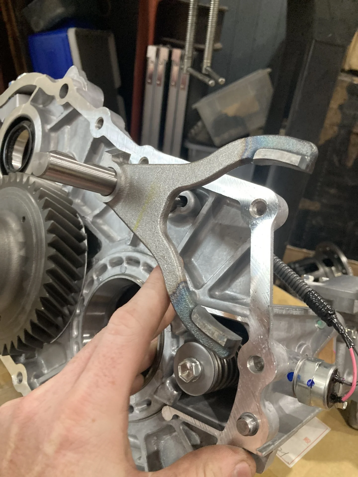

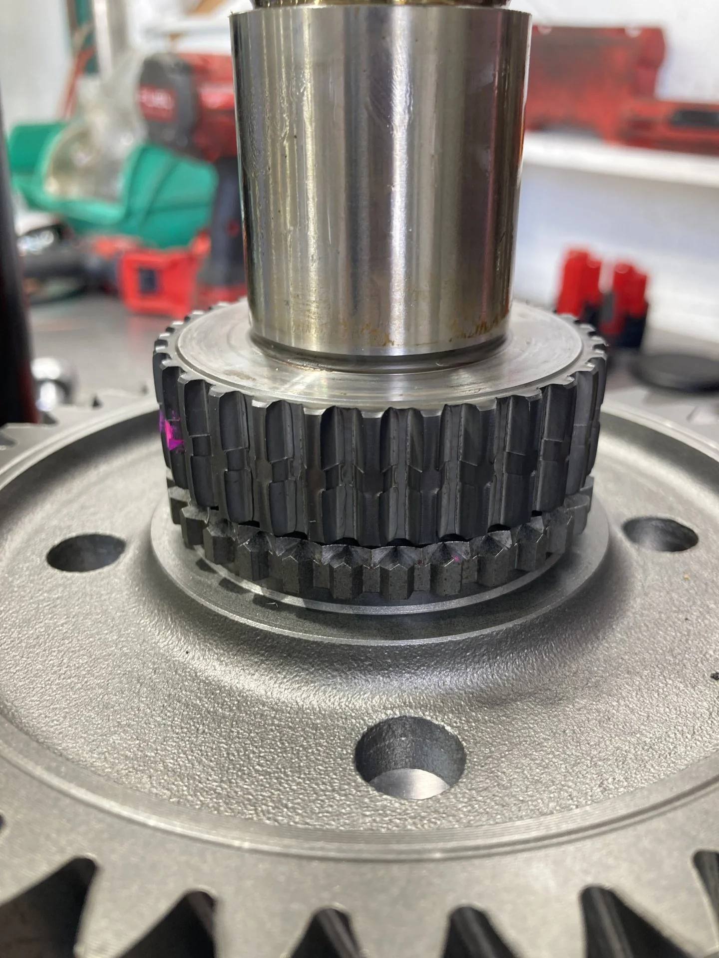

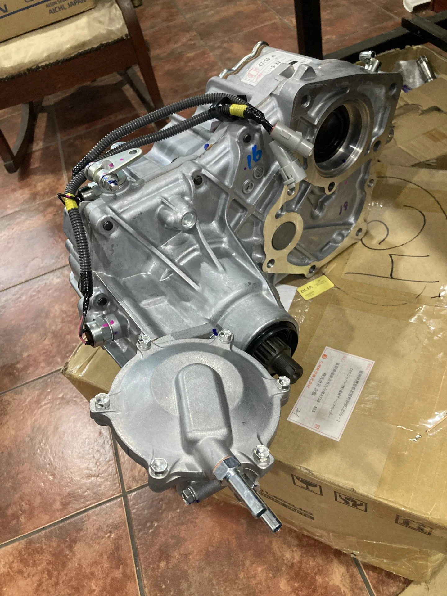

To further muddy the waters...Just took apart a brand new vacuum shift case to install some 10% OD gears before it gets bolted behind a 6l80e... turns out Toyota actually switched back to bushing supported output gears for 2007-up application.
Also noted that the output shaft range selector splines wet back to the "pinched" design that @orangefj45 has noted as being necessary for the low range gear installs (88-90 applications have straight splines).
I also see questions asked about the heat marks on the selector all the time - well this is what a brand new one looks like :)

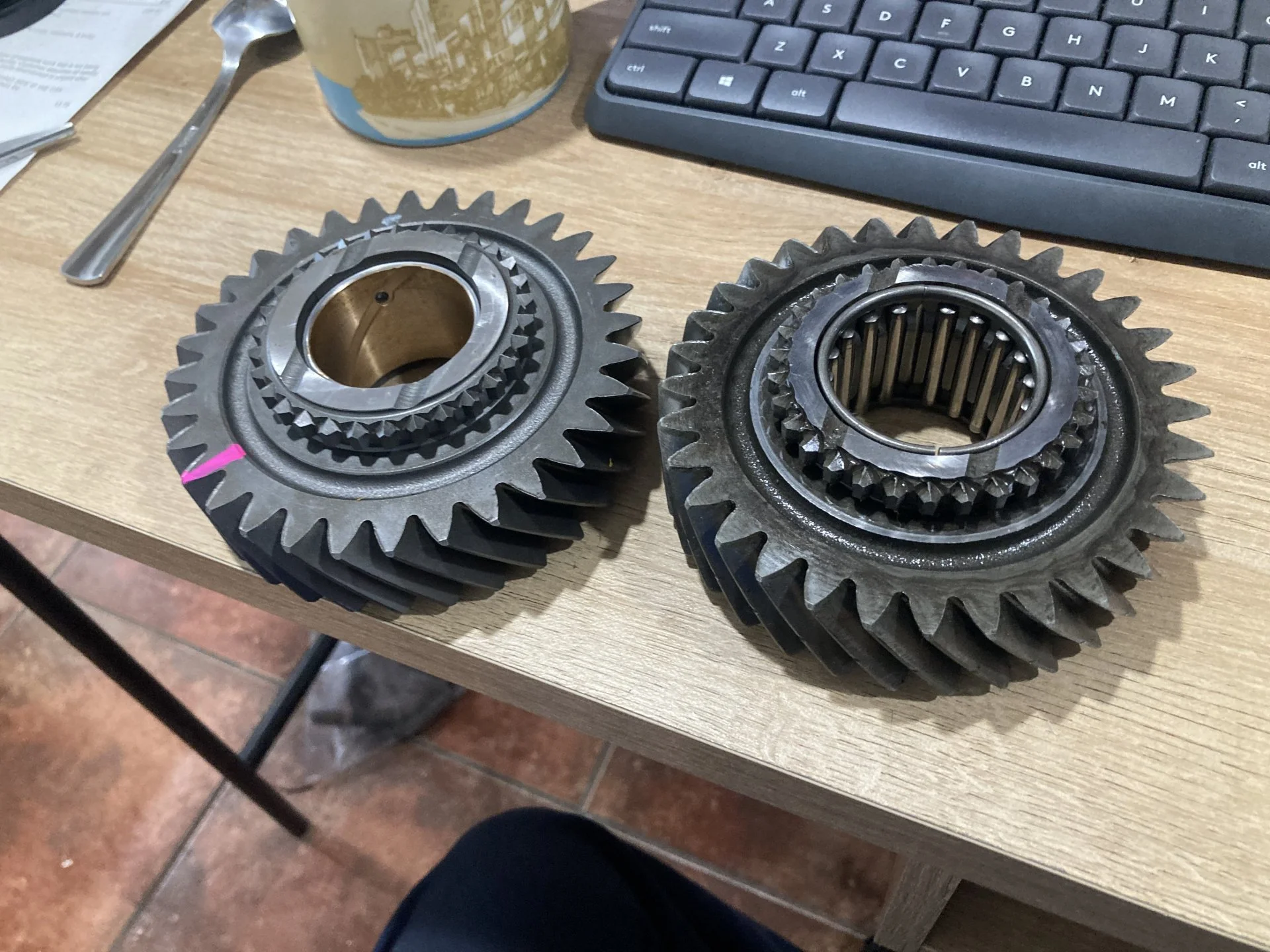

Did H55F transfer cases ever have roller bearings in the output shaft gears? I thought they only came from split case transfers found behind auto boxes.
But the bigger mystery is who wants a vacuum shift transfer... each to their own I guess :D
Owners who want their dash button and glove box shift instructions to be stay original 🤷
It’s a perfectly reliable system if actually maintained, aka used more then once a decade.
