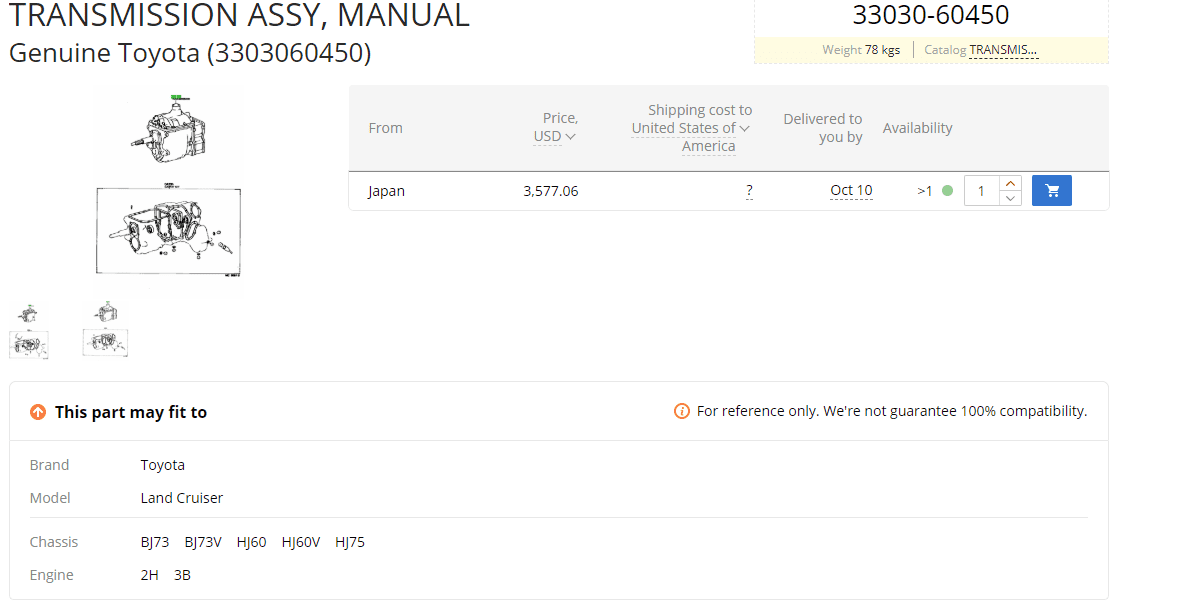

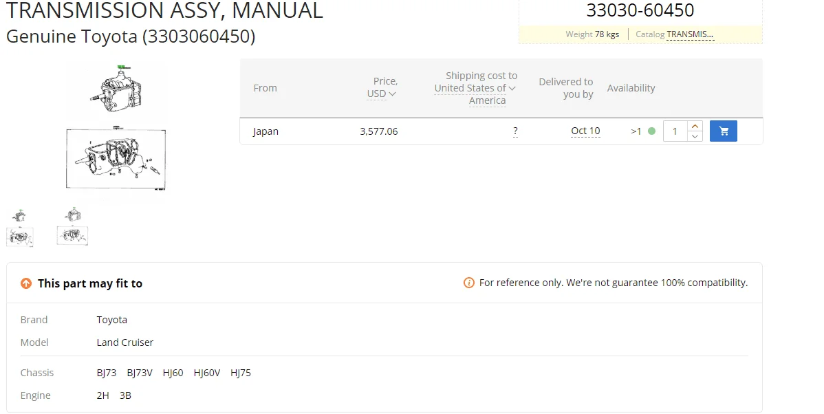

I'm a bit nervous now!! I have a 87 FJ60. I bought a H55 new from Toyota My Tcase is the 38mm. I got the rebuild kit for the Tcase,new clutch,rear main, new transmission mount. Am I good with the output shaft or.......?
Are you worried about the output shaft of the H55 or the output shaft of the transfer? Looking the part number for your box it is mated to 2H or 3B not an xF engine. Would be worth confirming if the input shaft is the same for the xF series engine as the 2H, I am sure there are threads on this...even earlier on in this one. I am still very new here and coming to grips with the amazing amount of data on this forum...

View attachment 2448481.
I think that could be that a h55 never came in a fj model. For sure could be wrong.
