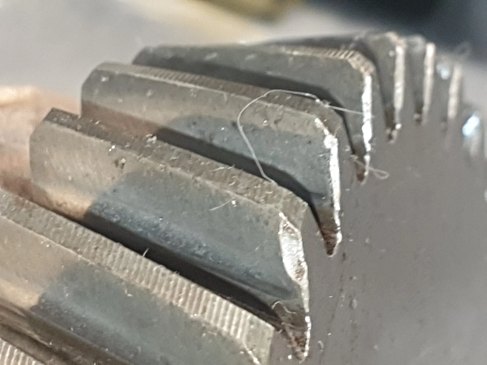

My otherwise perfect counter shaft has 3 tiny chips.. is that a big deal ?
My otherwise perfect counter shaft has 3 tiny chips.. is that a big deal ?View attachment 3161116View attachment 3161117
I would not be too worried about that, as long as you take off any sharp edges with a needle file, it should be useable. Obviously a new one would be better though.
In case you are not aware, the weak point of the H55F is the rear bearing surface of the countershaft, where the rollers directrly contact the shaft. Before re-using an old countershaft, make sure that the surface is perfect, or you may be pulling the gearbox apart again before too long.

Thanks, thats what i was hoping.. the bearing surface looks good and thats why id like too reuse it

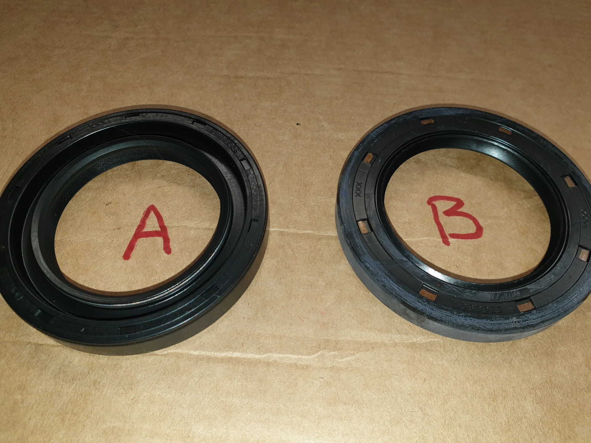

Ok , so can some one tell me which seal goes where.. ive got the outputs sorted , ... the front case halve has B in it , but whats A for ? Its the supre duper does everything TT kit if that helps
A looks like the double lipped seal for the transfer input gear, as fitted from about 1988 on. B is the single lipped seal fitted to earlier models (which are much more prone to leaking). If you have fitted B, I would swap it for A. You only need one.
Have a look here: Transfer case input seal comparison - https://forum.ih8mud.com/threads/transfer-case-input-seal-comparison.553563/#post-13379261

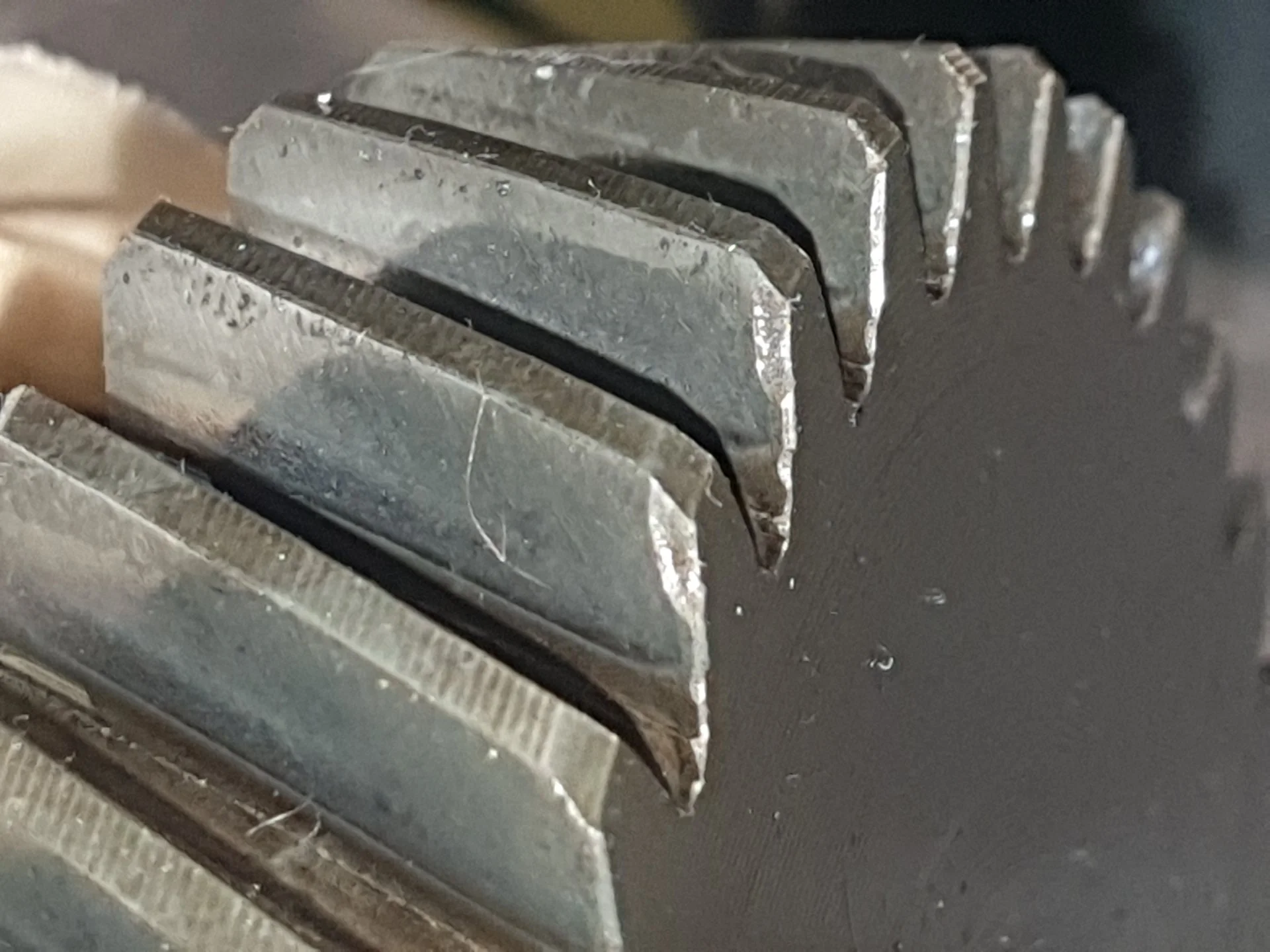

New question.. i have 2 3rd 4th sliders , and both are the old type with the groove all the way round.. they say upgrade too the one with 3 cut aways but is it a really big deal with new syncros and keys ? Thanks for any help
There is no issue with compatibility. The newer type seems like a better design, but the one you show seems to have held up fine through the years. The ends of the teeth are showing some minor wear, so I would only replace it if you are really making a 'like new' transmission.
Cool.. i was just going off what was said in the terrain tamer youtube video , but if the parts are new , or hardly worn hopefully its no big deal

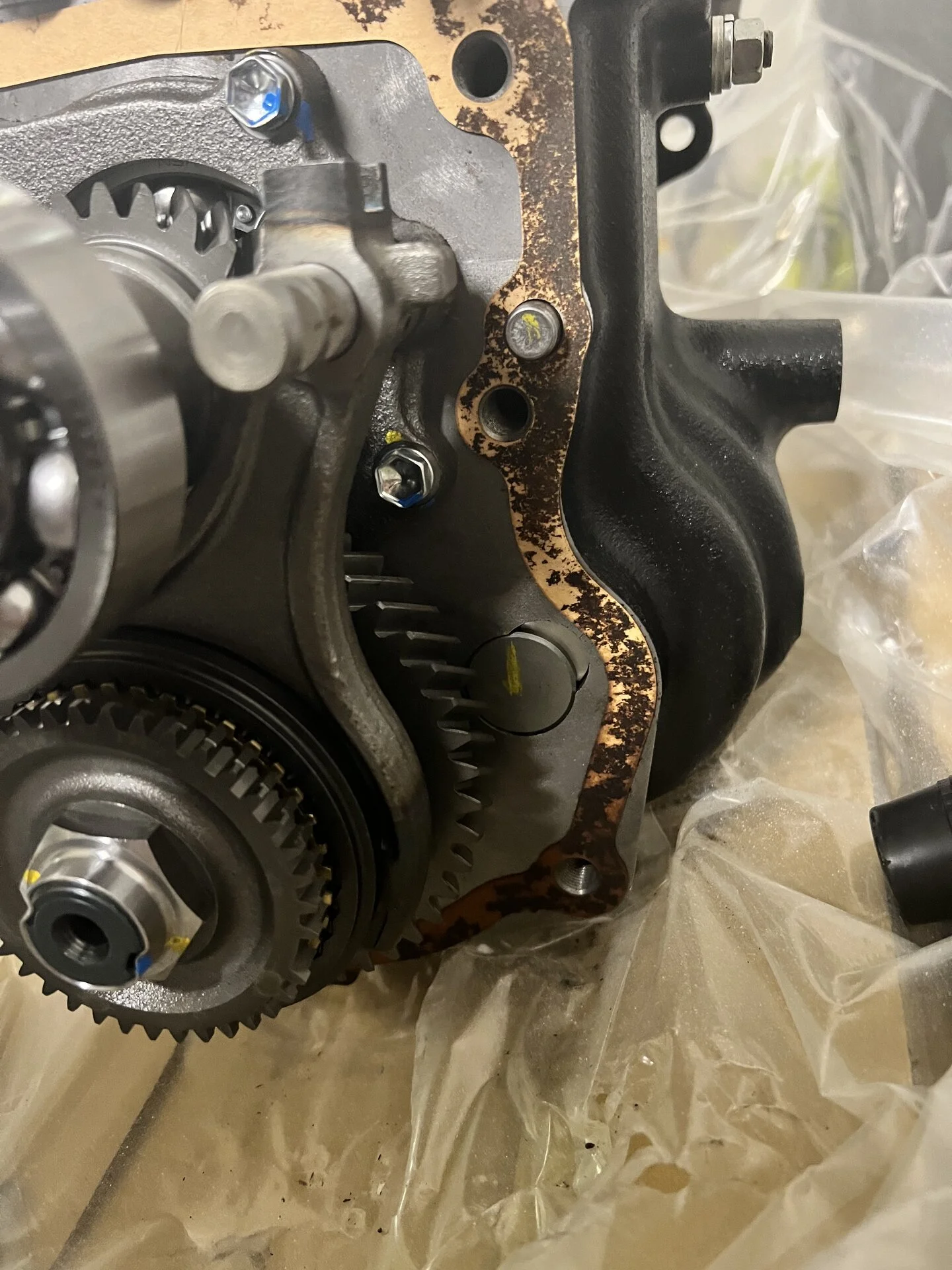

and one more tidbit about the h55fs. even when i buy a new trans from the dealer, i remove the 5th gear extension housing and apply some loctite "formula 518" to the gasket. i've seen a few of these transmissions leak between the main case and extension housing and i've heard a few people complain about it. doing this only takes 20-30 minutes ( if you get interrupted by customer phone calls :lol: ) and it's well worth the effort! you have to remove the 5th gear detent screw, spring and check ball but none of the linkage or levers. pretty simple really.
here's a crummy pic. sorry, all of these were taken with an iphone.....
hth
georg @ valley hybrids

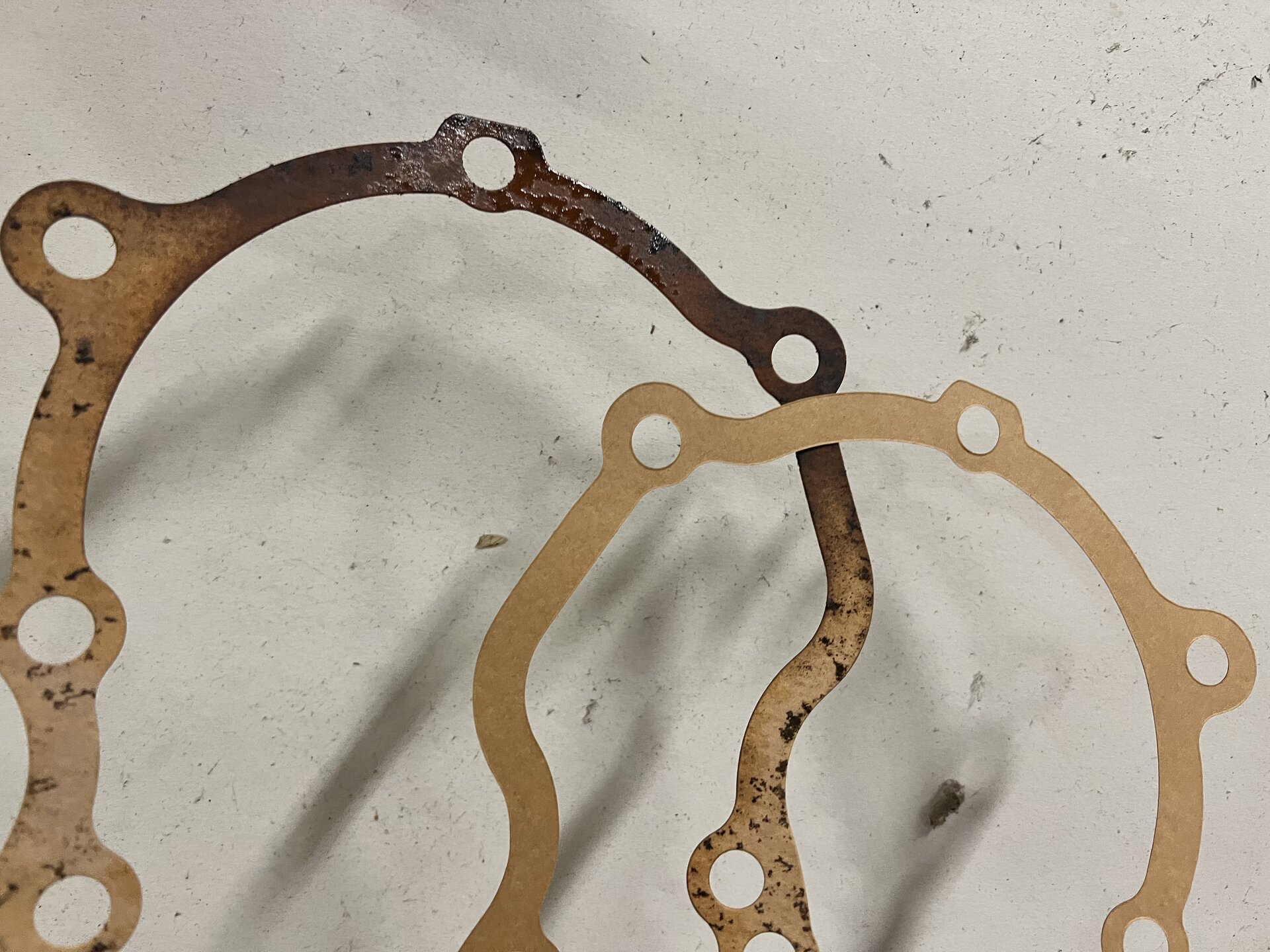

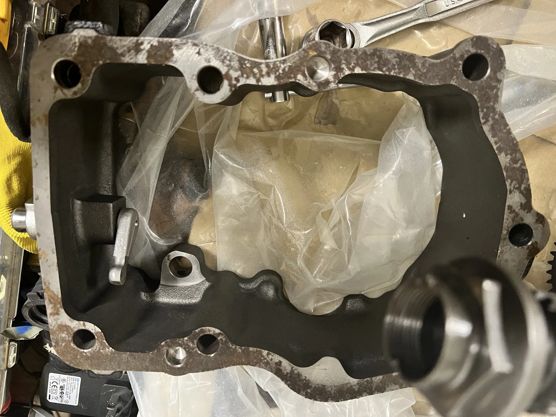

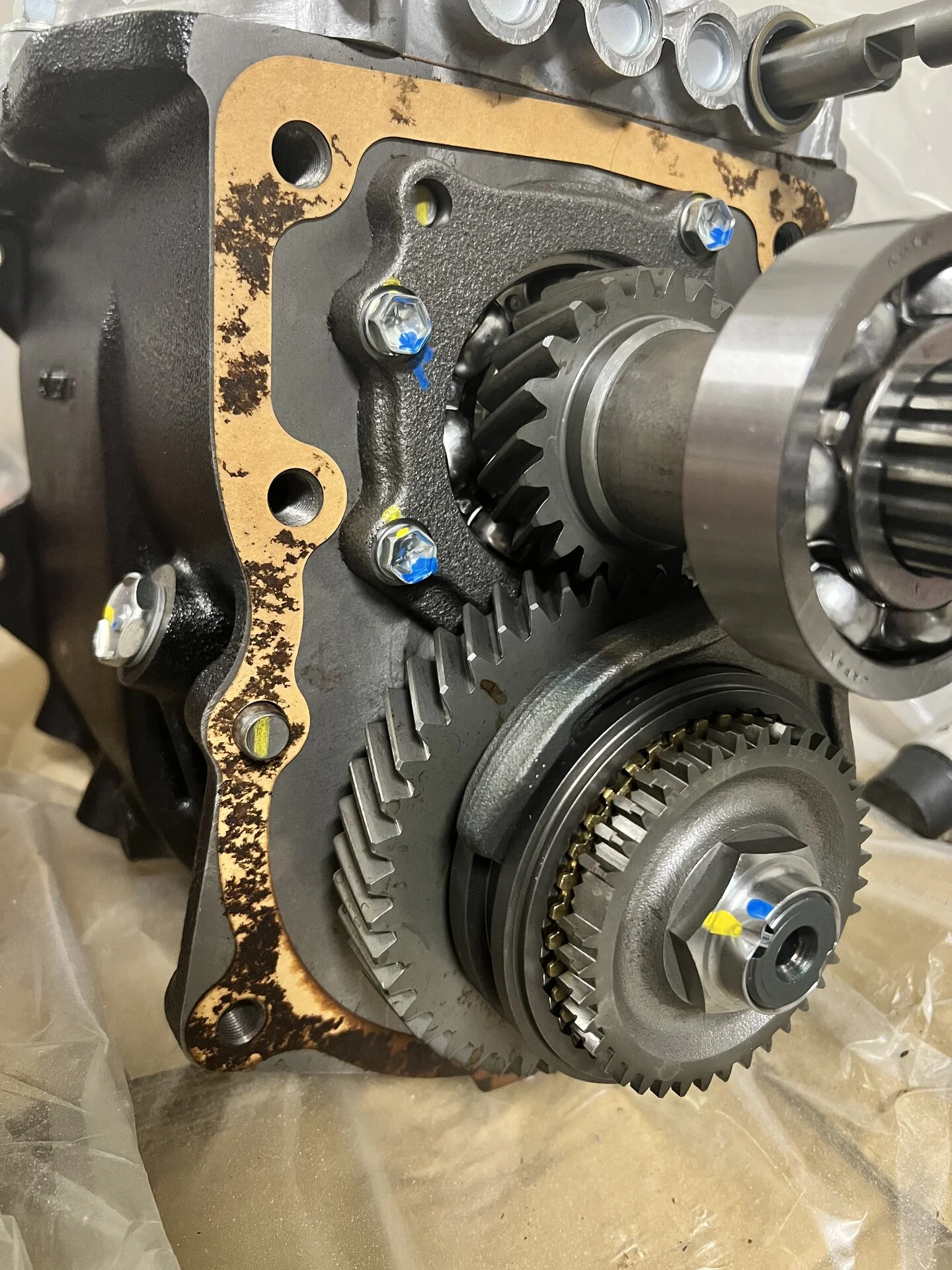

As one should, I followed @orangefj45 advice and popped the 5th gear housing off of my new h55f so I could add some sealant to reduce the chance of future leaks, and I’m very glad I did because here’s what I found:
(Original (new w/transmission) gasket vs the one I replaced it with)
Needless to say, I’m glad I spent the time to pull the extension housing off, as I have little faith that the gasket and corroded surfaces in the housing would have been free of leaks once in service.
As to the cause, I can only speculate. I did have this transmission stored for almost a year, and if that happened while in storage, perhaps it was a result of condensation accumulating between the close surfaces there when there was a swing in temp or humidity. This was the only place with corrosion on the transmission though. Could also have been there before I received the unit from Toyota, but no way to know.
In any case, it took more than 30 mins but I was able to bring it back to acceptable condition by resurfacing the affected areas and replacing the gasket.
In my excitement to get that fixed and to finally start assembly of the tc onto the transmission, I left the 5th gear oil pipe off the front case half. Oops! Didn’t realize till I quit for the night around 11:30, with the front tc half mated to the h55f, and I was back in the house washing my hands. Back out to the garage, pull the front case half back off, add the oil pipe(!!!), redo gasket seal, reassemble and torque, then to bed.
Thanks for this tip (and others), Georg! I’m certain you saved me from some headaches down the road
The H55F I bought last year had the same thing goin on. I imagine it’s from the trans sitting in a warehouse until someone with a similar affliction to us decides to order it up.
Very common “issue” since these do sit on the shelf, in a factory, container, warehouse …. for some time.
But it’s a simple fix and we’ll worth the time investment.
