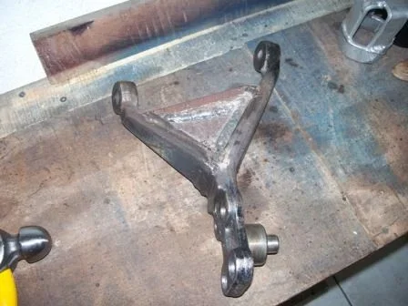

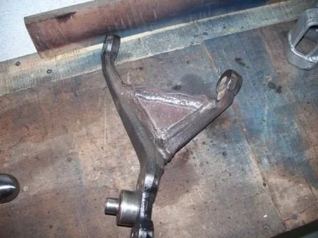

SOA a La tica

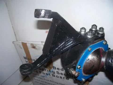

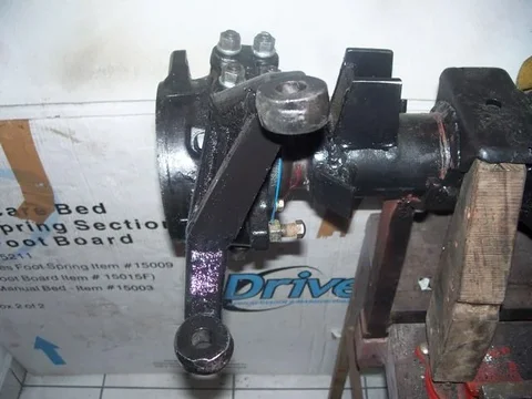

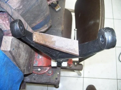

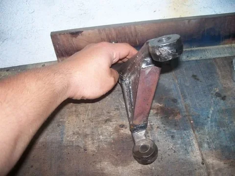

John thanks for the advice, yes actually the point of builtding the double steering arm a like just for a while until i get the money and the means to get the high steer from 4X4 labs or some where else , i was also wandering , well go to my friend the machinist and ask him if it´s also able to made the hight steering arms here, well i think if that costme the same than getting the high steer in US and shiping down to Costa Rica, but in the mean time i have mede reenforcements to the double arm, at least to last me enough to get the others later :)
Guys , needs another opnion!!!, when you made the SOA , an also planing to put a very nice power steering, based on your experience whats the best option, a saginaw box or put the toy minitruck, i have already a saginaw out from a cheroke comanche, but i have figure out that is a little complicated to place the linkage , in other hand is it true that saginaw is normally stronger than toy minitruck, that will be some to consider

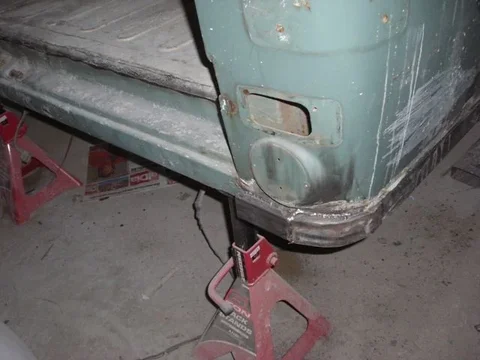

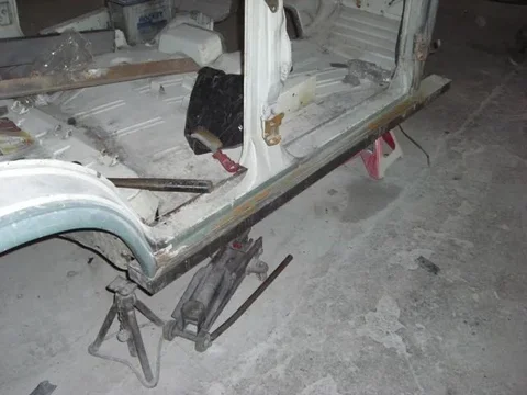

the resto process is goin slow, new job no time to get into, and the guys from the body&paint shop are also to I hope i Will get the paint job done by the end of the month, well at least still goingCIMG0319.webp

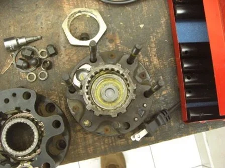

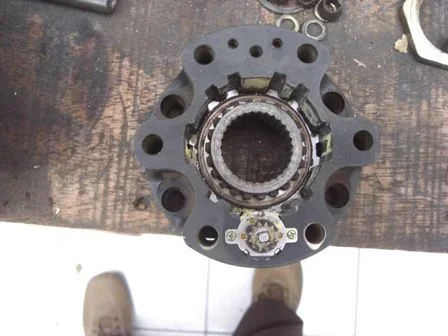

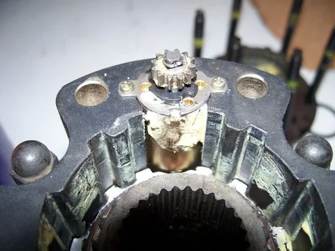

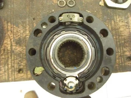

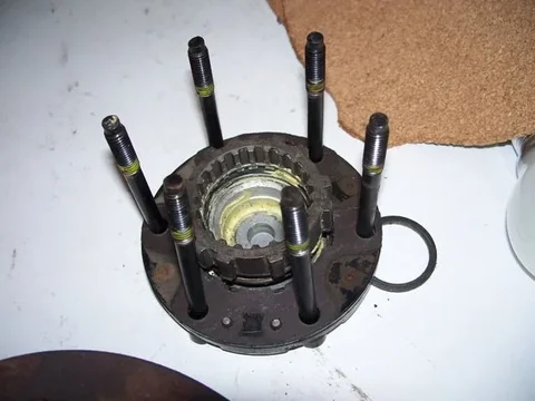

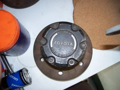

hi All, yesterday I went to get new birfields and hubs for my pig and y have purchase this hubs (impulsive fool)
They are electric activated hubs
and to be honest this is the first time that I see that kind hubs on my life and if one of you knolegeble guys have some information about how they work properly I will apreciate CIMG0338.webp
thanks

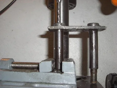

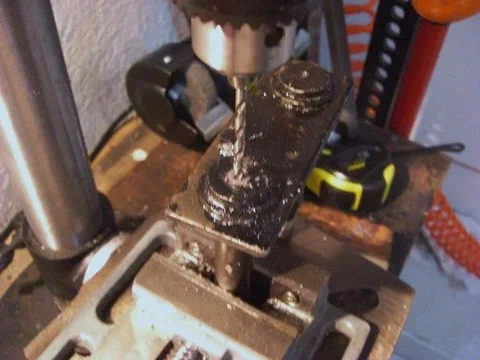

ok back to work, on the SOA that i am planing to my Pig i want to use as much OEm part as I can, when i was taking out the front axle I check the shackles and it simzs to be that they are no wormout, as I tough
takes a little time to drill the hole and change the old shackles in something that you can really reuse

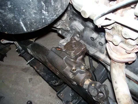

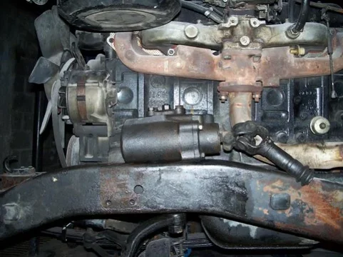

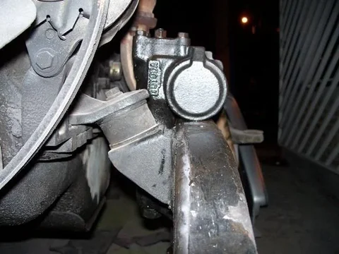

and here the first steering locations ideas
this is a BJ60 steering box japanese version (right side) I have found that location is a little far back but very clean and easy to install the only thing is we have to move the bumpstop 2 inches back

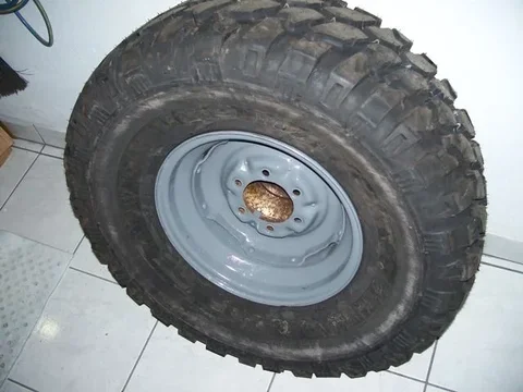

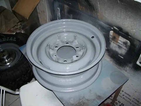

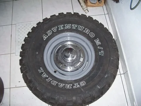

today I have finish painting the rims of the pig, already put tires on 3 of them
I also need some help I am looking for 2 caps for the front wheel with the hole for the hubs, if some one has 2 that dont need, please send me an email to victor@eurobungy.com:cheers::steer::flipoff2:
