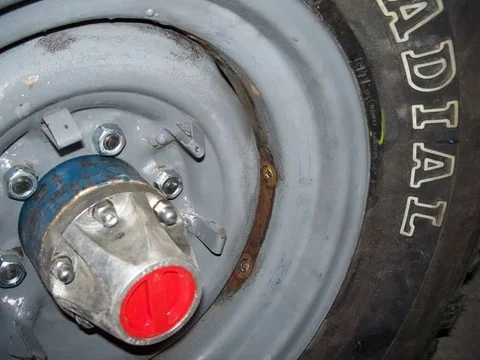

Those are totally useless and really just junk electric hubs which we would remove regularly and install manual units.
In otherwords without all the wiring harness etc you are going to need some cruiser hubs or mini truck hubs including hub housing.

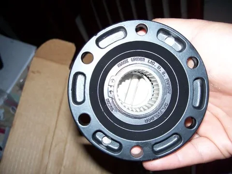

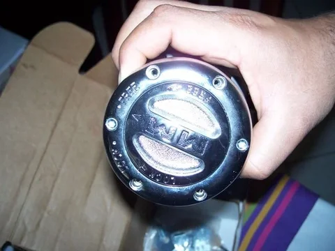

well guys, I giveup !!!.
with the help of my friend Sean from the Homegrowth Offroad in Miami, I finally get manual hubs, I will keep the electric hubs as decoration on my garage

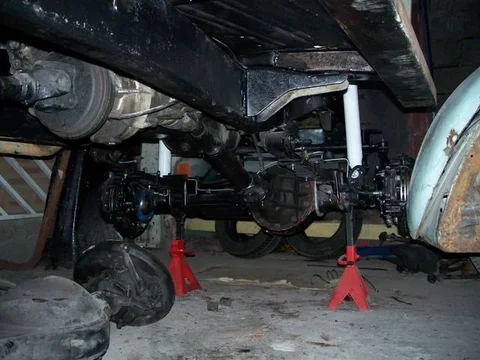

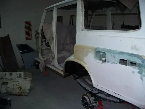

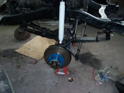

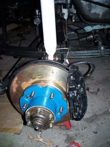

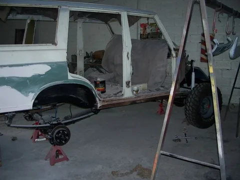

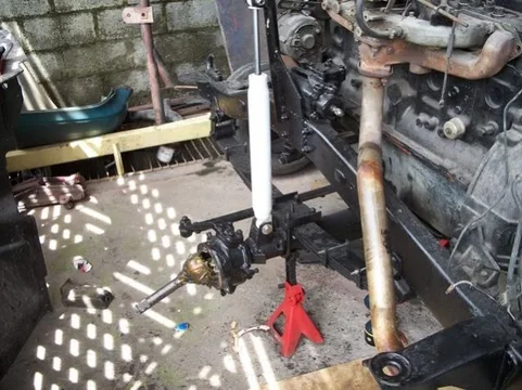

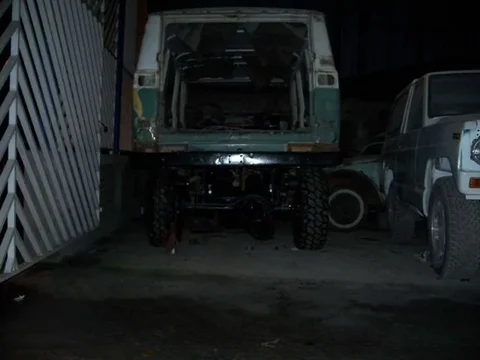

last saturday I was on the paint shop finishing the install of the fron end, I have the calipers and the brake lines left to install

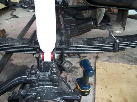

Rhino I learn from your tip, the shock tower extended and longer shocks look nice :cheers::steer:

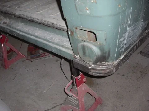

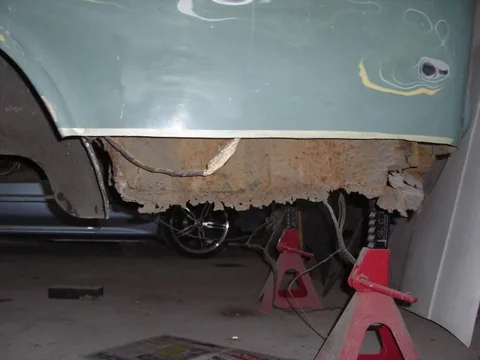

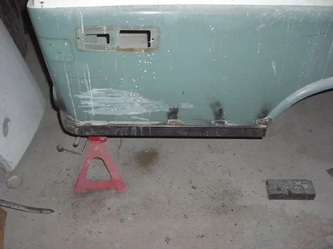

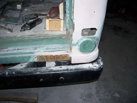

thats the photos from the prosedure to place the 2X4, ist really simple, an on my opinion, you dont have to use a very thick wall tube I use 2 MM wall tube otherwise if for some reason in the future you have to change it It will be not very hard and is also a good way to get clearence and also look nice
first cut the bottom I have used the window frame egde as reference
after that do some tack welding
and finish the job
before I have started with the cut and the welding I make a ¨L¨ tube and the round corner and the longer side of the L should be 2 cm longer than the body ( it provides a littlte protection but it is easier to install that way

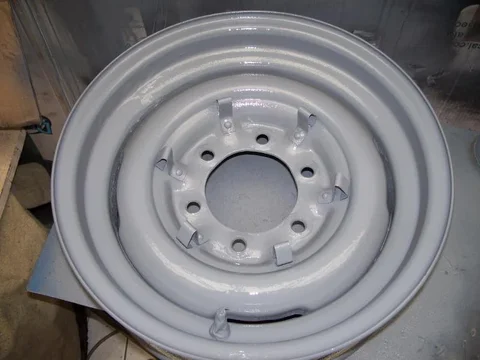

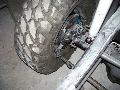

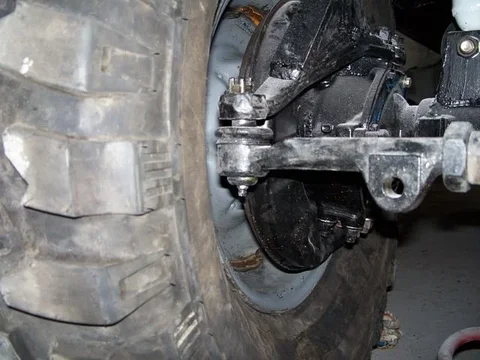

well friends, back on work I had some issues with the OEM rims and the new Calipers and the tie rods, and I finish sending the rims to the rims shop so they can move the centerhub further inside in that way the rim descreases de back spacing like 3/4 inch good enough to fit nice

hi well... the Rim shop was as little glich on my behalf it was the wheel repair shop, and about the bright colors ,,, I really hope at the end of the paint, my pig doesn´t look like a "big green taco con natilla" thanks for your support :flipoff2::cheers:
hi Rhino, the green I whant is the like the olive green but not too dark like pig on the photo I have also purchace a galon of ultratuff in olive green for the floors and under carriage and the chasis on black
