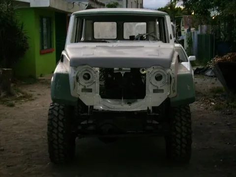

hi, finally I started to see some color

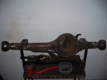

Yes, I did actually that is a FJ60 axle that I cut to the lenght of the fj55 (or FJ40 which is the same) I turn the alxe like 3 degrees positive, but what best, at least to me, is do the cuts for turn, assambly the housing in the car and set the pinion angle tac weld the spring pads, and afther that set tha caster angle to 0 degreess and tac weld the rest take the housing off the car and complete the welding on a nice table like this one

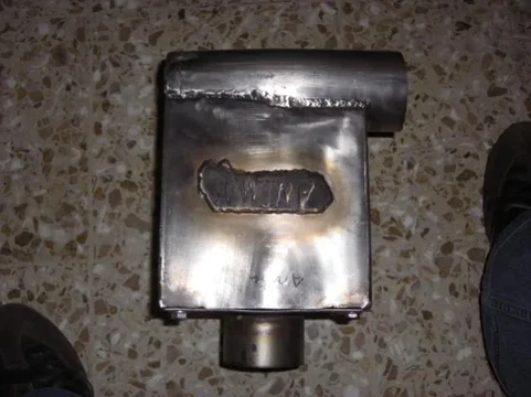

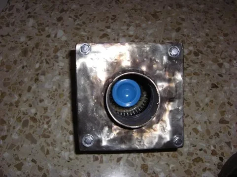

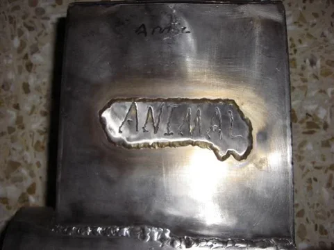

a couple of days ago I finish the intake filter, after too much welding, I have made it of stainless steel (I dont know why!!!),but I think looks good, I will tell next week

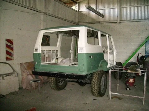

the little "chanchito" is almost ready to hit the mud........

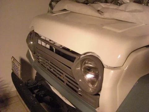

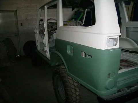

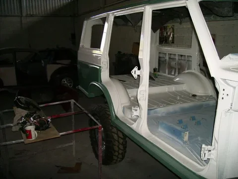

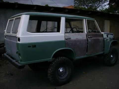

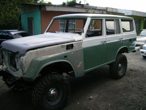

WELL!!! my pig just came today in the evening with the paint job all done, and the only thing is that one of the window machines is not there ,and fix the other ones, bleed the brakes and get the Pig ready to RTV in here in Costa Rica, if some knows where to find a right rear window machine for an 75 pig, i will apreciate any help, I still have a lot to finish but I am very happy with the work that the paint shop made on the piggy
Victor; your piggy is looking very nice.......keep the pix coming:beer::cheers:
Victor, my spanish is not good, but here I'll try:
Su cerdo parece maravilloso!
I think that says "your pig looks wonderful"!

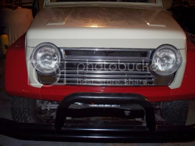

But your paint guy did the same thing to your front valence as mine...it's suposed to be white on top along the lines of the fenders.
But it is supposed to look like this:
Your spanish is great, well i didnt see that until you pointed , I think on my case the guy at the paint shop was so hurry about finishing the pigggie up , that they just paint evering with out taking care about that detail, hehehe funny, at the end of the history you will not notice after the installation of the winch
