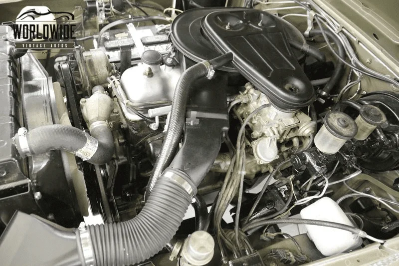

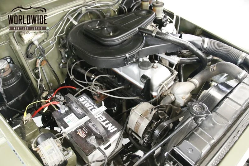

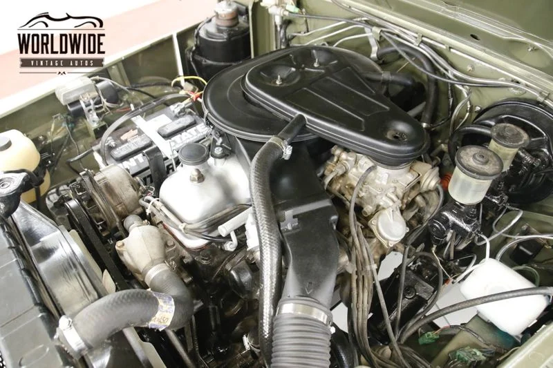

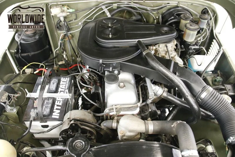

I'm pretty new to this world so forgive me for my ignorance. I'm in the final stages of purchasing an 1976 FJ 40. I live in California so I have to abide by the states emissions standards which makes me very worried. I've posted some pictures of the engine below. From what I understand it was a total frame off restoration. I know it doesn't have a cat converter because it was pre '78. The company I'm buying from says that it still has has air injection pump, and manifold system, with charcoal canister. Is there any hope that this thing would pass or is it 50/50?

thanks pjohnson. The car is coming from Colorado. I doubt they would provide that certificate. A mechanic just looked at photos and said all stuff is there and it should be okay.
It looks like you're missing the carb stud, grommet, and butterfly nut.
It's for the hole directly over the carb on the air cleaner assembly.

Isn't that a vacuum transfer case module on the firewall?
Interesting brake master cylinder.
edit: minor stuff, but I looked at worldwides website. Don't see fuel gauge or oil pressure needles. May be missing or not functioning. Something to ask about if you proceed.

The photos of this truck are flip-phone-ish.
I could be wrong, but that doesn't look like a Nippon Denso coil and igniter?
It looks like it might be missing the EGR system?
There is probably no hot air intake, because it mounts to the heat shield missing from the front of the manifold?
My photos aren't great either. You can see the EGR valve on this engine next to the secondary diaphragm on the carb. The EGR cooler, and line from the back of the manifold is hard to miss.
I have a Jan 76 FJ40 here in California. Even if it passes the emissions test it still has to pass the visual inspection which means all smog equipment has to be installed. The biggest issue is the heat shield on the front of the manifold. Very difficult to find . Cheap to buy though. The EGR system is widely available. Just remember, all of these parts are 40+ years old. Personally, if the price is right, but it
Sounds like a big gamble, especially for the pretty penny I’m sure you are paying for it. Probably better to buy in CA and make the purchase contingent on passing smog. Even if all the parts are there, it doesn’t mean it will pass.
To me that looks like an expensive road to pass. If I recall correctly the 1976 has a one year only eve exhaust part? The vacuum box on the wheel well looks like it was rattle canned black over the decal to see where the vacuum lines go. My guess is it will need a lot of hard to find parts to pass

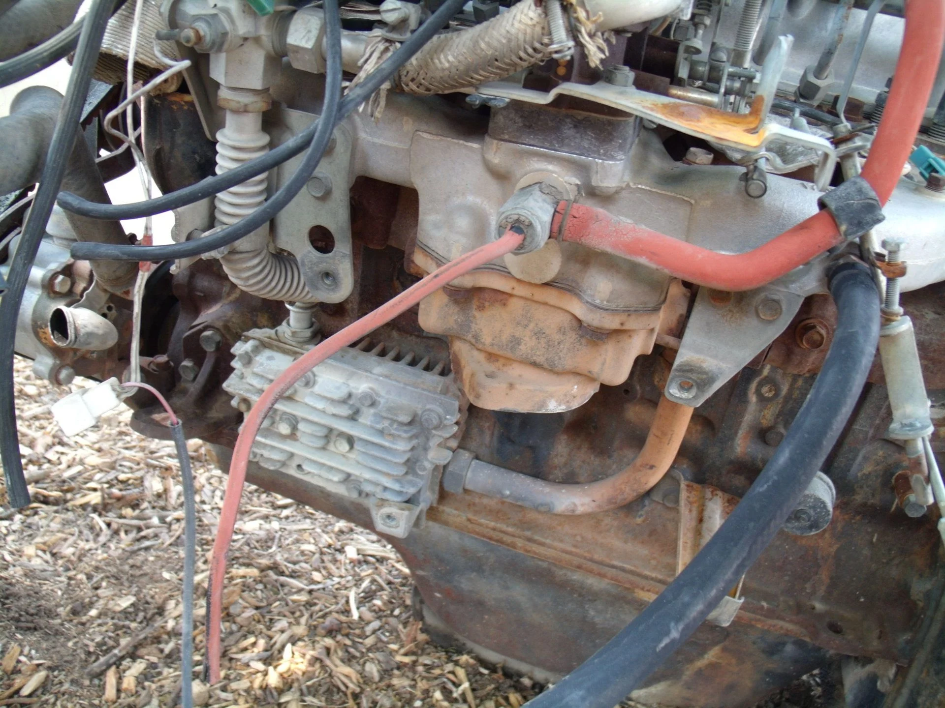

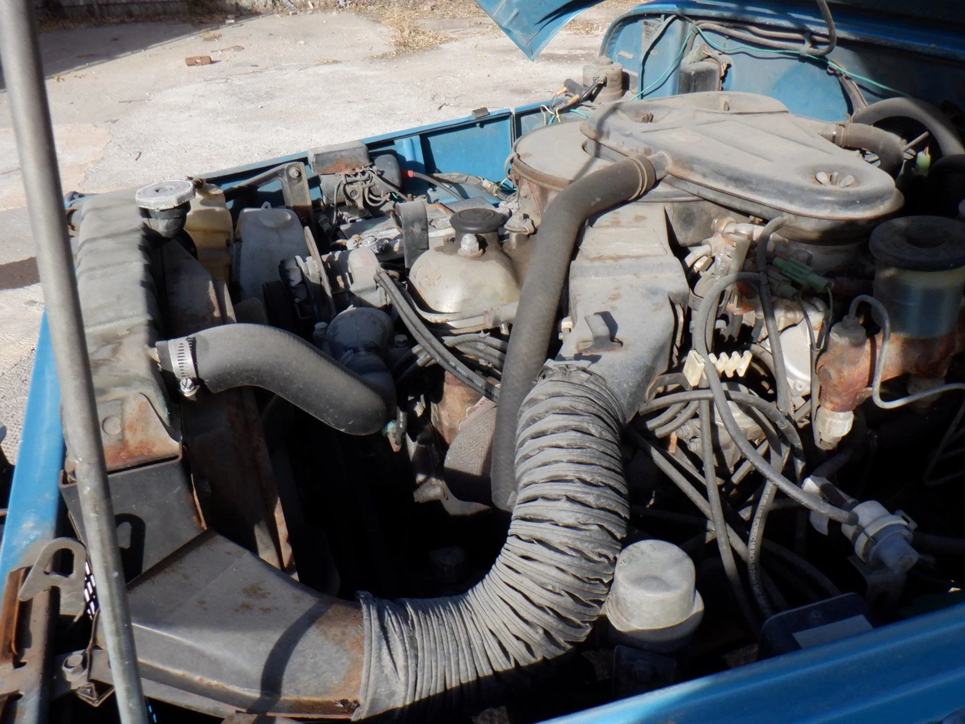

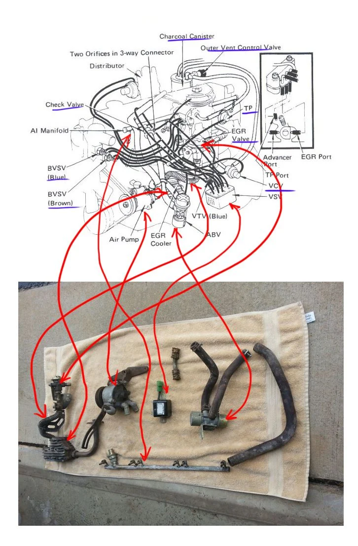

I just bought an out of state 1978 40, brought it into CA and it passed first time (not sure how though). I rolled the dice based on the pics below, but mine is nowhere near as nice as the rig you're looking at (my engine is pretty much original though). Not sure if they help, but here are the pics I based my decision on (as well as a photo I borrowed from another member that outlines each part).
Good luck on the decision. Not sure where you are in Socal, but I'm in Simi Valley if you want to take a look at my 40's emission equipment for comparison purposes (or if you want a referral for a smog mechanic).
Thank you. So are you saying mine is missing a heat shield? Is it supposed to have a hot air intake? Nippon Denso coil? Wht's that all about. Thanks for your help

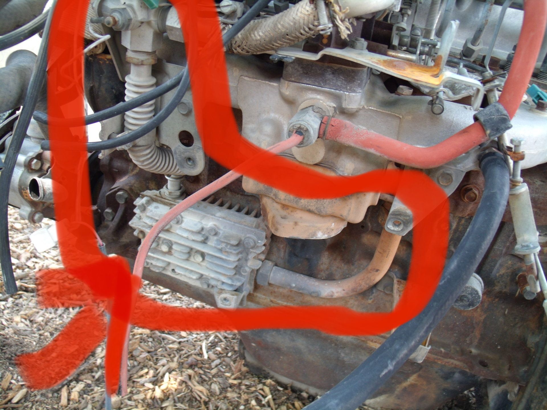

Yours looks like it’s missing the most vital and hard to get part the EGR system. A closer pic of the exhaust pipe connection will tell the story..
Circled in red are the major parts of the system
