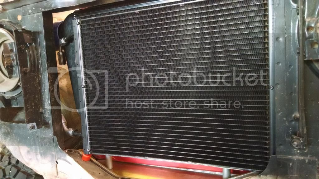

It came from Restomod Air. http://www.restomodair.com/shopproducts/restomod-ac-condenser-11-1044-size-15-58-x-20-½-x-1/ It wasn't a part of any kit. I just picked one that would fit, maybe a little too big.
Hey Ron, havent been around for awhile due to spending lots of money to make very little progress ;). I'm getting back on track now and ordering the restomod vapir this weekend. I noticed the post above and was curious, what size condensor would you pick if doing it again?

I used the #1044 http://www.restomodair.com/shopproducts/restomod-ac-condenser-11-1044-size-15-58-x-20-½-x-1/ and it fit alright, I just wanted to get the largest I could. JMack's is a little shorter in height and would help fitting it under the hood latch. Both of ours are modified applications, as far as where radiators, etc. are mounted, so yours might be different. I also had to drill a hole for the lower hose to go through the doghouse support. It looks like JMack's will miss that.

Thanks for the info on the condensors Jmack and Ron. I think I'll go with what Jmack picked since it seems to be a better fit.
