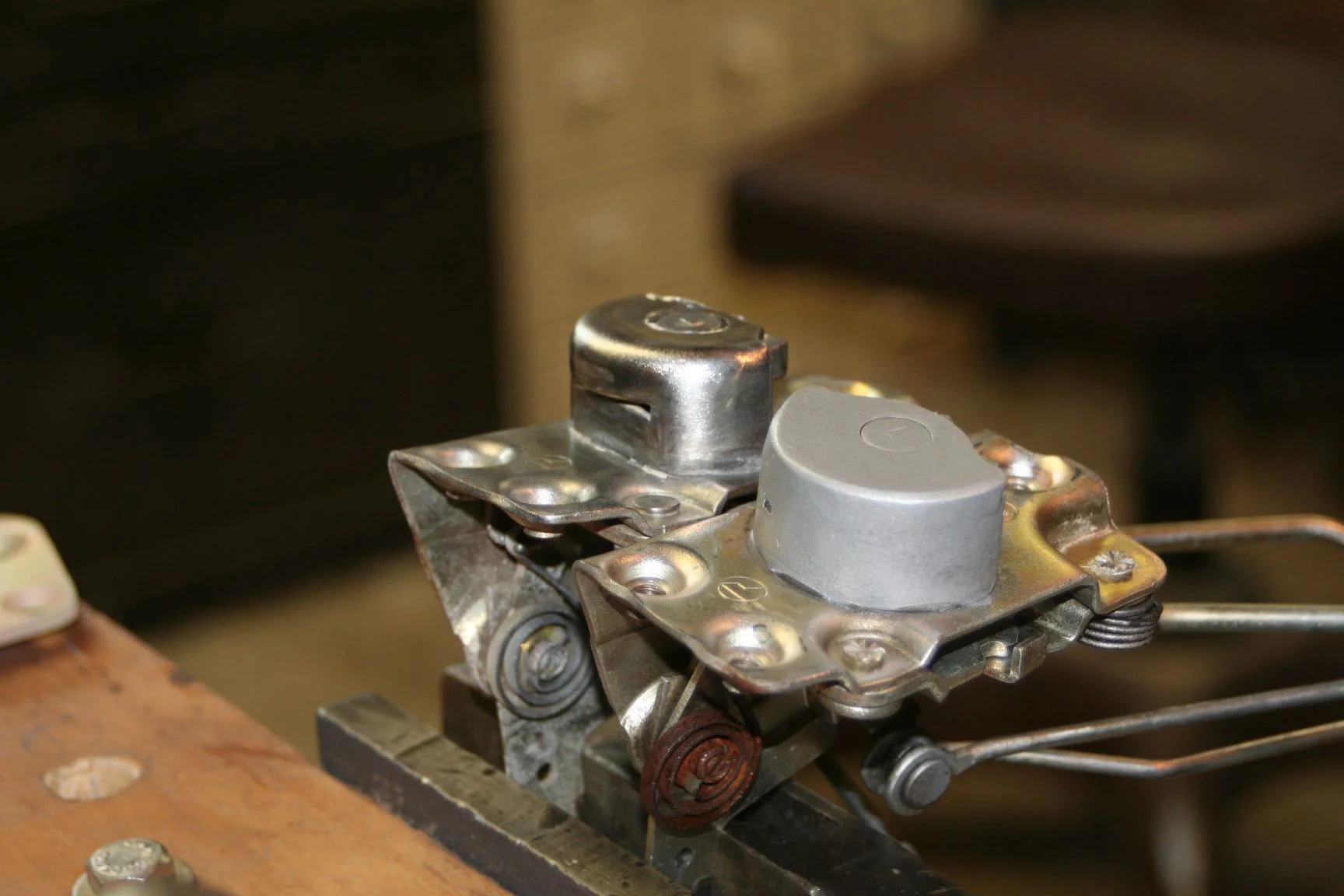

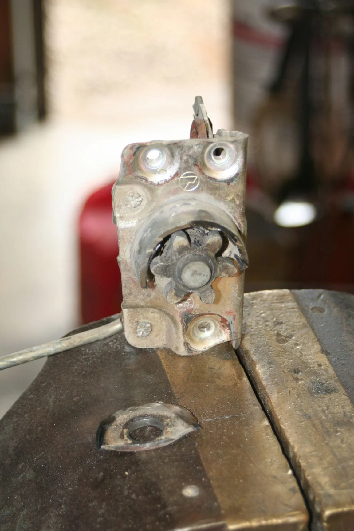

I'm going to post this here, so next week I'll know where to find it. A big thanks to Roadstr6 for lighting a fire under me and getting it done. On this last trip my door started to act funny, the little star wheel (gear) isn't spinning as it should. This Winter I'm taking apart the front doors, so thought I'd replace that whole inner mechanism. The ones I have in stock are in need of repair such as Roadstr6 posted about. As always with me there will be something not right or go wrong and I learn a good lesson from it. I picked a driver's front (which all four doors are different, you can't inner change them) and rebuilt it. All you need to do is cut the front off,make a new piece and weld it on.
Here is a pair of fronts left and right, I rebuilt the one the right.

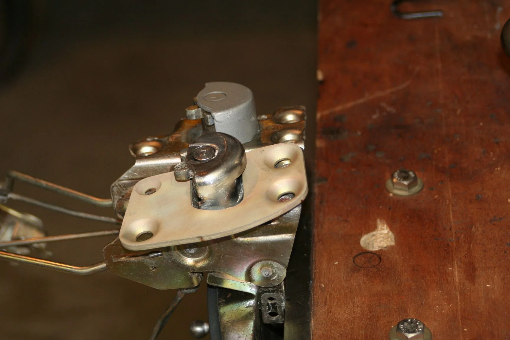

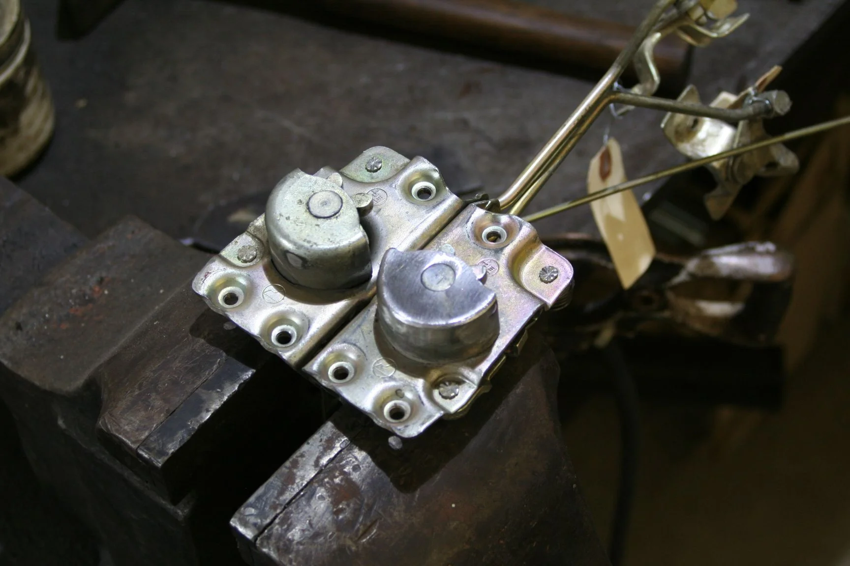

Looking at my driver's door I noticed a different looking mechanism, here's the difference, these are both driver's front...
The one on the right is the one I fixed and the left is like what I have in the door. One has a cut out (flat area) that the striker plate fits into.
I believe all mine are from 71 and 69 year vehicles, not sure what other years look like. So it looks like I'll be fixing another one to match what I have in the wagon. Each door has it's own part that can't be switched with another, so welding in a new piece is the answer.
