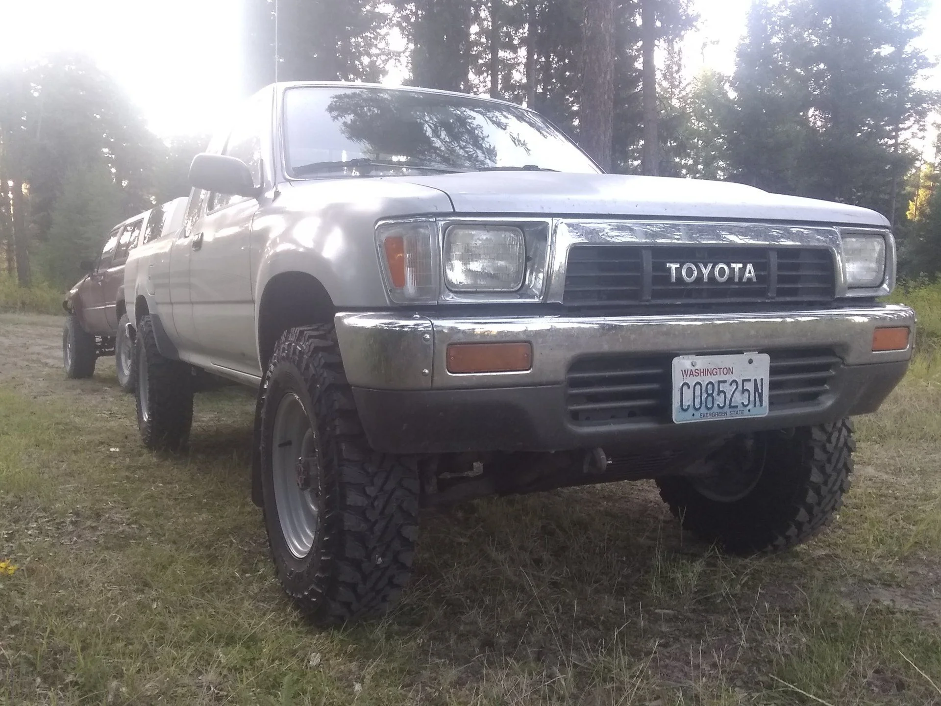

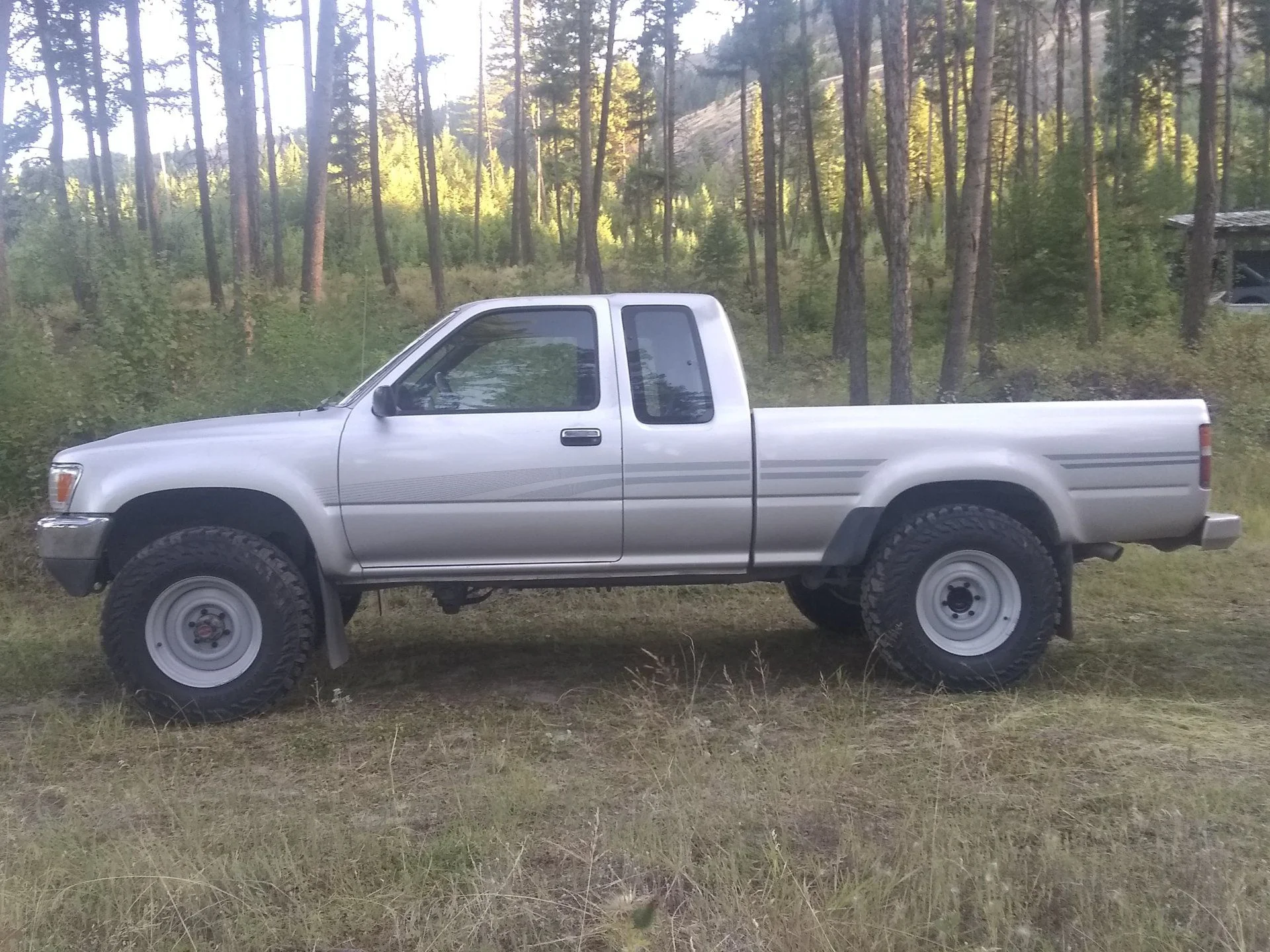

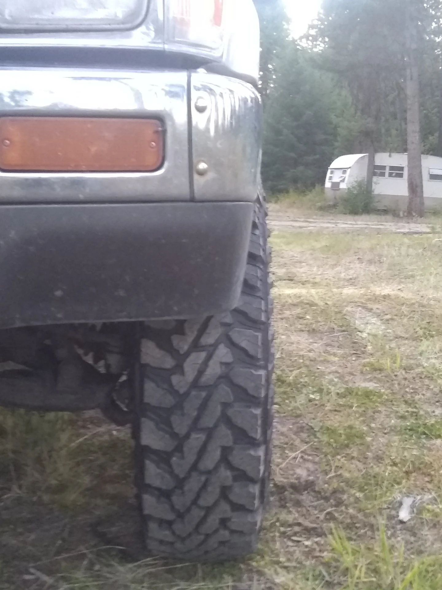

I'm running some of the Summit smoothie 16" steelies with a 235/85 R16 Yokohama Geolander MT's, I'm really happy with them, and like the tall skinny look...

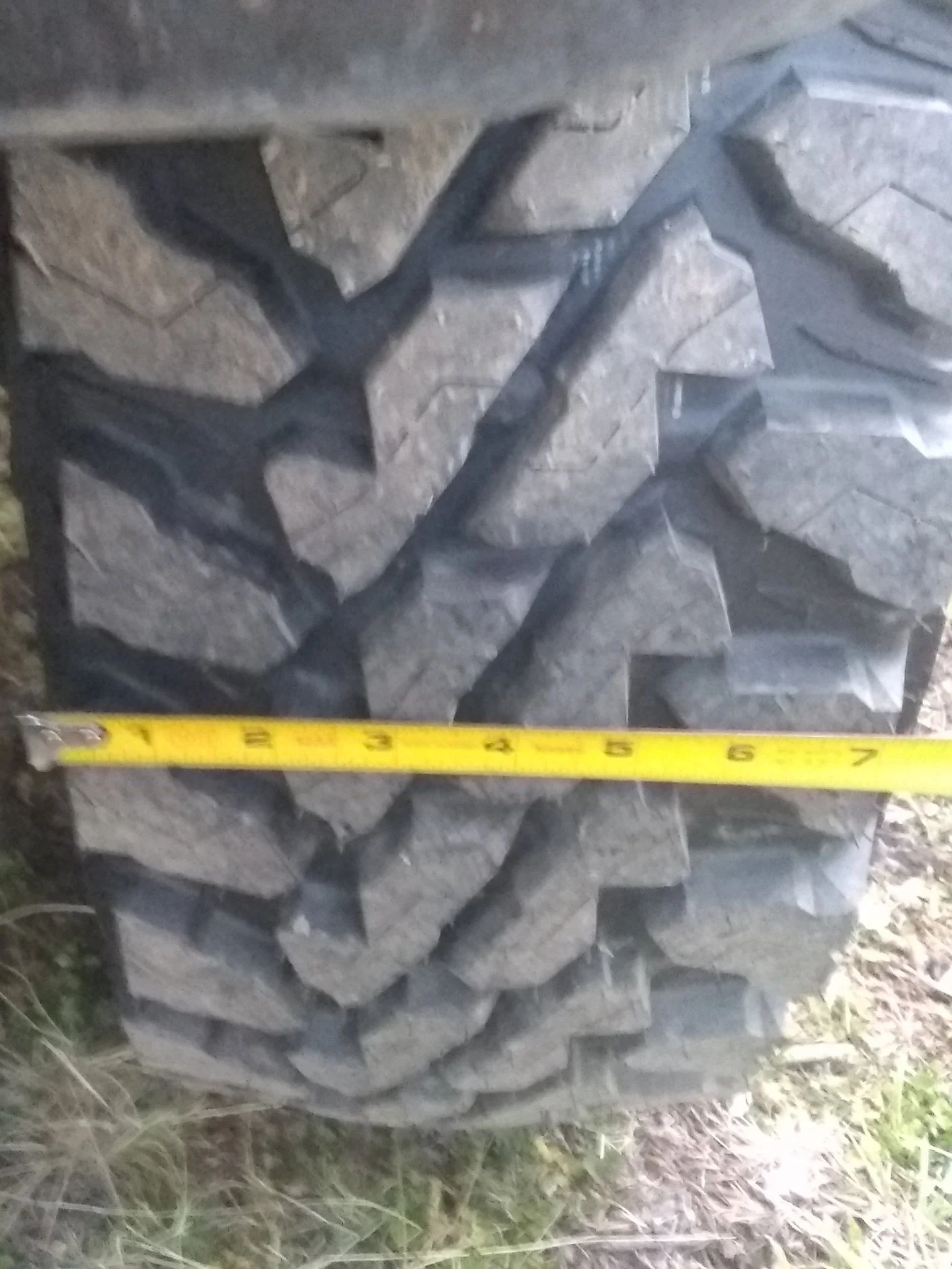

Will be just like the ones in the link. I have 235/85r16 duratracs on mine with those rims.
I also have a set of aluminum rims 8 inch wide with, -19mm offset, I think that comes to 3.75 inch backspacing. I think anymore and you would need spacers. But the rim still sits .25 closer and 1.75 further than the stock size but everything still fits in the fenders.
