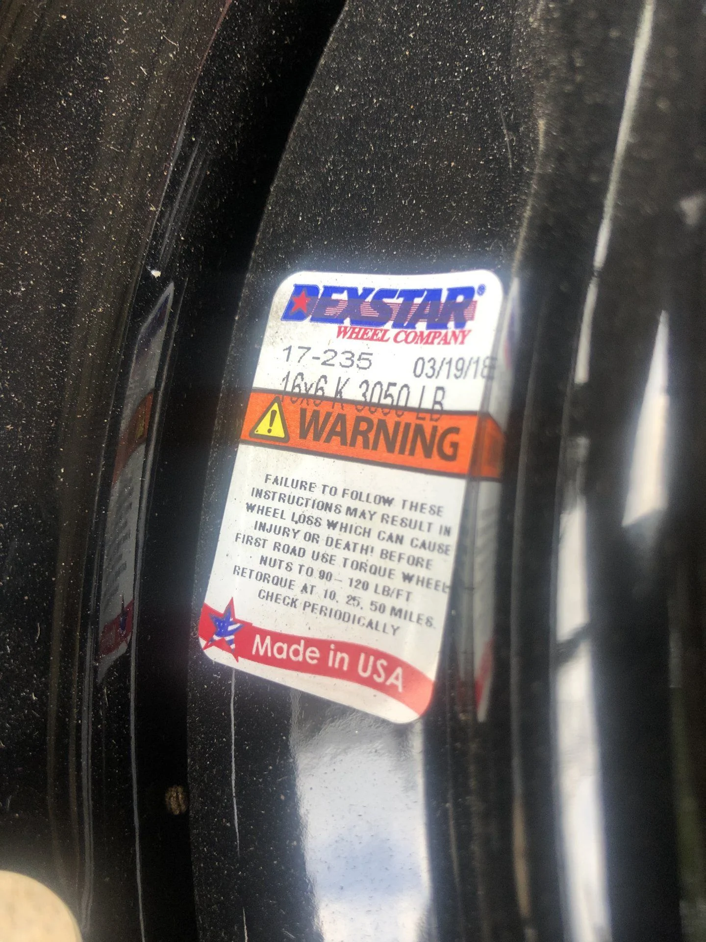

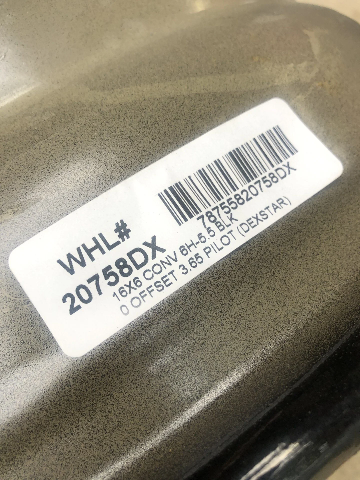

Last set....., first I’ll discuss.....generic 16x6 steelies
Feel free to toss in your steelie tech

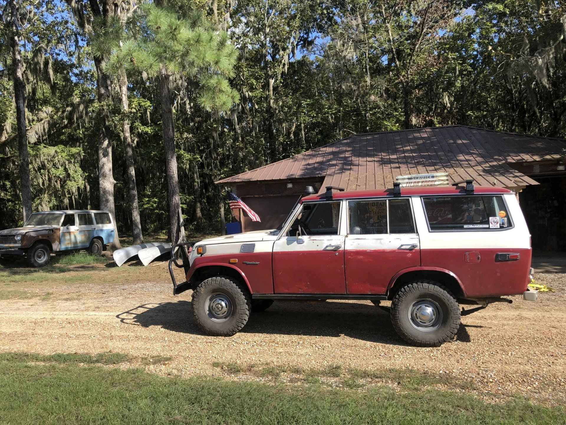

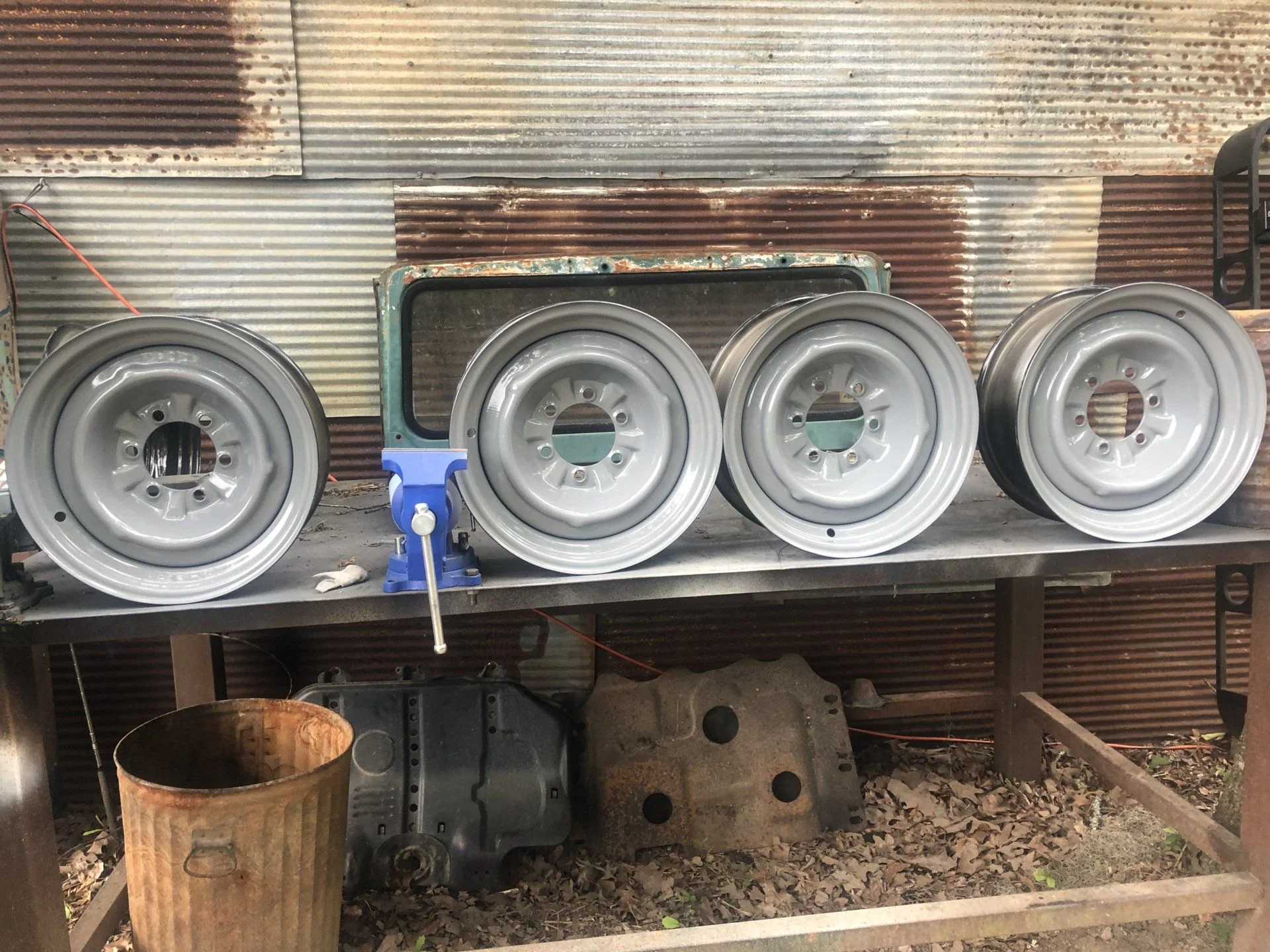

Last weekend @Bossman showed up at the CottonLand Campout with a new-to-him Troopy with some really cool steel wheels that “looked” to me, just like split rims
I started messaging the prior owner about the wheels and I pulled the trigger on a set of 5 from eTrailer. I ordered on Monday and they arrived Wednesday. Price is right.

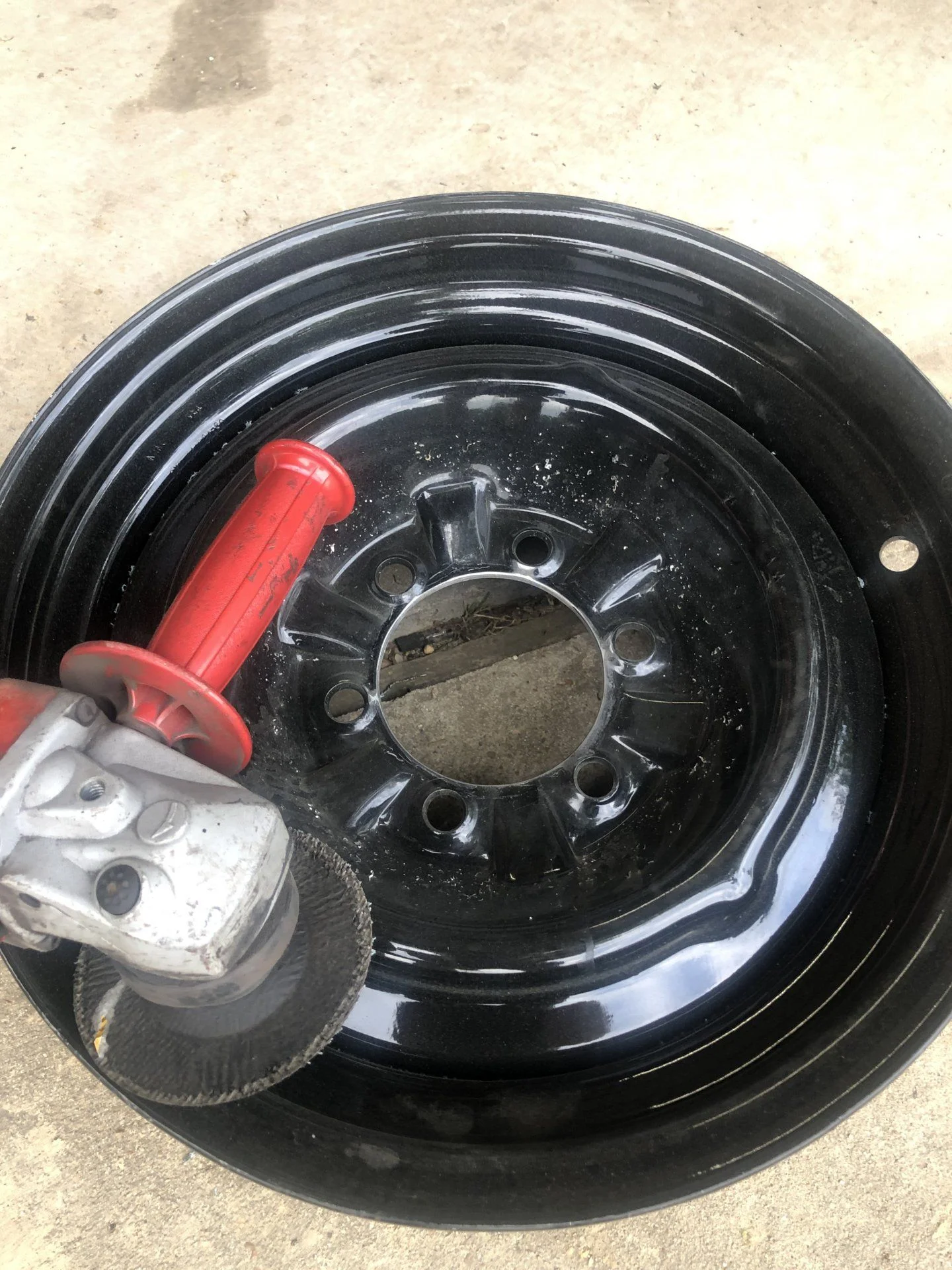

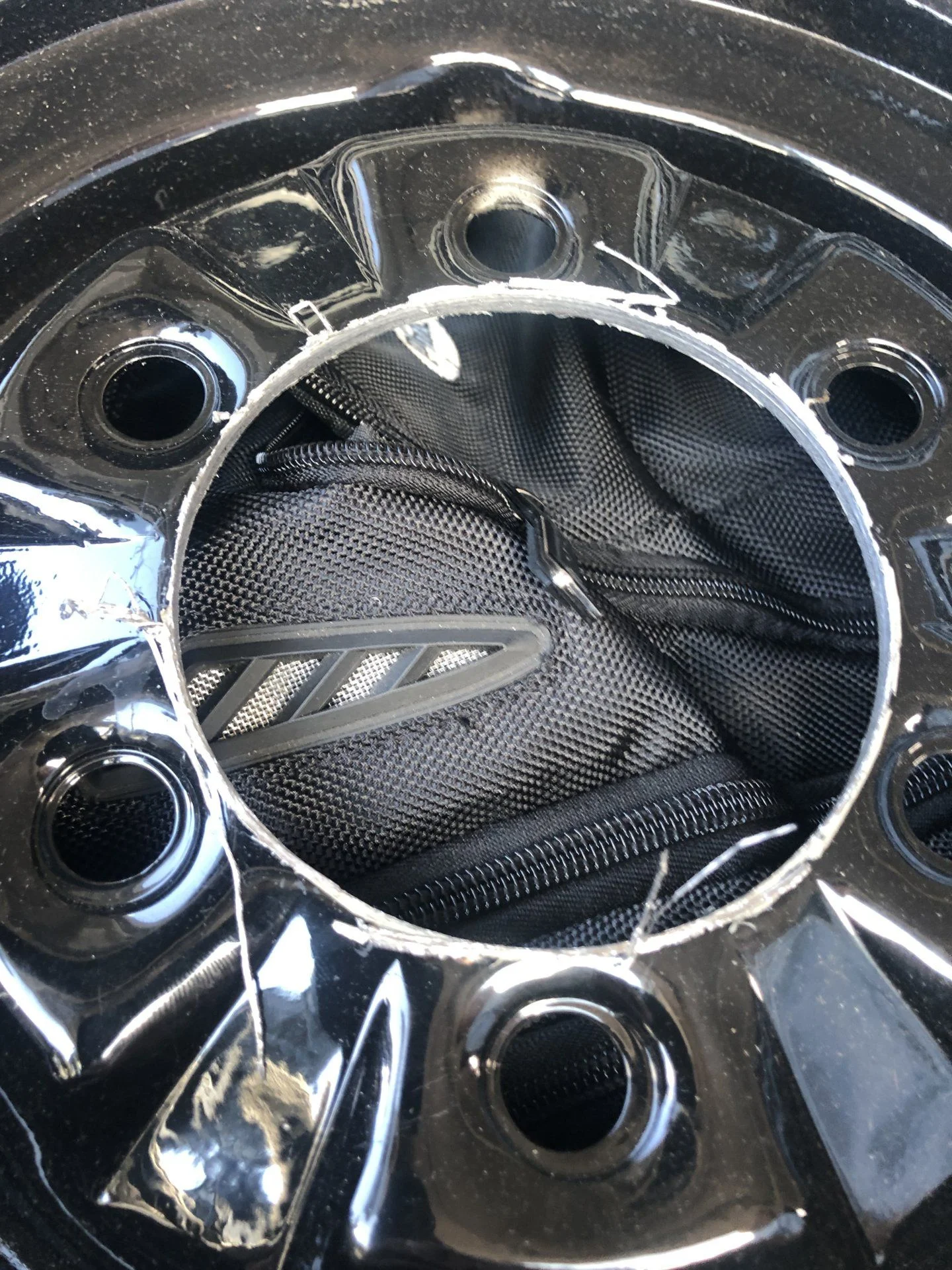

The only problem with these wheels is the bore is too small. 3.65” pilot and the Cruiser (fronts or full float rear) need 4” pilot
So, easy fix......drop them at my local machine shop to make them 4”
I smoothed them out with a flapdisc
Edit @island45 says 4.25” is a better bore size
Machine shop charged me $25 per wheel.

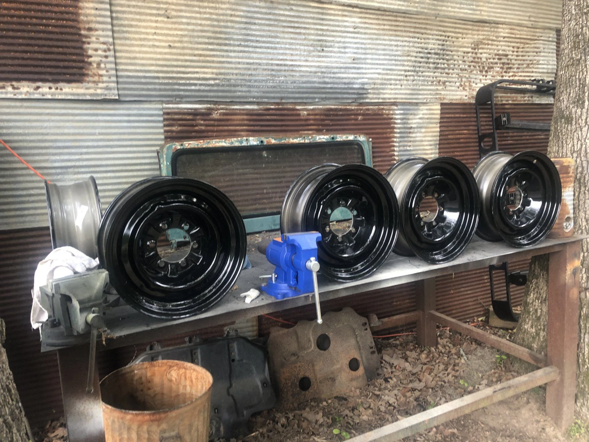

Time for paint. This is my go-to OEM wheels color to match 69 and up OEM steelies and splits
Clean em and line em up
Front side done with 2-3 coats with one can. I plan on doing the insides as well. Just need more paint

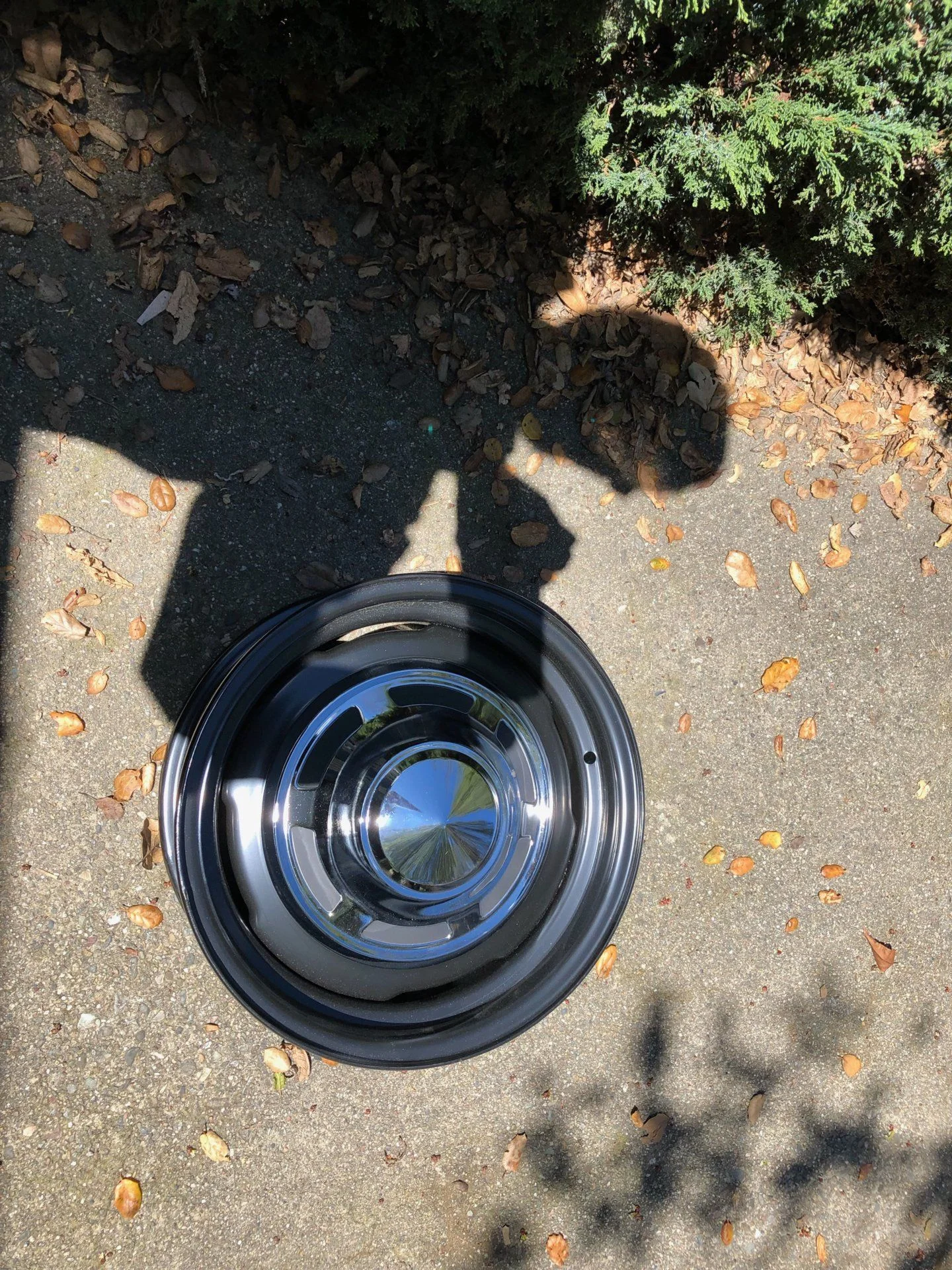

OEM Splits.
These things are cool as hell but most people around here are scared to death of them.
I traded my set off to a crazy Marine that worked on them in the military that had zero fear.

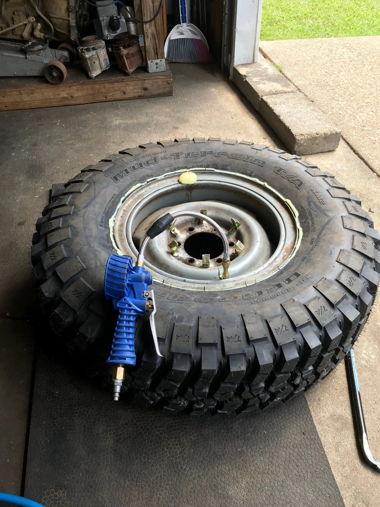

With these, if you want hubcaps you need to buy and install clips. @Racer65 sells them separately

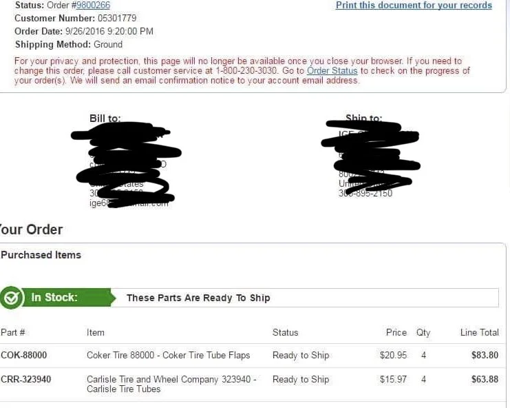

Also, you need tubes and liners for them.
Here are @USMC22 that he put 255/85-16” KM2s on.

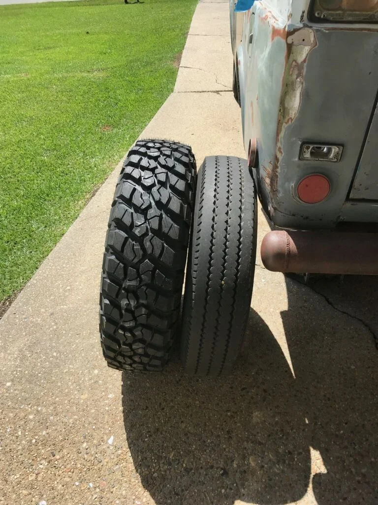

Excellent info. I ran 16x6 trailer wheels (white spokes) on my 62 for a long time with 235/85's. Never saw the "steekie style." I am going to have to get a set of those for my '61 40. Lots of haters out there concerning trailer wheels, but the load rating is more than adequate and they have worked great for me.
One such debate. There is absolutely nothing 1/2 ass about these wheels. They are heavy as heck. If they balance I’ll be fine and I’ll know that soon.

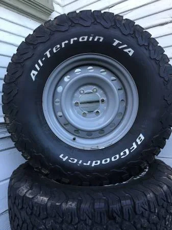

Cool, thanks OP I’m a big fan of steelies always have been. The appeal for me is that they are oem, they look tough, and foreign models always seem to have them. Dad and I went with the OEM 15s for the ‘79 because they were half the price of City Racers and we are going all stock for the resto. I would have liked 16s but I’m content with BFG A/T’s in 33/10.50. Still tall and skinny and I’ve always been very happy with this tire on the 40, run them in all conditions for years and never let me down.
The 92 will be getting a steelies retrofit soon as my bigfoots wear out. These came off a tundra, somebody powder coated them. Removing the tires revealed a nasty bit of rust inside. So elbow grease then POR 15 it is before mounting some tall skinnies (255/80/R17). Such is the plight of the steel wheel owner :frown:. Sweet Toyota caps on em too but I’m not sure they’ll fit the 80.
One tidbit I’ve learned is that the tundra steelies though bigger, feel at least 3-5 lbs lighter than the oem 40 wheels.
It’s amazing how many people are now going back with the OEM steelies.
Yes, agree, the 33x10.50-15 and the OEM steel wheels are a killer combo.
I’ve run them on everything from a stock suspension to a 3” lift.

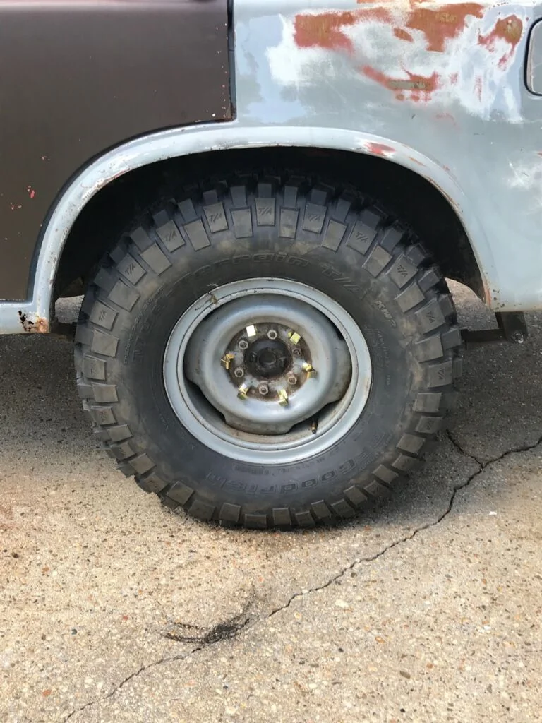

I run them on my Pig. Bought them from @beno and then painted them with Rustoleum Smoke Grey

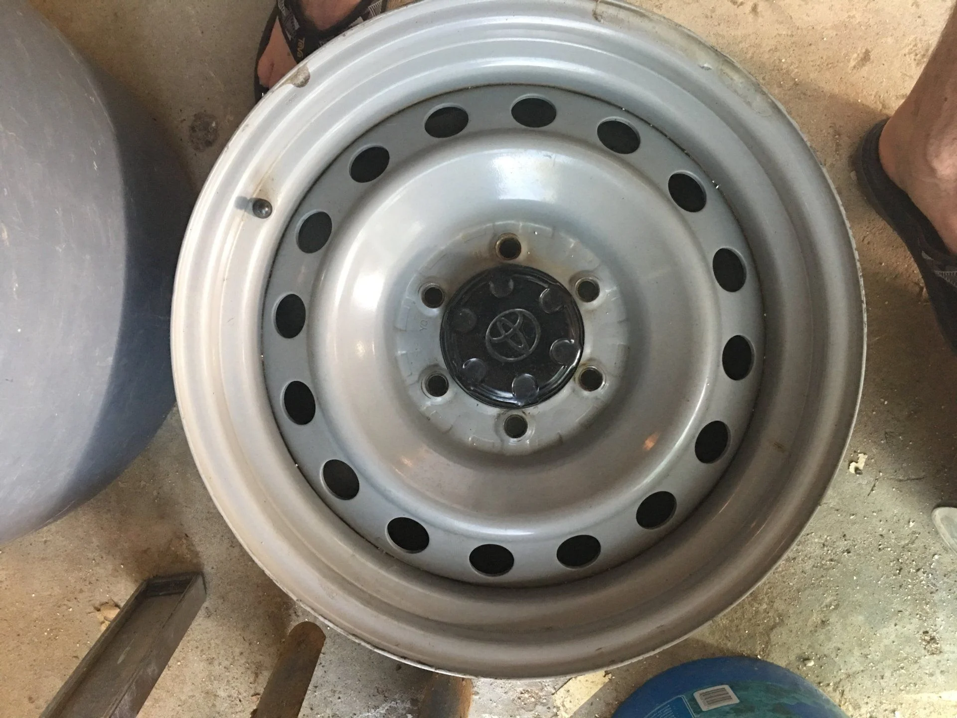

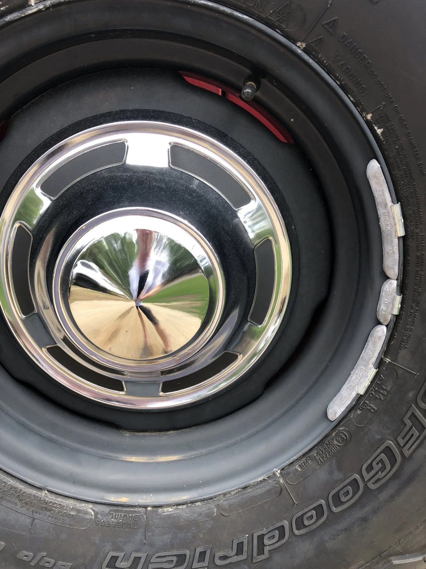

A couple of facts about OEM Land Cruiser 15” steelies.
E-75 the wheels were riveted together. These wheels won’t bolt directly to a later disc brake front axle without the rivets hitting the brake caliper.
76+ wheels are welded and have the proper clearance. All the new OEM wheels are welded.
The way to tell is to look inside the wheel. If they have big rivets holding the inners with the outer they are drum brake wheels.
Last note.
The black paint or powder on the new OEM wheels fades out fast. If you want to run them black, make sure you paint them first.

Nolan,
From where did you order the tubes and flaps? Don't see the company name in the attached picture... I have a set of 5 splits holding up the wife's '74 while it is being resurrected from a long nap in the pasture. They currently have 7.50x16 bias mud grips which I think means they have bias style tubes which won't work with radial tires... I'm planning to swap out to 265/75/16 radials that I took off my DD suburban that were at least made in this century.
