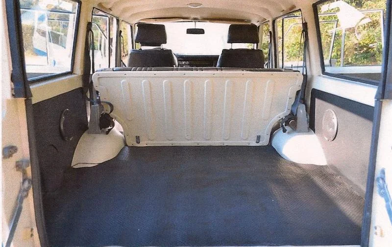

There is already a mount in the roof rail aft of the C pillar - very similar to the anchor aft of B pillar (over rear door opening) for the front seat passengers.
My understanding is that this was present all the way back to the '69 Pigs. Not sure why they were planning on 3-point belts then and not including them?
I may have a picture of this...
I was just driving our newer car today and noticed that the pivot point for the shoulder harness is even with the front seat, pretty close to the position in the photo that I posted.

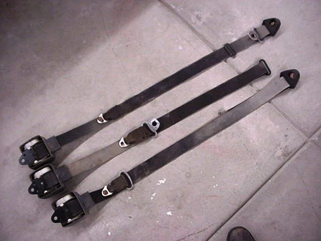

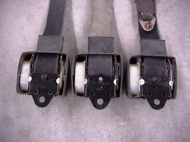

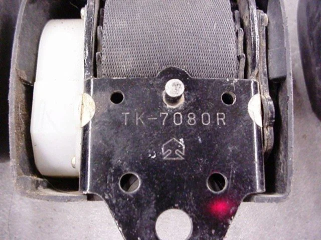

Here is what I have, all three part numbers end in "R" and it looks like the shoulder mounts are all for the passenger side.
View attachment 411854View attachment 411855View attachment 411856
Going back to this question - can anyone eye their original retractable belts and tell me if they have a L and a R? Are the retractors all on the same side, regardless of what side of the Cruiser it is mounted on?
I have these 3, and all the retractors are on the same side. Wondering if these can serve in either side of the Pig?

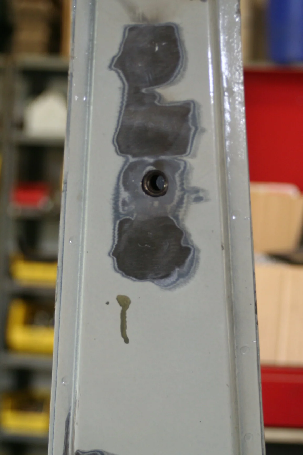

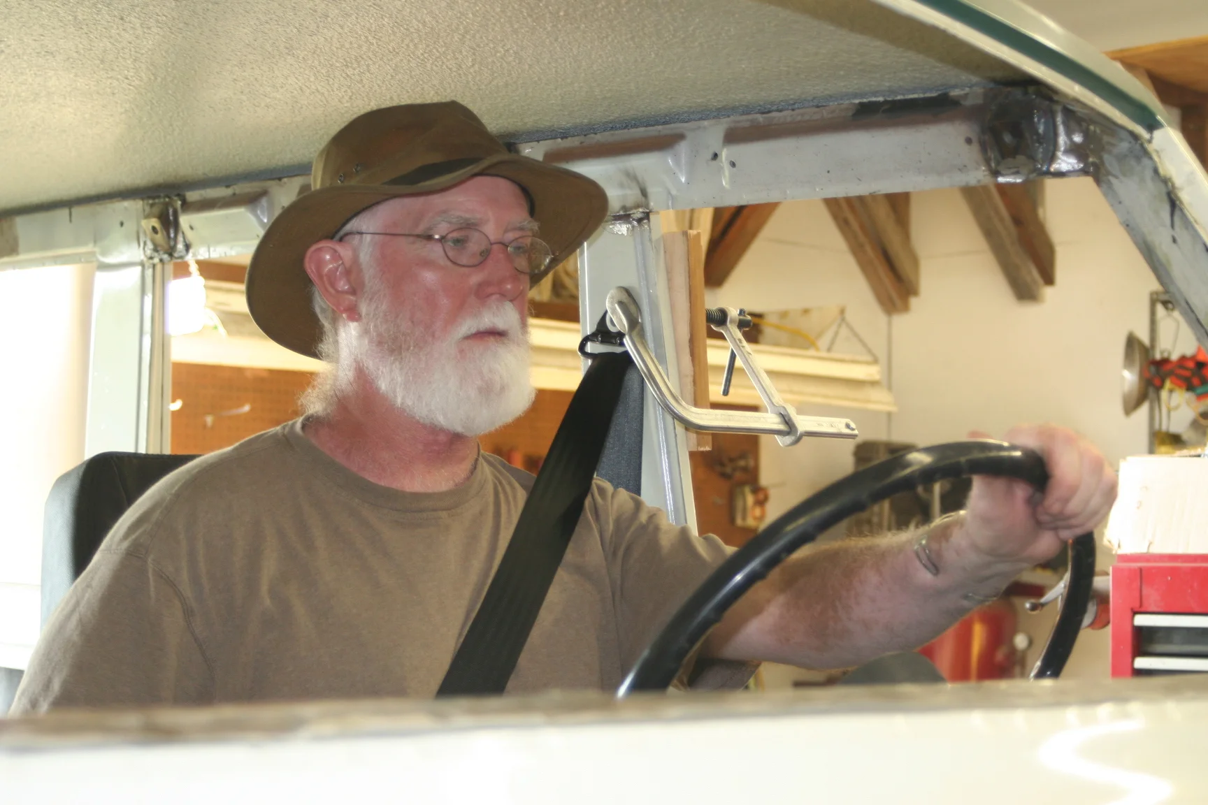

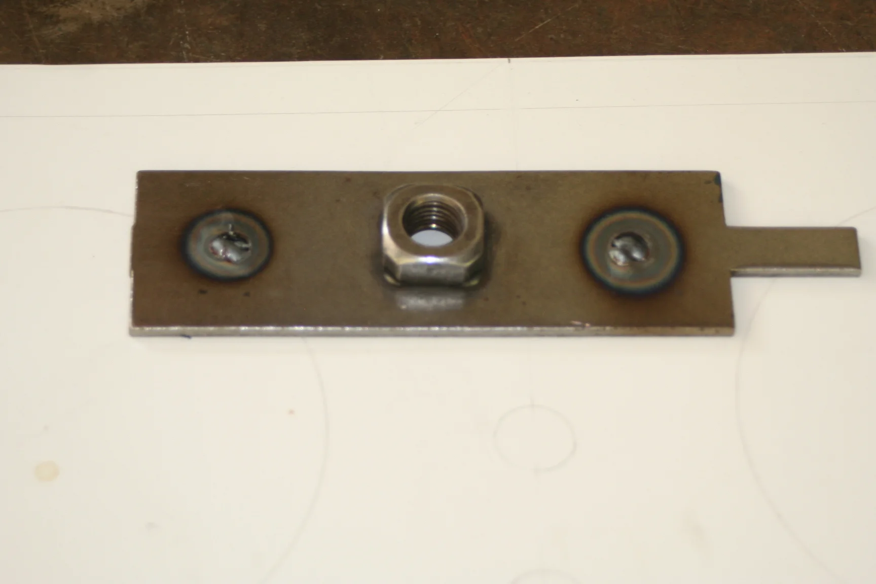

I believe several have installed three points. Here's what I did.
Backing nut for the third point.
Welded it on the B pillar where I wanted it and had to pull the nut up from the bottom with a wire.
Right about here on the model. Don't mind the ugly mug, he's just a hired hand on the farm.
I did the same as @scrapdaddy did above. In my build thread there was some further discussion about the thread size and pitch of the seatbelt bolt going into that plate, and what size and thickness it needs to be.
The takeaways are -
Factory bolts I believe are 11mm 1.25 pitch, not easy to find a good variety of hardware in this size.
7/16” – 20 is virtually the same and much easier to find. Just convert them over unless you have a specific reason to keep everything metric.
1.25 pitch = 0.04921 pitch in inches
20 Thread Per Inch = 0.05000 pitch in inches
11mm = .4331”
7/16” = .4375”

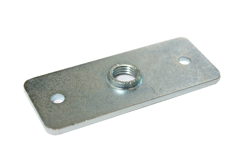

Get some 12mm x 1.25 and you'll be good.
When in doubt if I’m going to modify safety equipment from factory on a factory vehicle I’ll look at the guide lines of FIA or SFI.
SFI says Shoulder Belt Angle: 0 to -20° (-10° optimum) from horizontal
Seat Belts | SFI Foundation
I thought SFI said a seat belt anchor point backing plate should be fashioned out of a piece of 11-gauge steel with an area of about 6 square inches minimum but I can’t quickly find that info to post as fact so take it as speculation.
LOVE IT! I just need to find/sorce a set of these plates to weld into my pig. Anyone make these or have a set they want to sell me?
