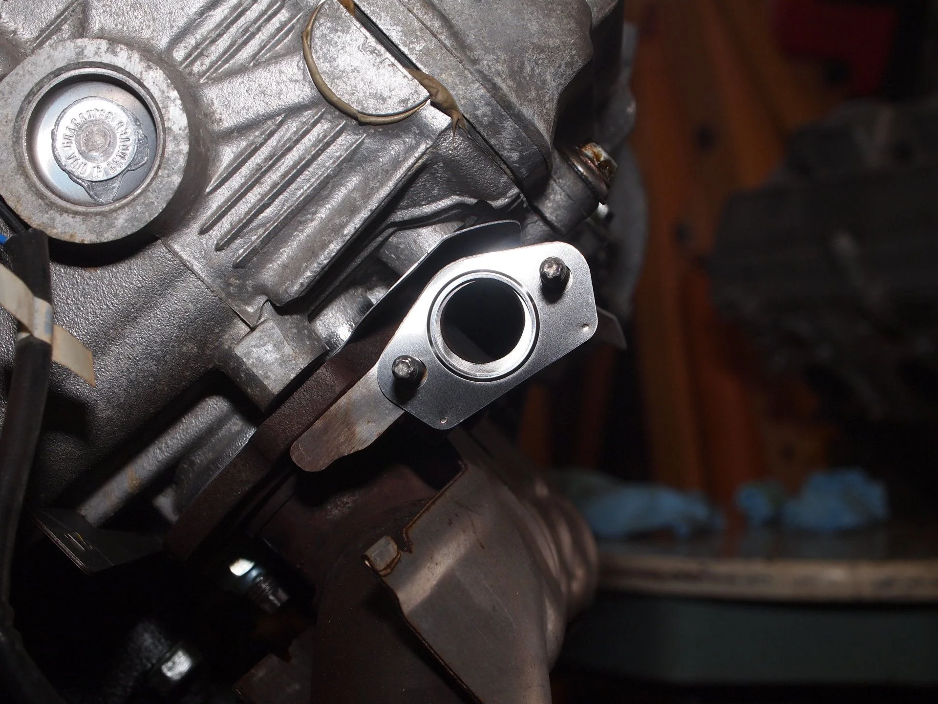

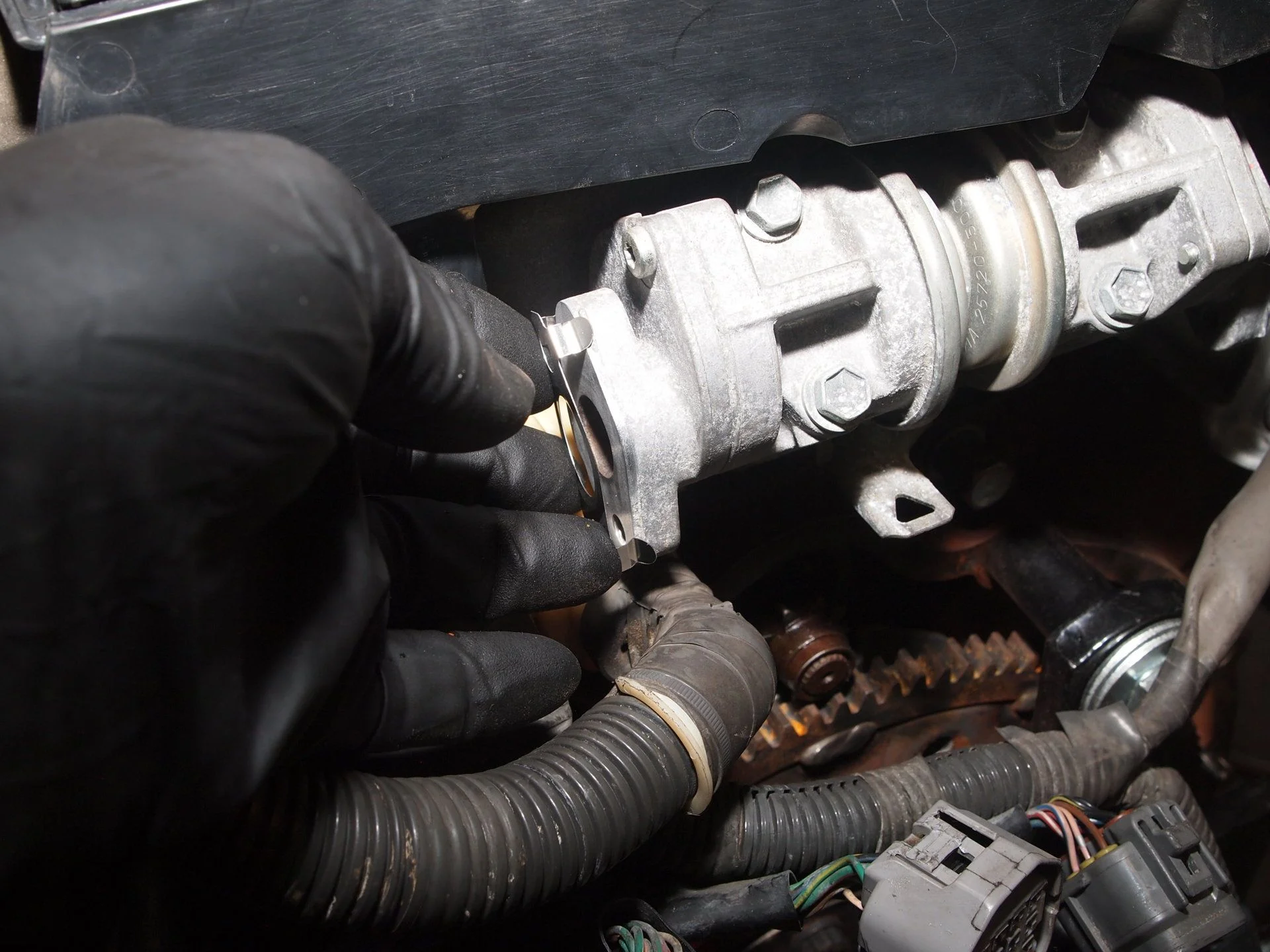

A. I. exhaust air tubes, LH & RH install.
A portion of the main wire harness (MWH) plastic housing sits behind the LH side air tube, so doing after MWH is a must.
These are the exhaust air tube found on the VVT engine. Some block off as parts of shutting done the Air Induction (A.I.) pump smoke system, I don't. I prefer keeping with Factory design.
I clean up mating surfaces in prep for new gaskets.
Then just install.
Torque to 7ft-lbf.

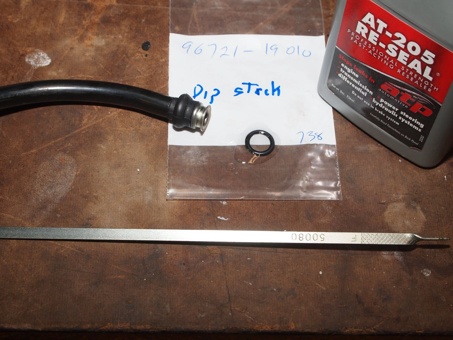

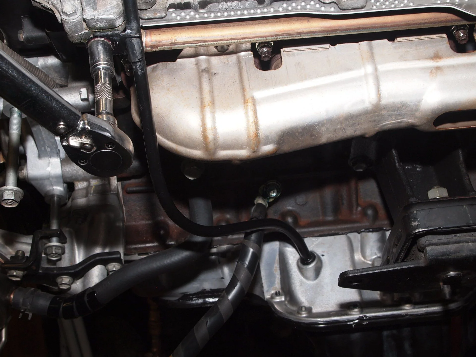

Oil dipstick guide tube install with new O-ring.
So I've been finding these O-ring weeping oil of side of engine, more so on 06 up (IDK on 03-05) for some reason:hmm:. Even on the 200 series.
On the King (01 w/170K) and other 98-02 I've not seen them weep, or not as much:hmm:
IDK on 03-05 as I've not looked.
Easy fix to stop leak. I'm tiring something a little different to see if slows or stops leak for longer. But they'll all weep someday
Lubricate (For easy installation) new O-ring with AT-205 re-seal, to see if adding the extra plasticizer will help slow this weep.
Torque 11ft-lbf
It takes about 200K miles to get to this point.
Stock photo of 06 w/200K miles:
Getting to with engine in the bay, is near as easy.
Remembering to clean area really good before pulling out guide tube is a must.

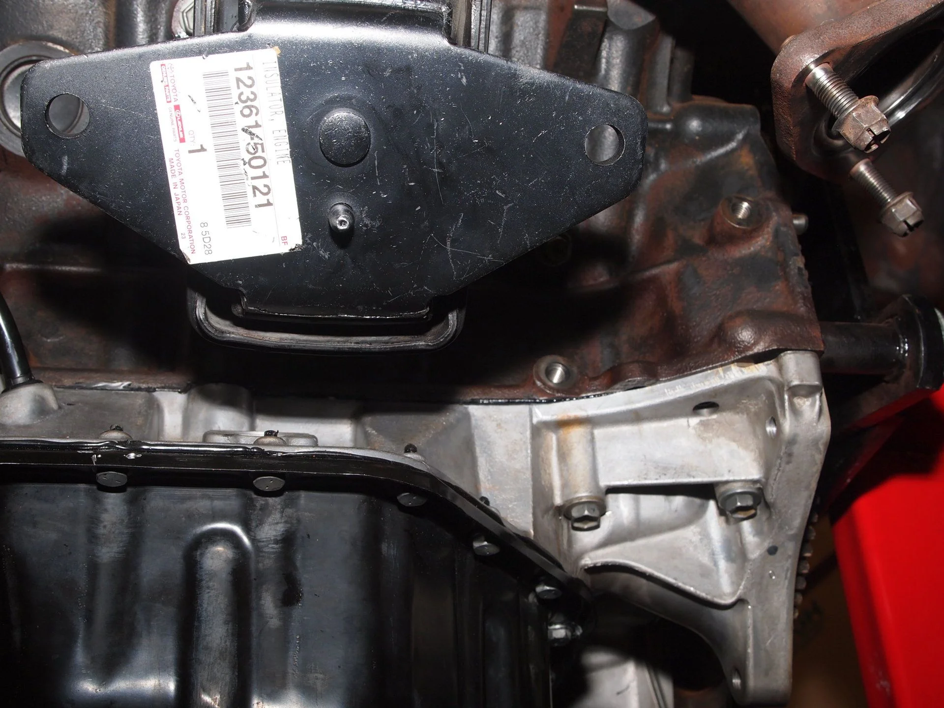

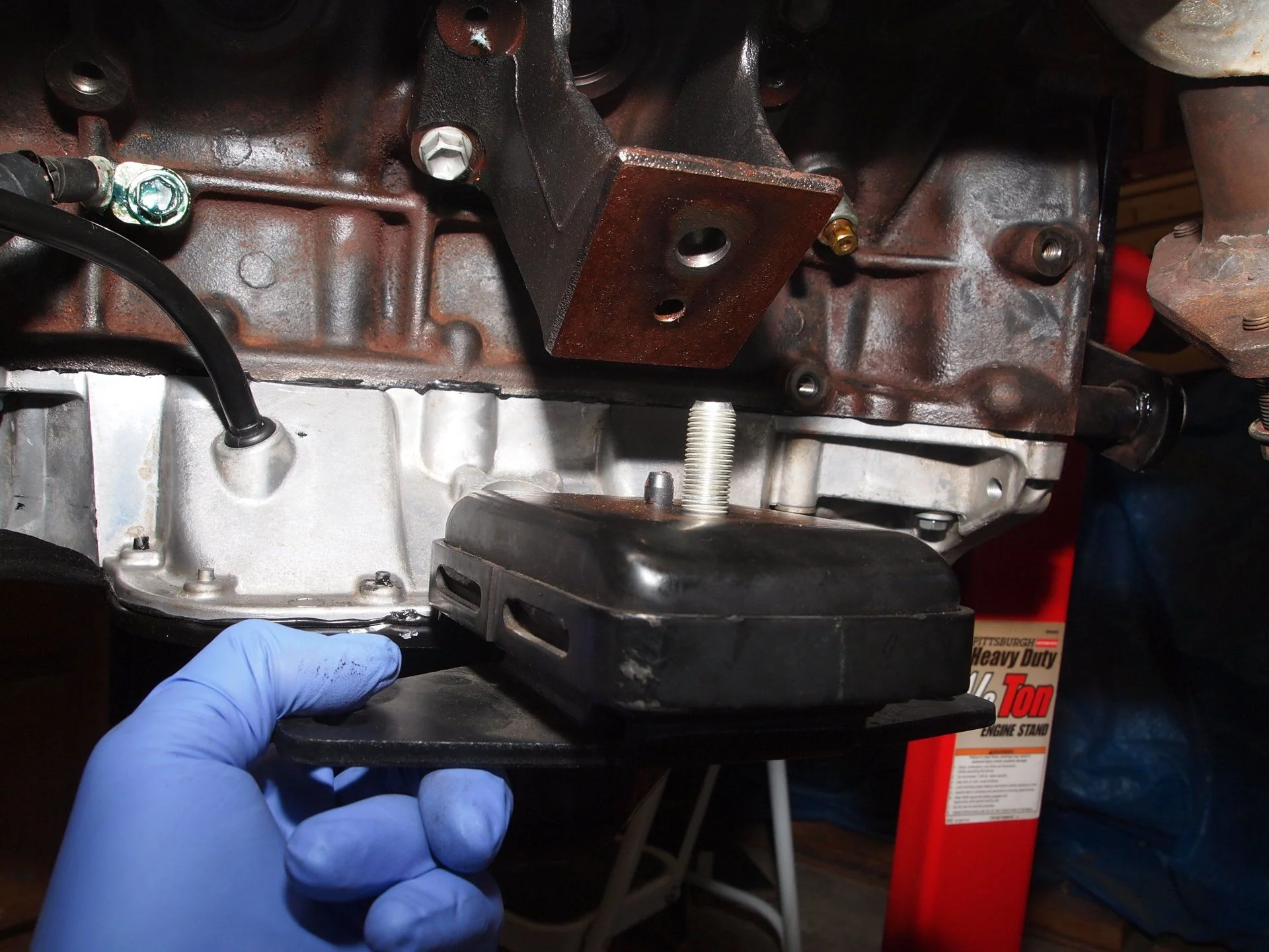

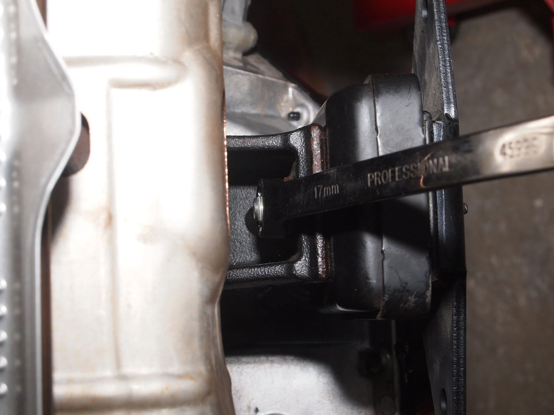

NEW OEM Engine Insulator (AKA Mounts) installed.
"Eat your heart out", this is so easy with engine on a stand. But I will be leaving the 17mm nut loose. This way the mount can pivot allowing for easier alignment of the two frame mounting bolts during engine install. I'll then come through fender well and torque down the nut. Torque will be the "feels really tight method" unless I find a spec for it.

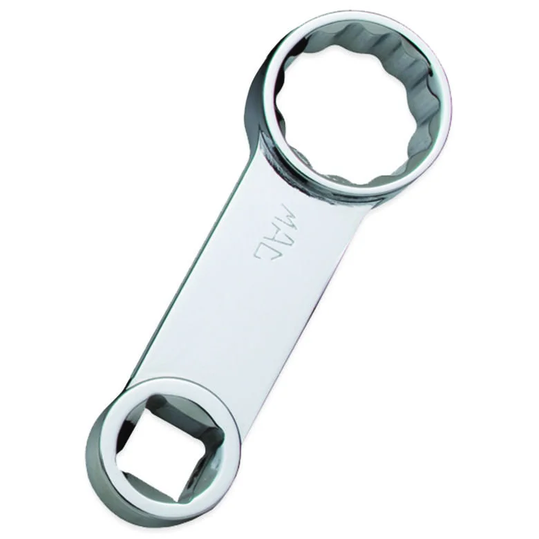

Were you able to torque that nut with a crowsfoot or something else?
@abuck99 I couldn't find a torque spec for this, let me know if you do?
Actually I've not yet installed, as was waiting for second engine mount insulator to arrive. I'll leave the 17mm nut loose, so mount can pivot. This should allow for just enough movement to make aligning the frame mounting bolts easy. Then I'll come back and tighten the engine mount insulator nut through fender well.
But really doing on the rig is a different ball game. They steering, frame and body will all be in the way. A boxed crowsfoot or extended crowsfoot (Box end Torque Adapter) may work well with a torque wrench. I found that with the standard Crowsfoot, I could only make minimum turn, then couldn't get back on as crowsfoot hit side of mount.
17MM Torque adapter 12 point would give greater movement and allow for torque wrench. But still I've no torque spec.

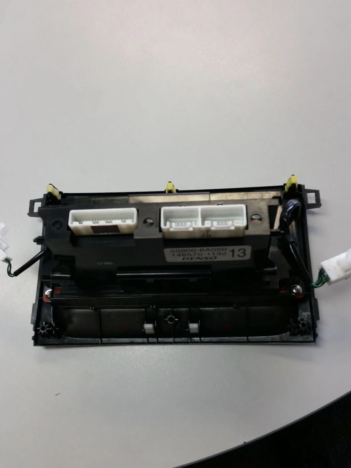

Unfortunately the ABS pump parts are gone, was several years ago:( On the unicorn AC controller, this is a pic of the back of that unit. I’d like to see closeup pics of each of the four male plugs on the vehicle side harness. Looking to either confirm moving directly from the TFT unit, or the wire colors for moving individually to a new plug. No hurry on this since you’re elbow deep, but think a lot of folks could use this info ;)

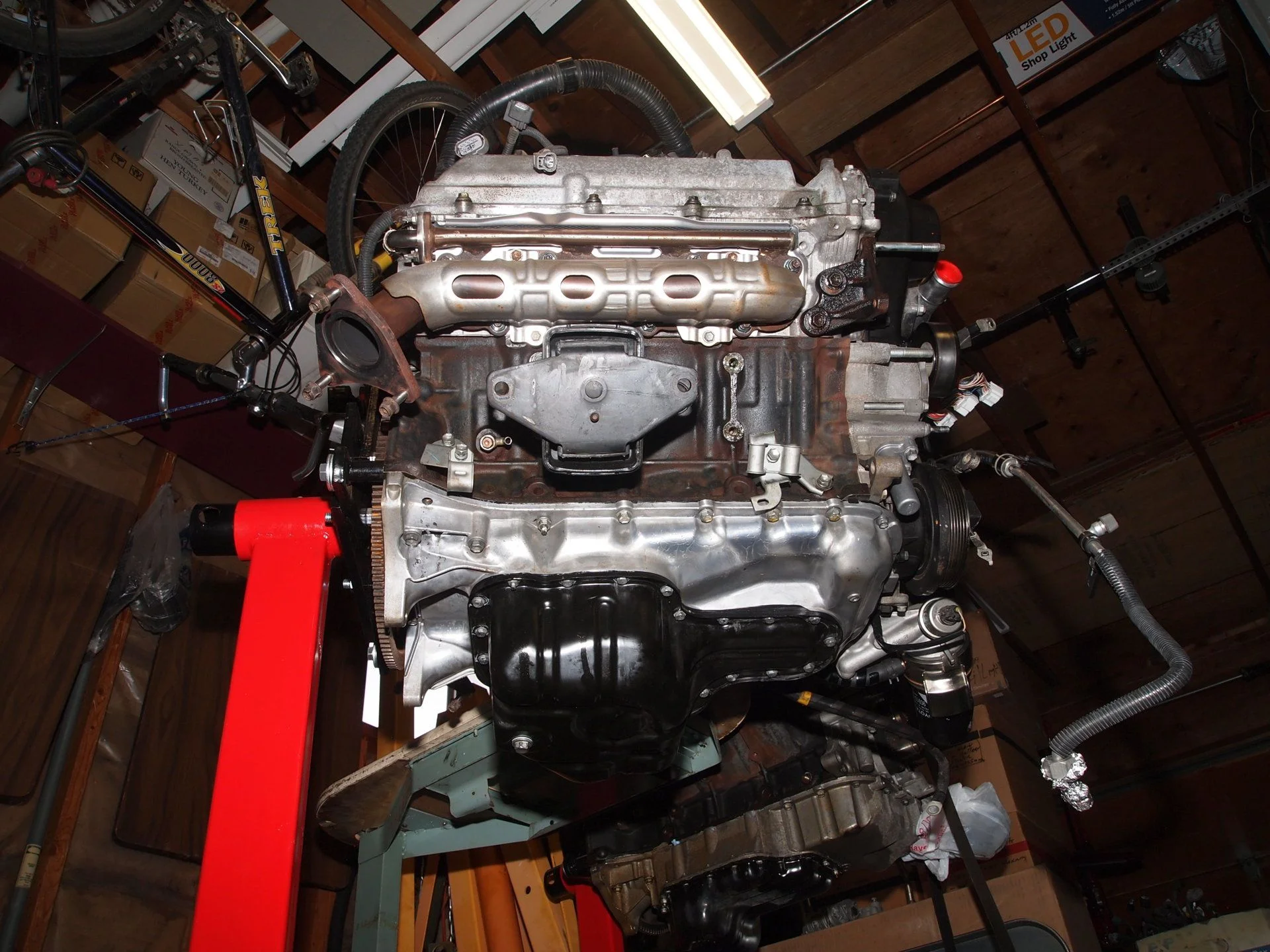

Back to job at hand, installing the engine!

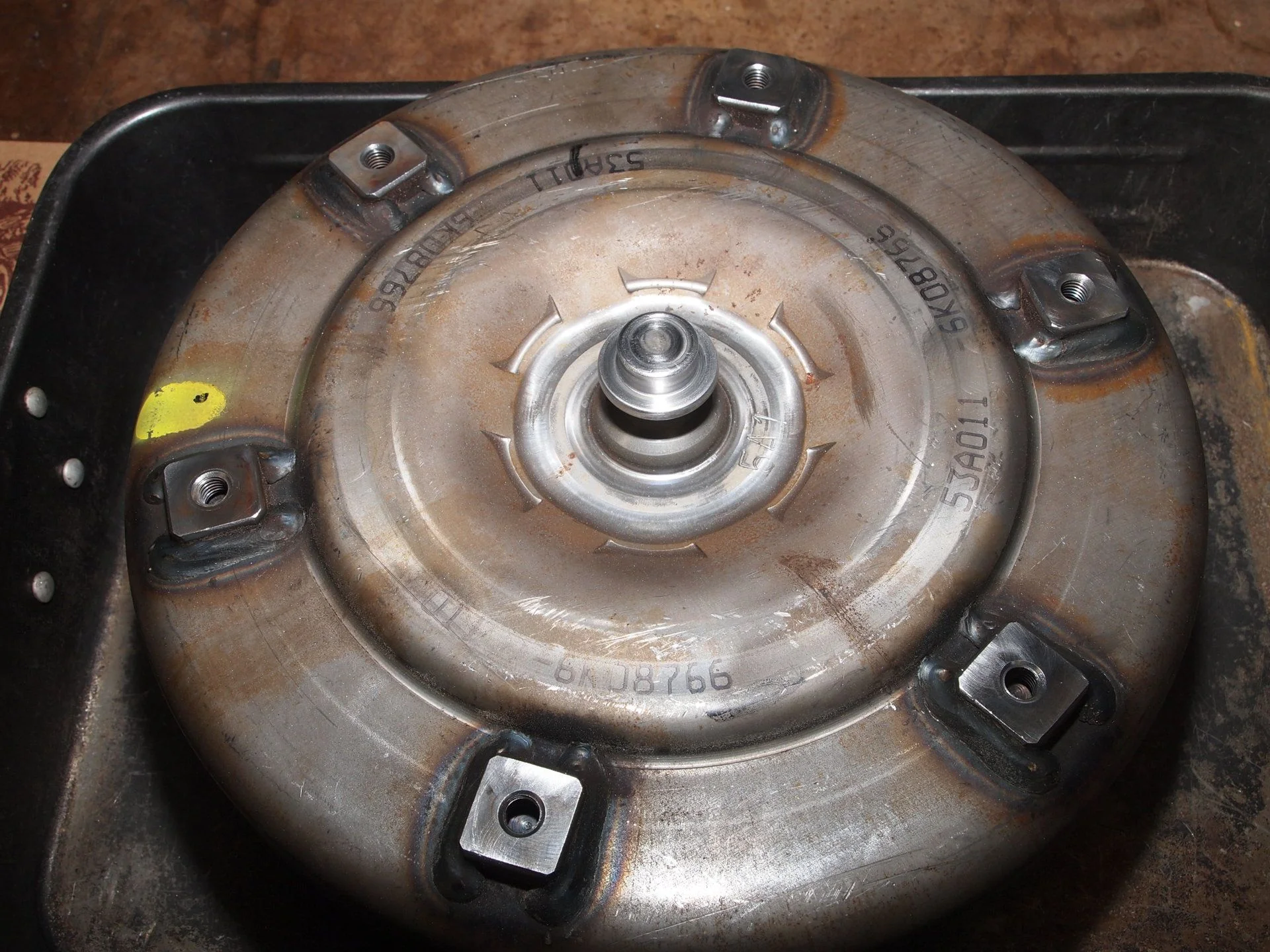

Cleaned up torque converter pilot shaft and crankshaft end then greased, so they slip into each other easily.
Notice my thread cleaner tool in the bolt hole. Last thing I wanted was bolts difficult to thread during install, so made sure to cleaned all the threads.
Seated the torque converter in the transmission. It's kind of tricky to get seated all the way in, as it seems to stop at three different points before fully seated. It needs to be far enough back that pilot shaft is flush with bell housing.
Floor jack under transmission was helpful in getting alignment of engine to bellhousing, by starting with transmission up as high as possible.
I did not want to risk damaging the new exhaust pipe flange gaskets, so I'll put those on after engine is installed.
Finally, months after receiving The Unicorn the replacement engine is going in.
