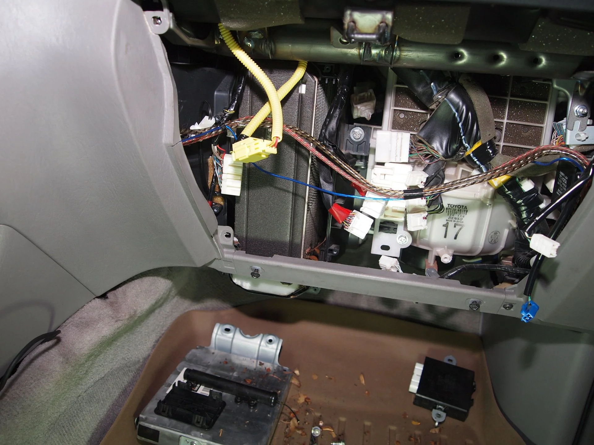

Interior work has been progressing.

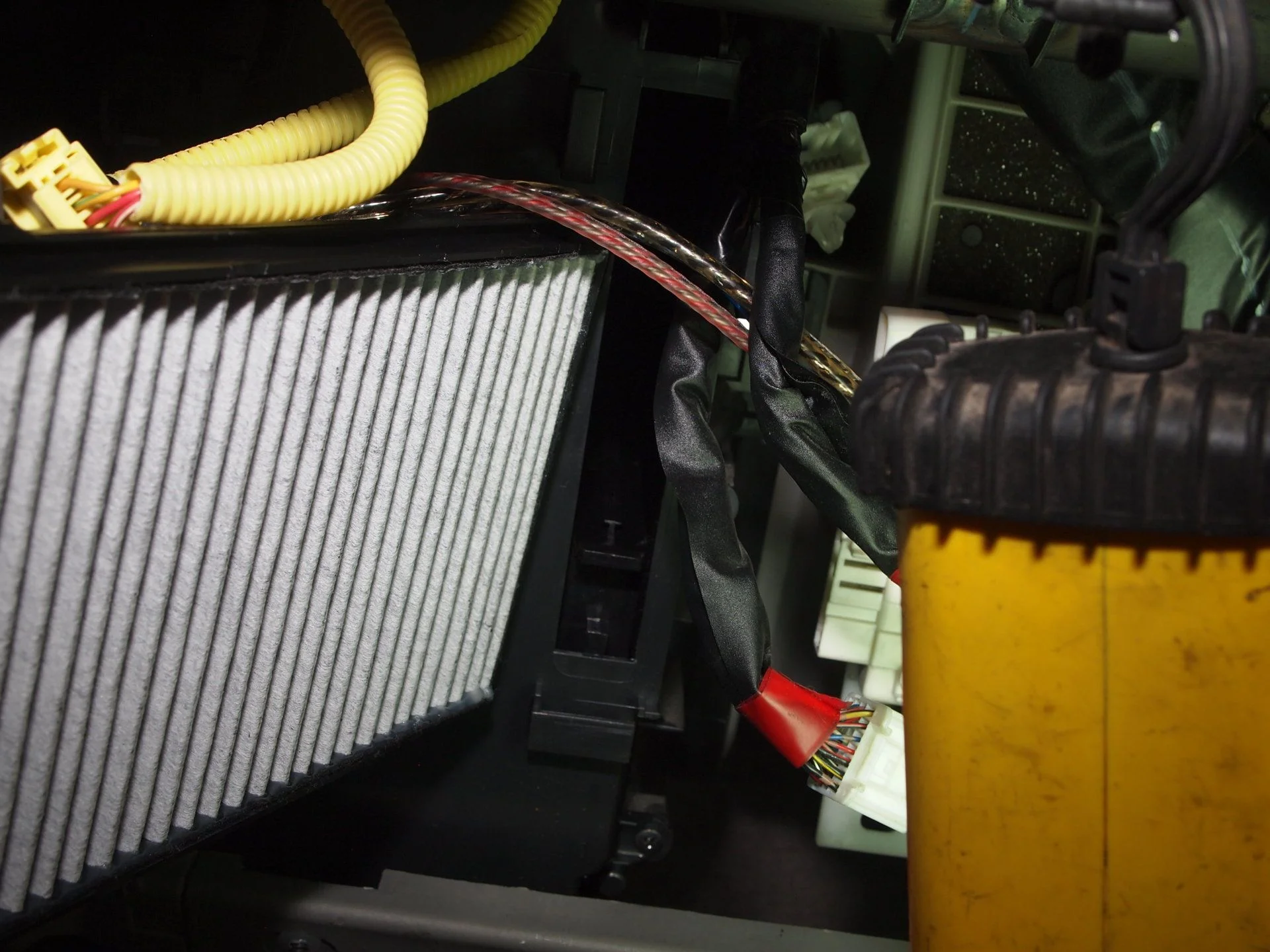

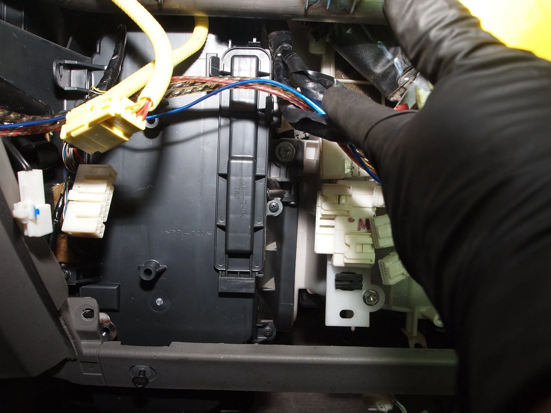

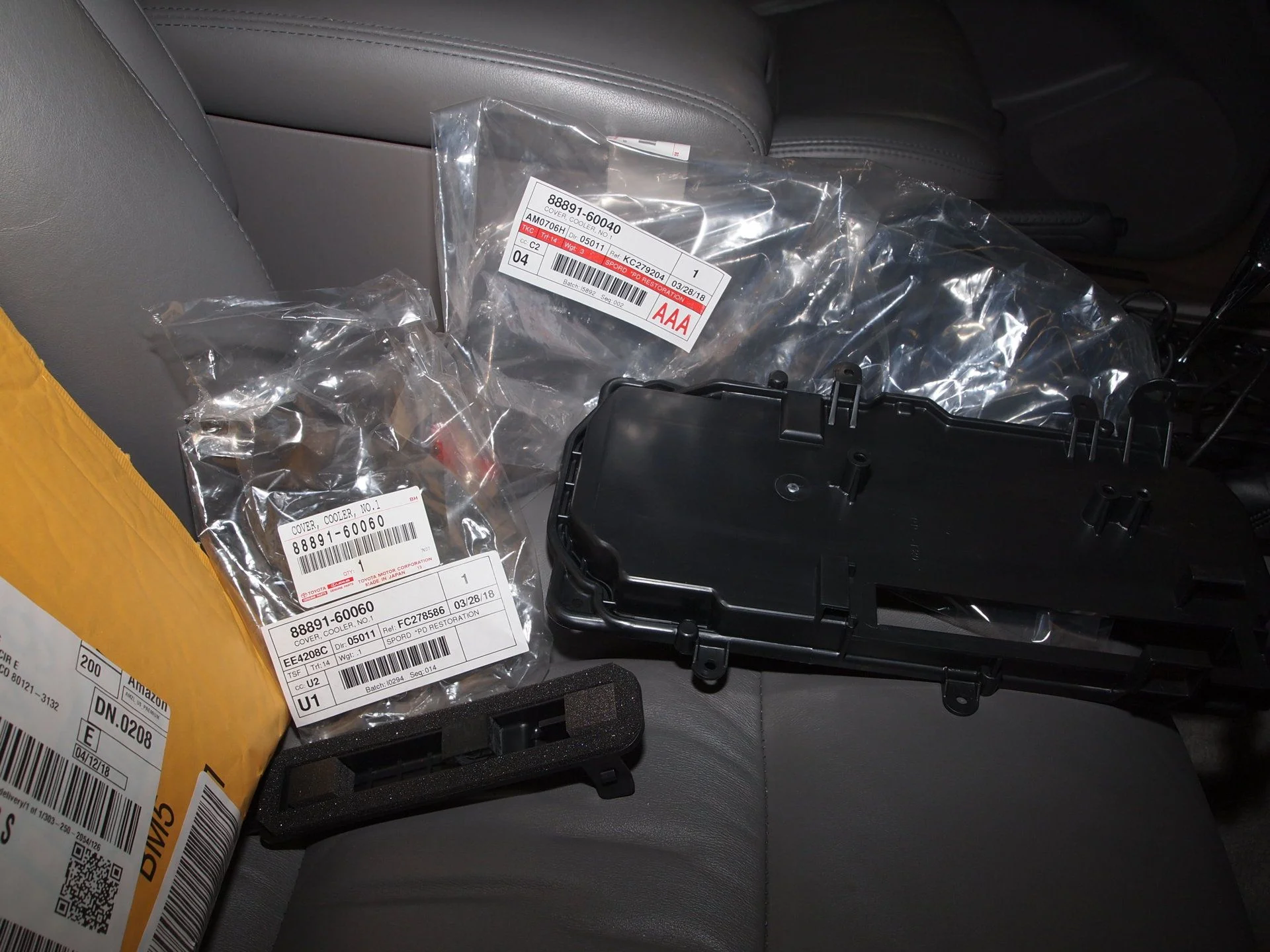

HVAC filter additing was one first up.
I purchased new cover and door and placed in cabin air filters.
Using these filter seem to change air/fan sound a bit in hi. Kind of like air flow is a little restricked.

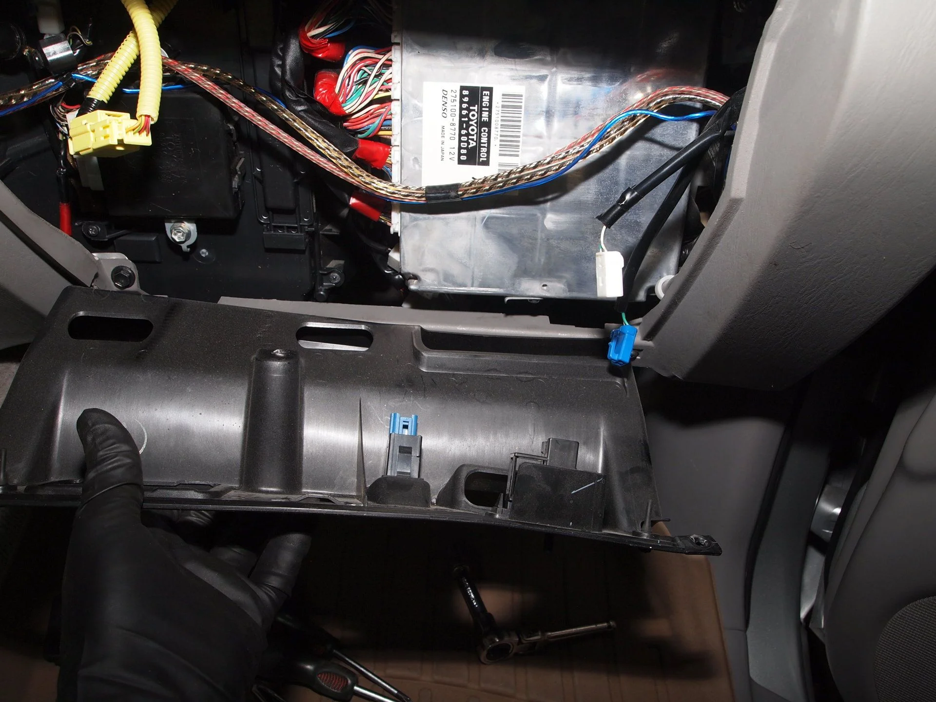

Notic, I did this while engine harness and ECU out.
Cleaned and ready for new cover plate.
Had to make sure seal at bottom was in good condition, clean and in place.

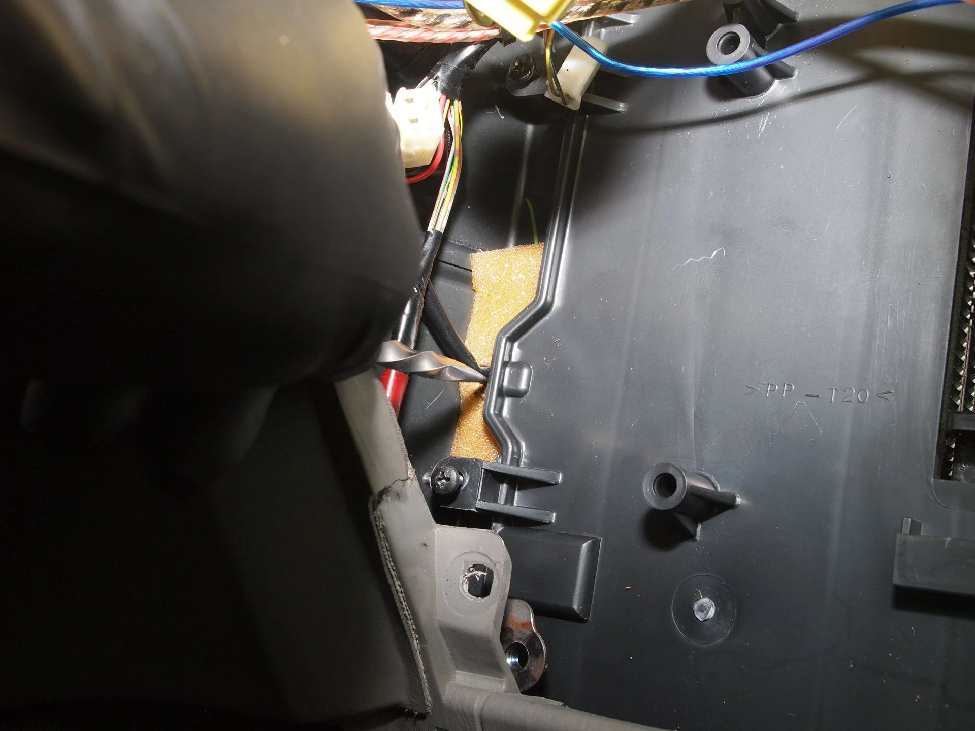

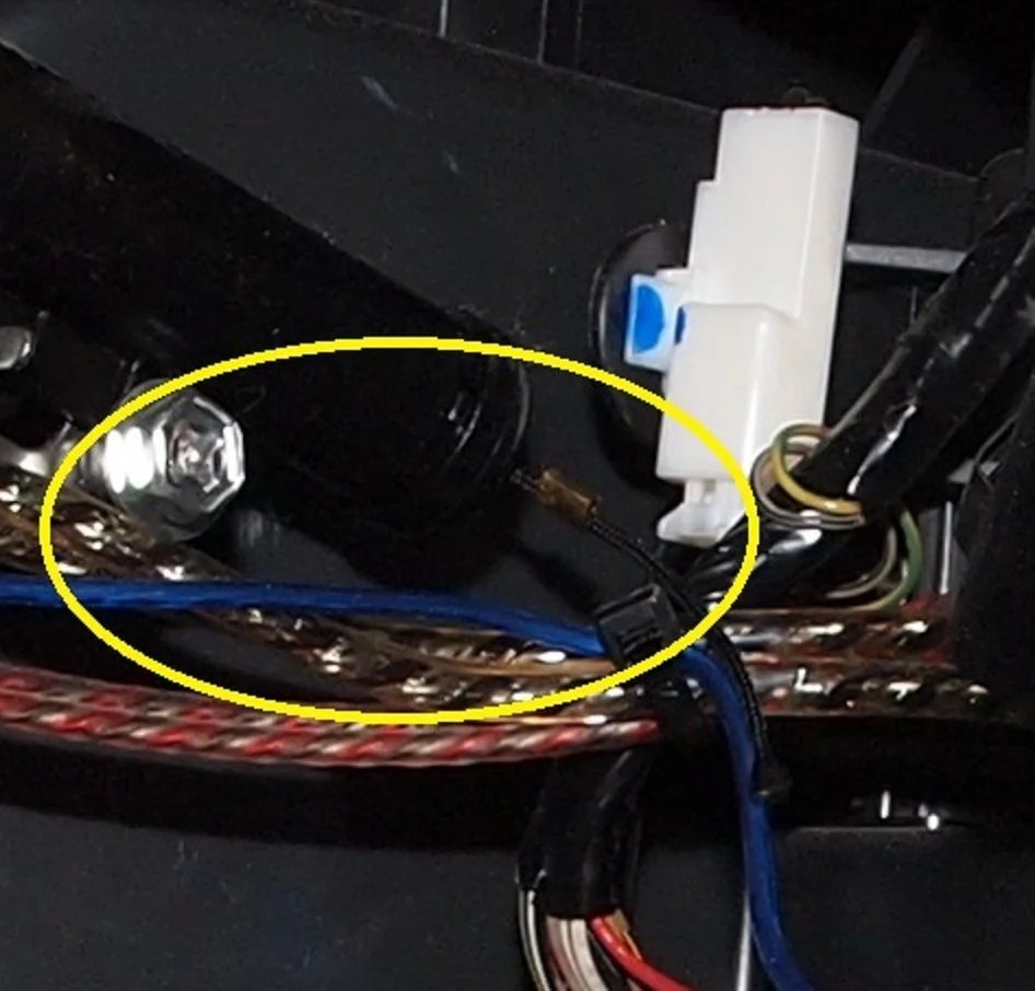

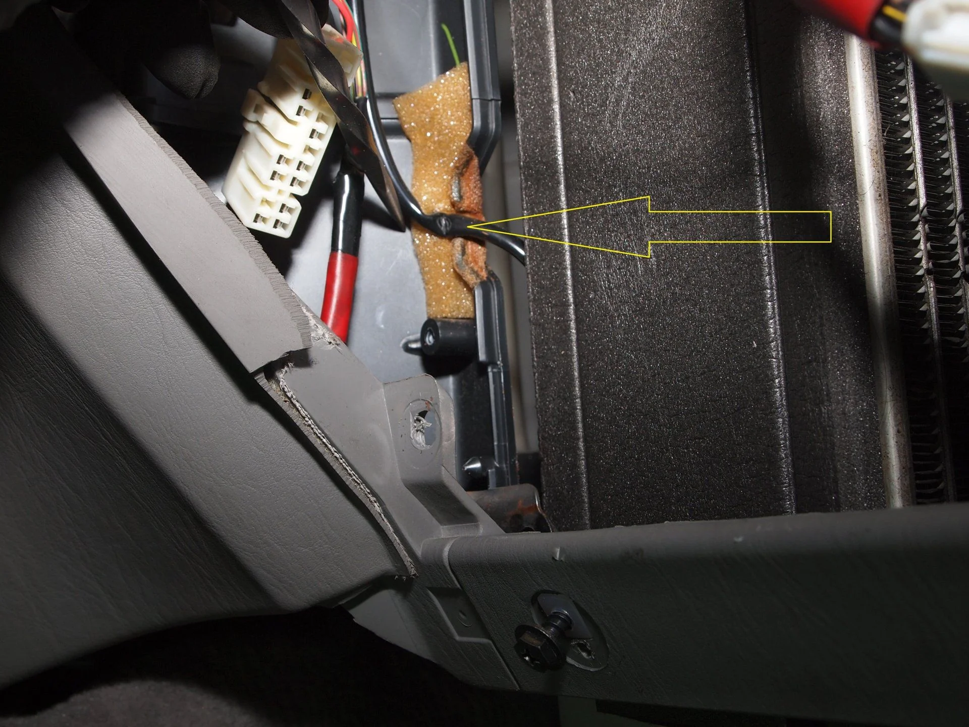

This wire was given me a bit of issue, keeping in position between HVAC housing & cover.
Both filters in and door in place.
Attaching wires as inner shield goes in place.

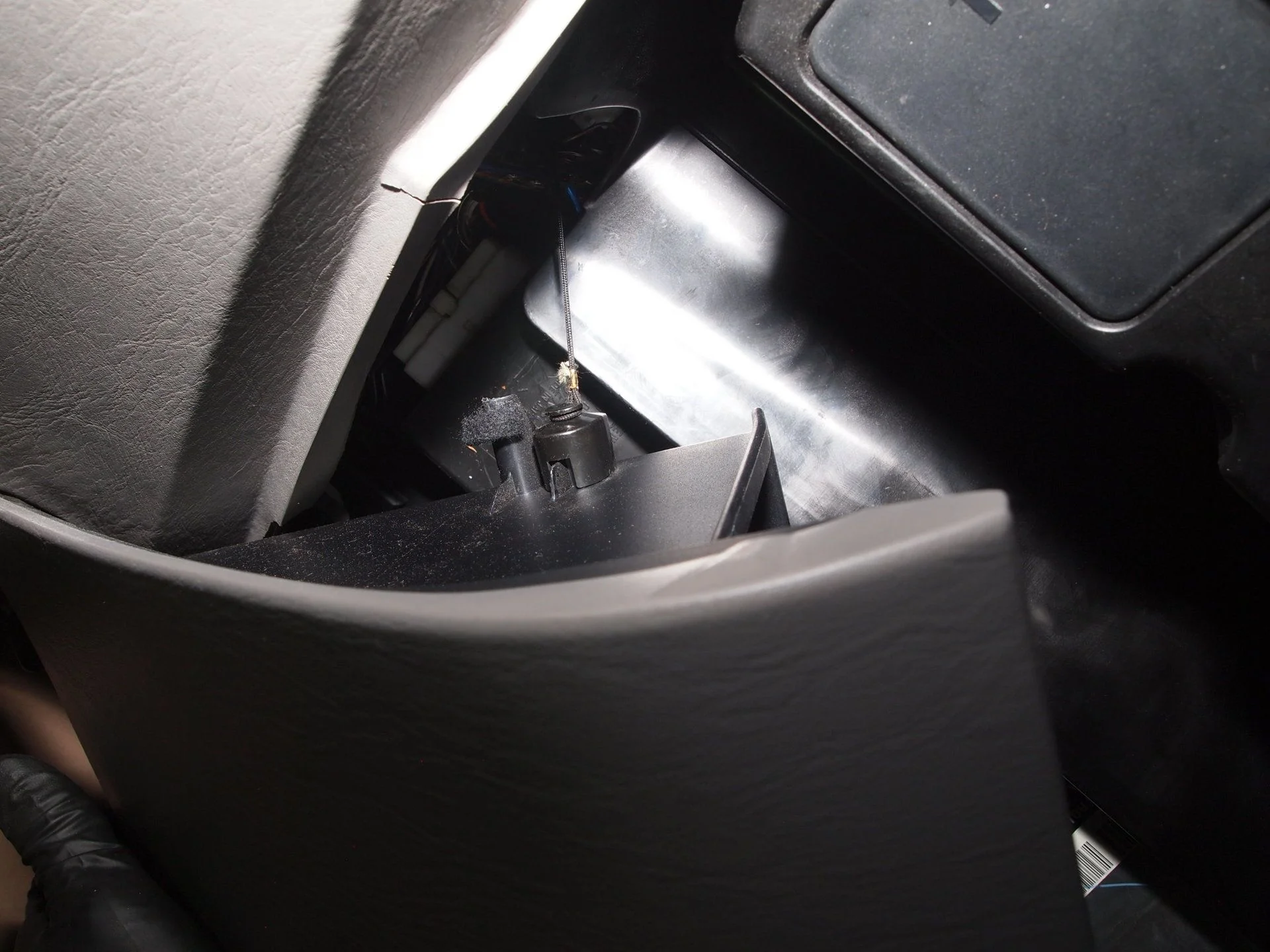

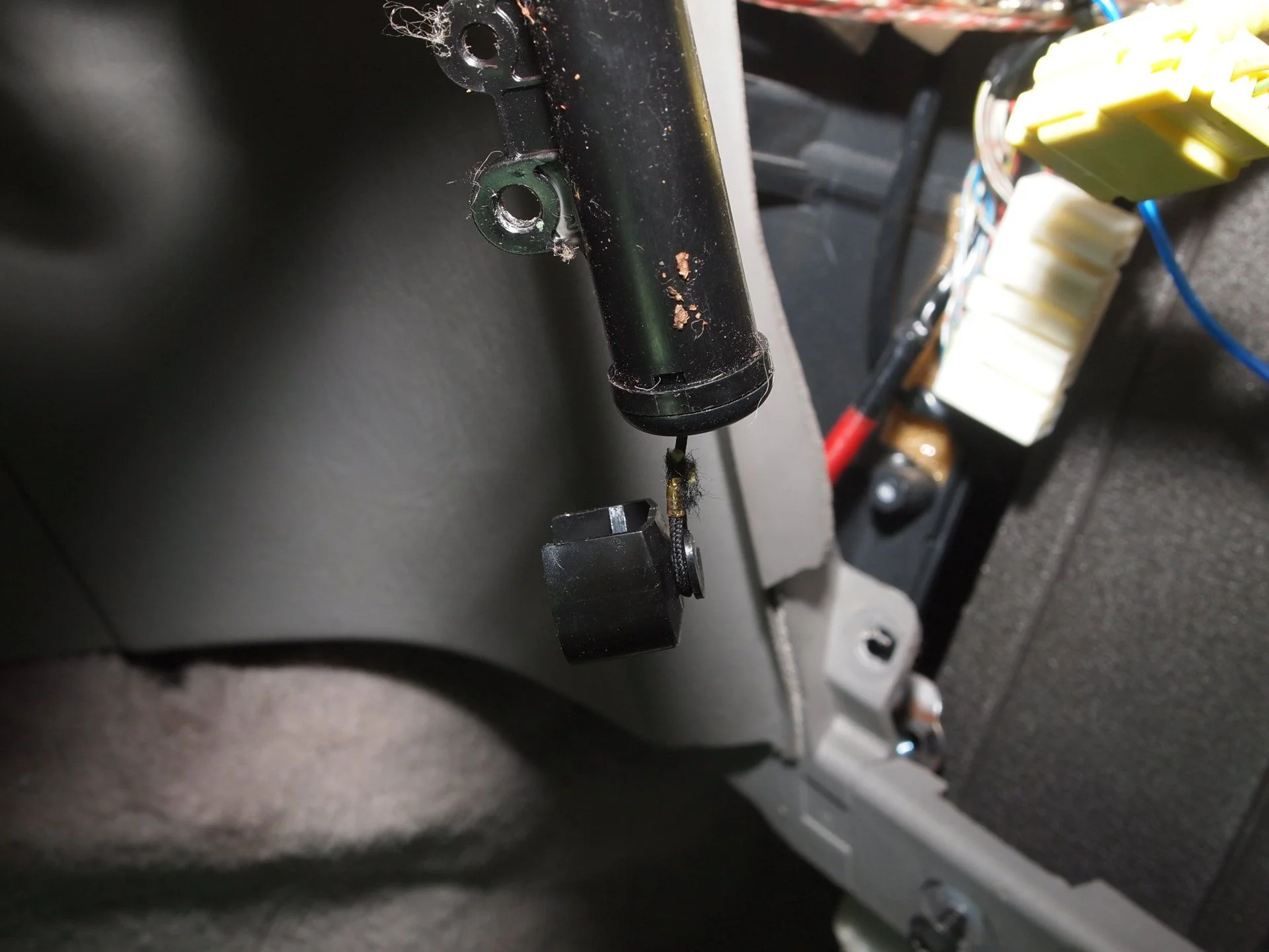

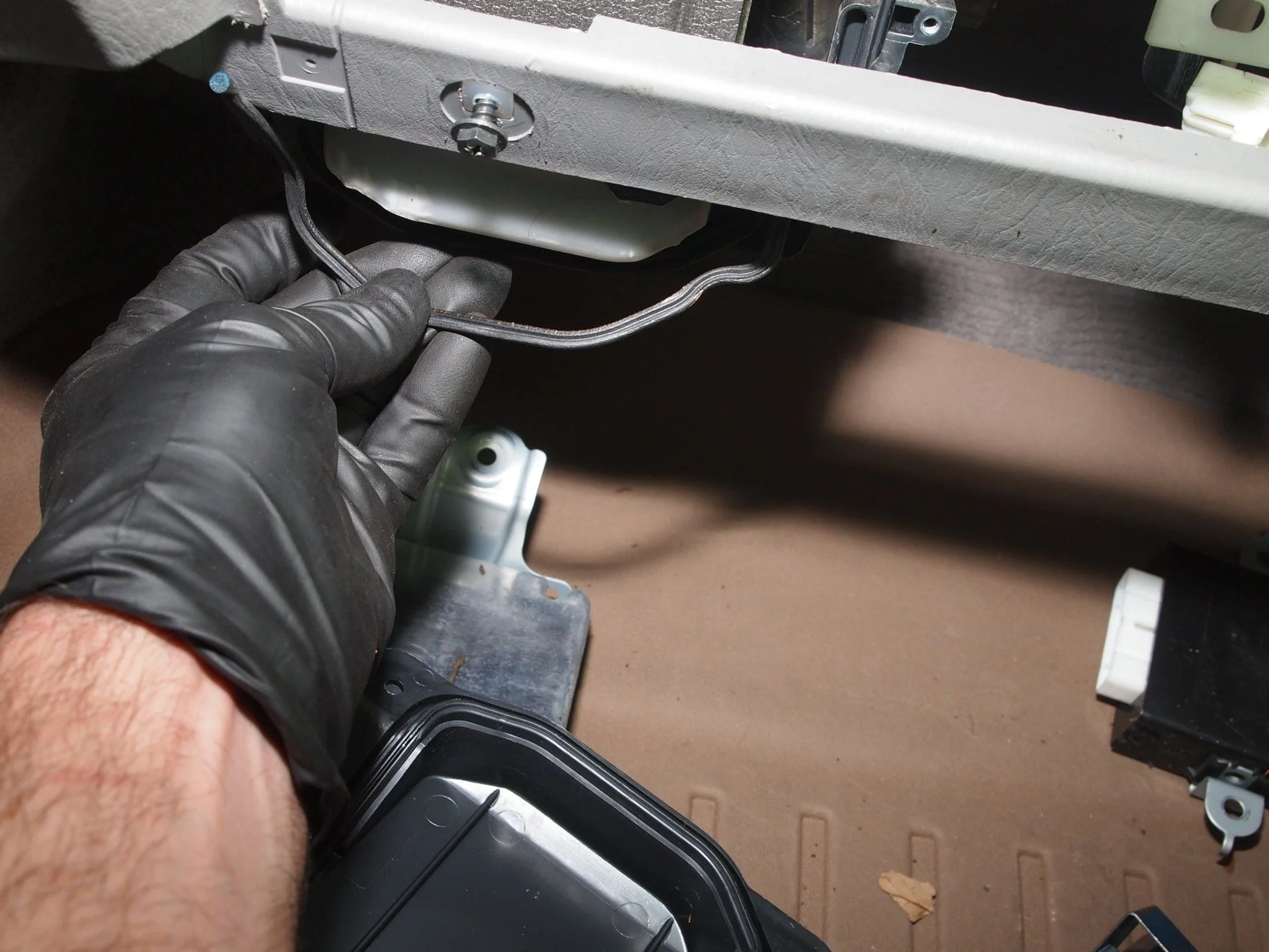

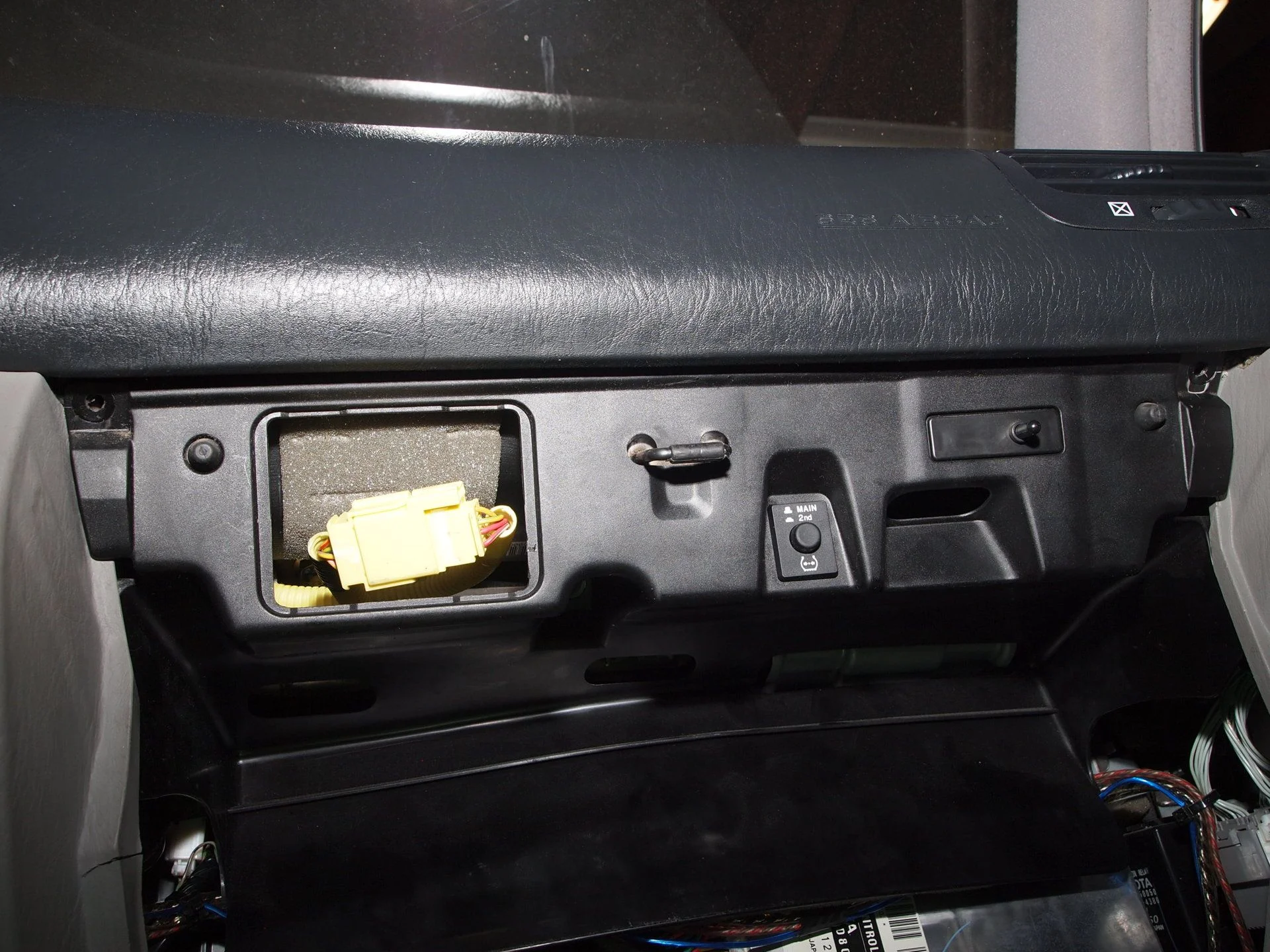

I repaired glove box door shock cord while in the area. I'll bet the radio installer broke it. They don't care much what they tear up, getting installation done.
The loop was pulled from crimp of metal retainer. Notice the loop is held to glove box door with a slip of bracket.

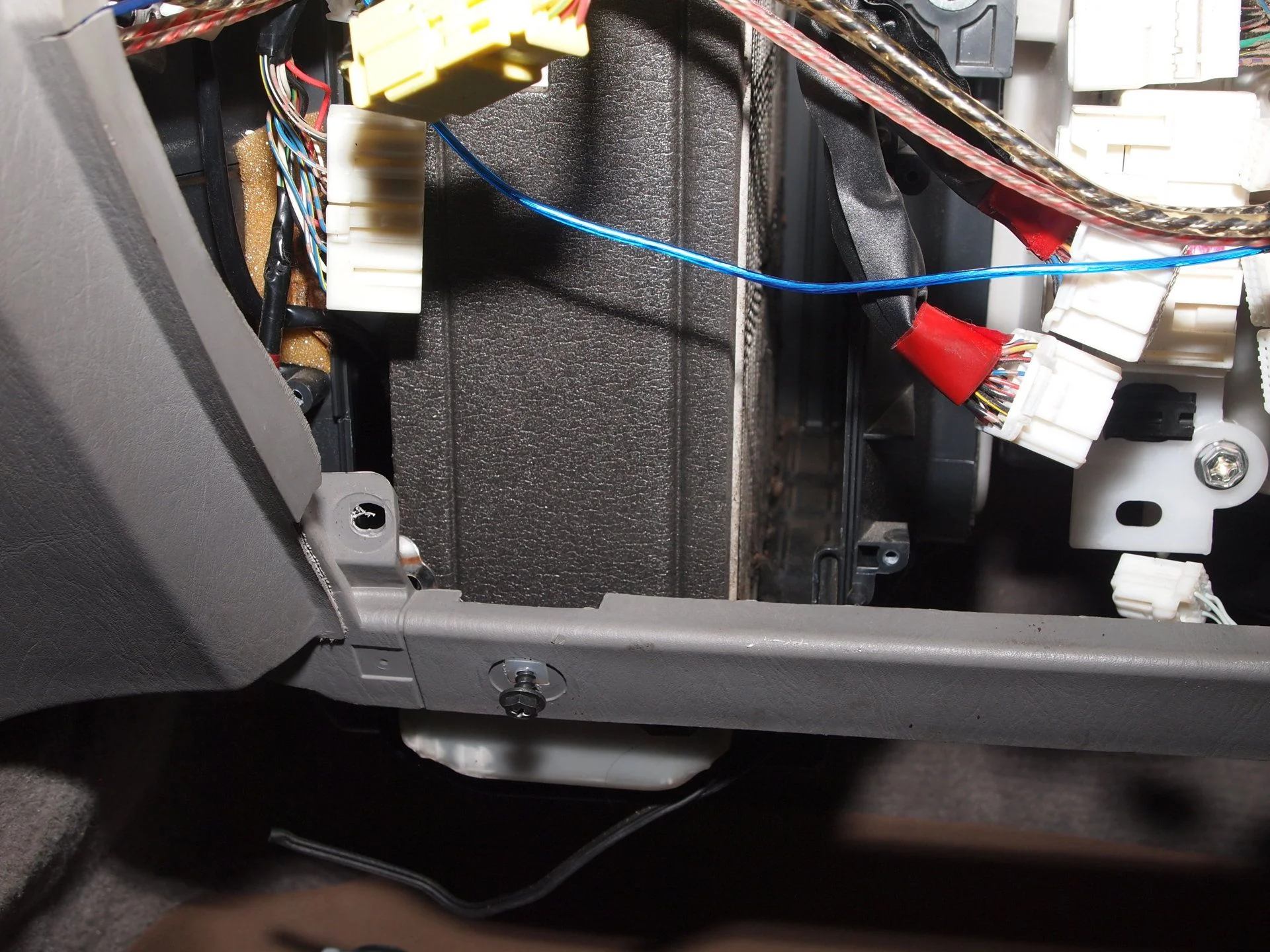

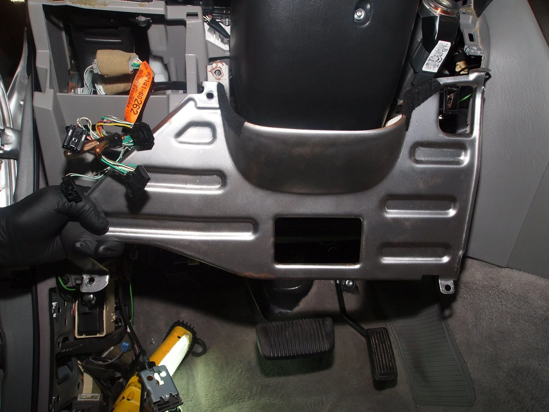

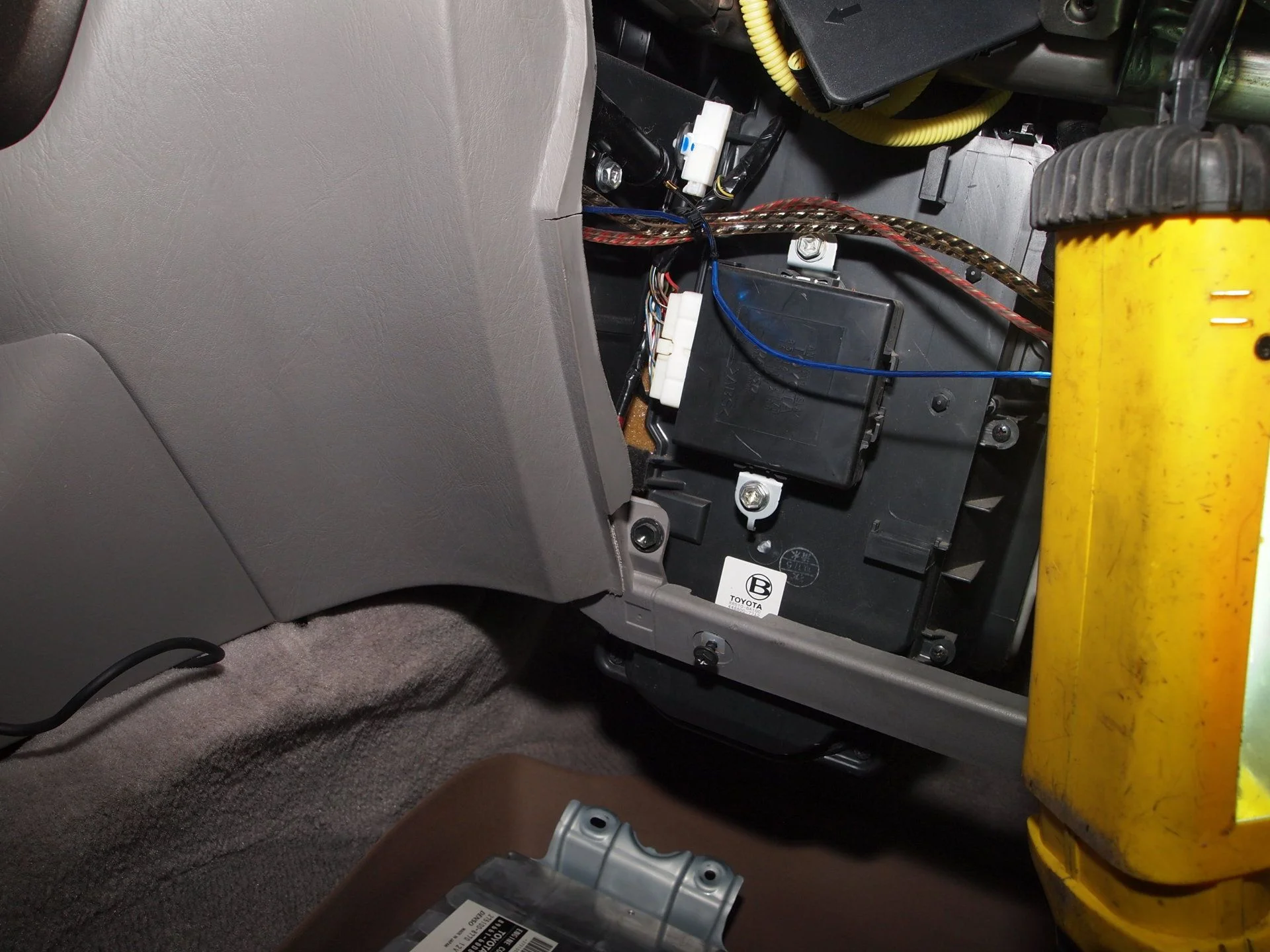

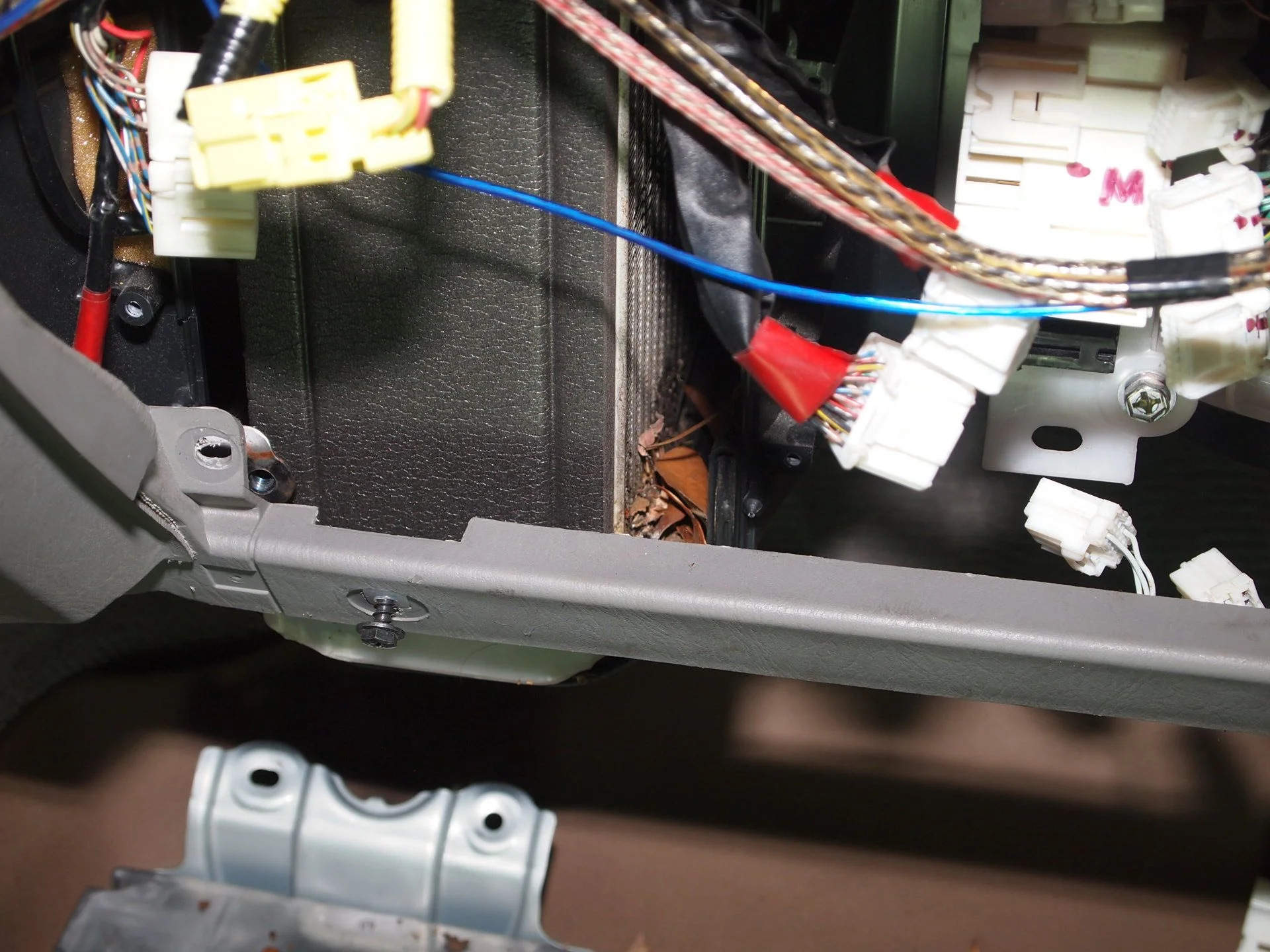

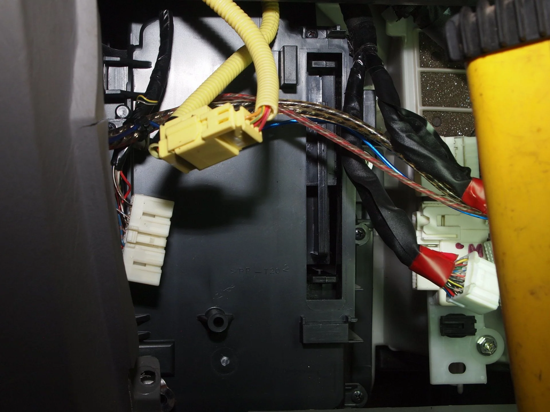

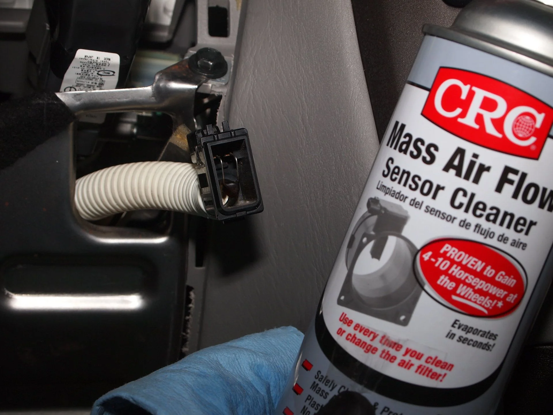

Cleaning the HVAC cabin sensor while working in dash area. This is behind the little vents cut in dash under ignition key. I was working on diagnose steering telescopic motor. Had lower panel off, so why not hit with some MAF sensor spray cleaner.

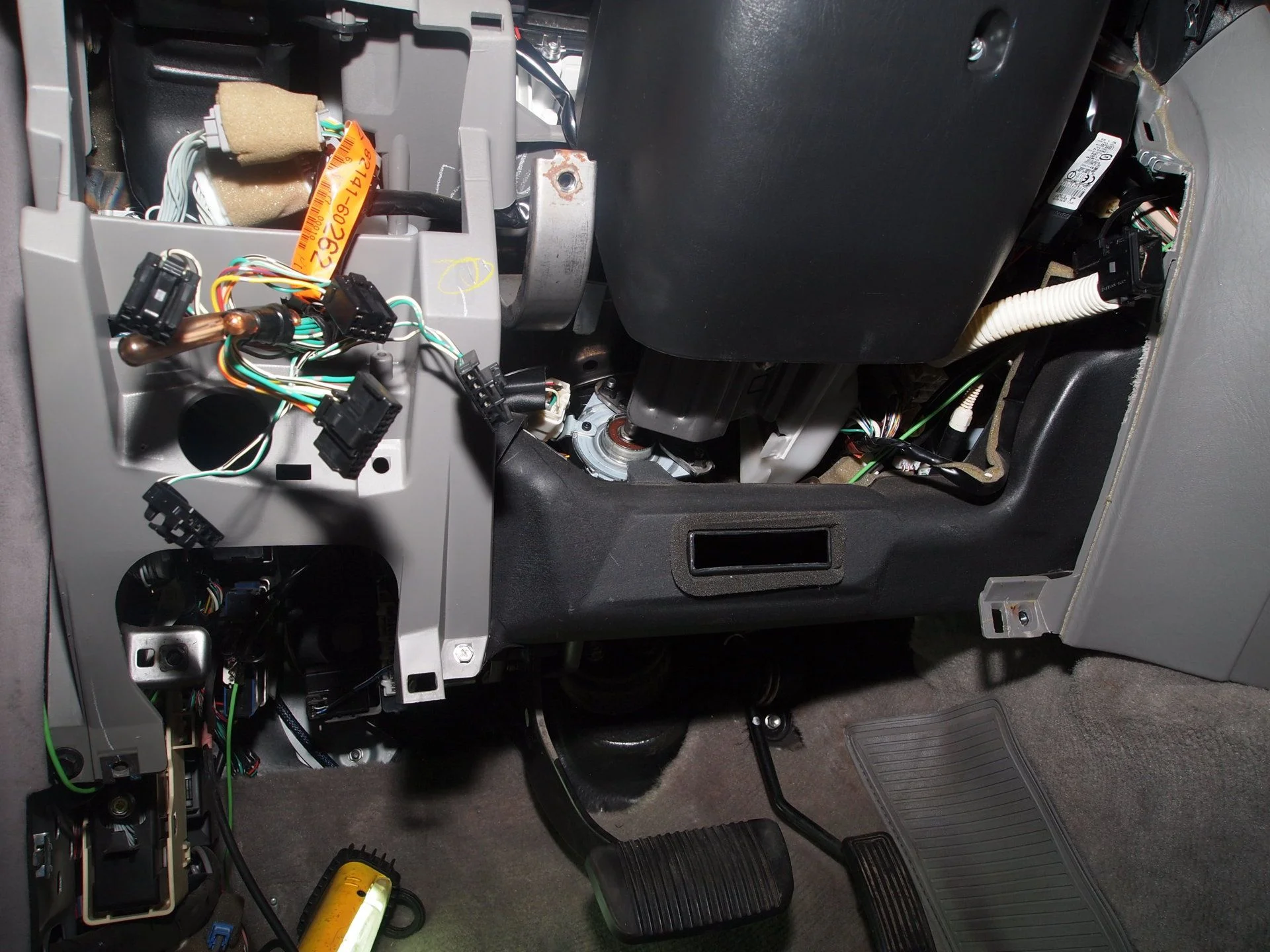

Steering column telescopic function was not working. So I pulled it and plugged into tilt motor wire harness to test, it was bad.

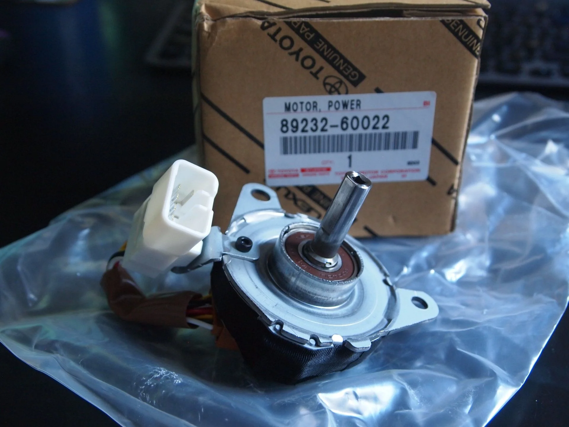

I order a new out of the UAE from PartSouq Auto Parts Around the World ~$200, 3 or 4 days later and it was here.

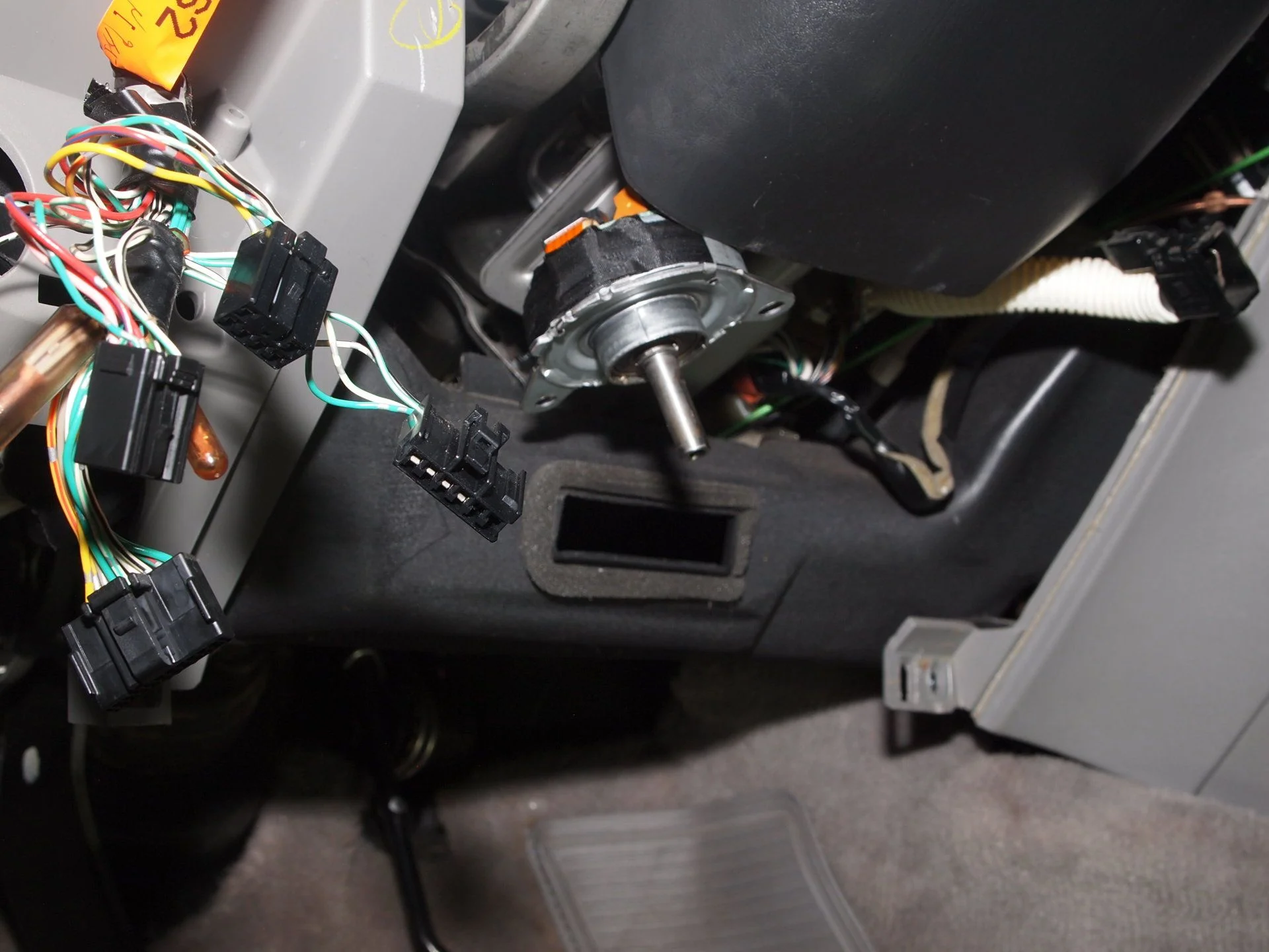

Installed new motor
Button back up the lower dash
Works fine now.

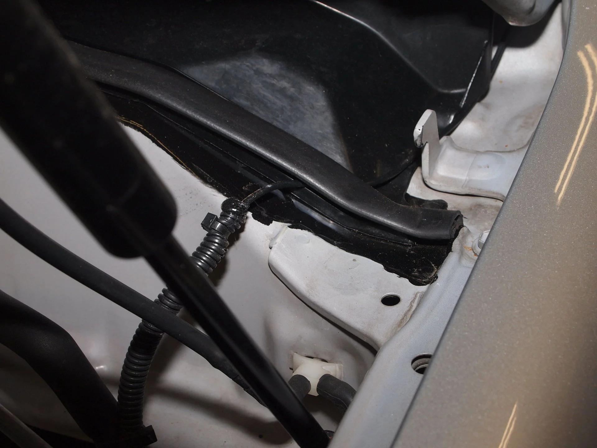

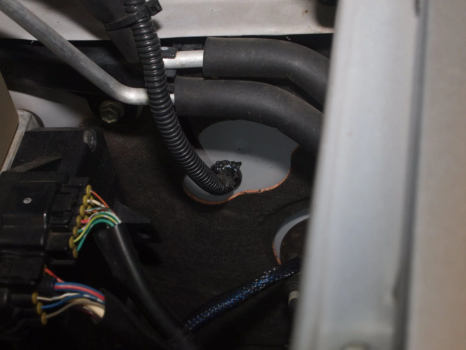

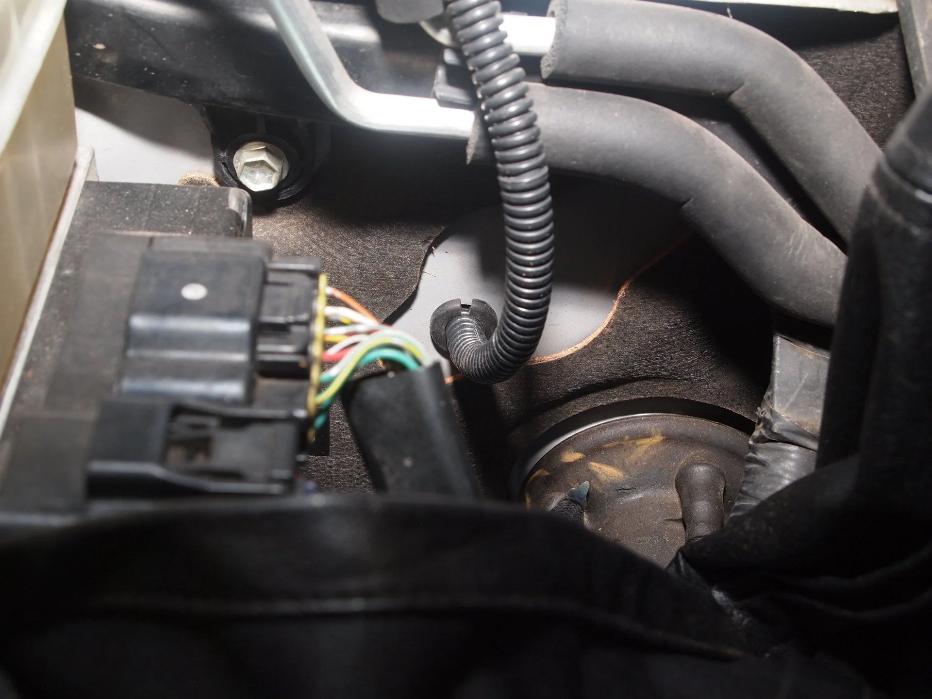

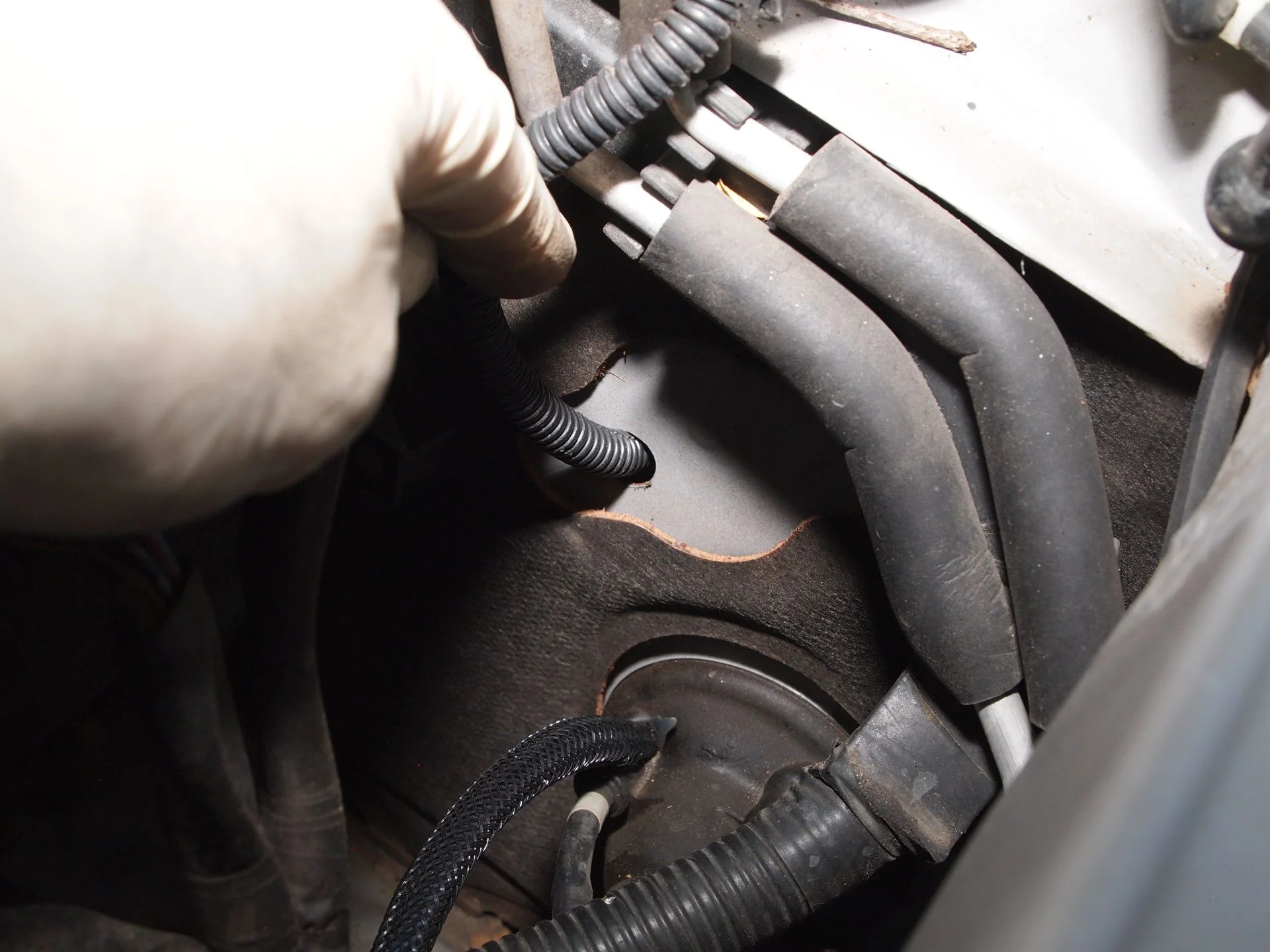

A hole was drilled through firewall for antenna (GPS I suppose). They didn't need as there already was a rear one installed, oh-well. In doing the job they failed to make air/water tight. So I put in a grommet in firewall and sealed with some black FIPG.

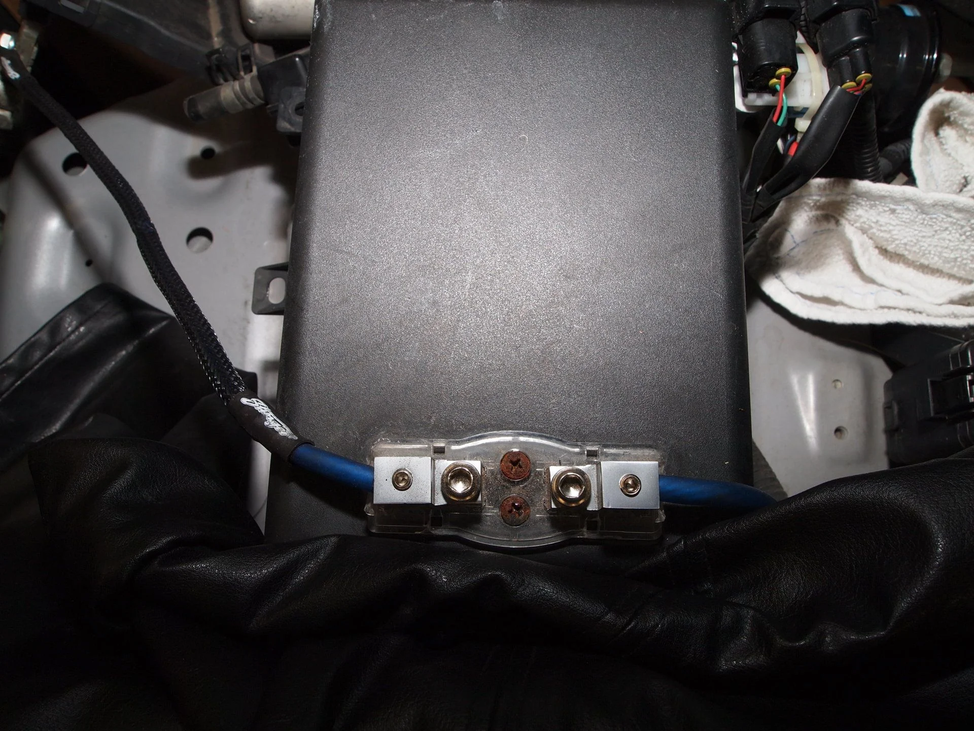

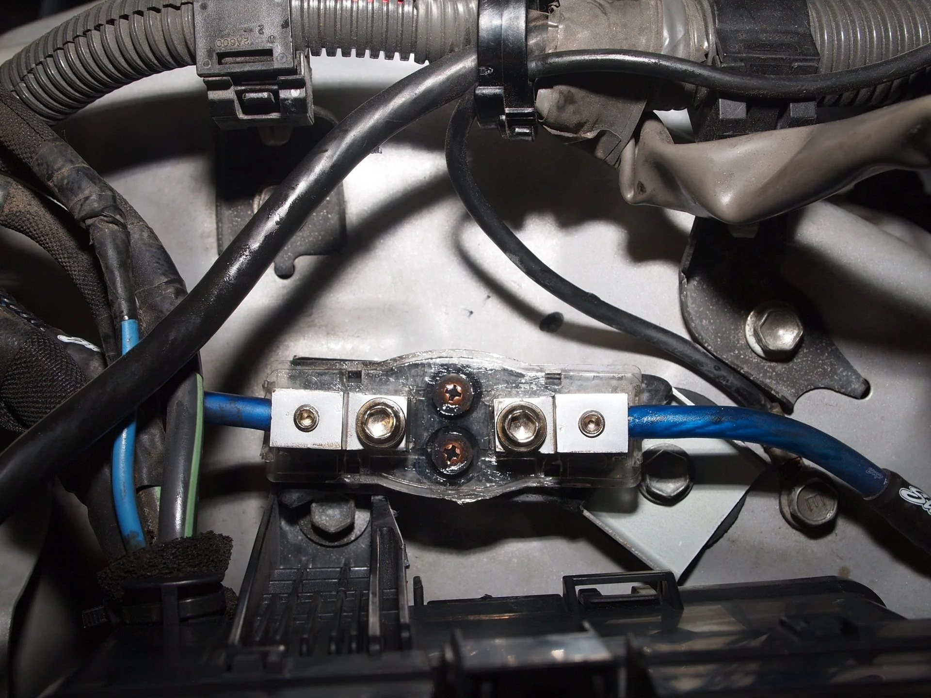

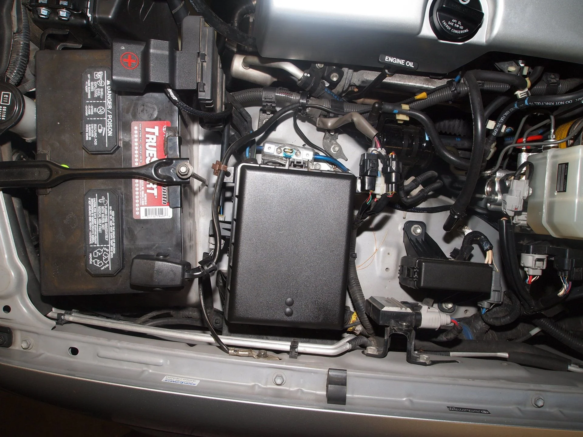

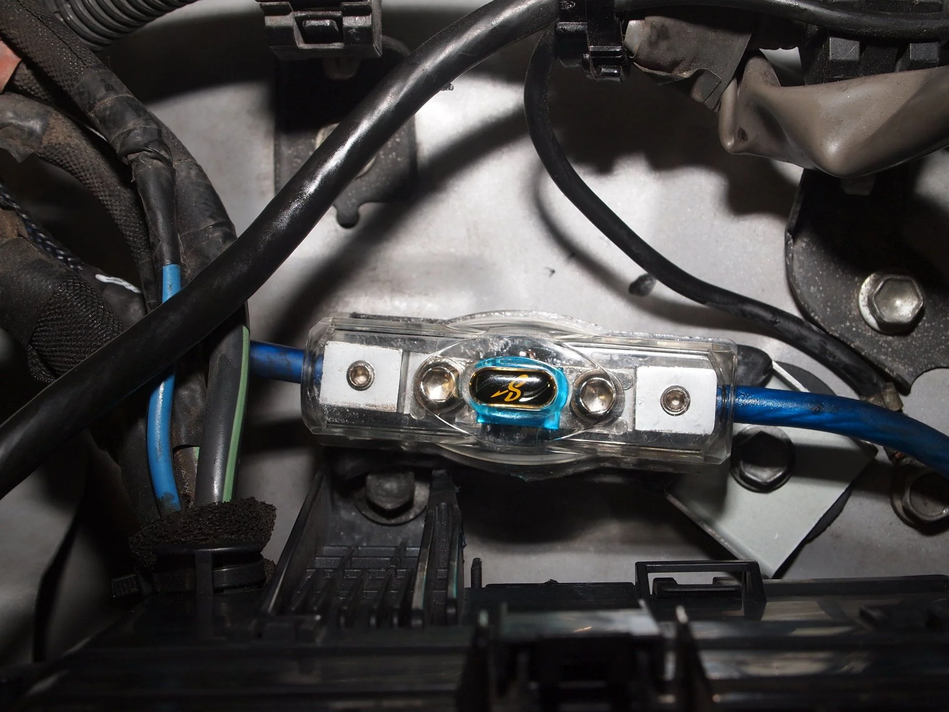

Aftermarket AMP battery lead and fuse box. They took a lazy apochoce and just screwed in with steel screws that rusted. They attach to top of fuse box, making opening fuse box a bit cumbersome. It also created a potential water leak into fuse box.
I made an insulated bracket, then attached with 10 mm bolt to existing factory fender nut hole at side of main fuse box.
Plugged the holes in fuse box and sealed with FIPG

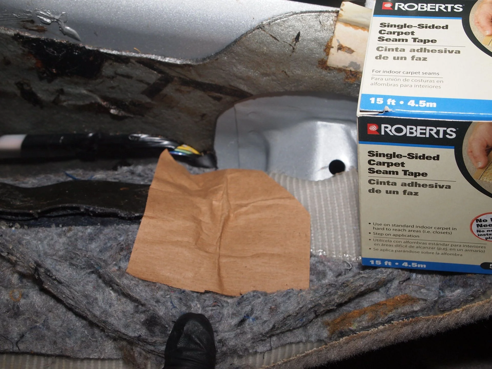

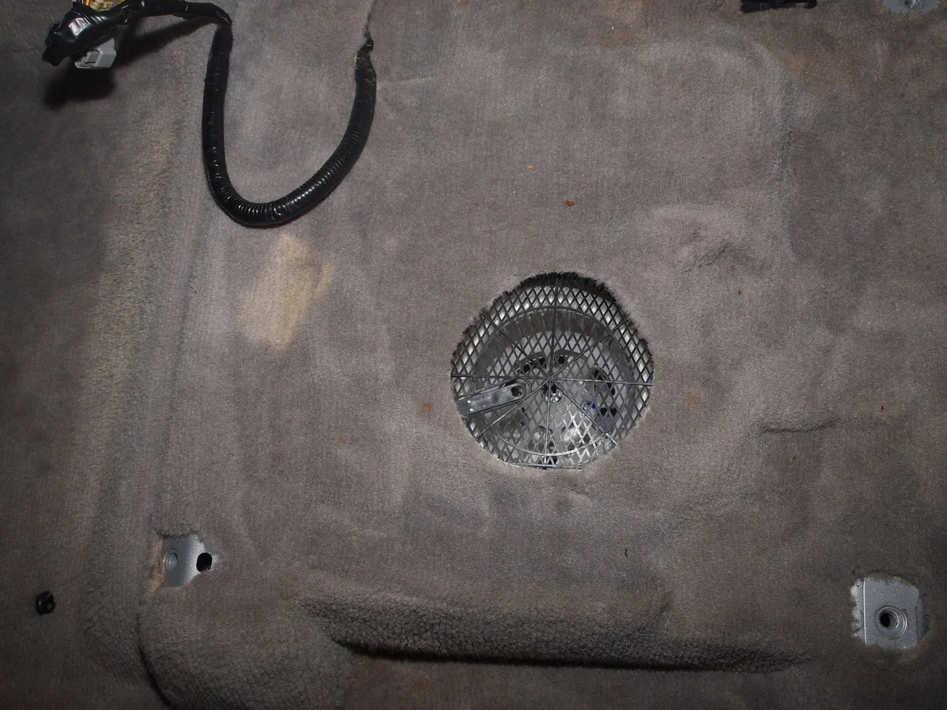

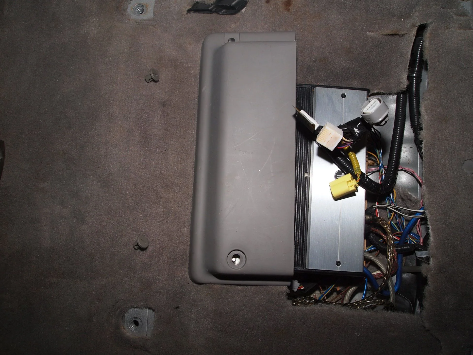

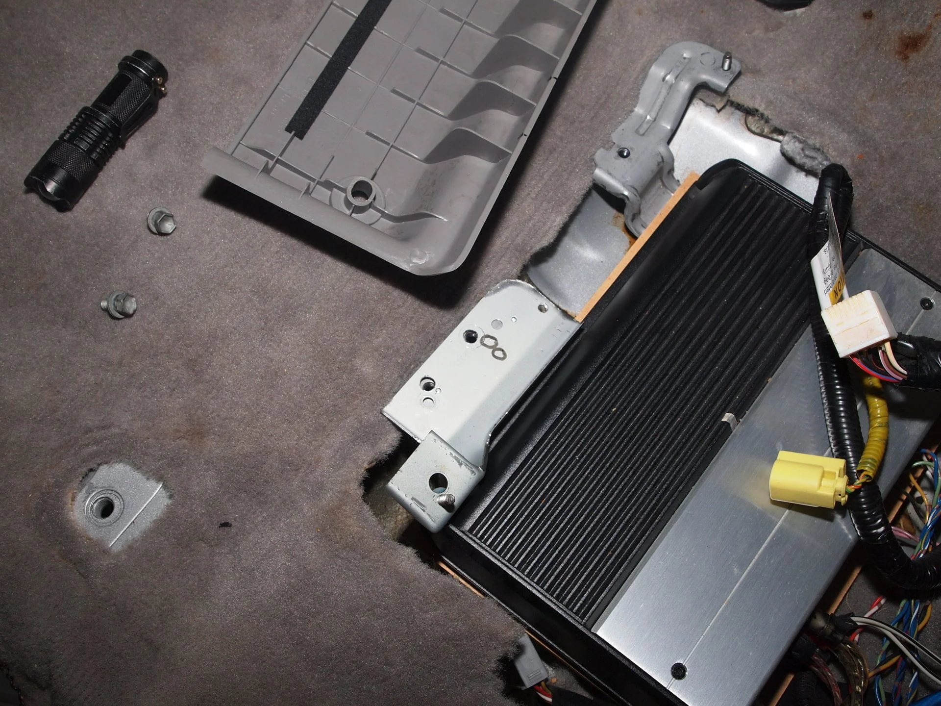

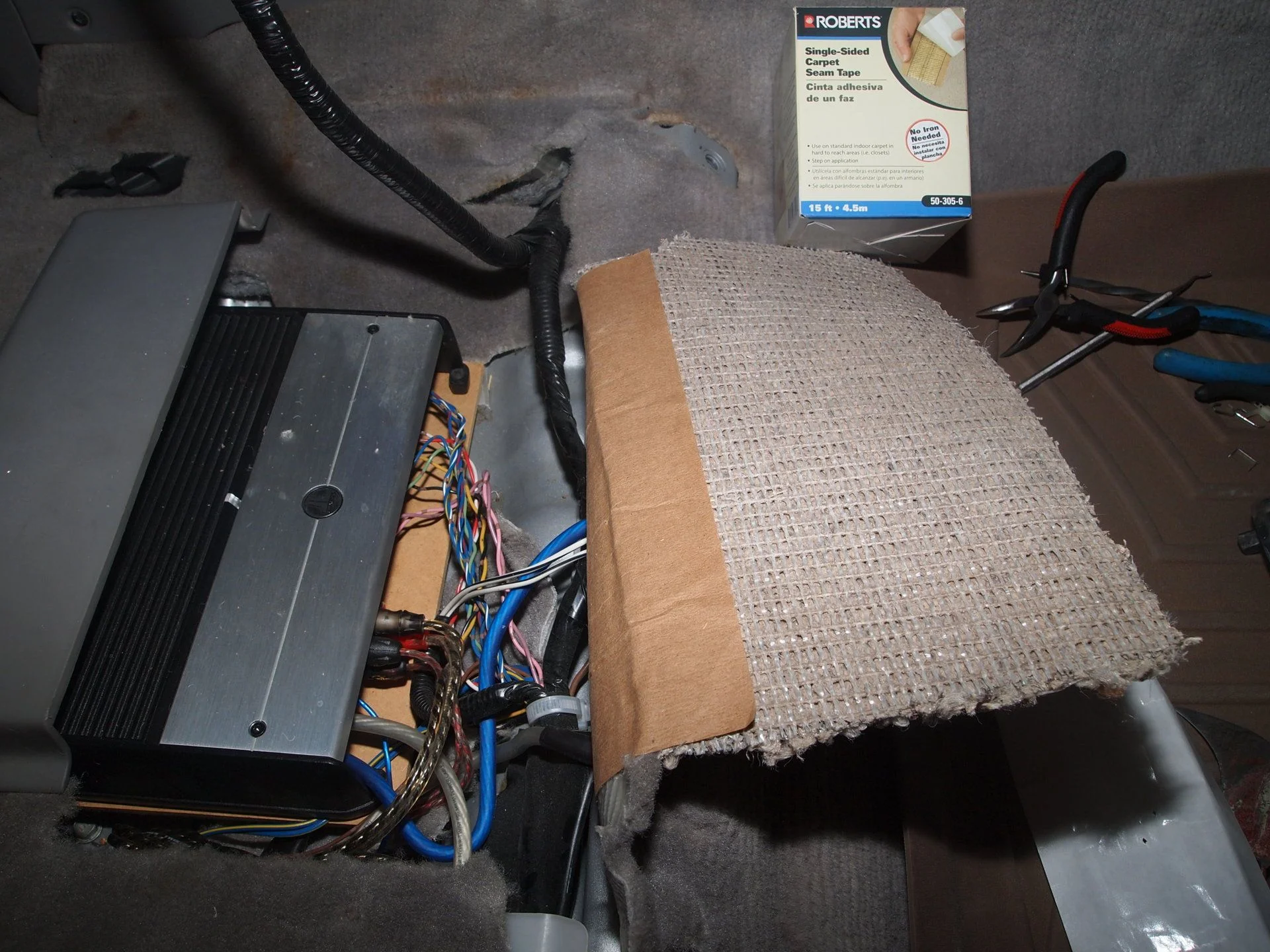

AMP under PS frt seat, need some clean up and modification. The installer cut the extra carpet off that bridges over the AMP. This created a potential problem, in that, the seats wire harness could drag into AMP speaker, power, receiver, etc. wires. The factory kept this extra carpet on to give wire harness a slide on both DS & PS front seats. It also helps debery and things dropped on front floor out, keep from building in the cavity.
After cleaning the area up a bit. I found a piece of new household carpet I cut and fastened with carpet tape. Works really well, just hope the carpet tape holds as I've never used it before.

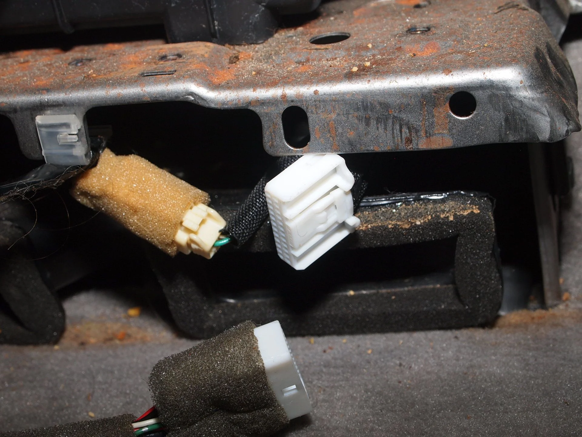

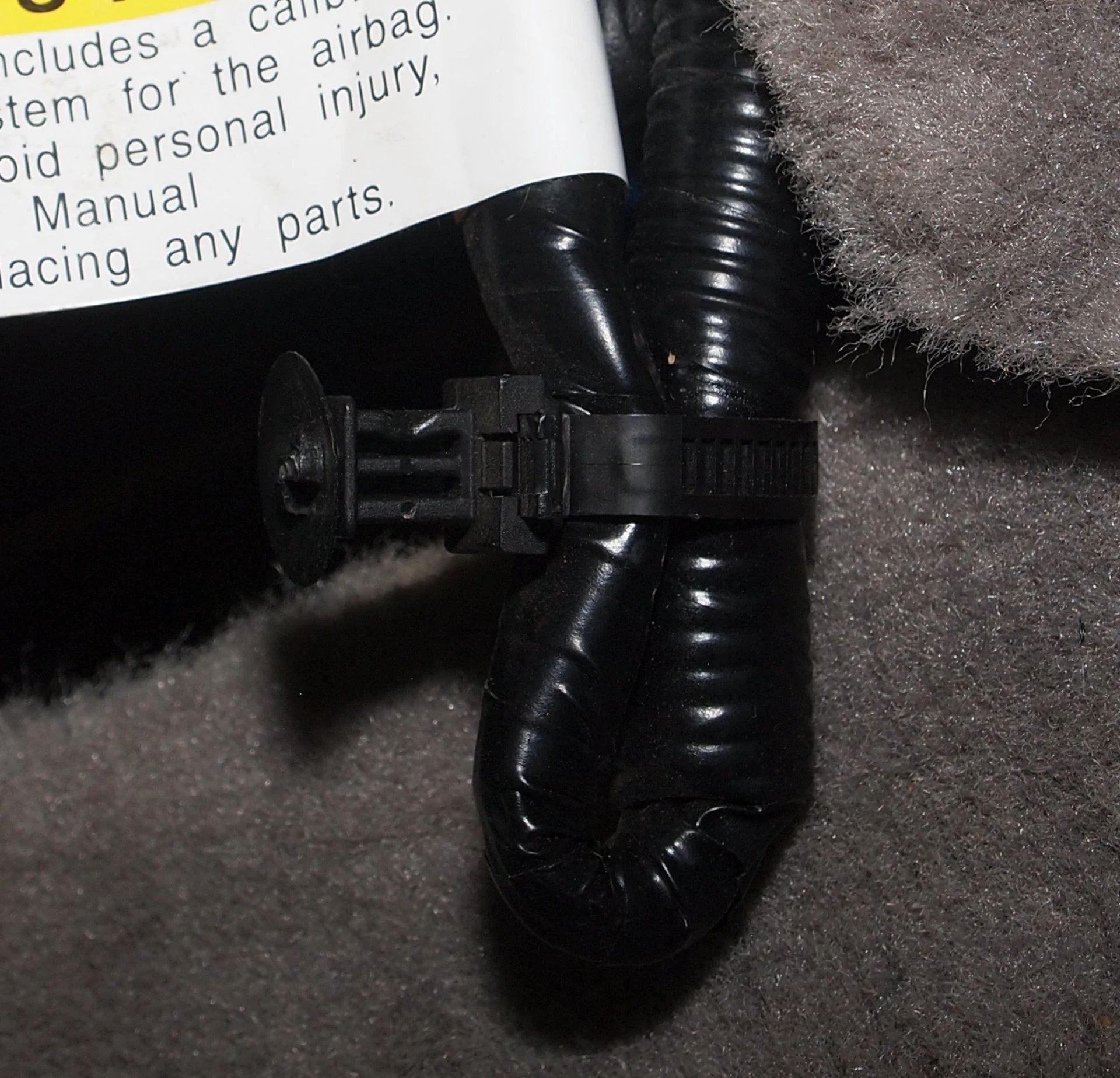

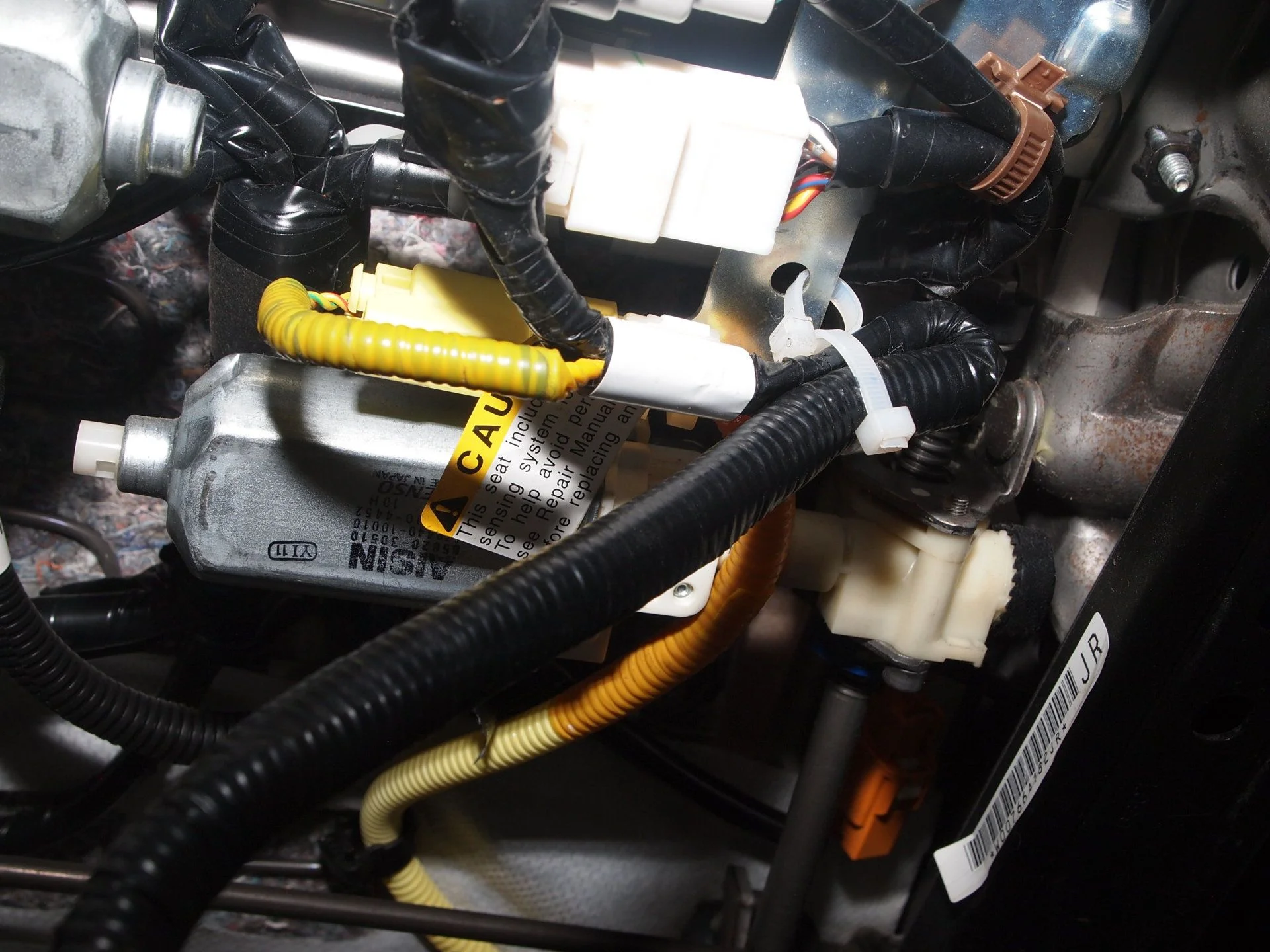

Radio installer also broke the clip holding wire harness to bottom of seat. This clip is not sold separately by Toyota. So I used two heavy plastic ties.

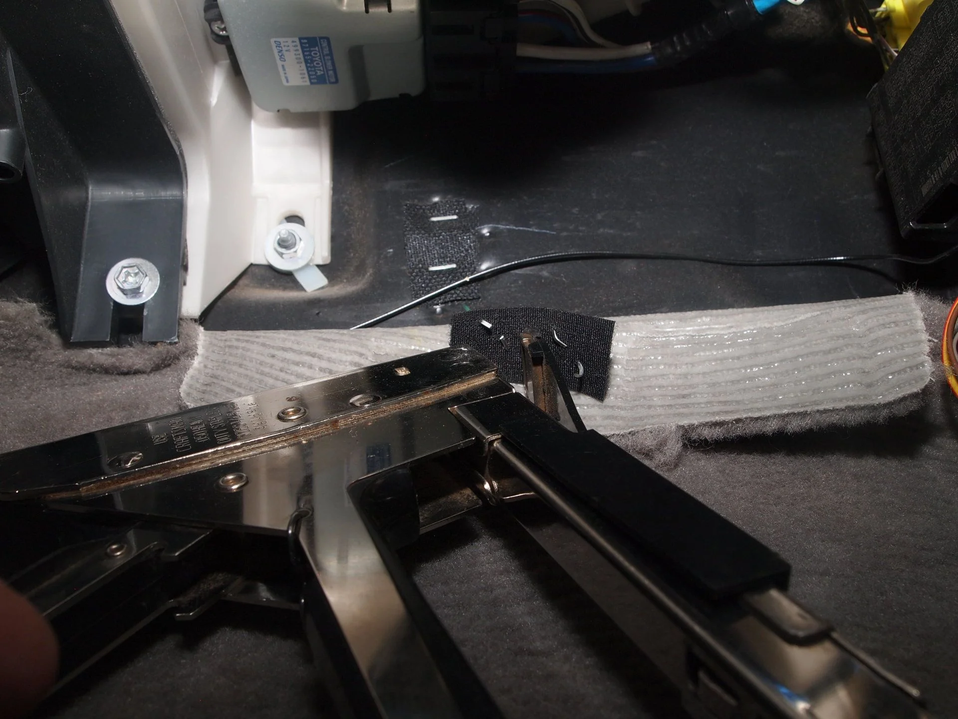

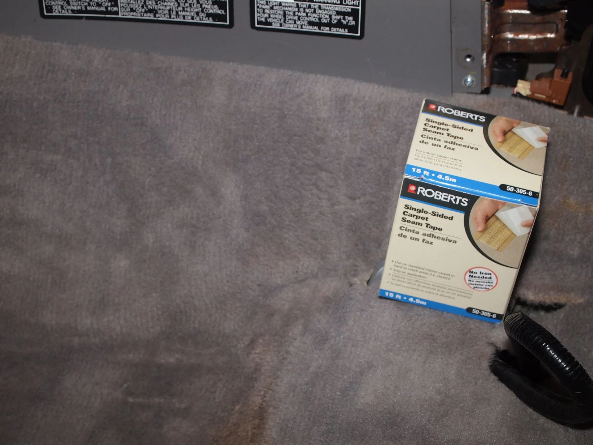

Additionally the carpet stay (hook & loop tape) in front footwell was yanked out of its staples. Likely rear GPS antenna installer again. I'm never happy with these aftermarket installers.
I simply restapled.
Wire is to rear GPS antenna.
View attachment 1710982 View attachment 1710984
View attachment 1711702 View attachment 1711703
I can’t believe they drilled a hole in the firewall and just passed some loom through it without a grommet....that’s impressively stupid:confused:

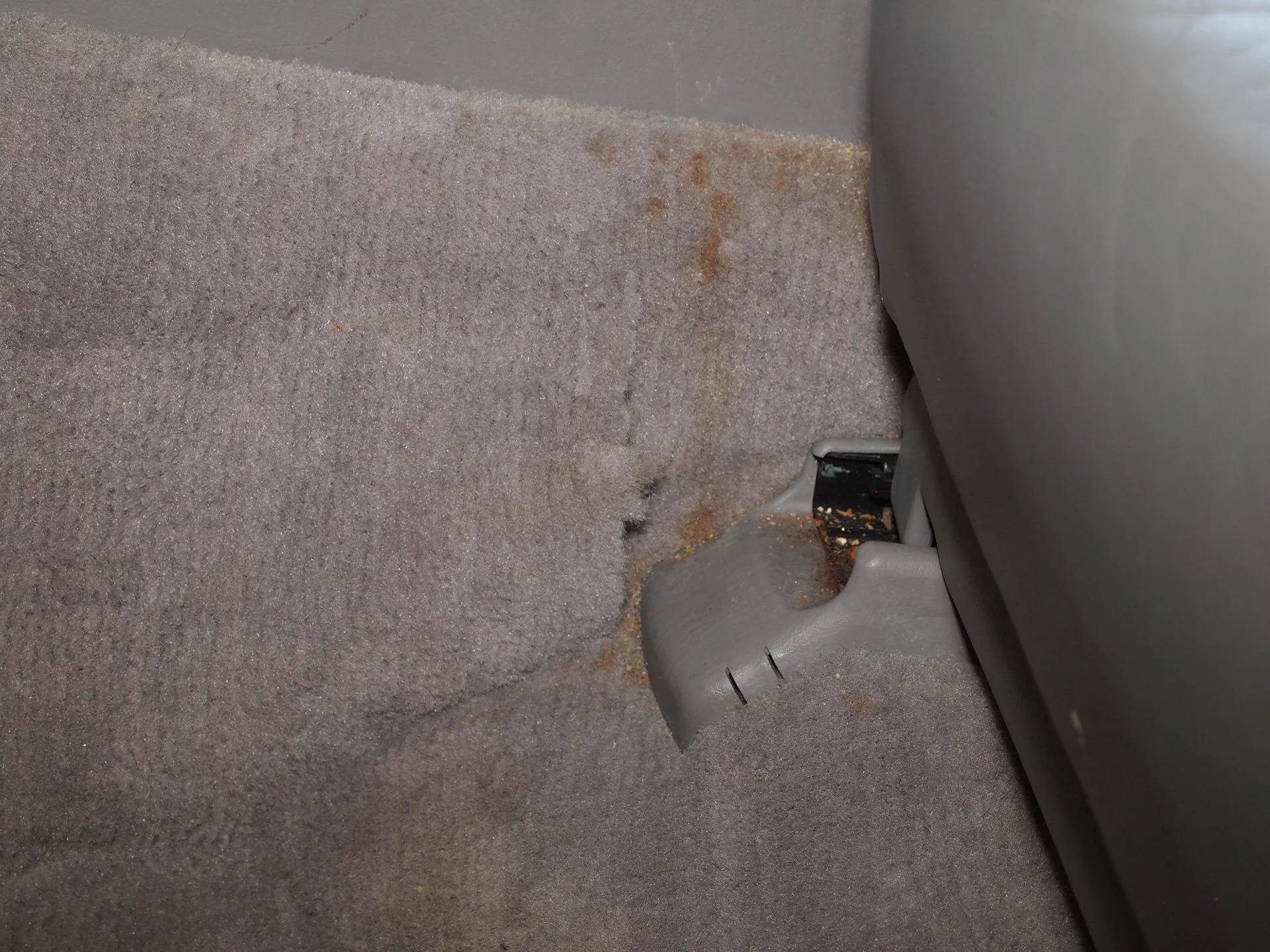

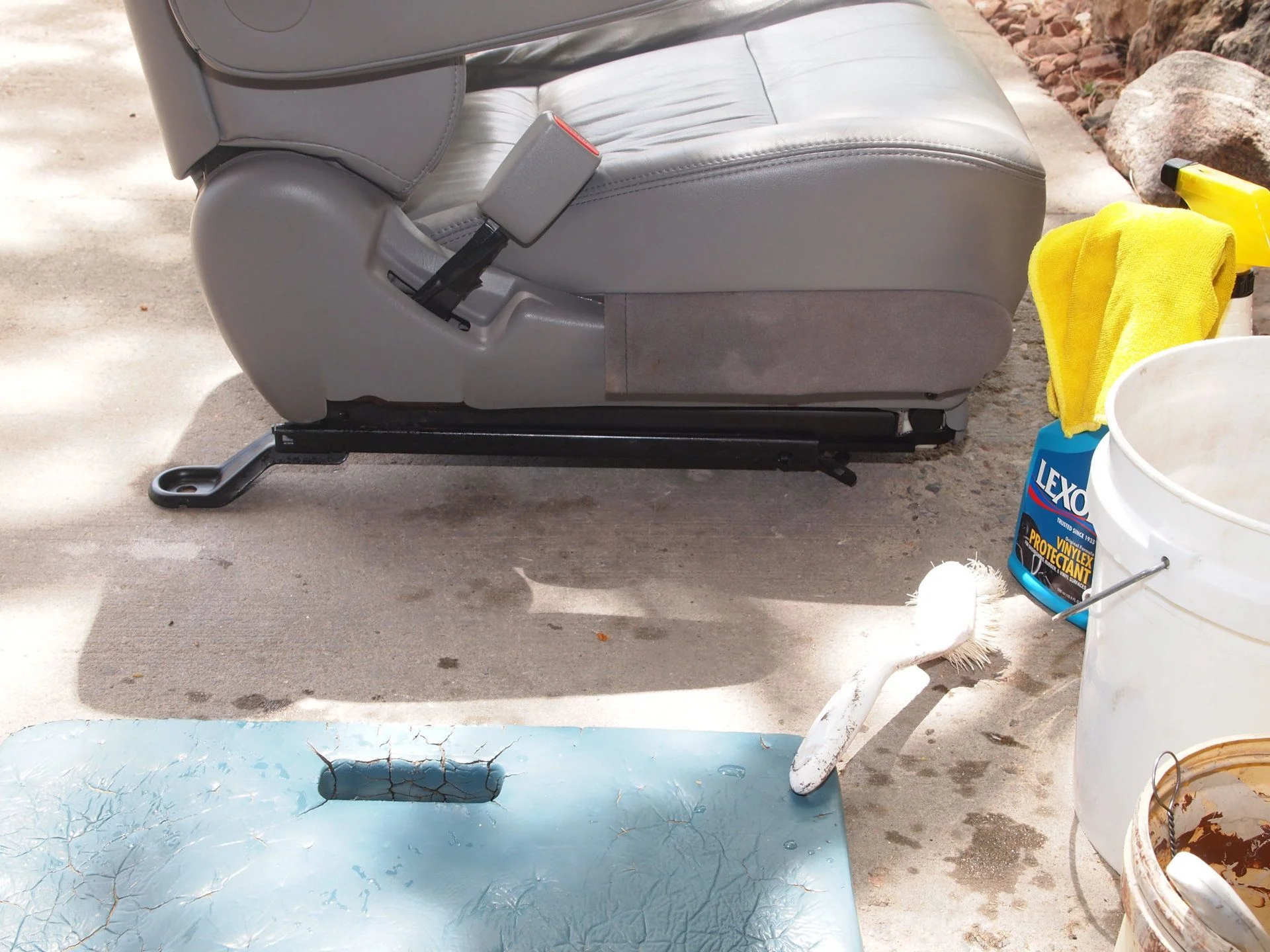

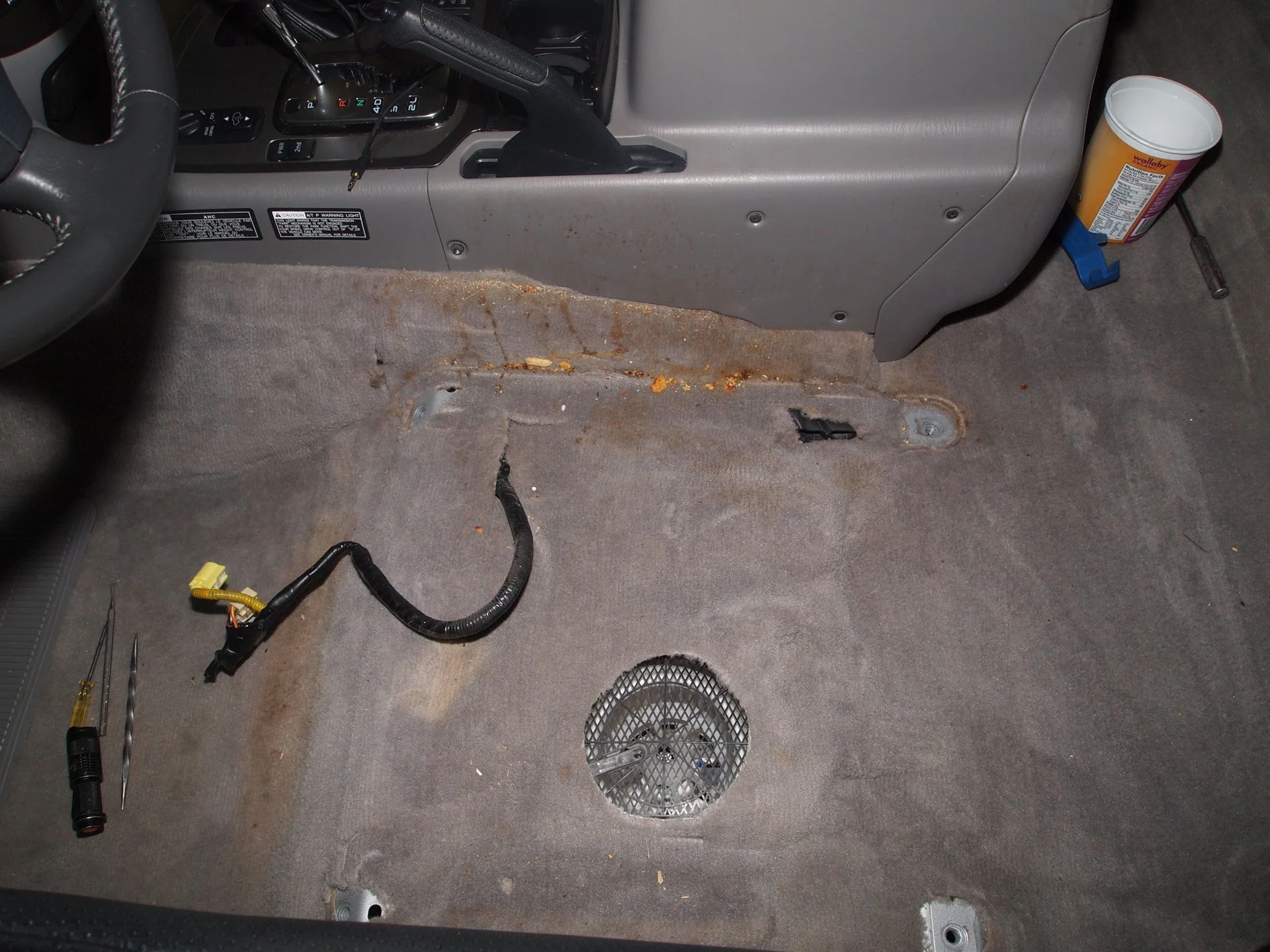

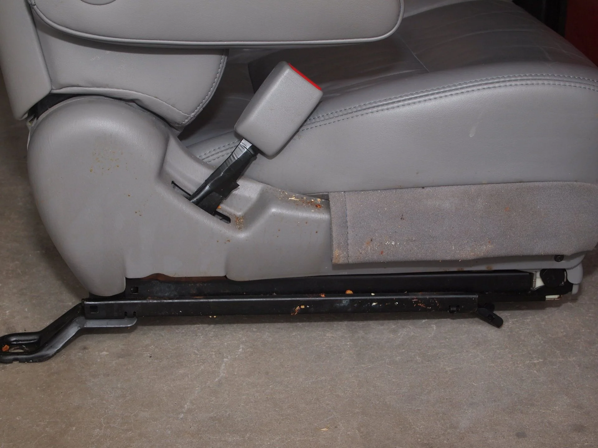

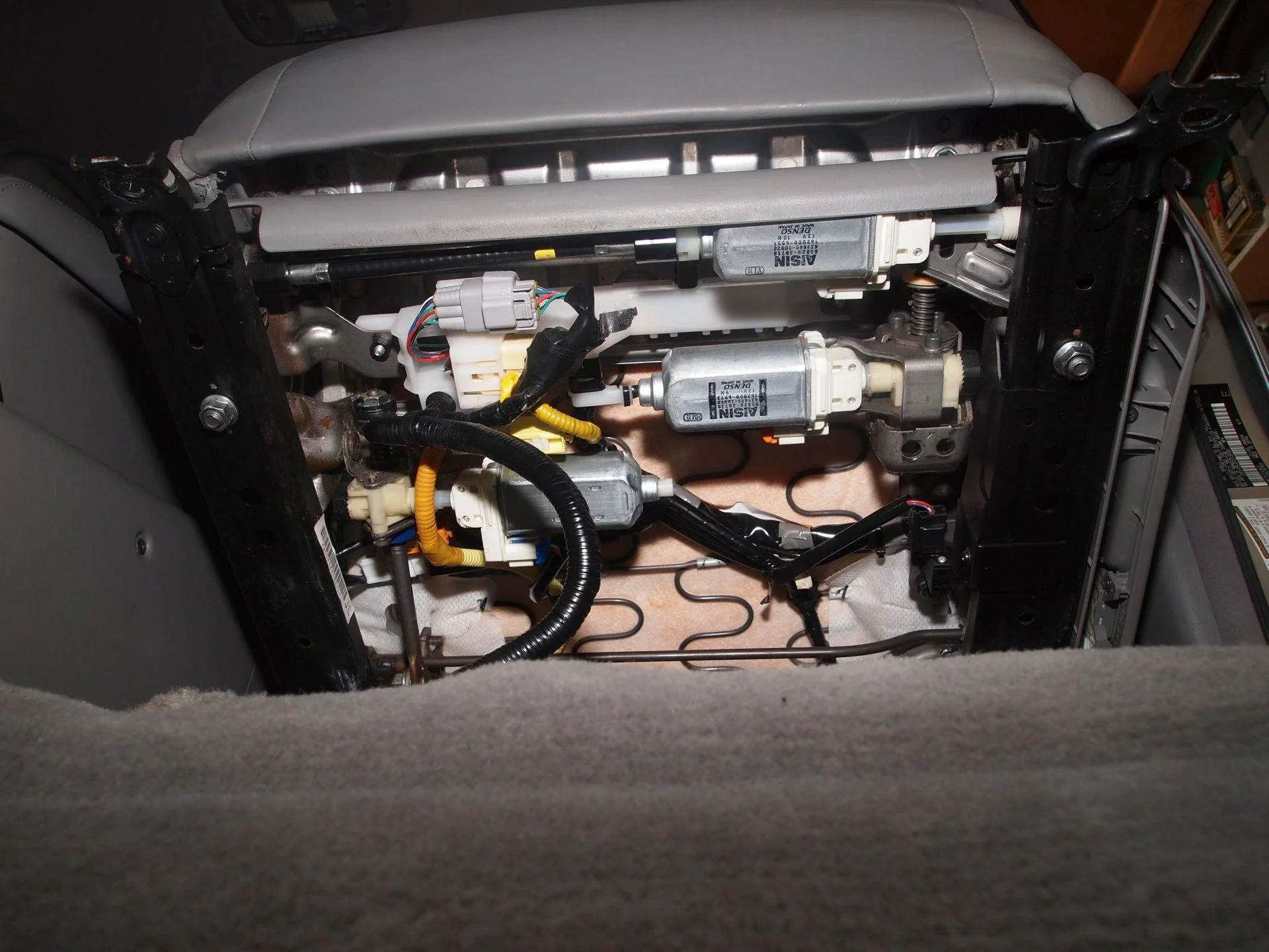

DS front seat was removed to clean up and repair carpet ripe. Ripe may have been something jamb between seat and carpet as seat was moved forward.
They not only drilled a hole and not sealing up, but made a clean path for water to travel down from roof gutter into footwell of DS. I really hate seeing any modification on our rigs by these guys. It just cause issues. One I've yet to mention yet, that has me pulling out what little hair I've have remaining.:mad:

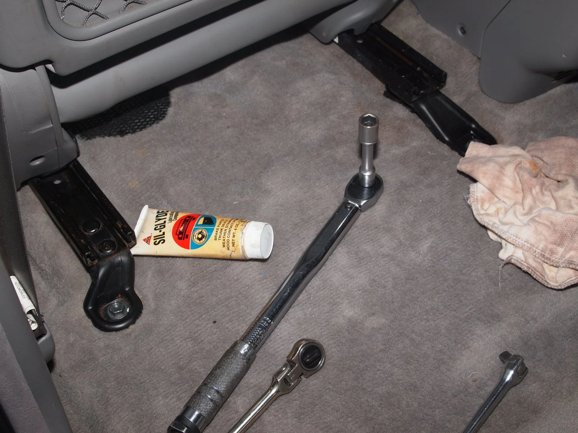

Having seats out also give chance to clean the inner side & rails.
Gavs chance to blow out rear heater blower with HP air to clean fins also.
It's important for safety, that all four bolts are in place and torqued to 31ft-lbf.

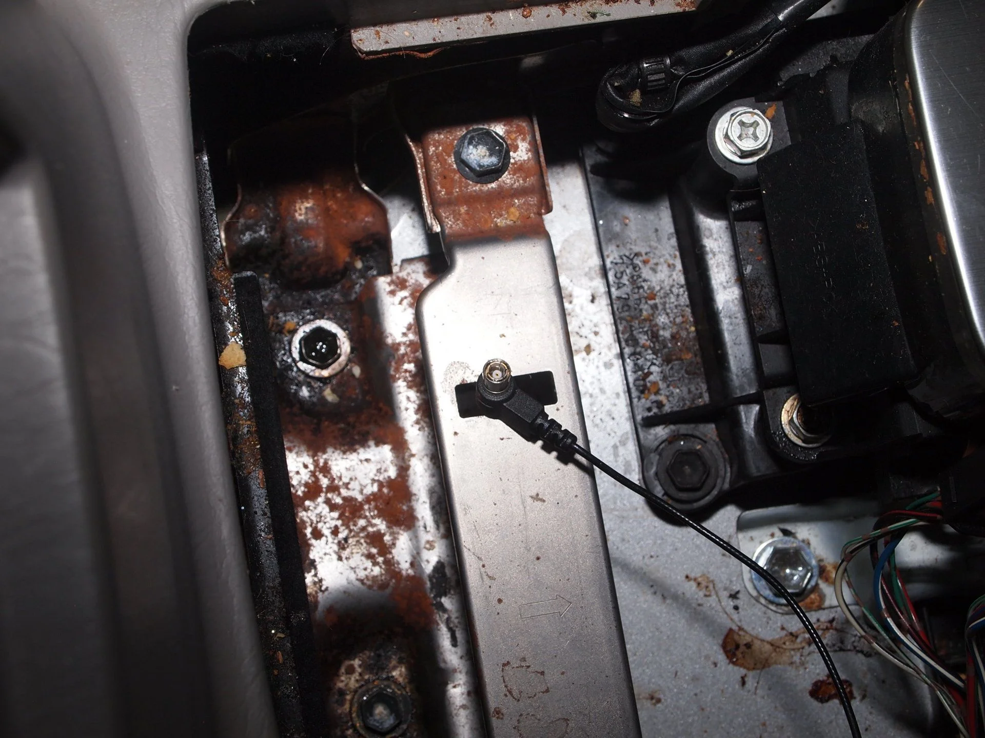

Found a wire hidden behind carpet in PS frt foolwell.

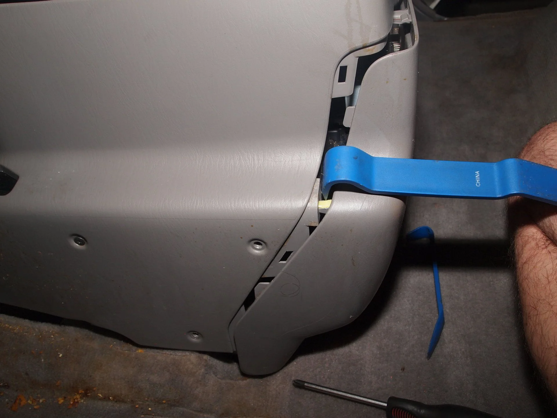

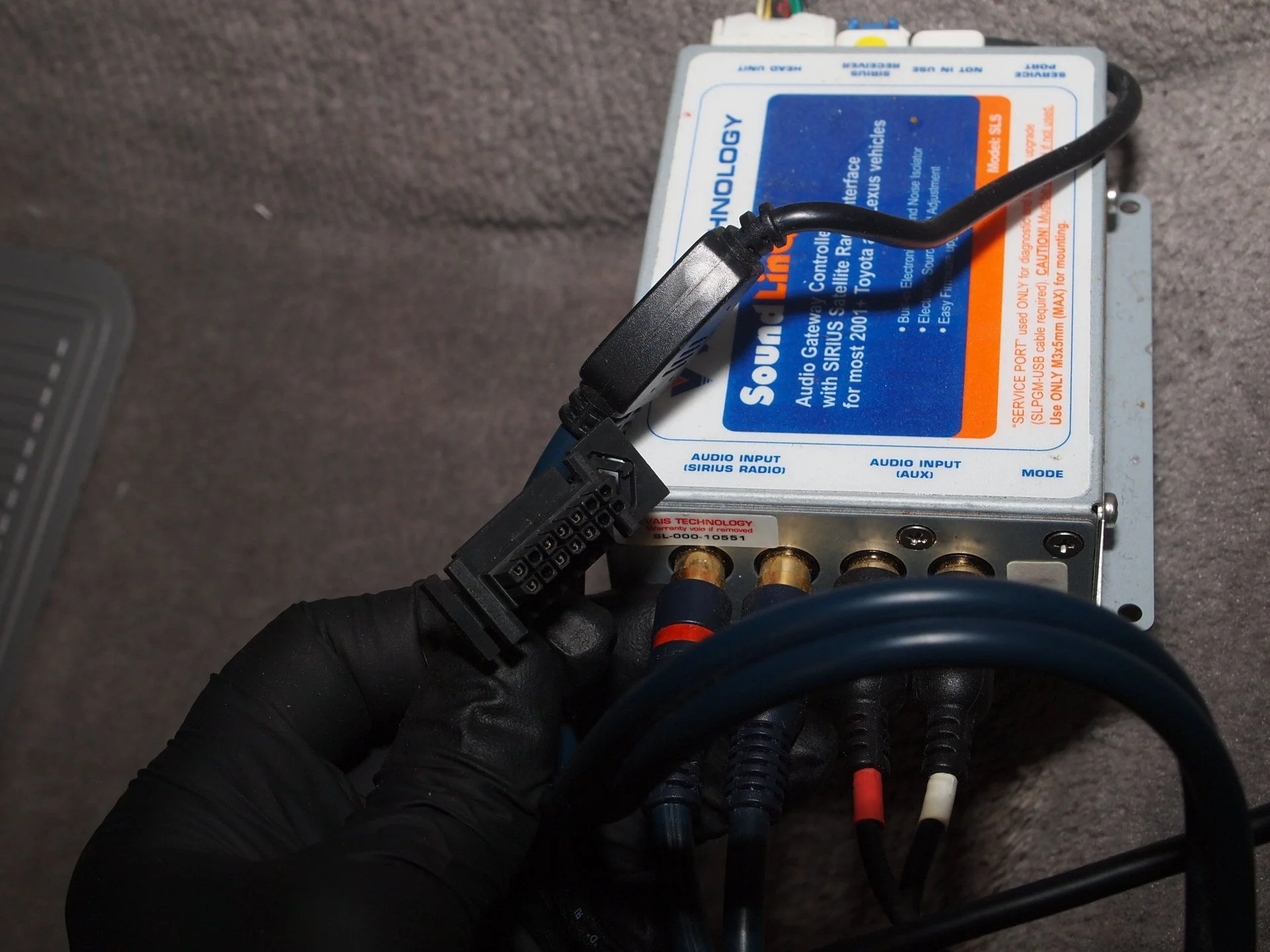

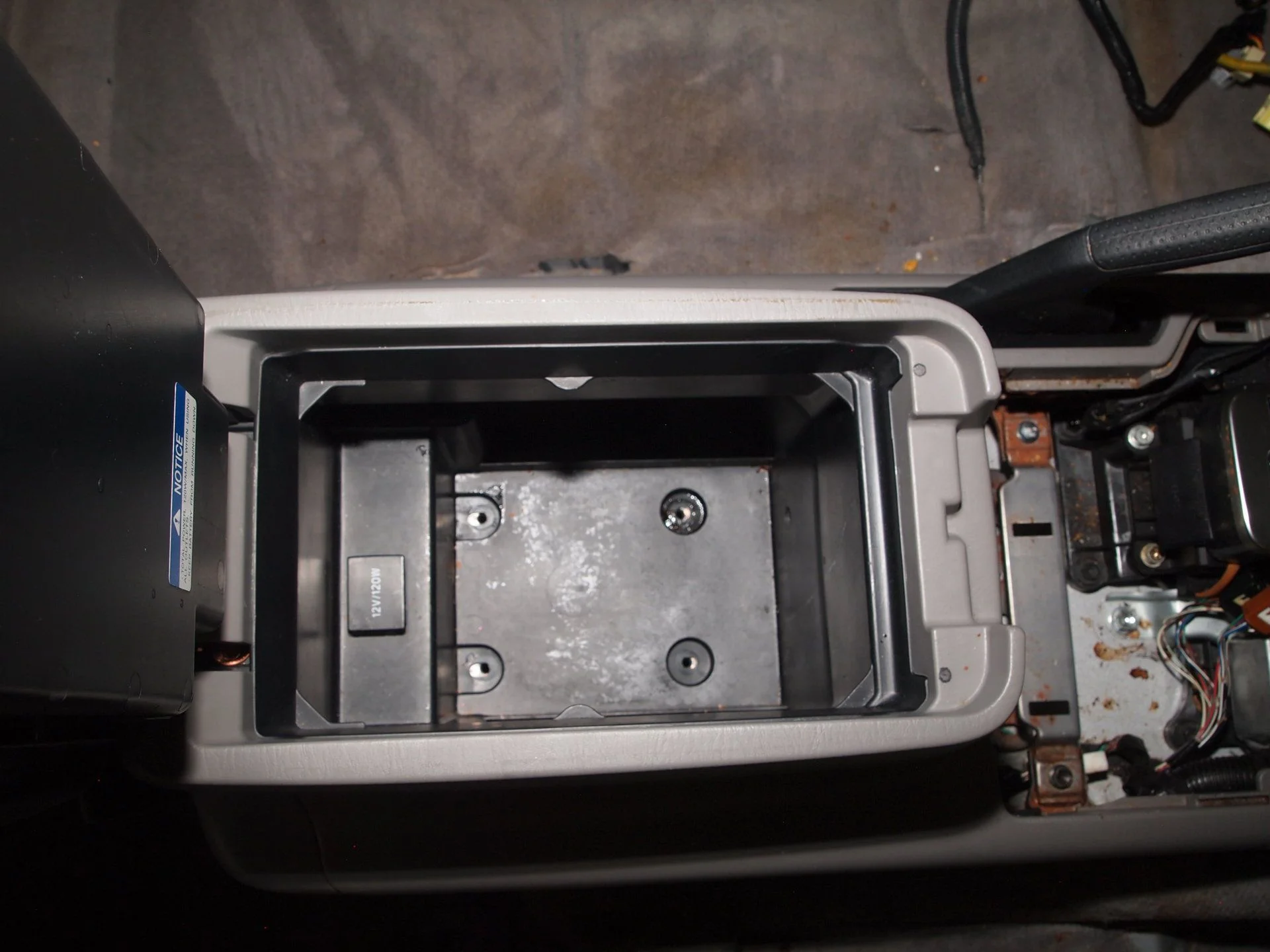

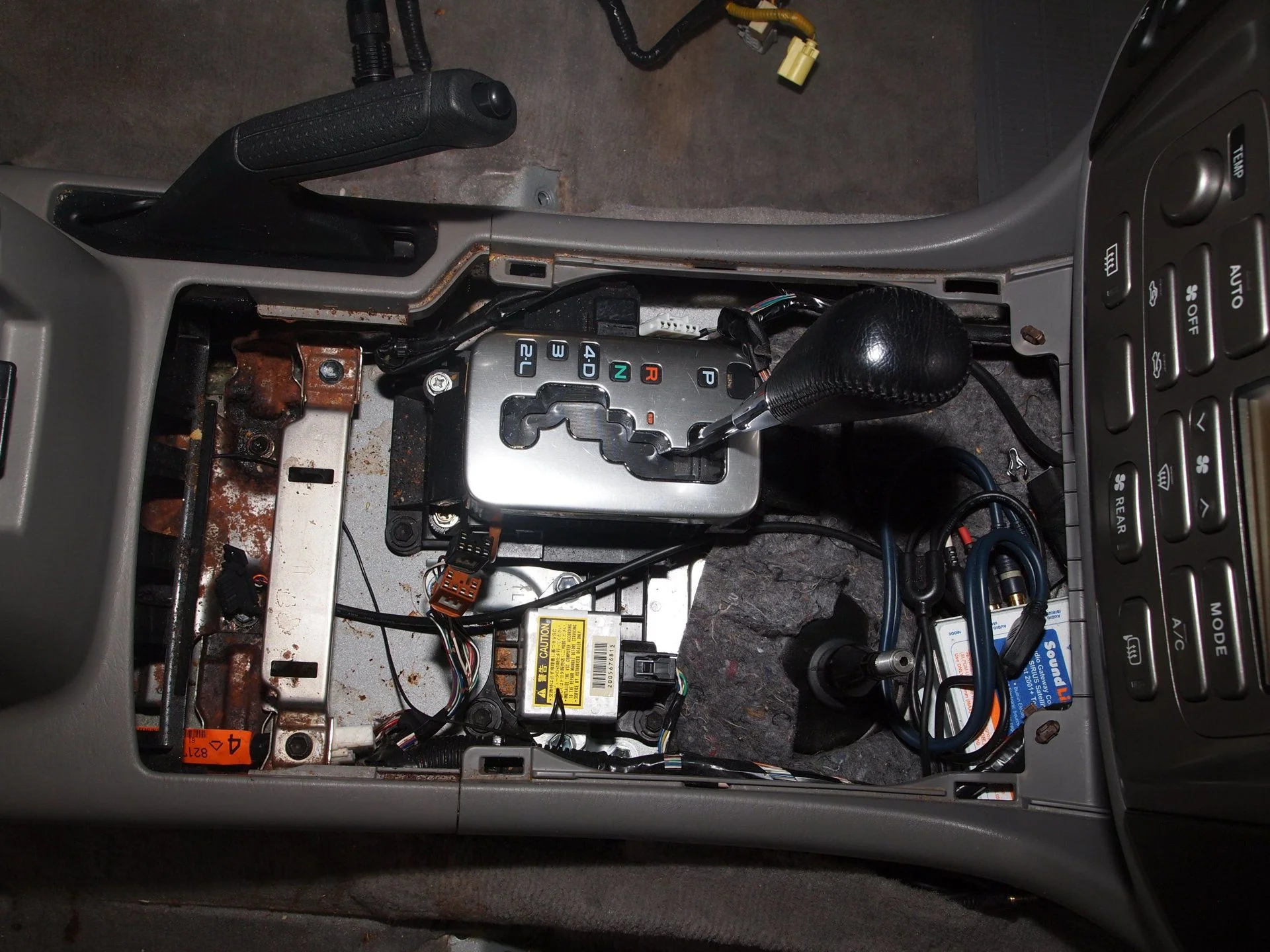

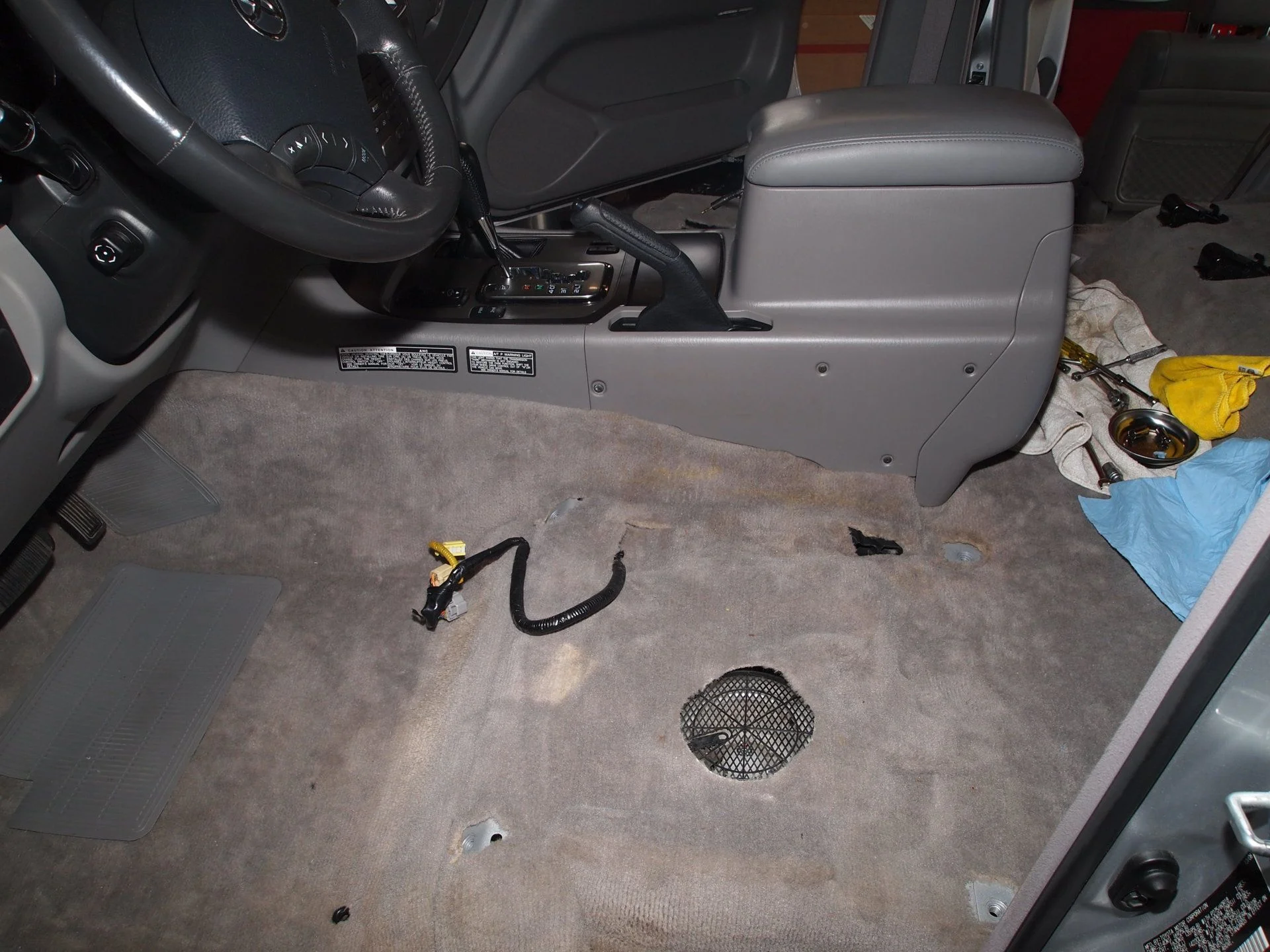

I decide to pull center console apart to trace wire and clean up spills from food and drinks.

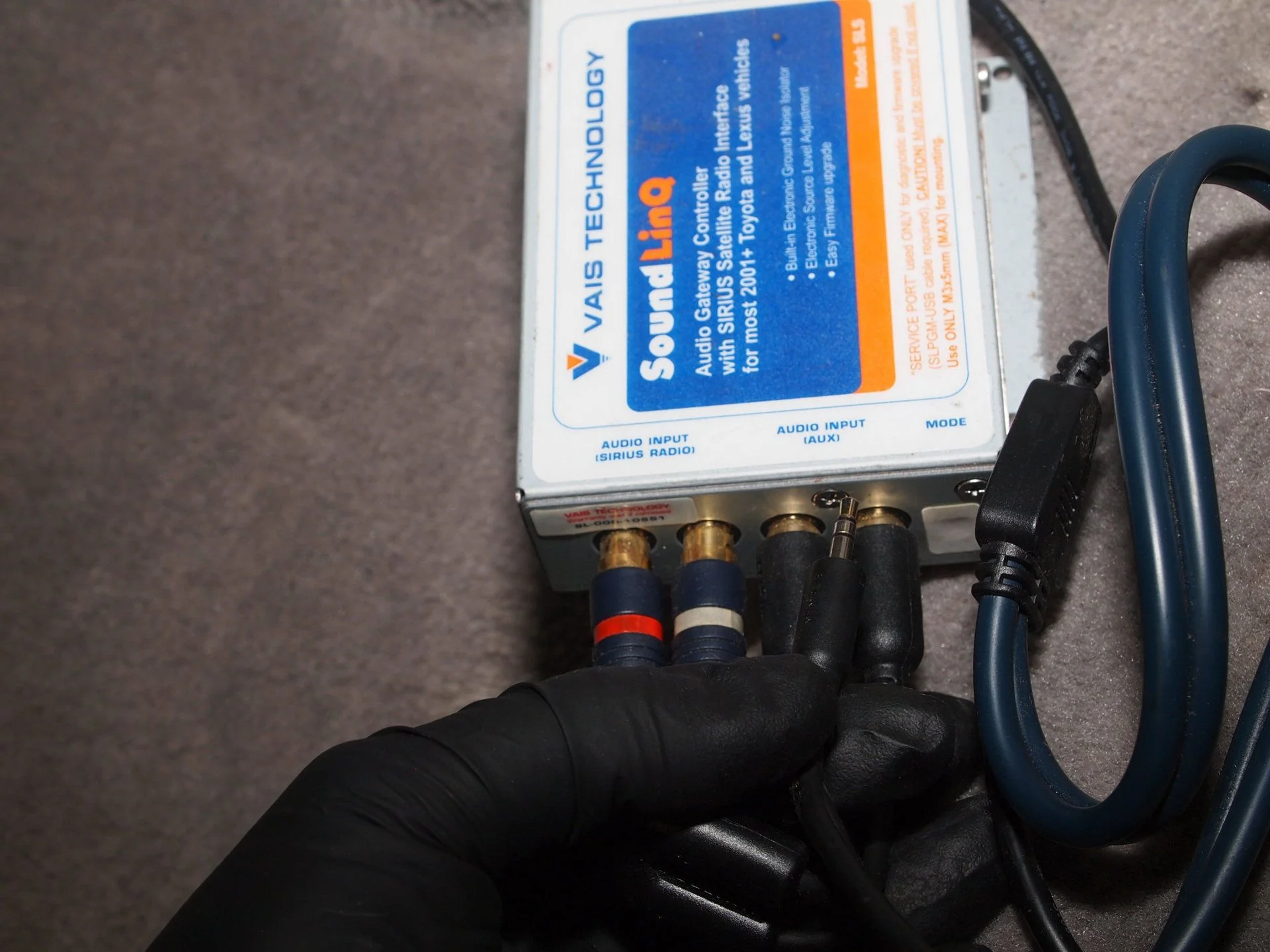

Found it to be and Auto input jack.
Found two more aftermarket wires while in there.

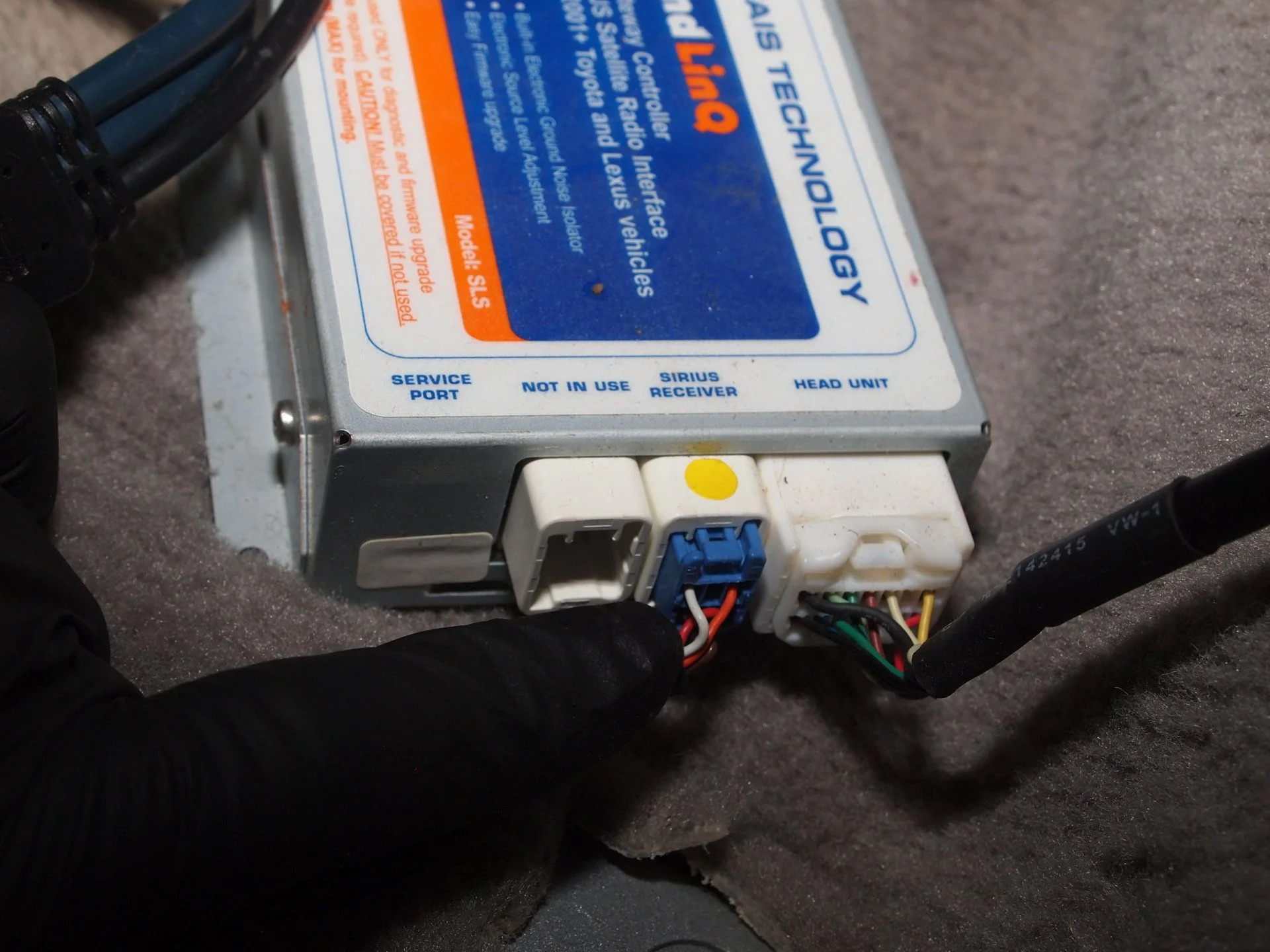

One turned out to be rear GPS antenna.
The other a hookup for Sirus Radio

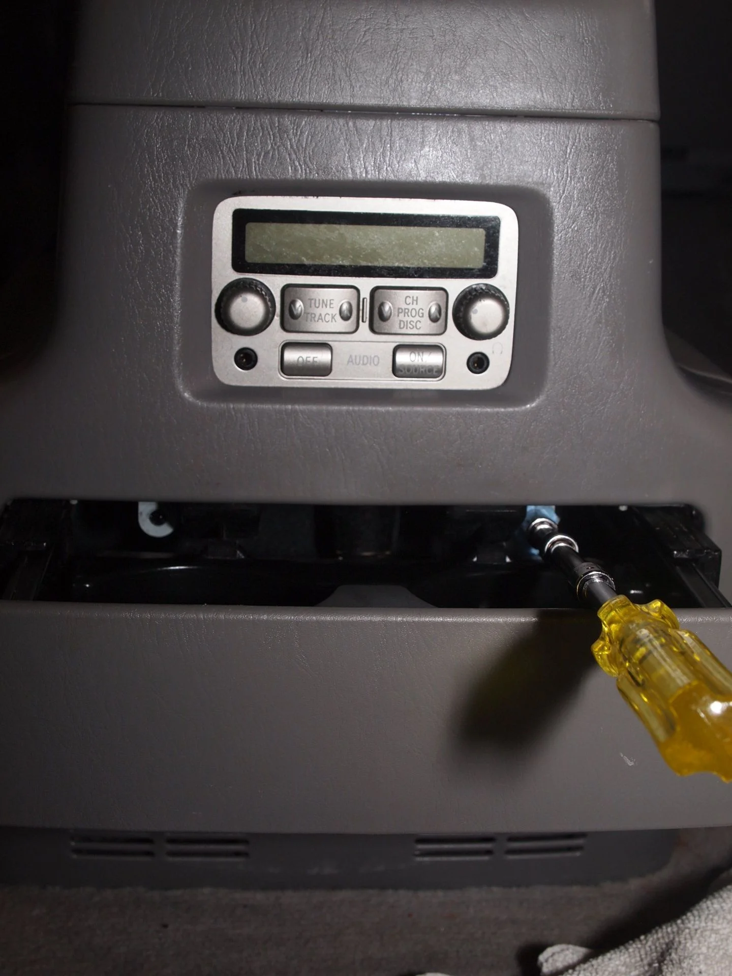

I continued pulling apart and cleaning inside the console.
The backplate doesn't need removing to pull console box, but makes getting wires & clip on back bottom disconnecting easier. The two screws must be remove first to do this.
These screws on both side do need removing.
Also the four bolts in bottom of box must be removed.
