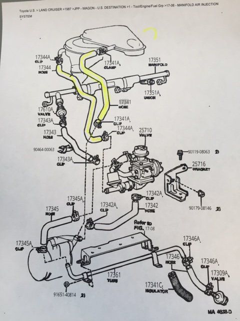

I've got another hose question for you. Did you replace the hoses that are highlighted in the attached diagram? I tried ordering them from Toyota and they are no longer made. I want to get new ones but am unsure where to go...
Console looks great! Impressive. Should be an excellent armrest for you.
Hello: No, those are the rock hard original hoses that were one the truck when I bought it. You might try talking to Beno
here on Mud. He is the OEM parts guru. If it is available, he can get it or tell you where.

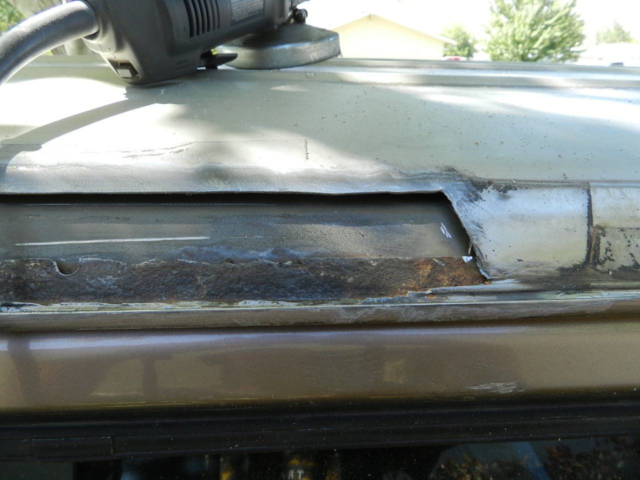

Time for the dreaded rust repair. This is what the outer shell looked like after paint removal,not to bad.

But wait, there's more!!!!! This is what I found underneath. Rust is a gift that keeps giving.

Here are the some of the patch panels I have fabricated. I will paint on Rust Encapsulator to cover the inner shell rust before moving on,and will also use weld through primer on the back side of the panels. The plan is to stitch weld the panels in place. I will post more pics as I move forward.

My plan is to remove the side glass and part of the headliner before welding. When I get to the front the windshield will be coming out also.
