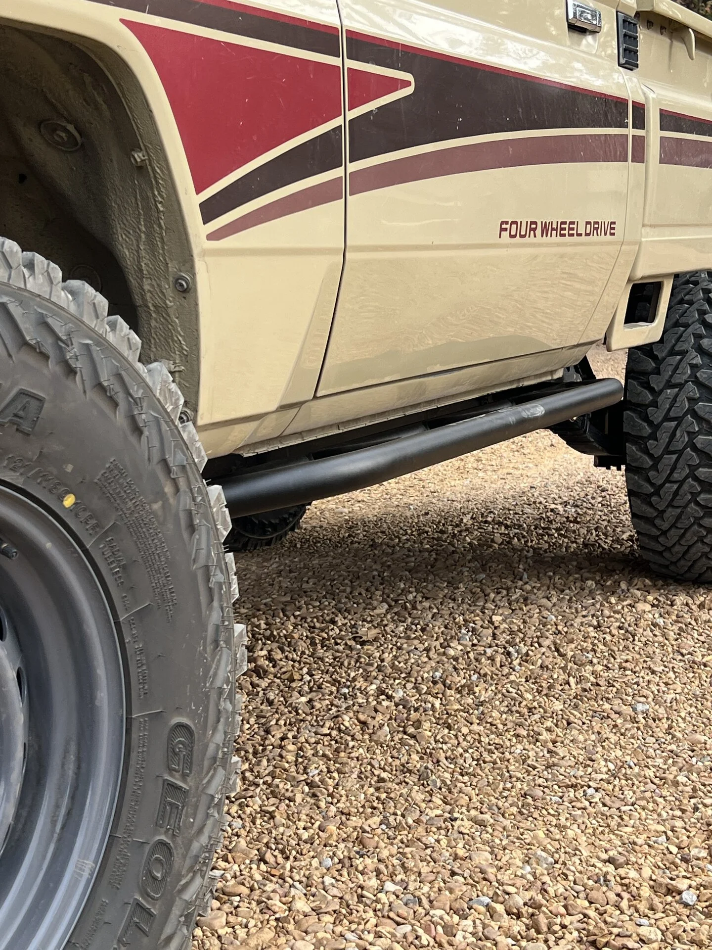

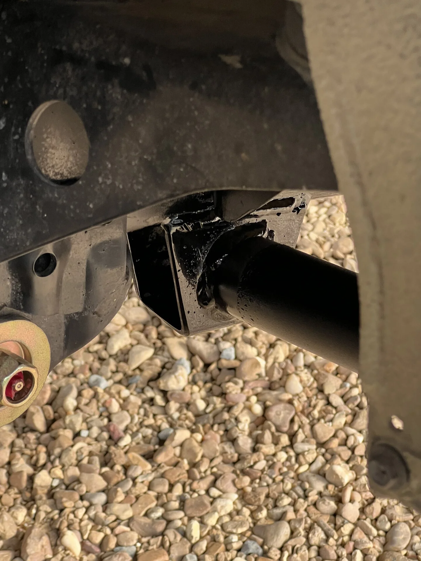

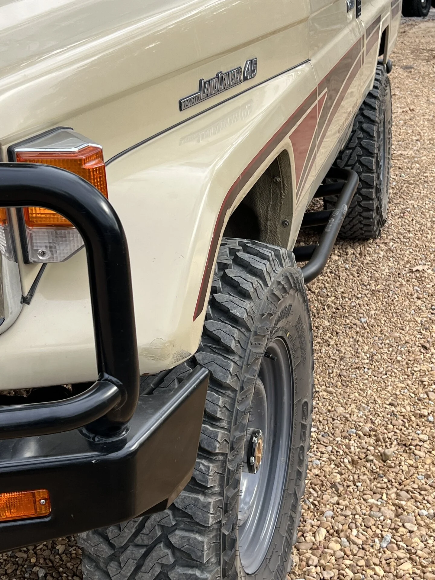

Disclaimer. We only did 2 spanner bars. Hopefully these will just be used as heavy duty steps and not hard core sliders.
These are the 58” Trail Gear weld on sliders.
On both sides the the wizard made drop brackets behind the spring hangers and scab plates on the rear. Turned out nice.

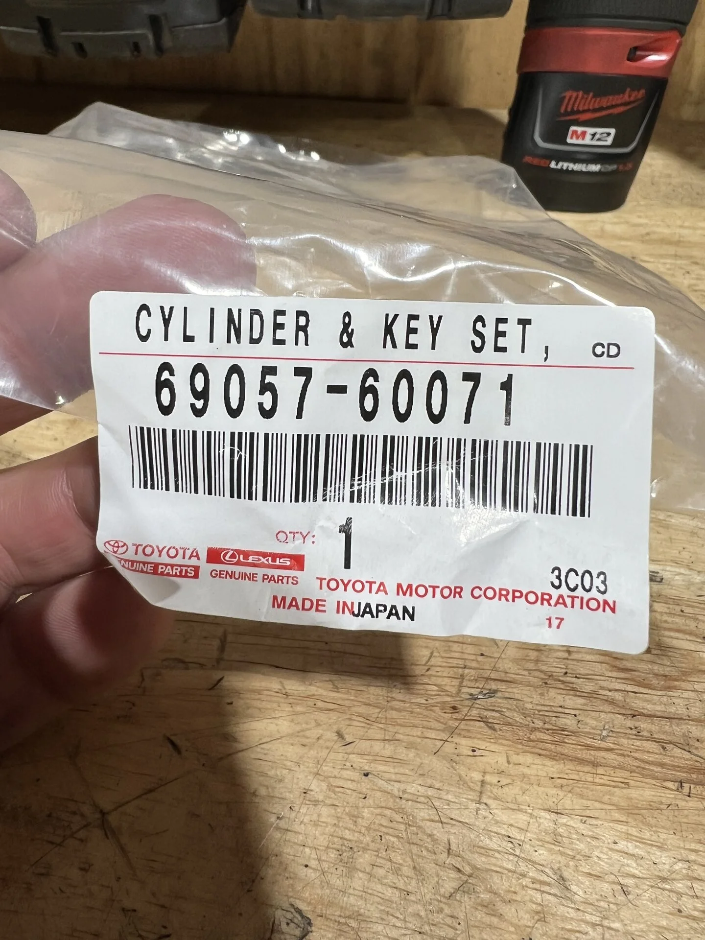

Picked this one up and installed a new ignition switch today. Thanks to @OGBeno I got the right one. My search had turned up the wrong PN.

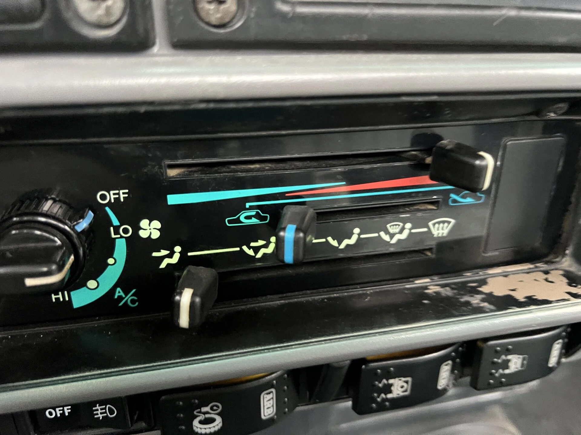

Just picked this one up to put a new door key assembly in it. Freezing rain hit and damn if the defrost selector won’t move it from vent. He lever slides freely but it’s stuck on vent.
Anyone have the steps to fix this?

The slide from Vent to Heat to Defrost is not doing anything. It moves but it’s not sliding whatever it needs to slide to direct air

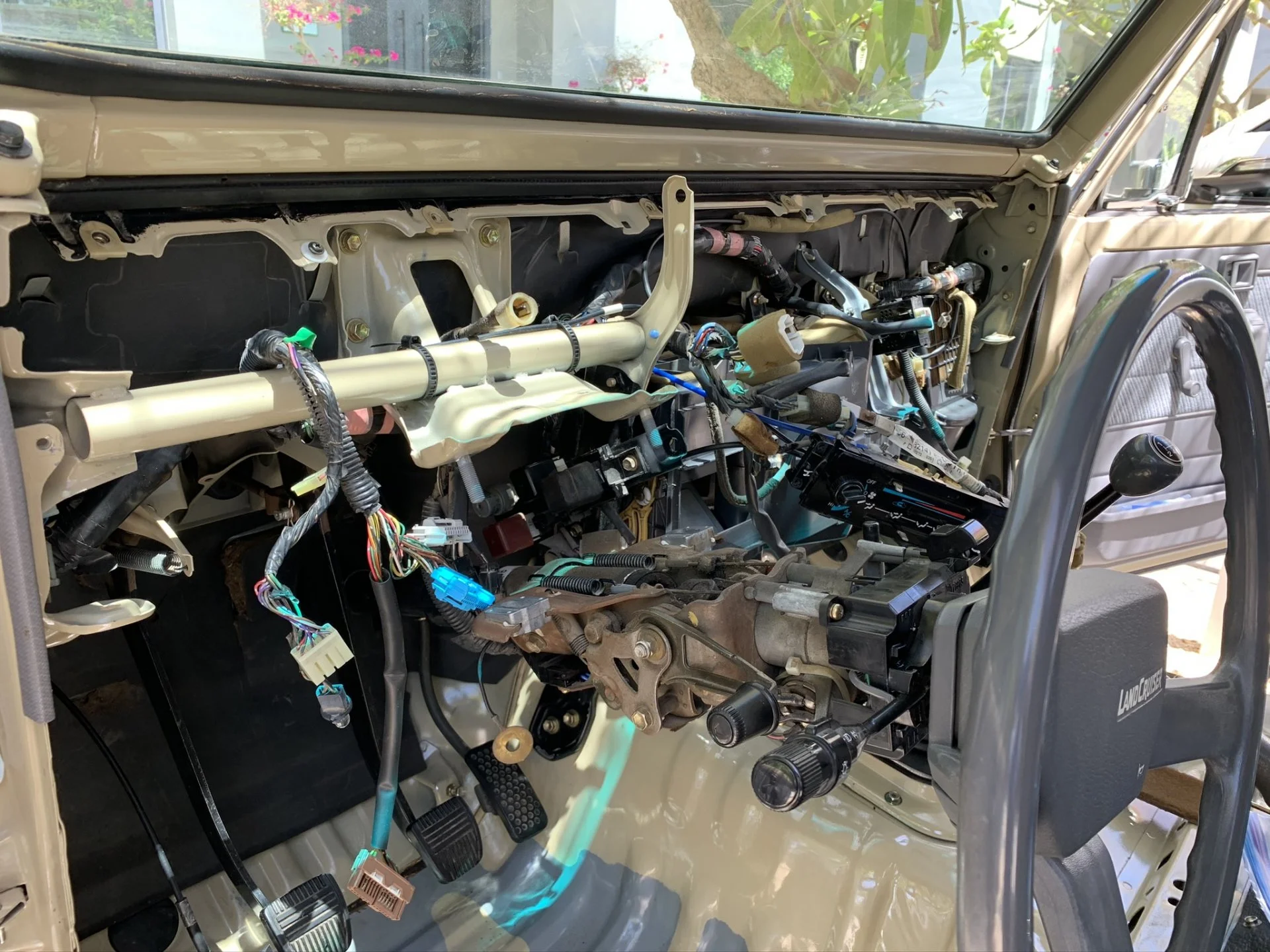

Sorry but I don't think there is an easy fix. Here's a photo of it all apart if that helps at all.
Remove the surround around the HVAC controls and then remove the panels on each side. You can generally remove everything a piece at a time. All of the controls are push pull cables (as I'm sure you know) and they generally go to very simple dampers that only move 90 degrees +/-. You can take this all apart without removing the HVAC faceplate.
Apologies but I don't recall exactly where the defrost, etc. push pull connects but it will be easy to follow it as you pull panels. I don't know any way to address this issue without removing the panels.

That lever gets stuck in old age. It is usually due to lubrication, or the lack thereof.
You just have to remove the rectangular faceplate around the AC control panel. There is no need to take the whole dash apart.
In a nutshell:
  1. Remove the faceplate. Six screws.
  2. Disconnect the clock, cigarette lighter and the four switches below the AC panel. This will allow you access.
  3. Remove the knobs from the levers and blower switch.
  4. Remove the panel plate. Be careful, it may break.
  5. Remove the lever assembly. Four screws if I remember correctly.
  6. Very gently, pull the assembly outwards.
  7. Disconnect the blower switch.
  8. Disconnect the panel light bulb.
  9. Check every lever and its cable.
  10. Adjust the cable if it is loose.
  11. Lubricate the lever pivots. Lithium grease or Vaseline are good options.
  12. The Vent/Defrost lever responds well to lubricant. Check for proper operation. If necessary, let the lubricant penetrate for a while.
  13. Reassemble.
Hope this helps.
