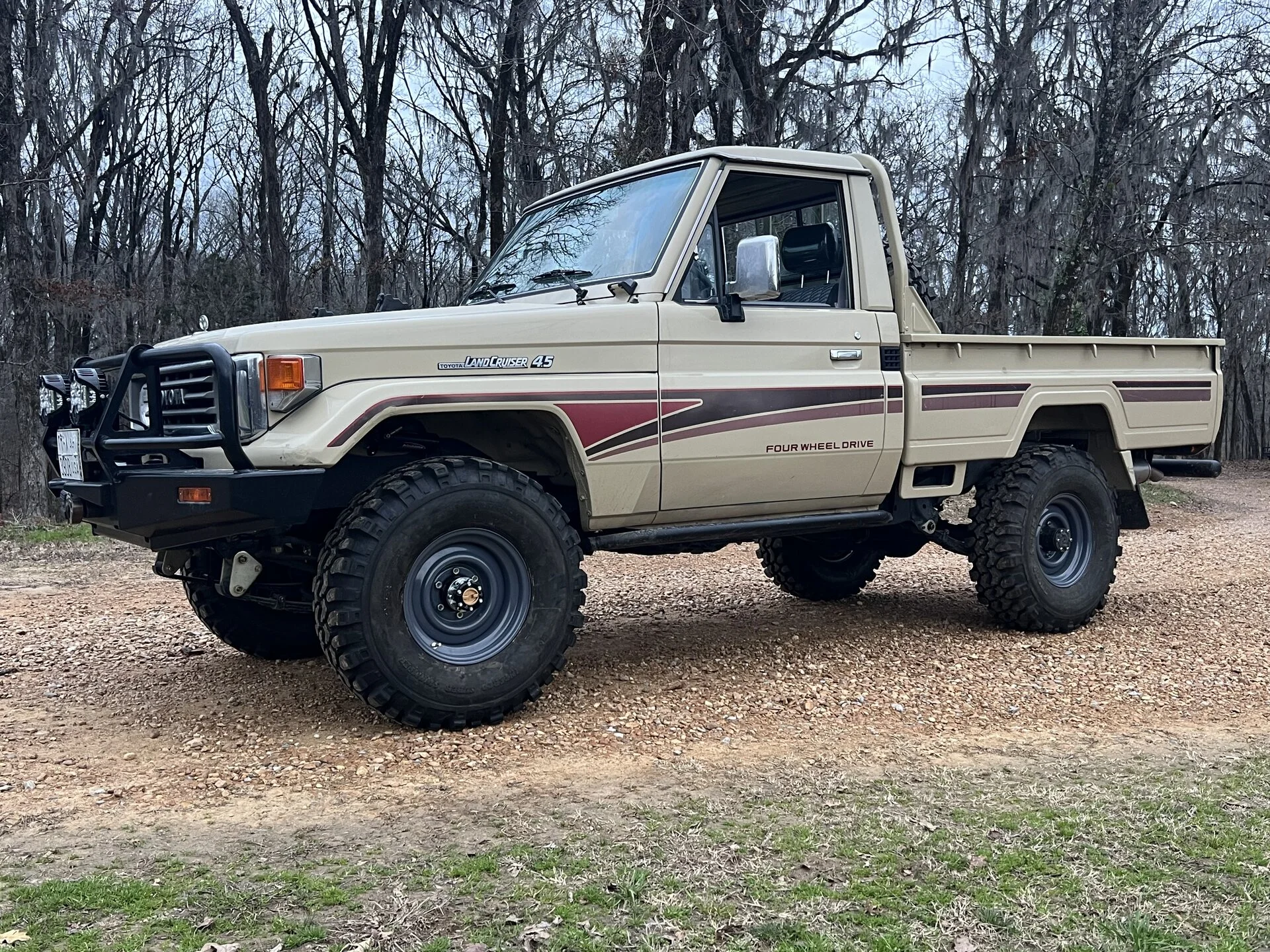

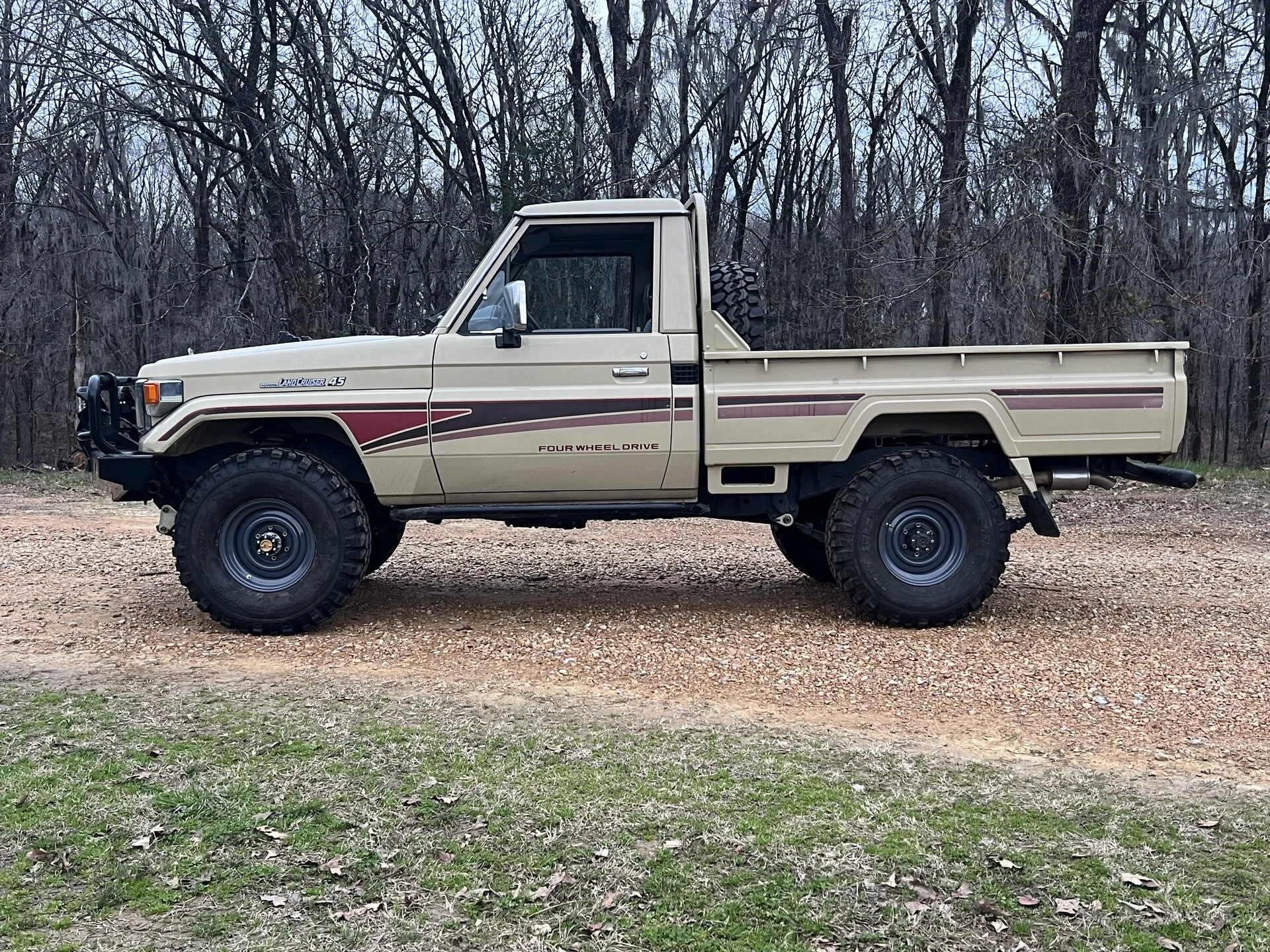

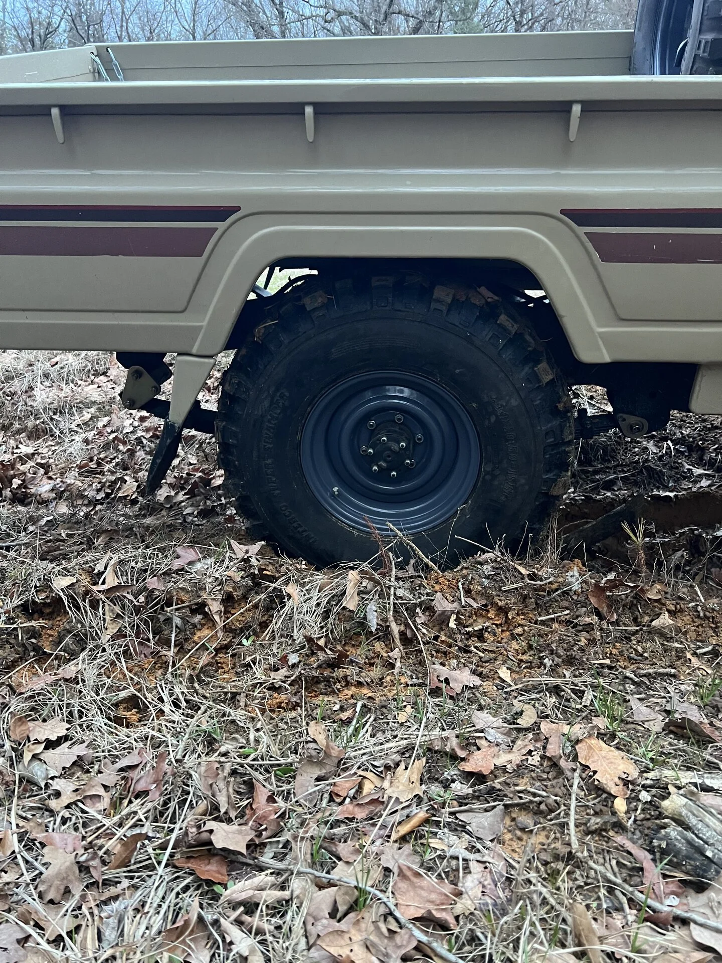

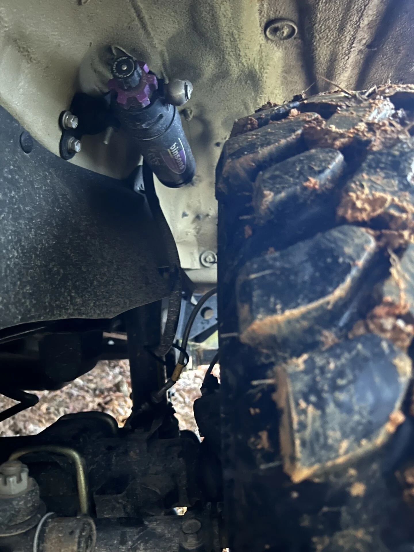

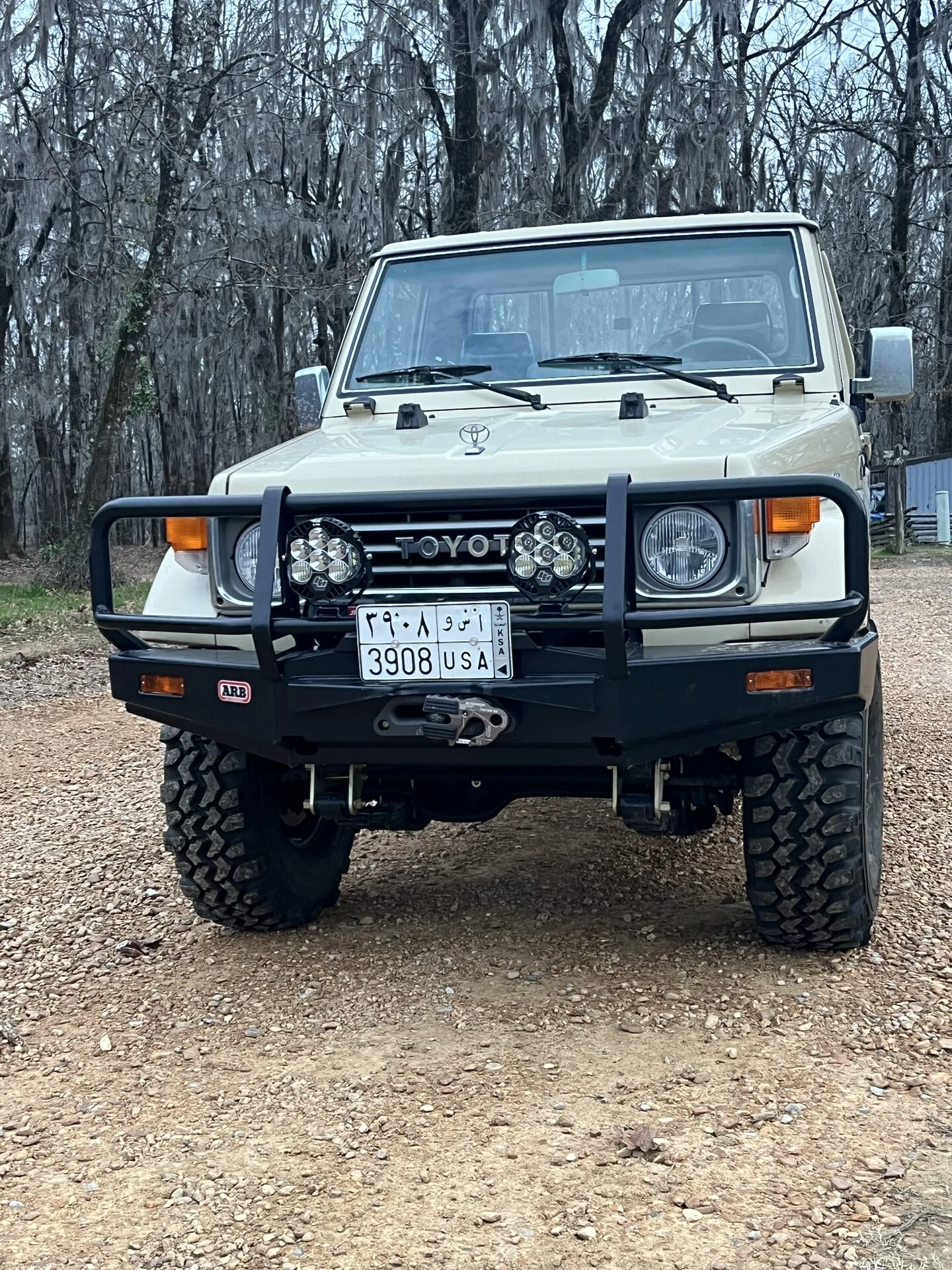

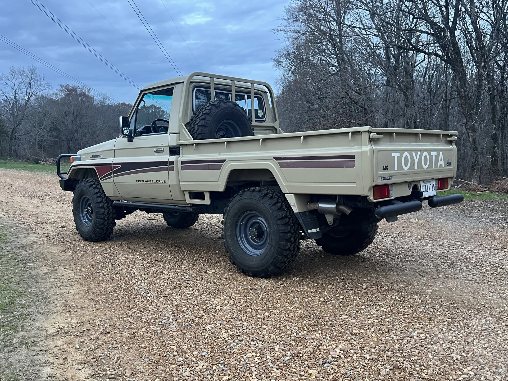

So……..neither of us liked the way the 285/75-17s and 3” wide big brakes looked on the 75 so ….
Off with their heads.
Back with the 70 brakes and no spacers and the comparable size SWAMPER LTB

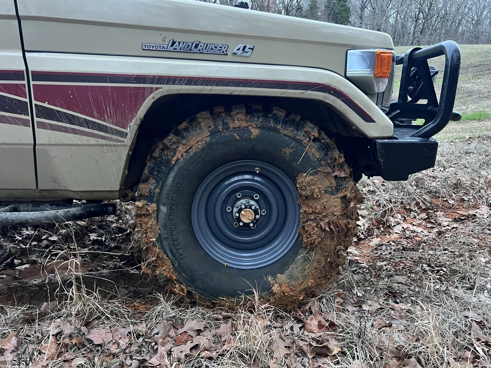

34x10.50-15 on smoothie Vintique wheels.
Jonathan already owned the tires and wheels from another project. Was I buying this combo new I would recommend using the 16” Smoothie Vintique or City Racer 16’s and 34x10.50-16 LTBs. I had to run a 1/8” slip on spacer to clear the tie rod end on the front with these wheels.
Slight tub rub at full stuff in the rear but not enough to worry about.

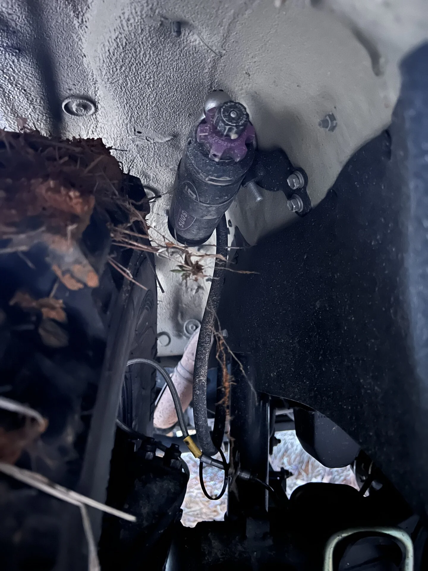

How do you like your Dobinsons adjustables?

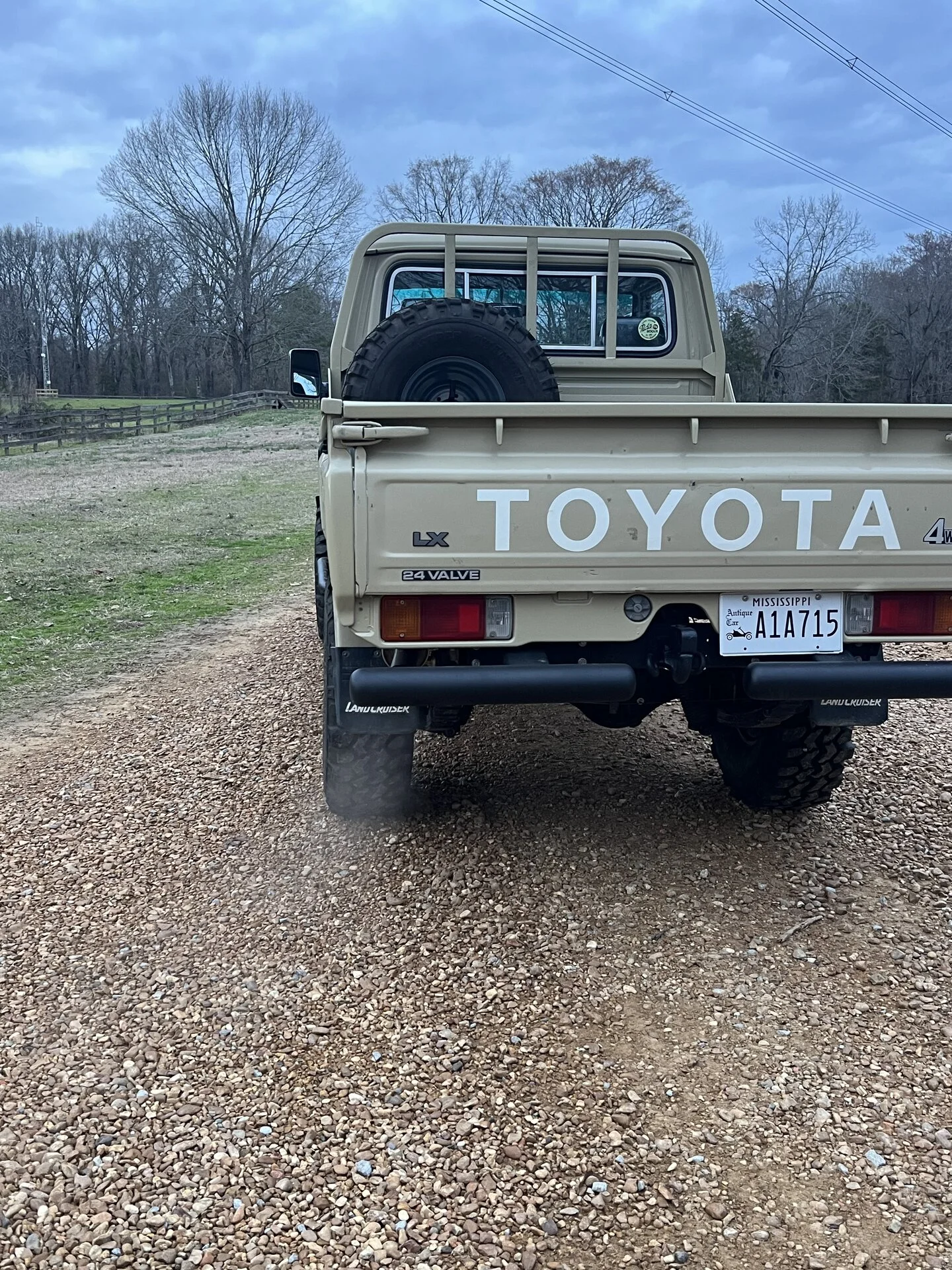

Looks like the seller/PO upgraded to the optional more modern J70 rear view mirrors, which is a nice OEM upgrade.
If you work on the suspension, flip the shackles left to right so that the fixed end sit outwards like on the current J70's with a fuel tank under the rear, otherwise the spare wheel is in the way when servicing the shackle bushes or even greasing up greasable shackles.
