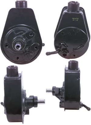

Does that one have the keyed shaft also? The reason I ask is I have a pulley from MAF and do not need another. My pump casing (the reservoir) is bent and so it will not seal properly around the pump.
Sweet. Thanks.
Looking at the pictures on Rock Auto, my part number is a threaded keyed shaft and all of ones Blue has listed are the smooth press fit shaft.
I don't believe so. From the pics, you can see that there is internal threading for installation/removal of stock pulley, but I can't see any keyed shaft. From looking at Manafre's pulley, you will need the keyed shaft. Doesn't look like this one will work for you.
