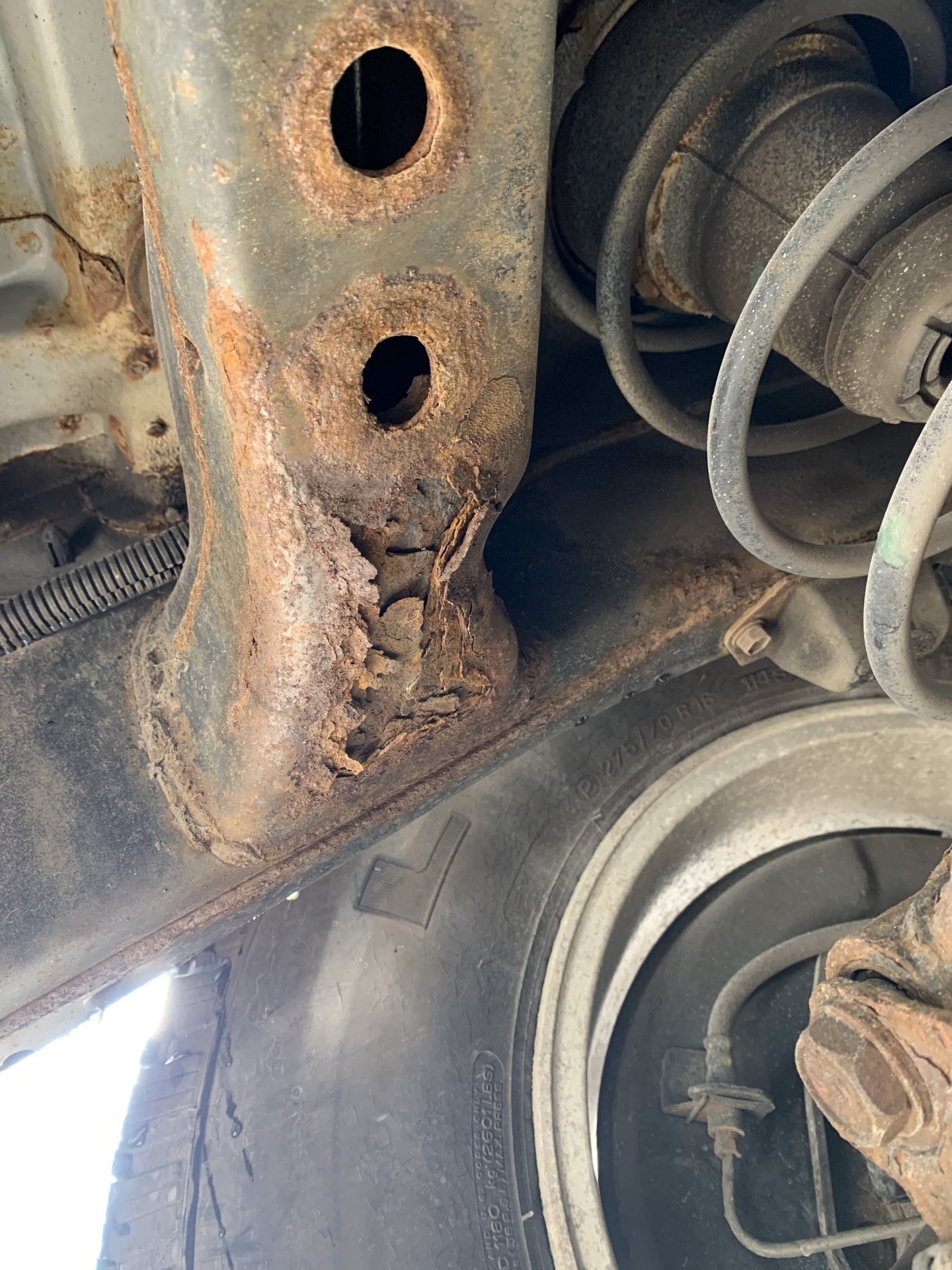

I found my dream 100 series for what seemed to be a reasonable price (6.6K prob negotiable down to $5800) right near me (New Jersey)
Body looks great. Good color. Ran decently. But... BUT when the snow cleared and I got underneath I was horrified by the rust I saw.
please help, I’m no expert, so is this a run-don’t-walk situation or does the rust not matter / can be remediate at the above price.
I live in illinois and i'd run away from that. there are tons of less rusted 100s out there for that price. it's what you can't see.
Justify rusty trucks all you want. It's not just the structural stuff. It's not just the appearance of bubbles and holes in the body. Working on rusty trucks just plain sucks. Bolts strip. Bolts break. A 10 min. job turns into a *%#&ing project - extracting bolts, rethreading... Nope. Not worth it. You Rustbelt guys are not held captive. Get the &$*@ out of there and buy a S.E./S.W. truck. There are PLENTY. As mentioned, these aren't rare classics. The number of trucks that'll die in the N.E. because an enthusiast relocated one is statistically insignificant. Time for a road trip!

Rust paranoia is justified with 100s because there's still a healthy market of them. Yes, they're getting longer in the tooth and finding really nice ones is tougher, but they are not so rare that yo want to live with that much rust. If there's that much delamination visible, I have to assume there's significant rust all over that vehicle in places you haven't even considered. I'm with the consensus, keep looking, there's better trucks out there.

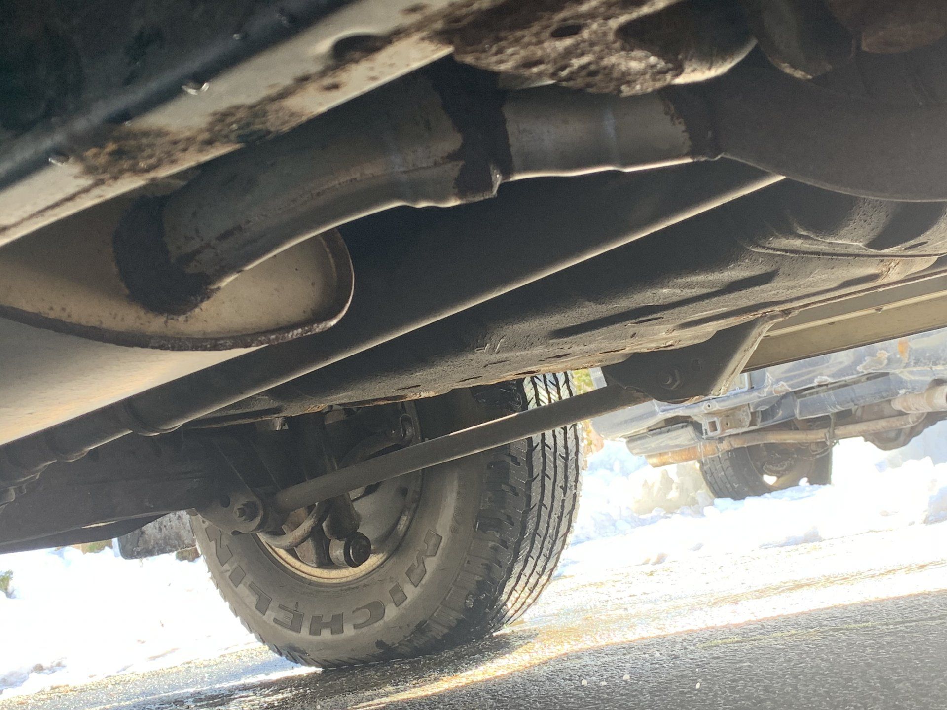

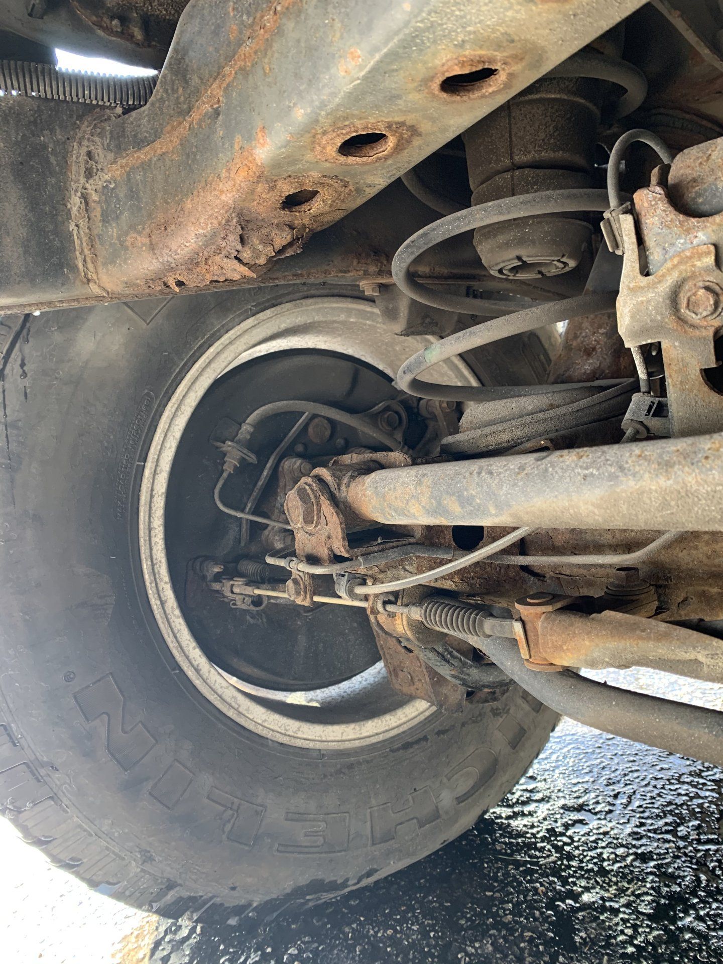

Frame doesn't look bad honestly. And I know a thing or two about rusty 100 series ;)

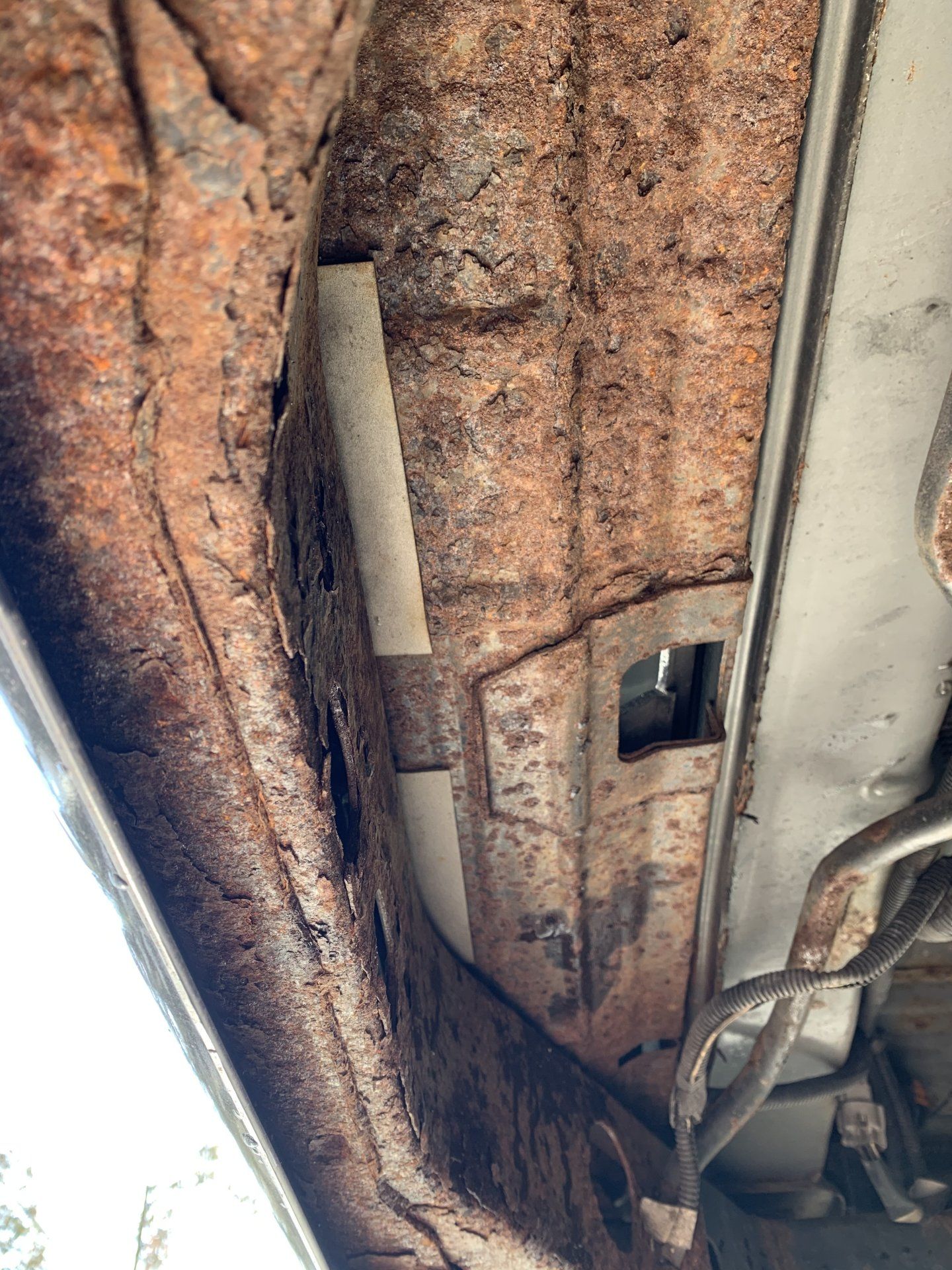

Look at the quarter panels behind the rear wheels (and under the rear bumper) and also the fender are right behind the front wheels.
Those are drain points for the sunroof and are typically first areas to rust. If those are solid then frame stuff is easy peasy.

I vote option #3. Buy for around $3k and drive it into the ground. Treat the rust you can to slow it down and in 15-20 years buy a replacement.
Rusty Cruisers make great trail vehicles and daily drivers in the salt. If you are looking for an instagram model cruiser do not buy a rusty one.
I have a rusty midwest '99 LC. While my frame was relatively solid and considered that the main factor, all the other thin metal rusting parts have been the bigger issue for me. I've now replaced all the brake hard lines (one busted), the rear a/c line (busted multiple places), windshield frame leaked a lot, half-assed patched up my rockers, the fuel hard lines (busted twice), and now the gas tank that started leaking. I still love the thing, and hopefully thats the last of the crucial stuff, but thats been a whole lot of hassle and work to fix.
This LC you're looking at might be weird in that those are the only rusty spots, which might not be too hard to fix with a shadetree welder, but the rest of the stuff would worry me.

I bought a rusty midwest 99 LC for 2500. It looked bad underneath at a glance but upon closer inspection frame was OK but plates, especially gas tank plate and brackets were really bad. I went through it with a grinder and rust removal wheel and used por15 on everything I could touch + fluid film in frame. The main reason I wanted it is it had 165K miles and was a well maintained plus I have lots of experience with the 4.7 working on my tundra. I've focused on mechanical maintance and its become a reliable daily for me. I've driven it 15k miles since last September so it was worth it. Definitely not a looker though. The biggest hassle are rusty bolts. Ive got to do my stabilizer bar bushings and the bolt don't even look like bolts anymore.
