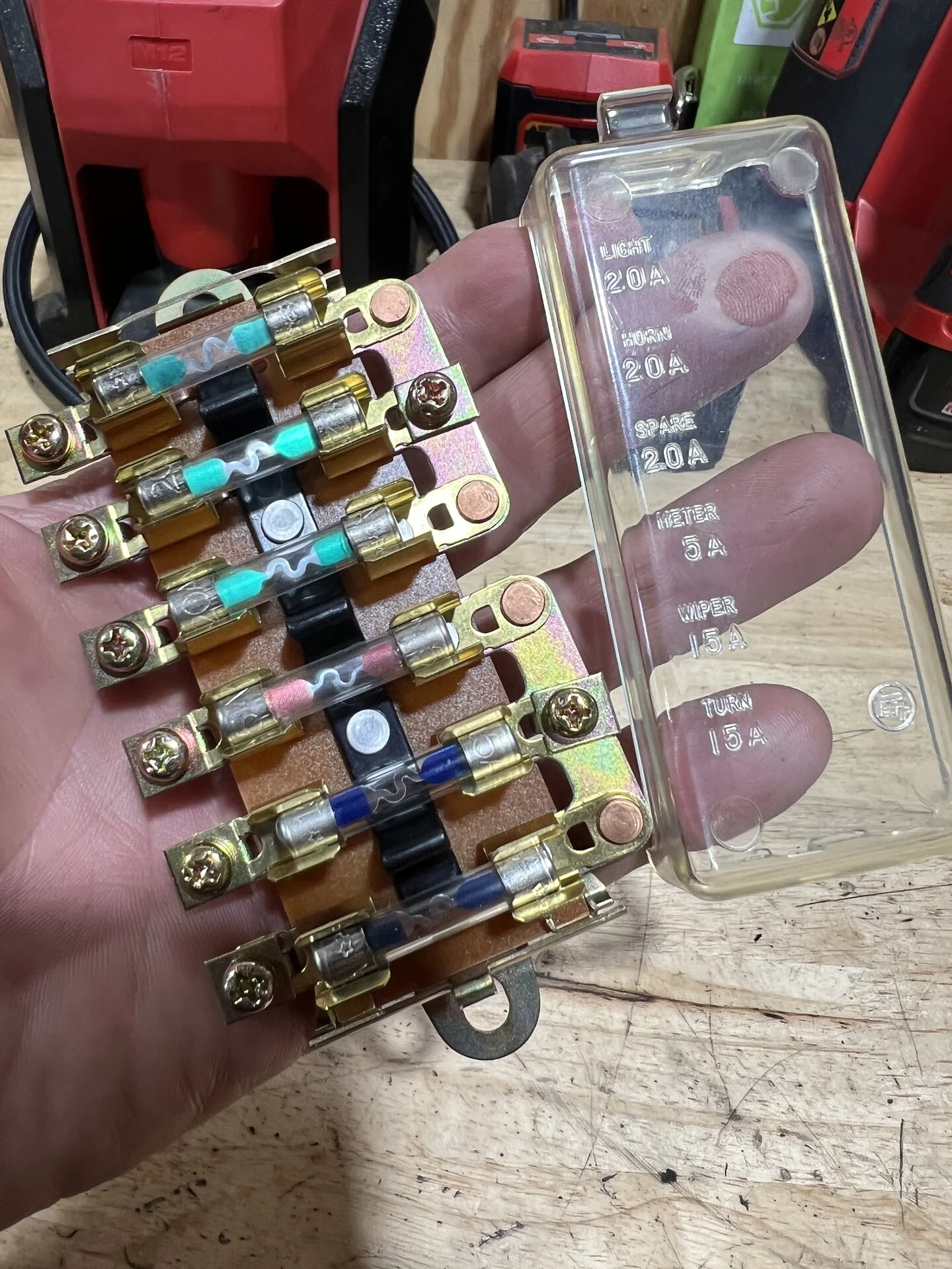

Did the early fuse blocks have a mylar/clear isolator to prevent unwanted grounding to the tub?
Not that I know of. Each attachment post is used as a ground for the lights.

About to add this beautiful OEM fuse box into the truck.

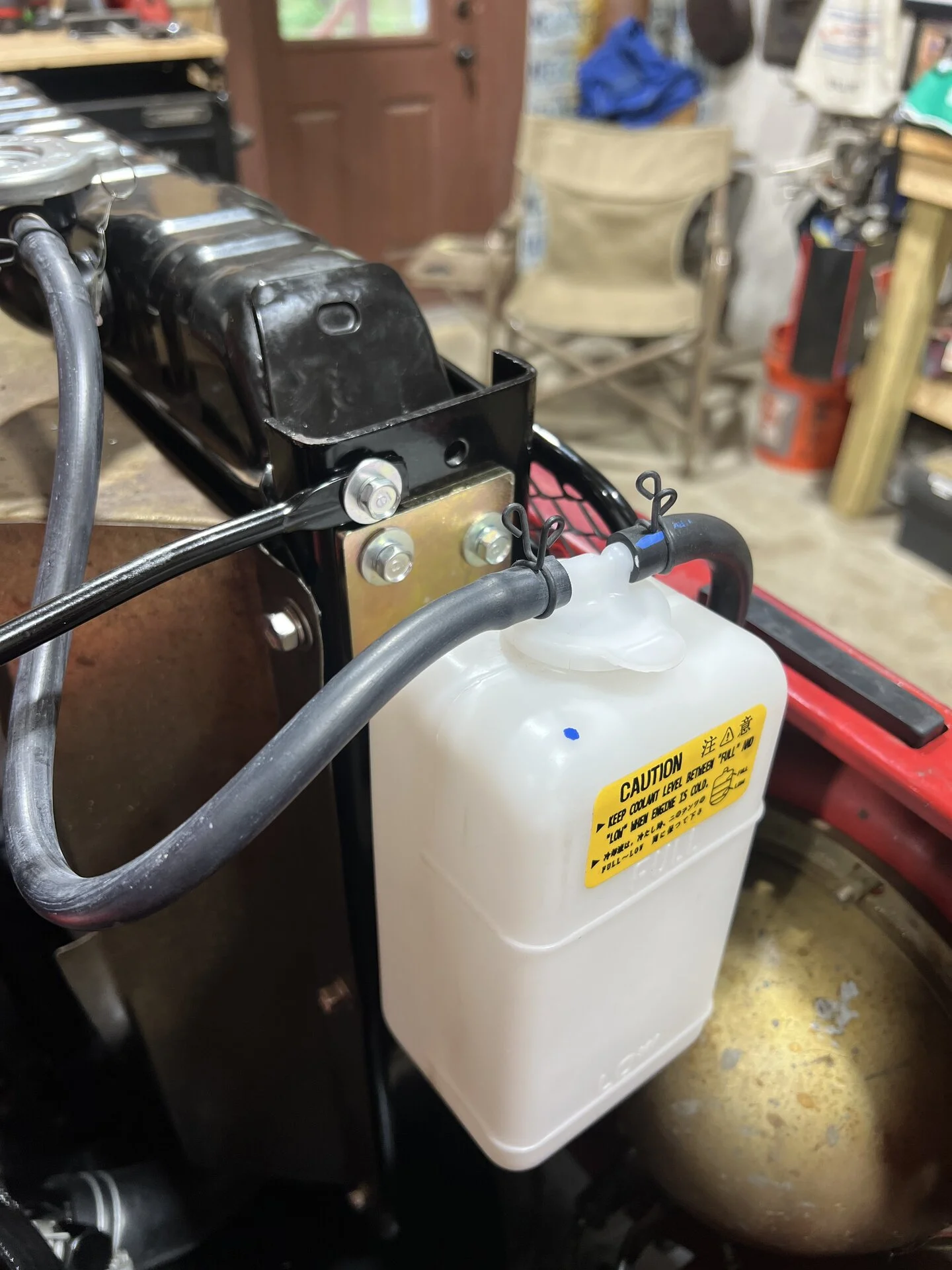

@ToyotaMatt overflow bottle

Great score on those seat belts and fuse box.

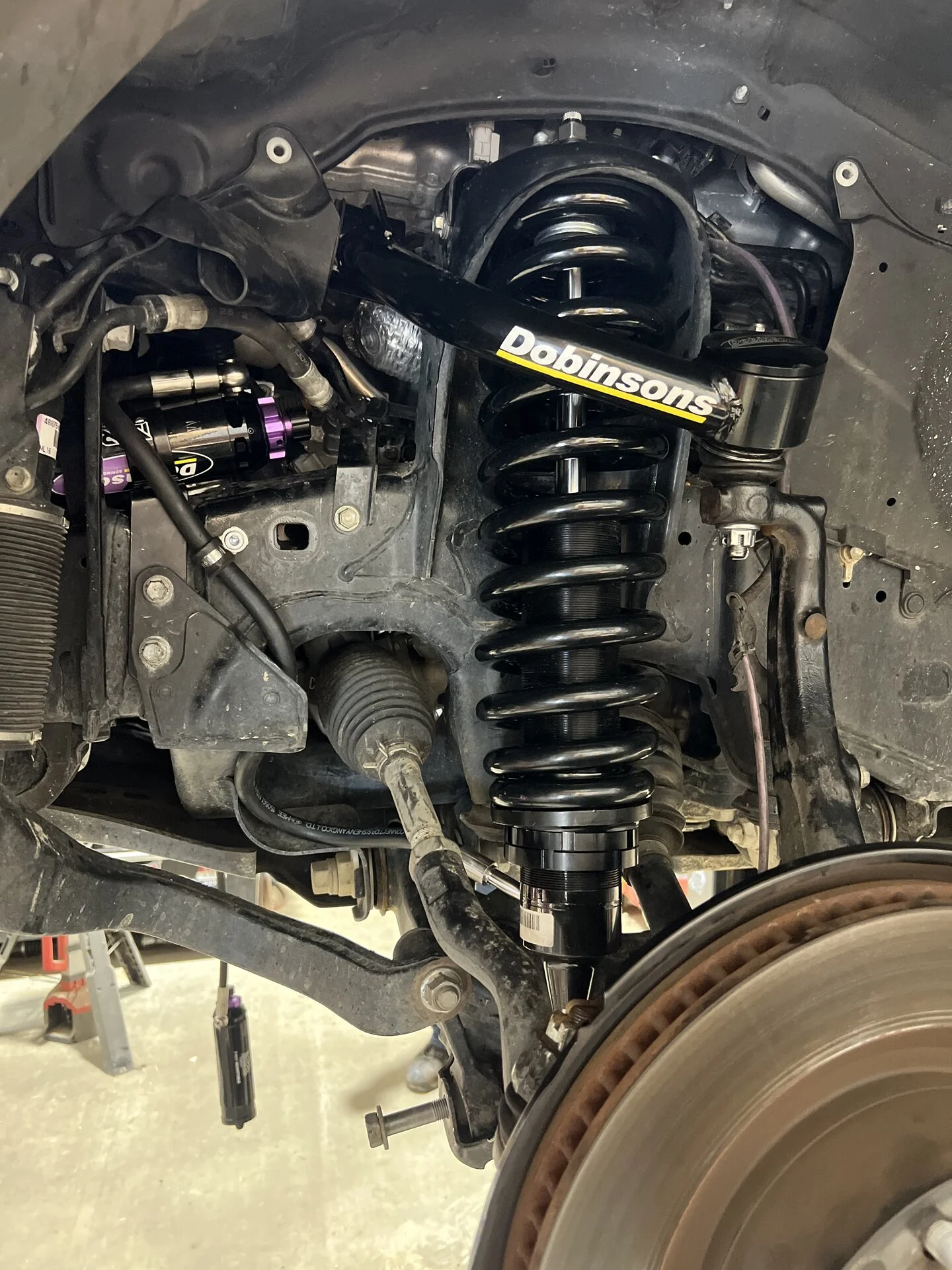

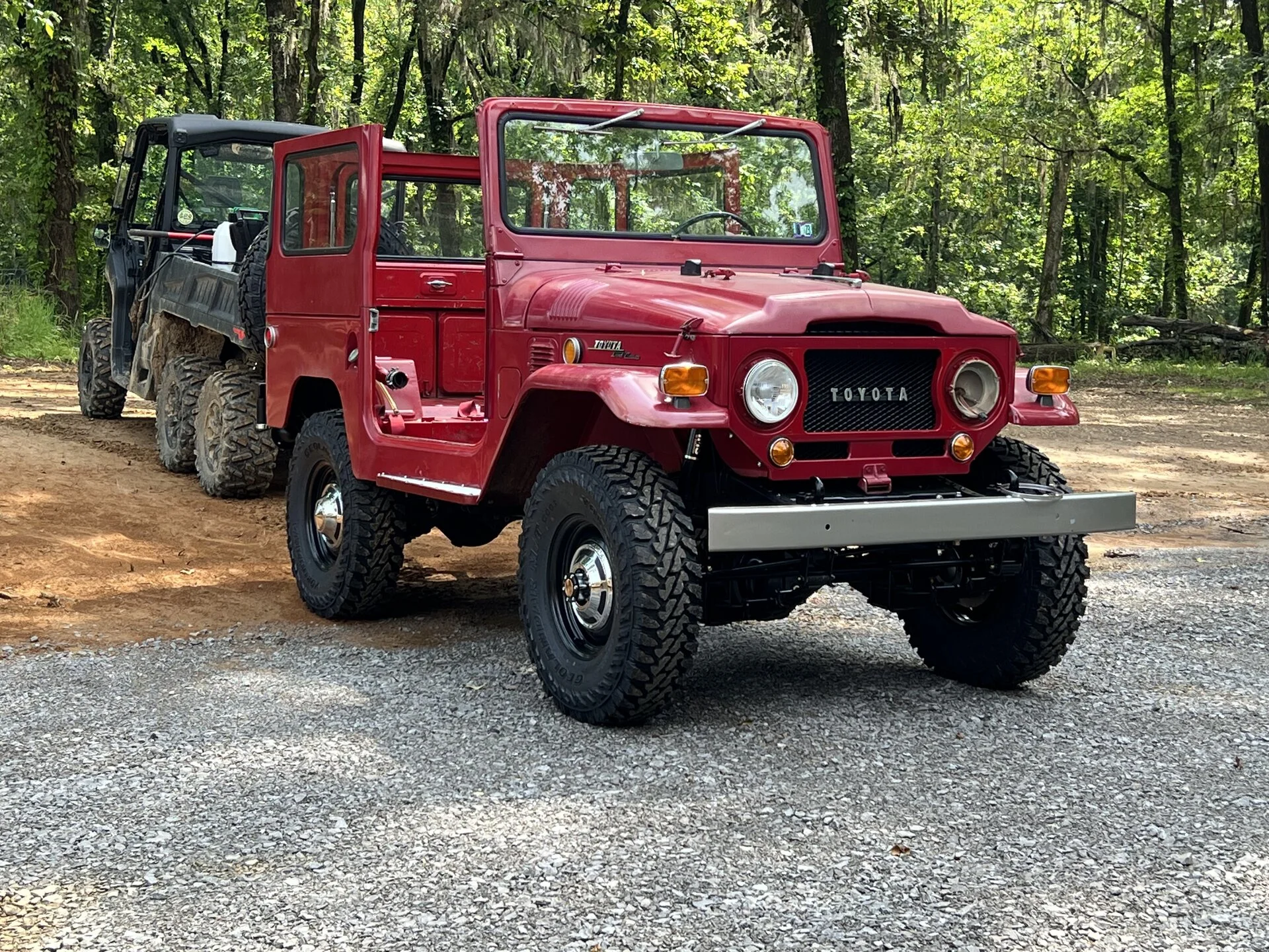

Rosie got towed out for some sun today while I helped a friend do a Dobinsons lift on his 200
I’d rather do leaf springs

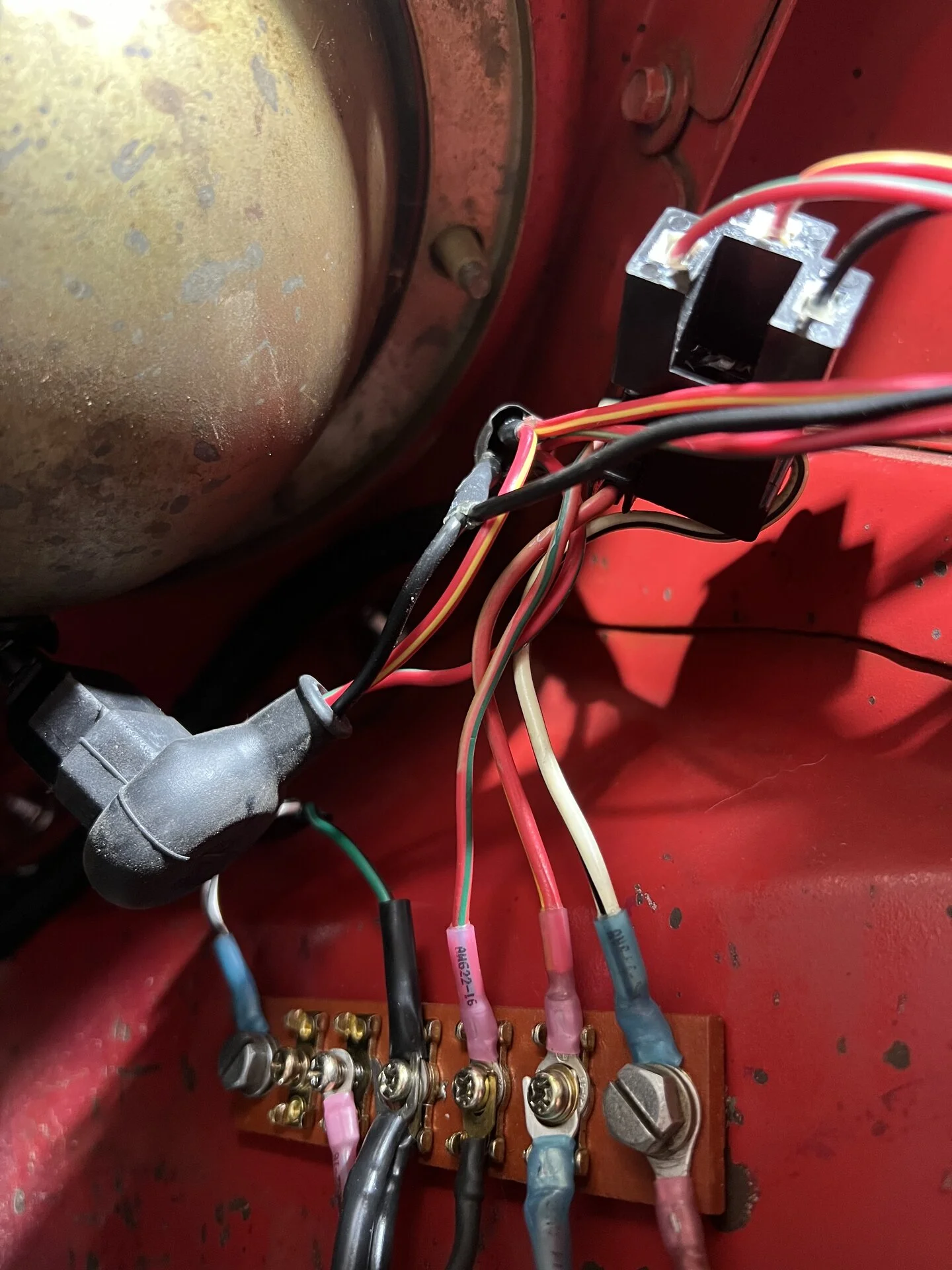

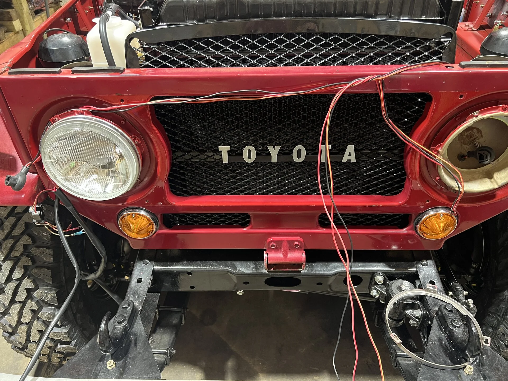

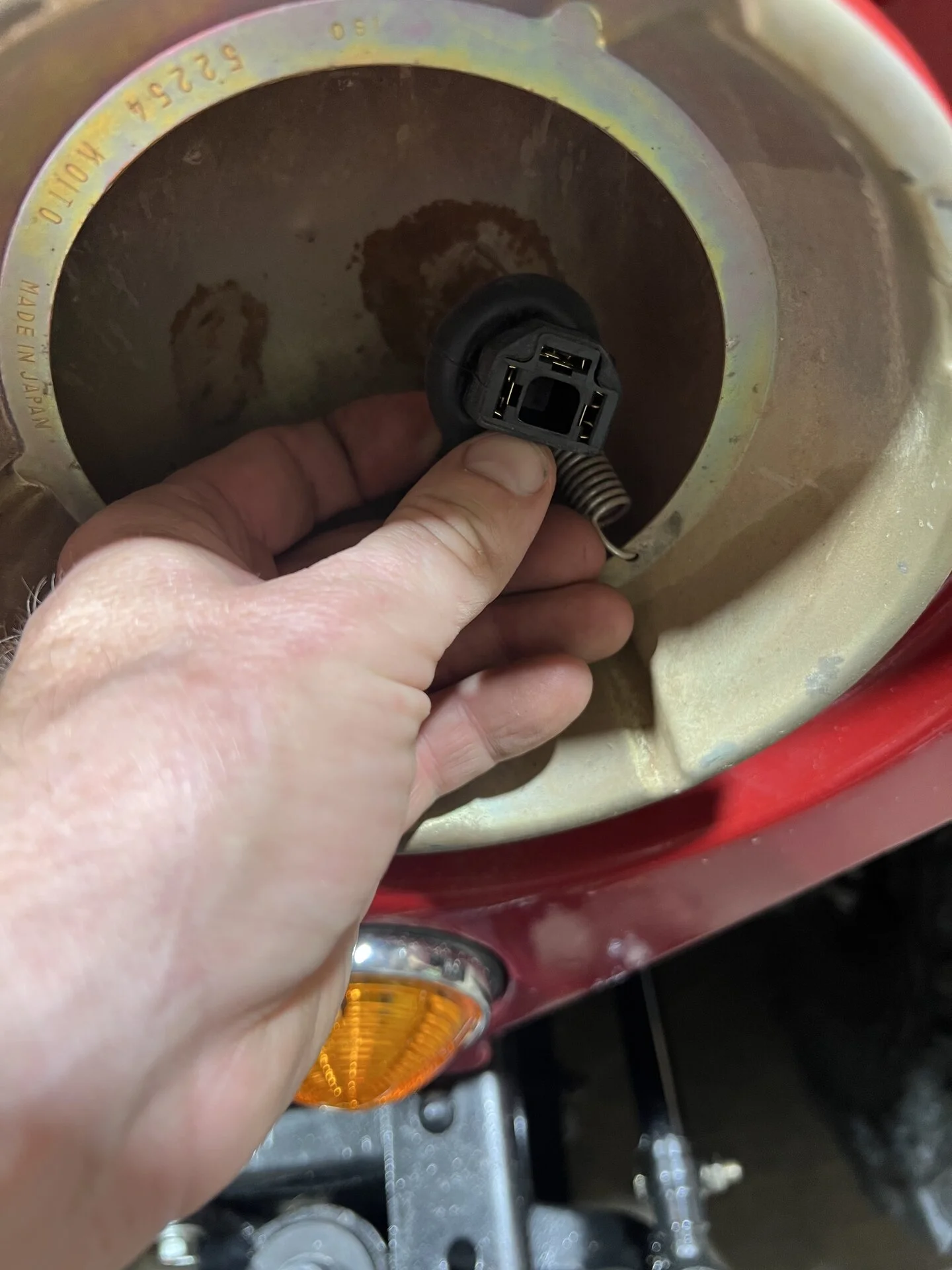

Someone in another thread asked how to make the Koito harnesses work with the enclosed light buckets on the early 40s.
This is how I do it.

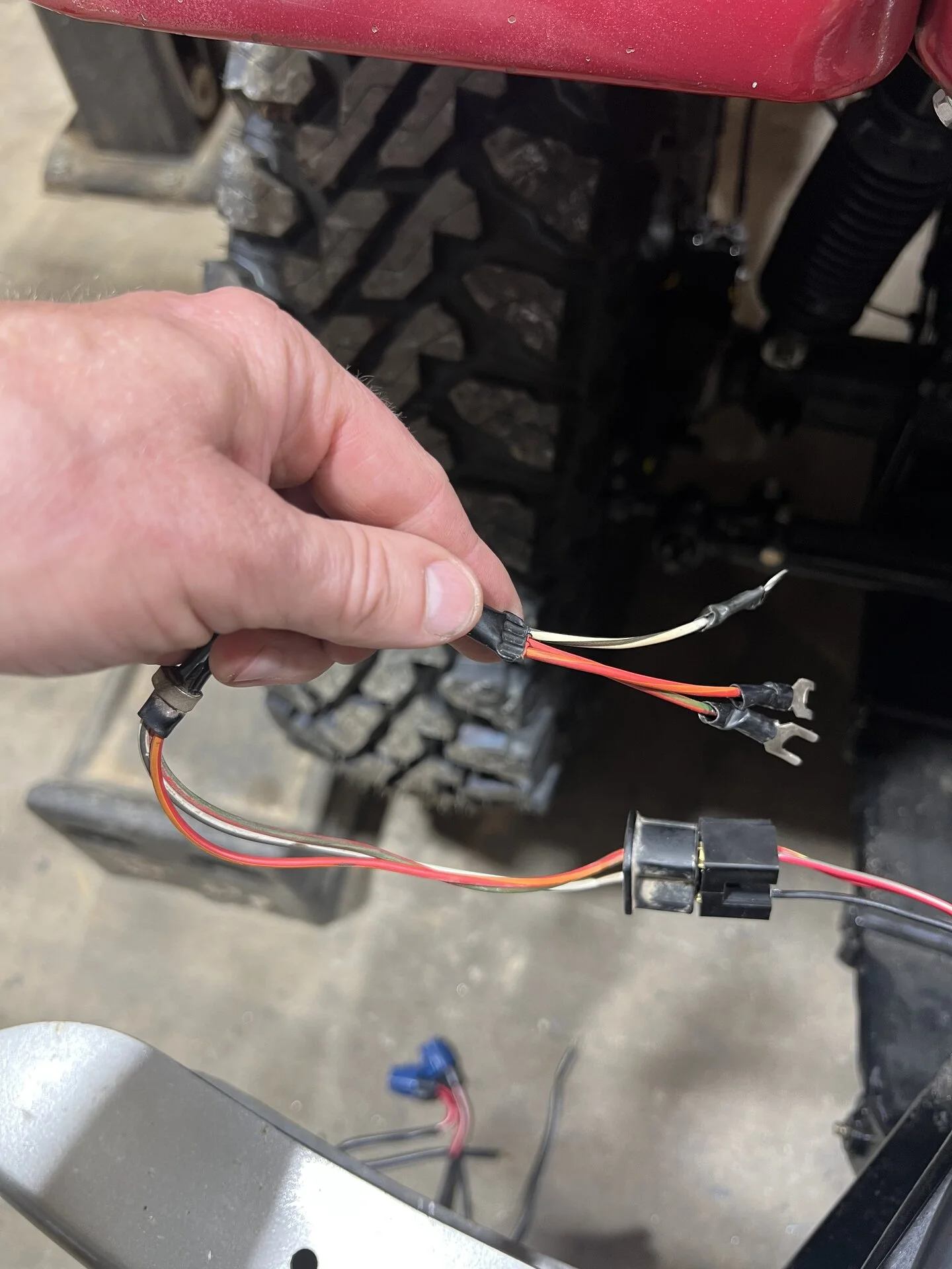

Pull the drivers light and pull the female plug and its associated wires out. Replace the rubber plug if it pulls out.
Cut the 3 wires coming across the grill in 1/2 and unsheath the wires from the big black rubber stuff.
Feed the bare wires back through the grommet and leave the new female plug in the bucket
Next just trim the 3 grill wires down to fit the size of the grill and then reloom
Take the female plug and harness and install it on the fender harness opposite of its colors on the 40 factory harness.
Passenger side.
This truck has an LED bulb so there is length to drill a 1” hole in the bucket and feed the male plug out.
Matt sells the perfect grommet for this. It’s for the rear door of a 40 I think
If you don’t have LEDs you just replace the U ends that go on the fender bar with spades that will plug into the female harness.
Last, plug the new male into the piece you robbed from the drivers side.
Clear as mud?
I dickered with the lights a bit more. Everything works now but the blinkers.
I’m tabling it and moving to other stuff. Will report back on what the fix is when I find it

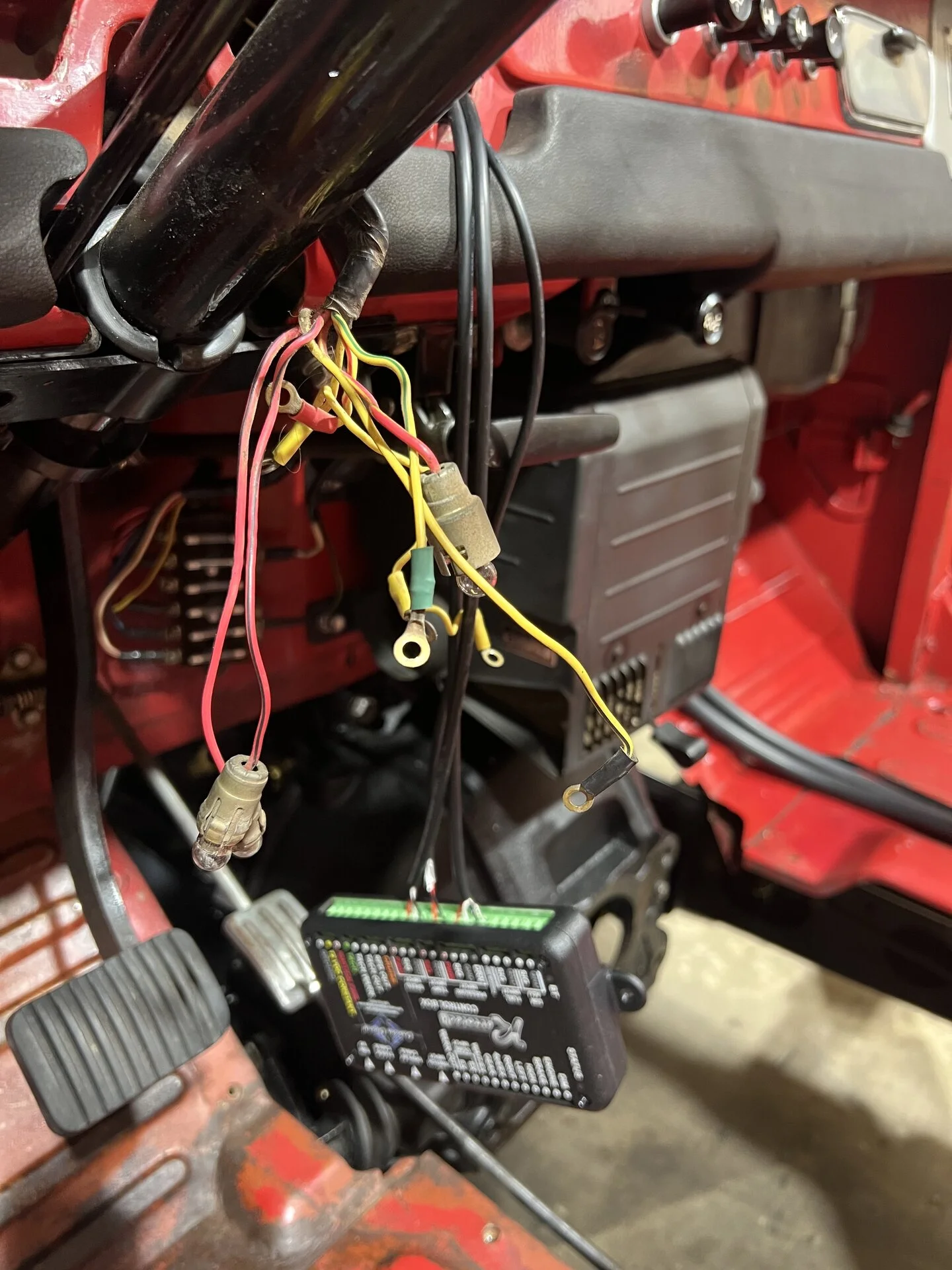

Next couple of days will be just hunkered down wiring.
I am waiting on adapter for the Sniper but I can pre wire a lot of it
Also we have a beautiful Dakota RTX going in as well.

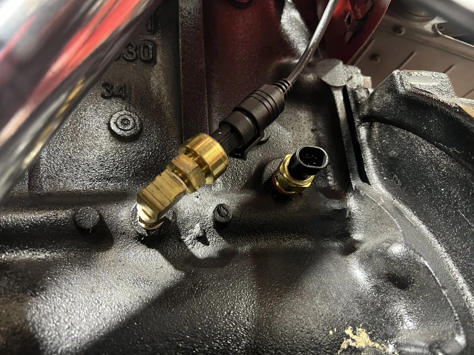

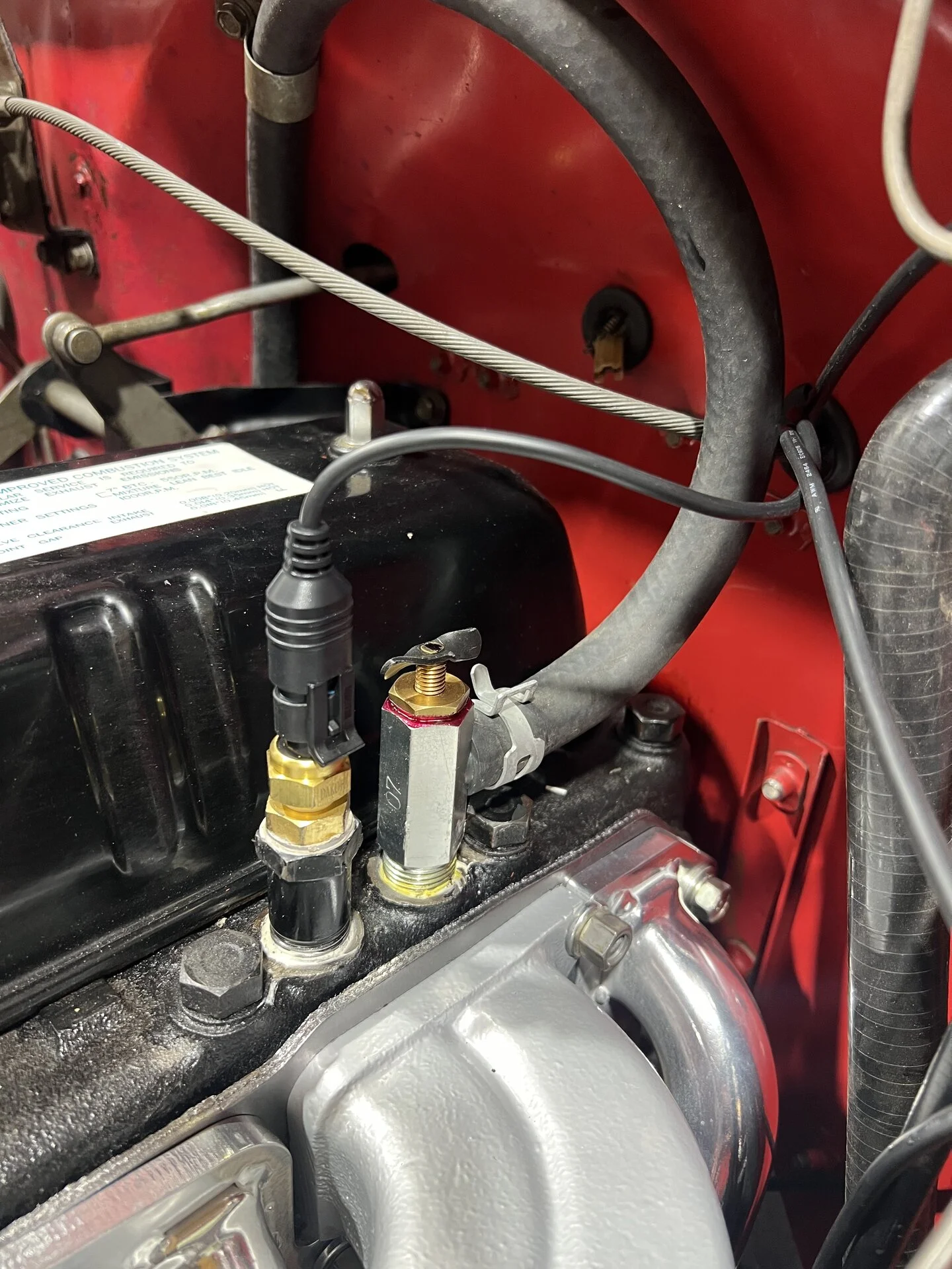

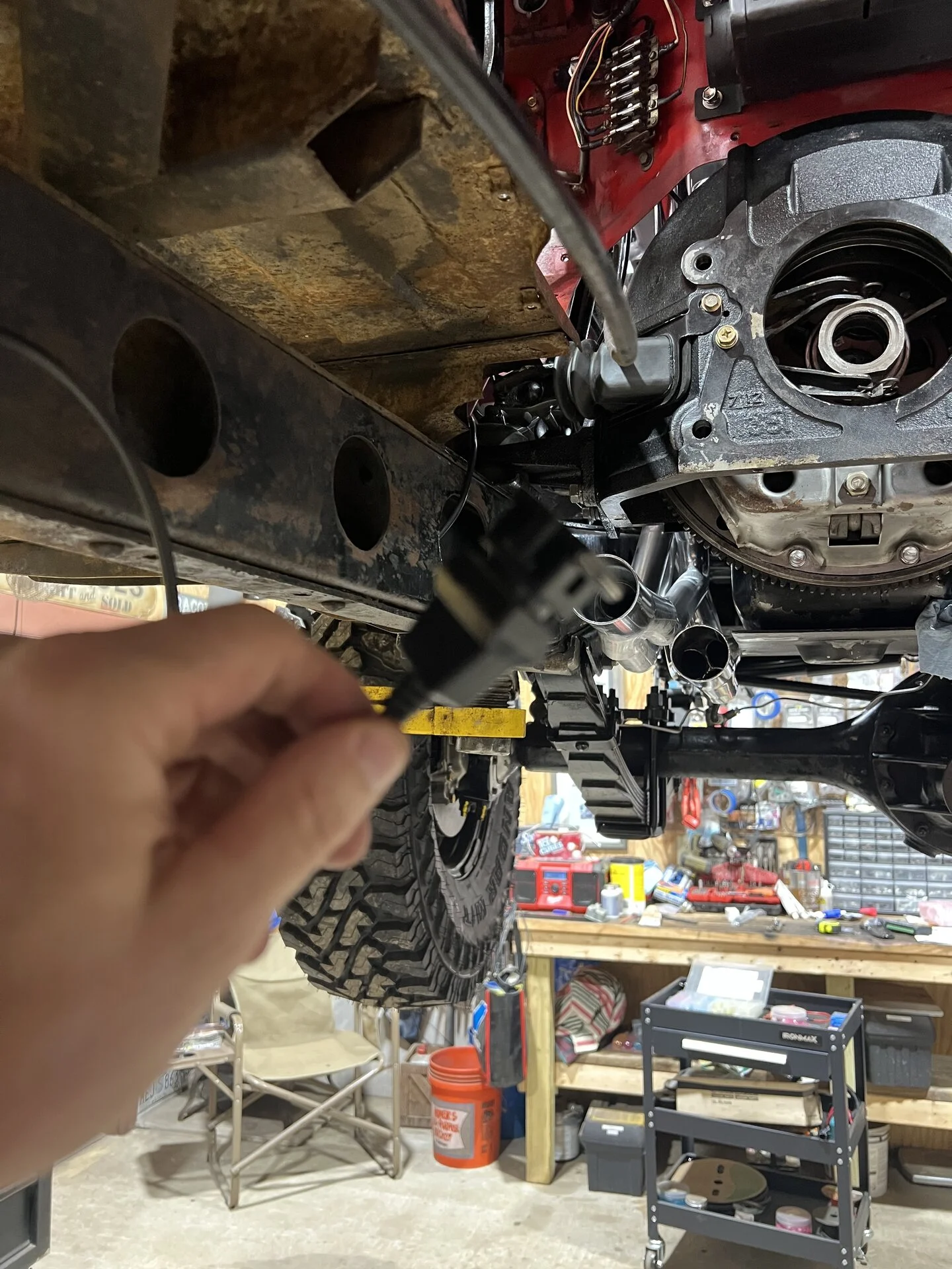

Justin at Redline sent me these two adapters to 90 out the Dakota oil pressure sensor away from the headers
One of the adapters in the Dakota kit works here on the top of the head for temp

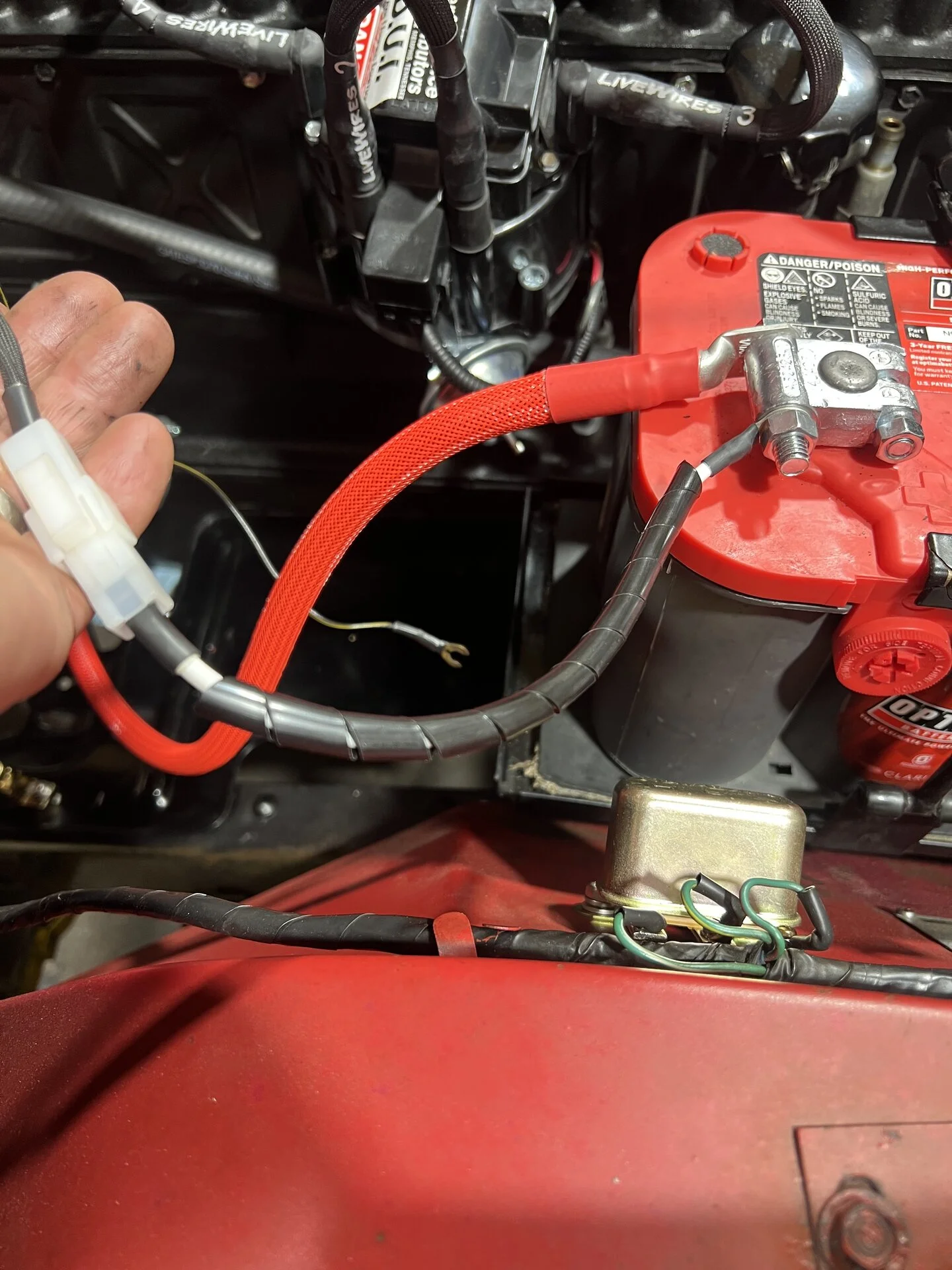

Main sensors are all wired in and trimmed for length. Now I’ll start filling in all the rest of those holes as needed

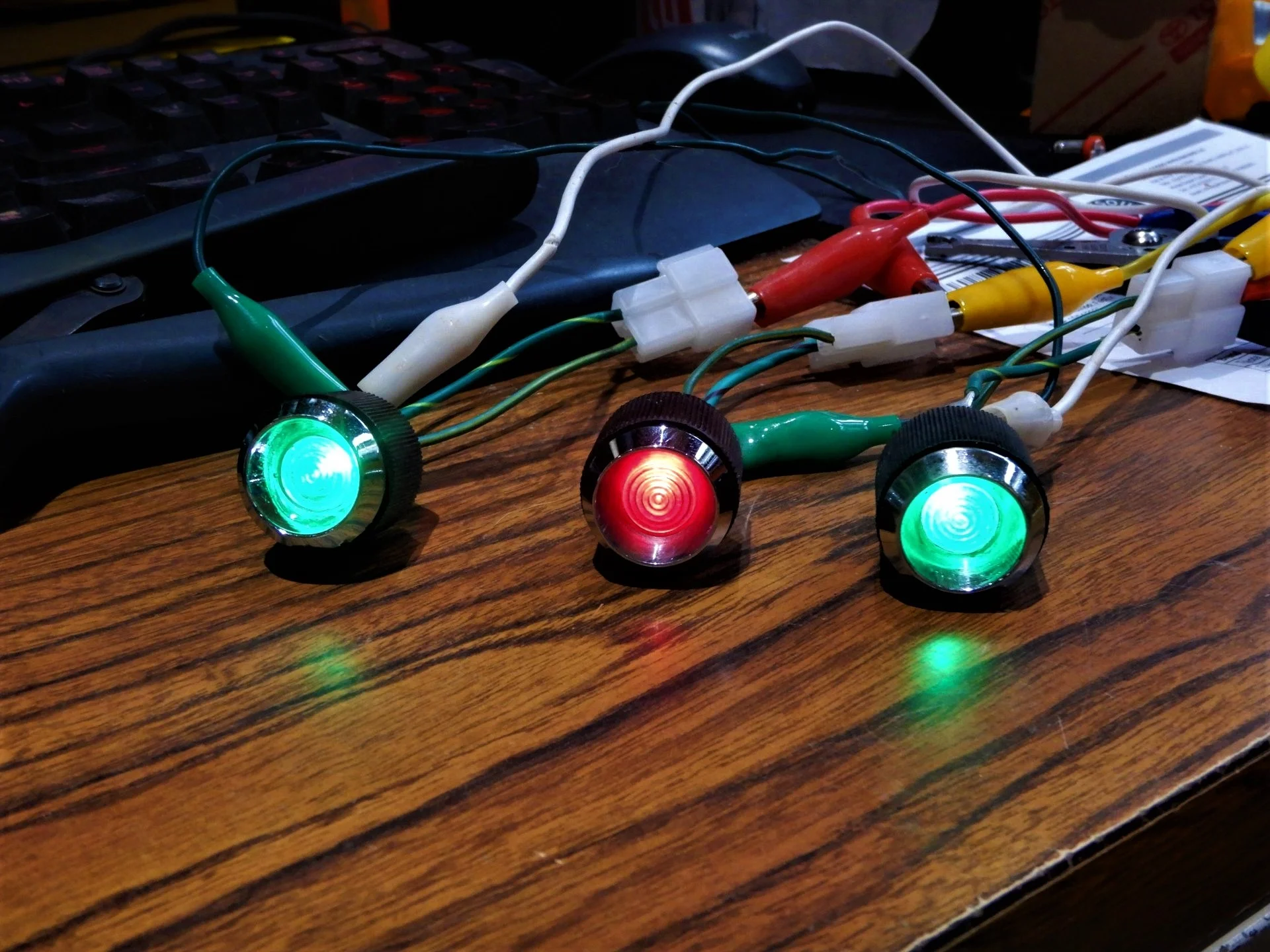

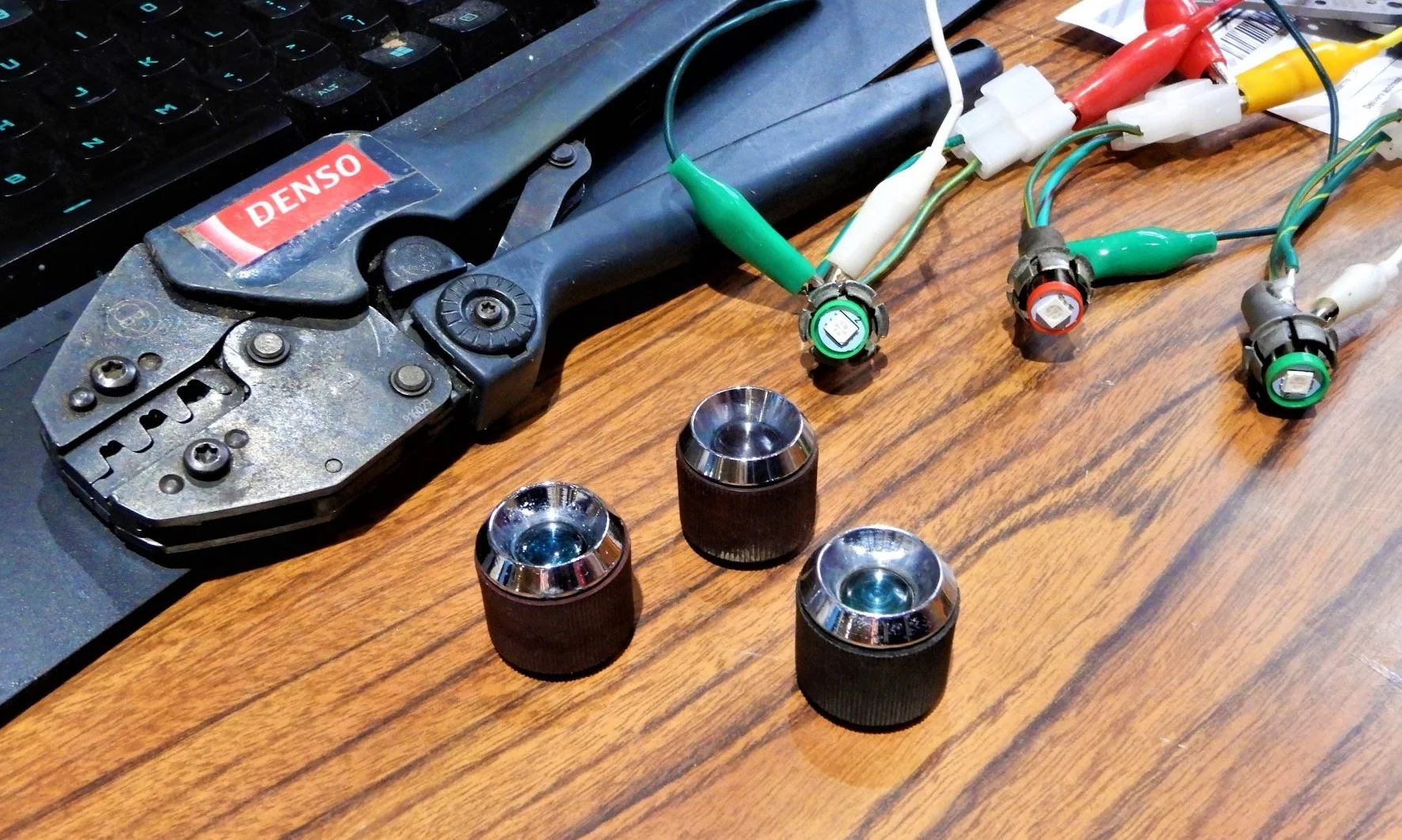

- the 25mm Grommet w/ the tape-off nipple spout is for the RED rear wheel well side marker sub-harness the feed up through each side , also feeding the tag lamp's / lamp depending on year starting in 1969- later , i like the sparky new use application the read-lamp bucket H4 plug feeds , good show !
- the low-profile Color-Temperature
RED and Green LED's for the in-dash indicator lamps , they have a like ZERO room inside once the oem socket is snapped up in place , and such are a LOW-LUMEN so are to not over-power the same in kind color tone KOITo lenses , rather give off a warm rich cozy glow that all the early-era folks can really take a fond liking to ....:)
- gotta go LED baby steps with Nolan's " patina-club" crowd 😇
- this tech. image below is the exact low profile red LED;s Nolan is holding in his hand above ,,,,
