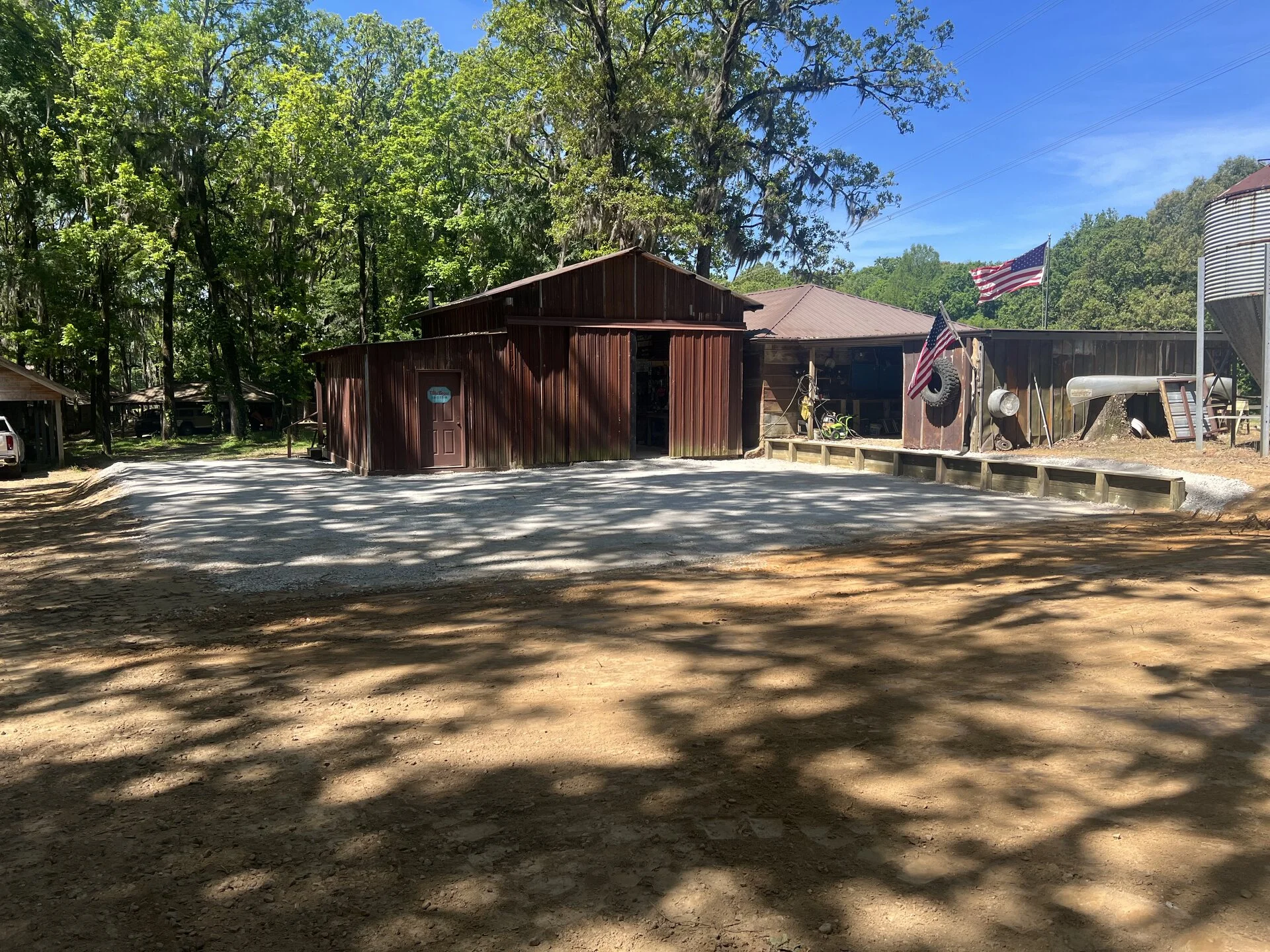

The pad is formed outside.

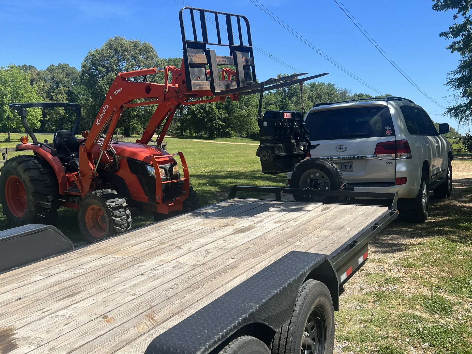

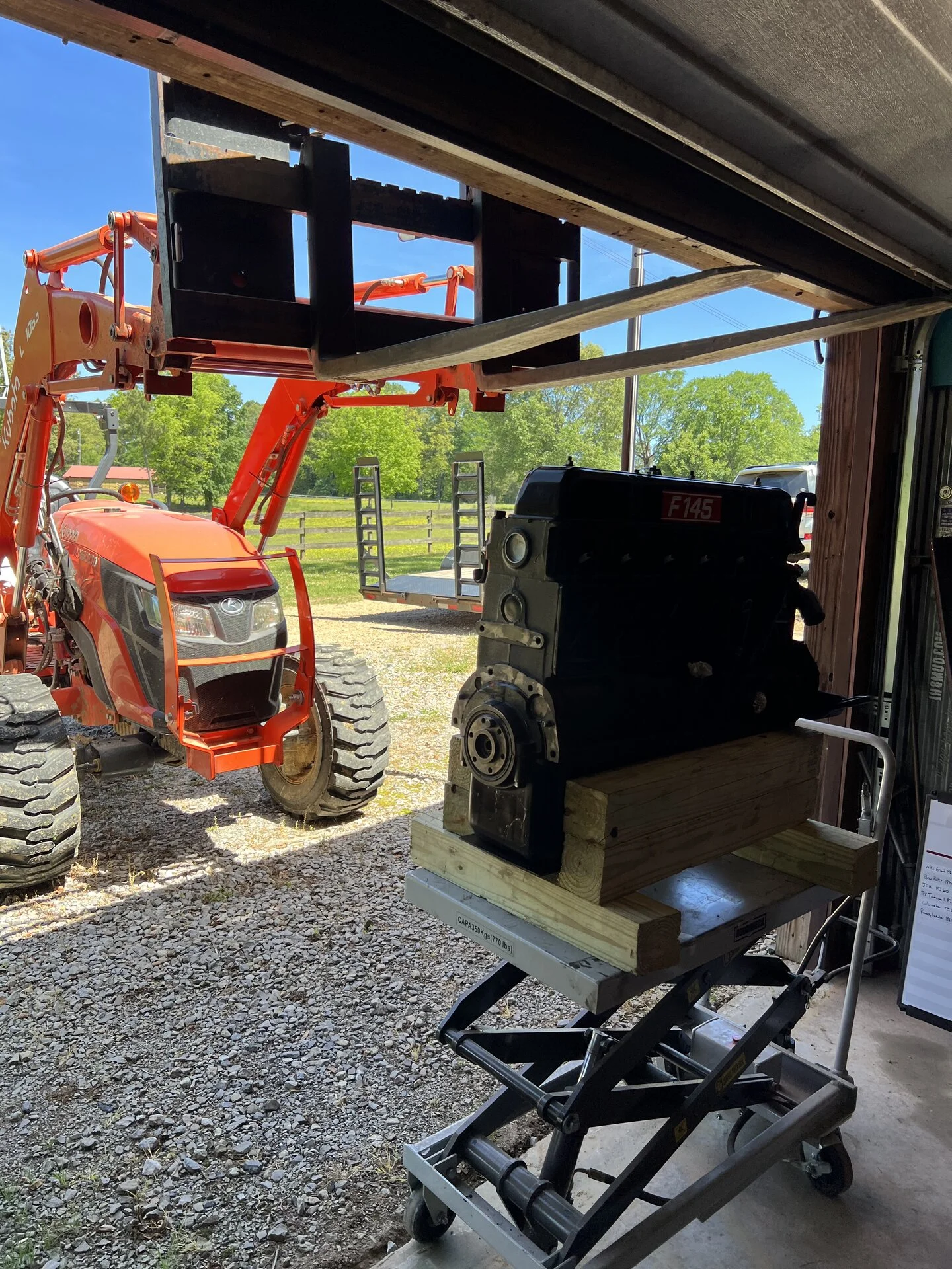

They finished up this morning and I got the mighty F unloaded and on the cart

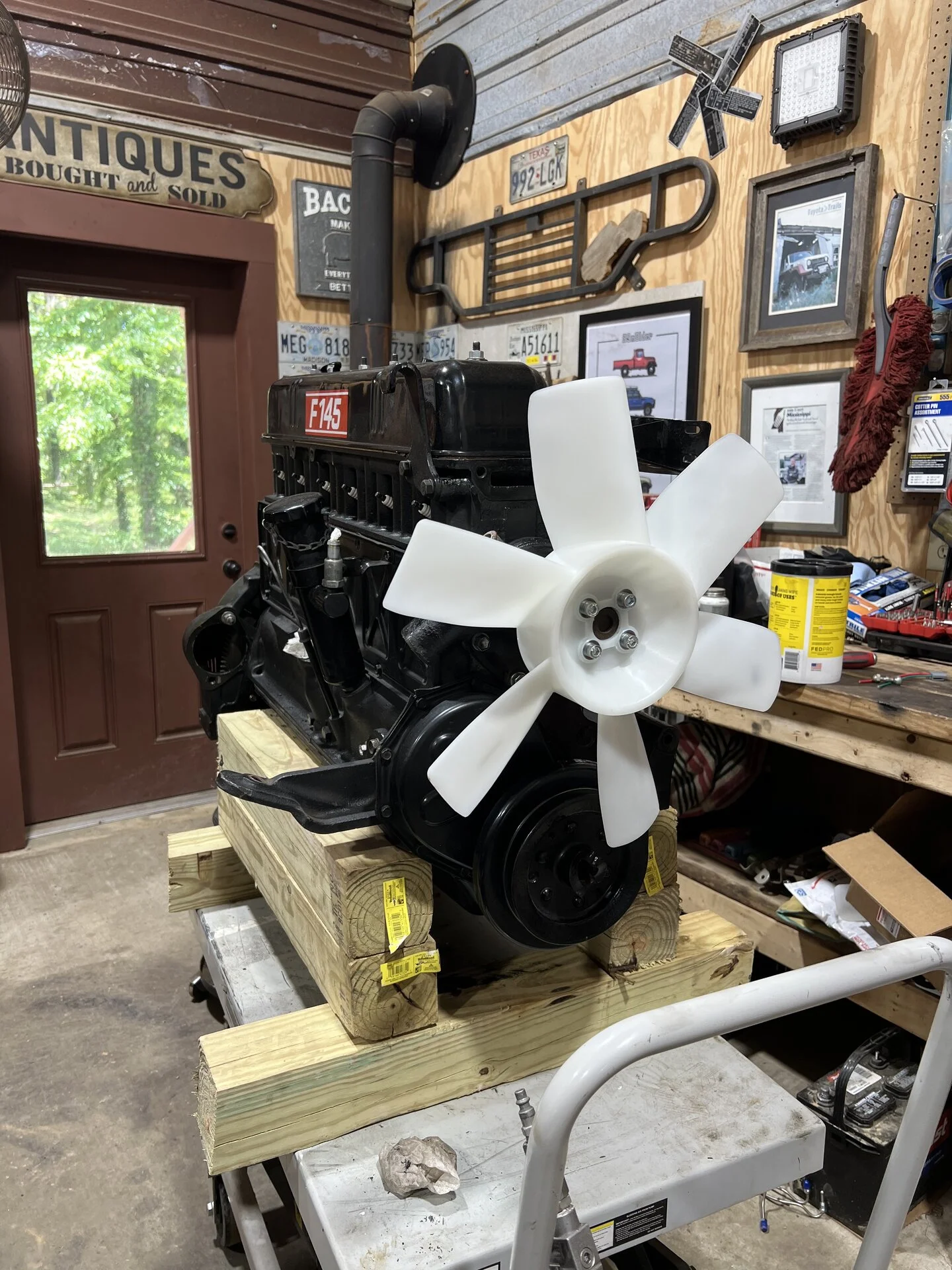

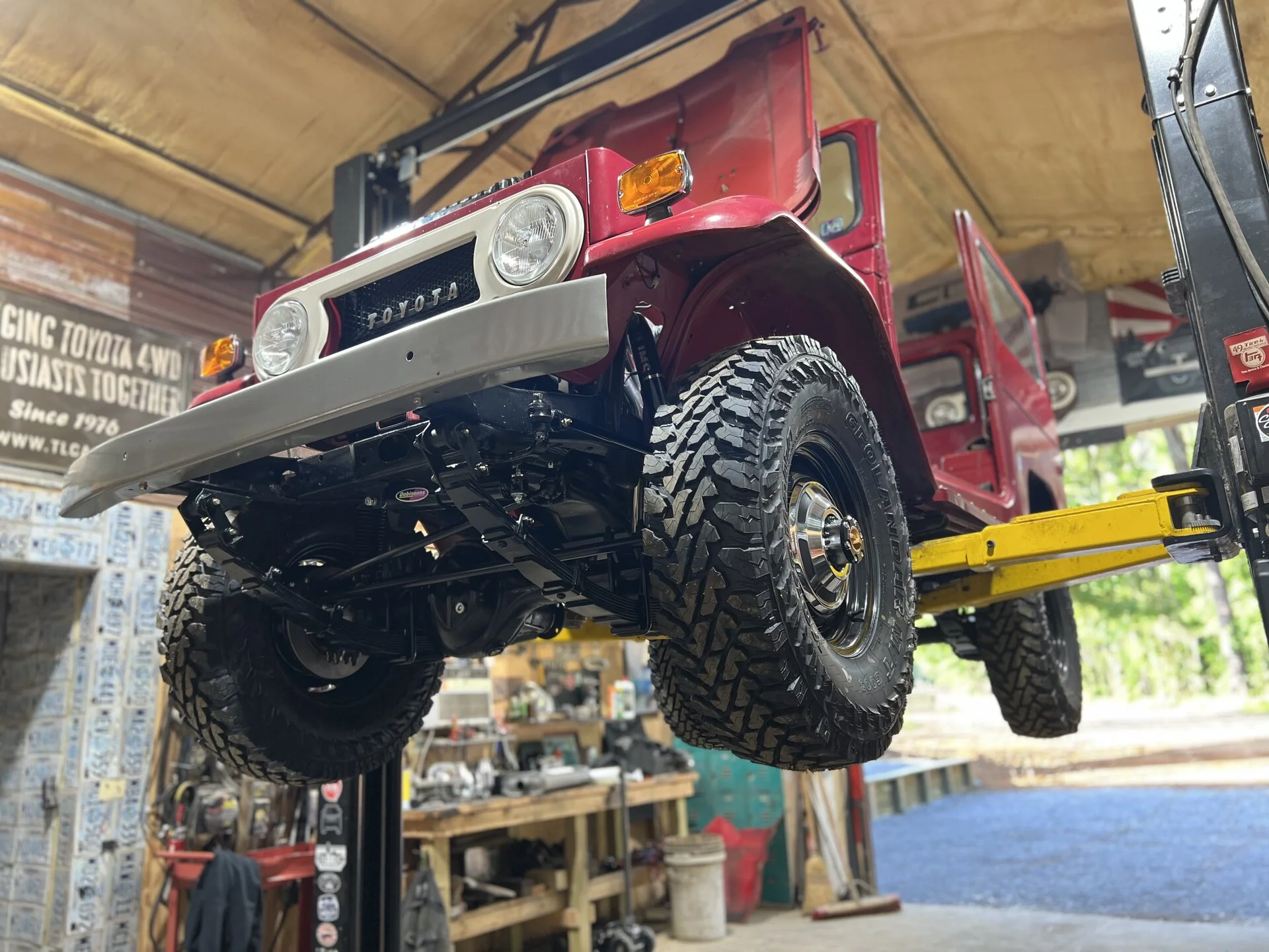

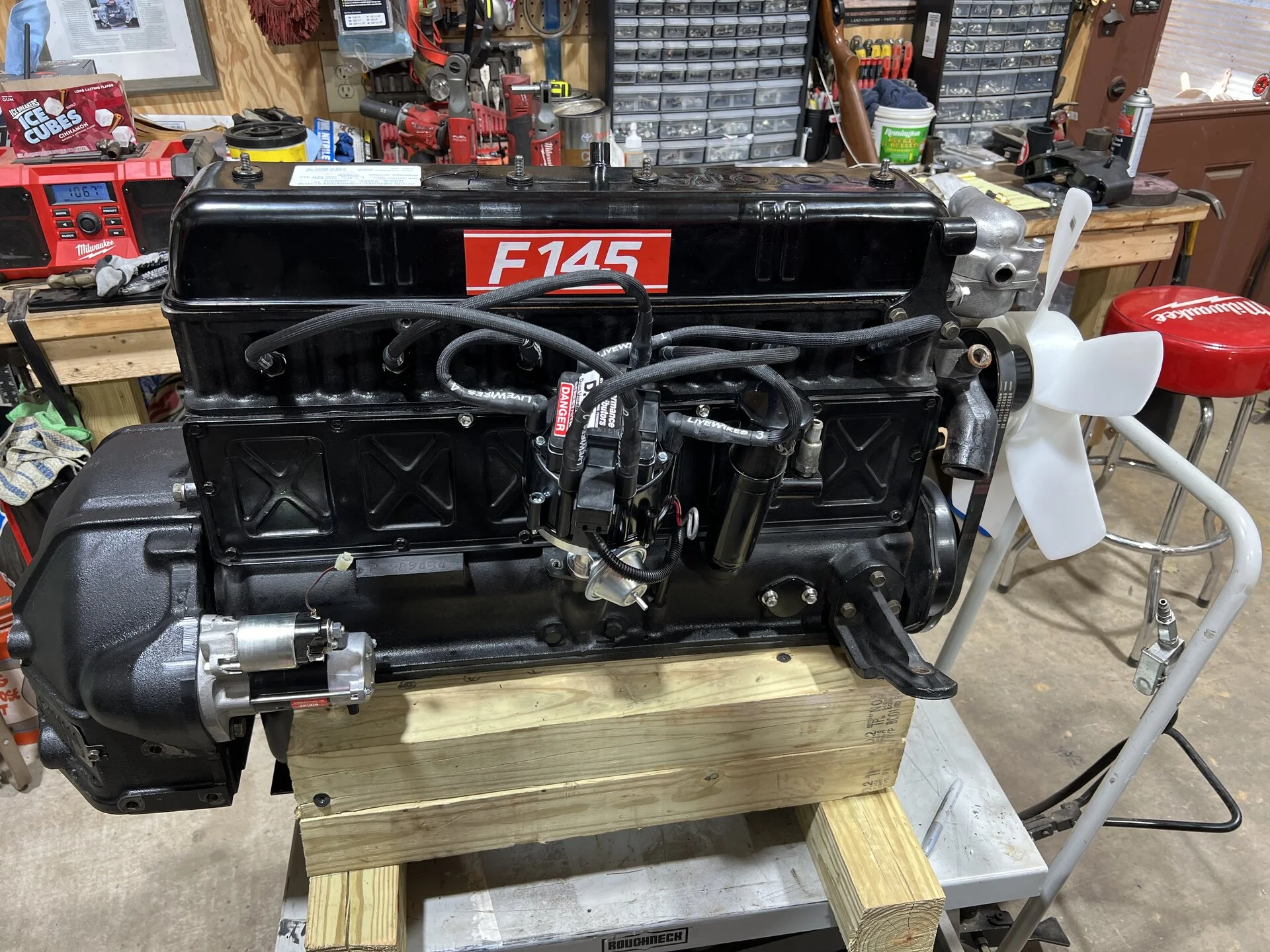

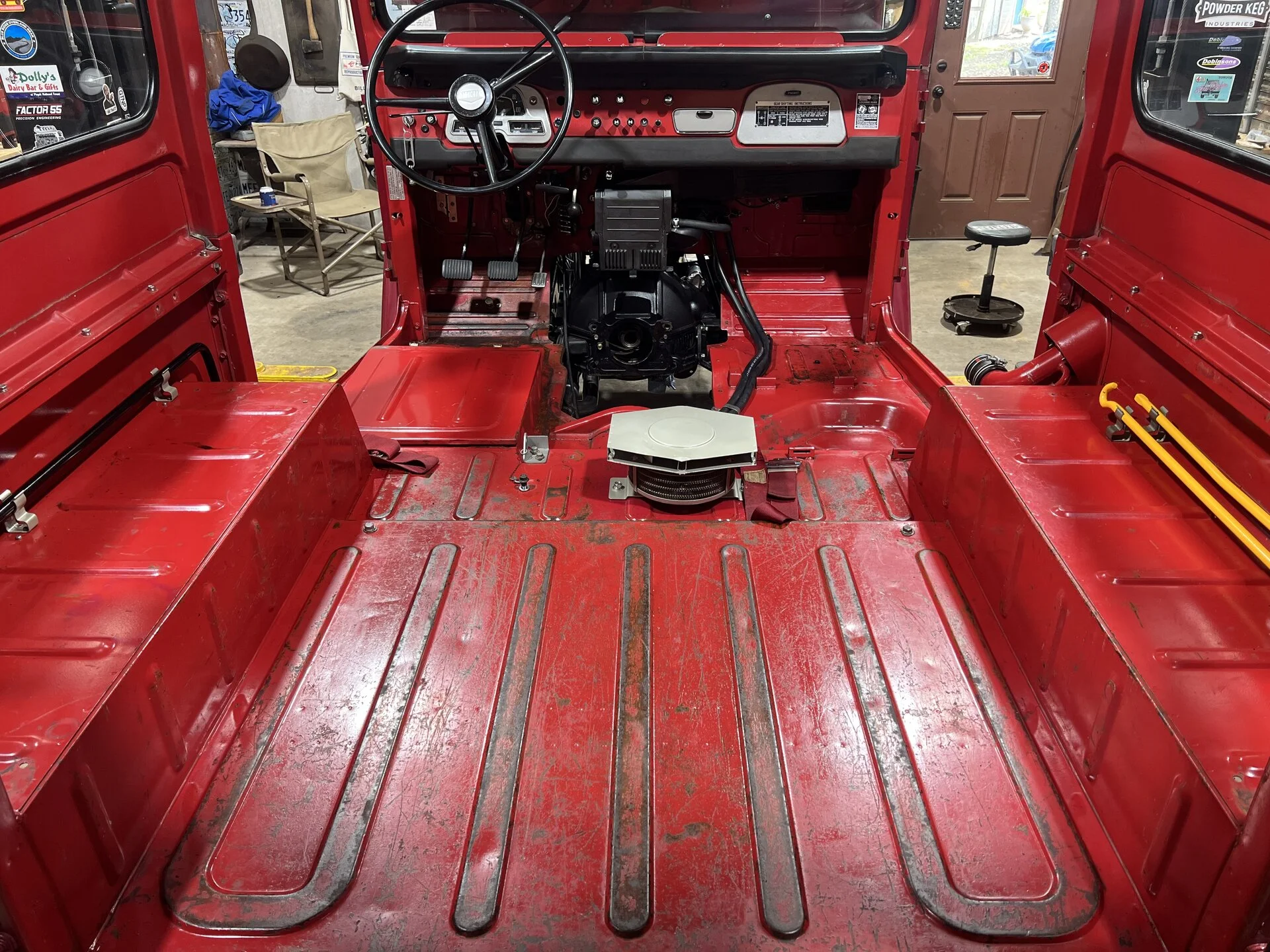

Building this mighty 1F back up.
Plastic fab via City Racer

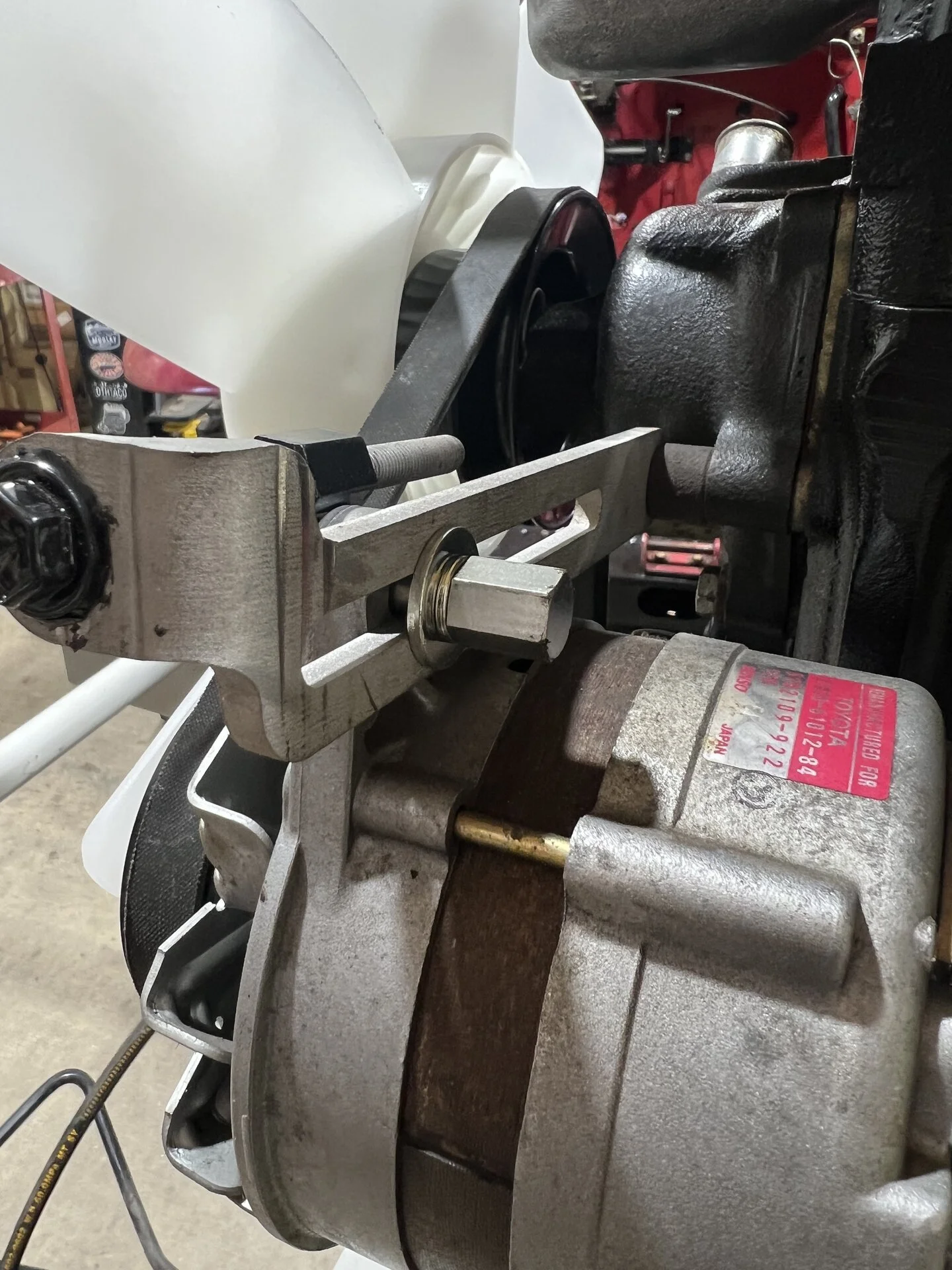

Alternator tensioner via Toyota Matt

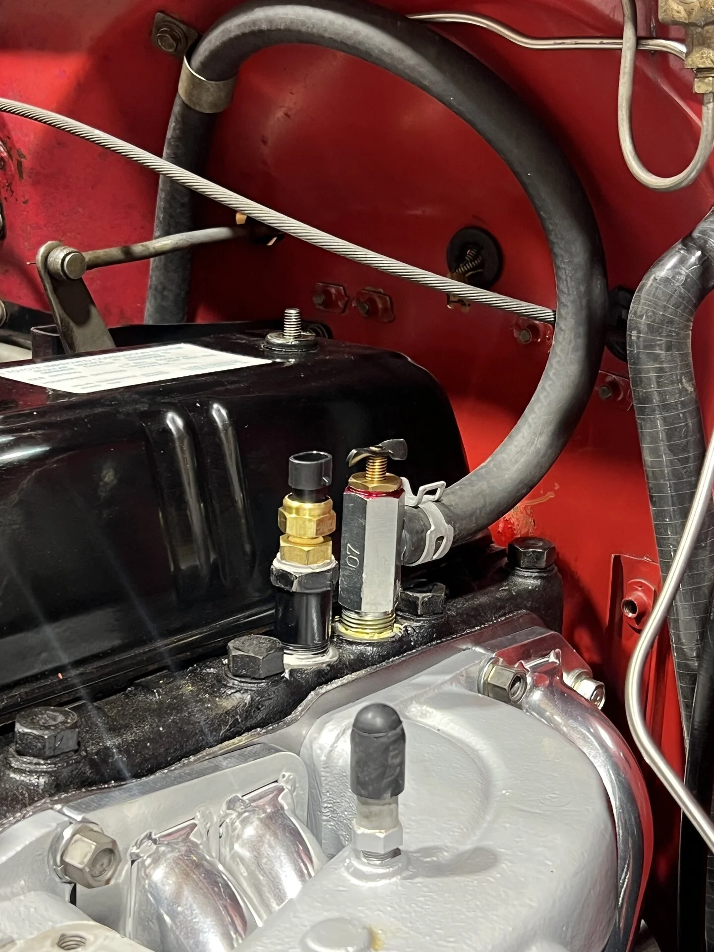

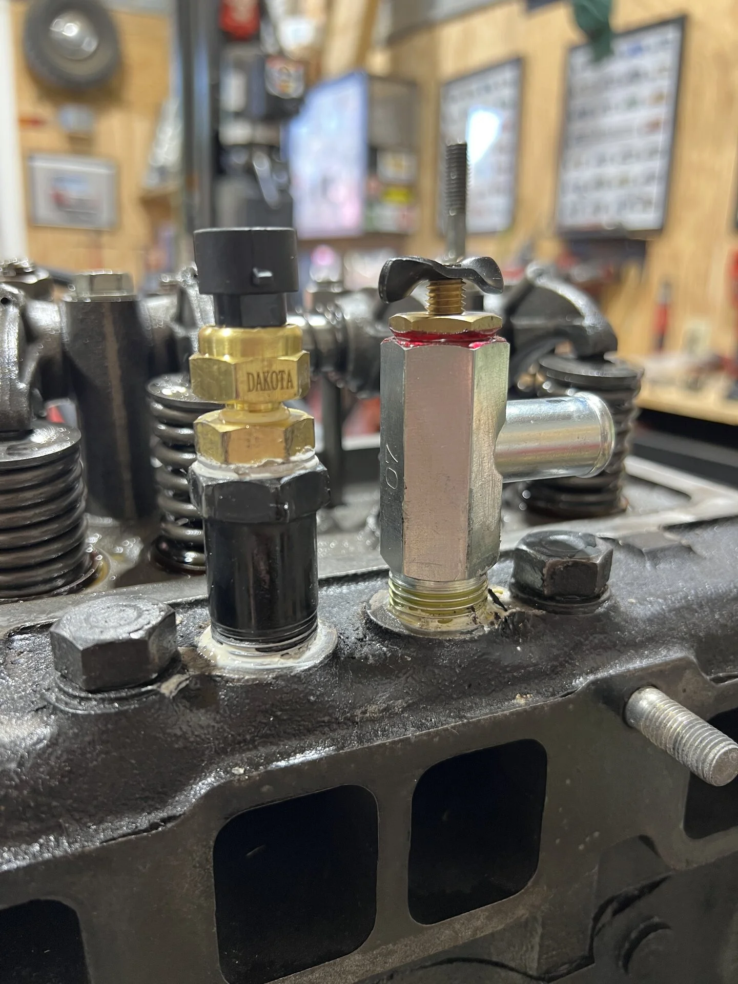

Heater valve via Toyota Matt next to Dakota water sensor

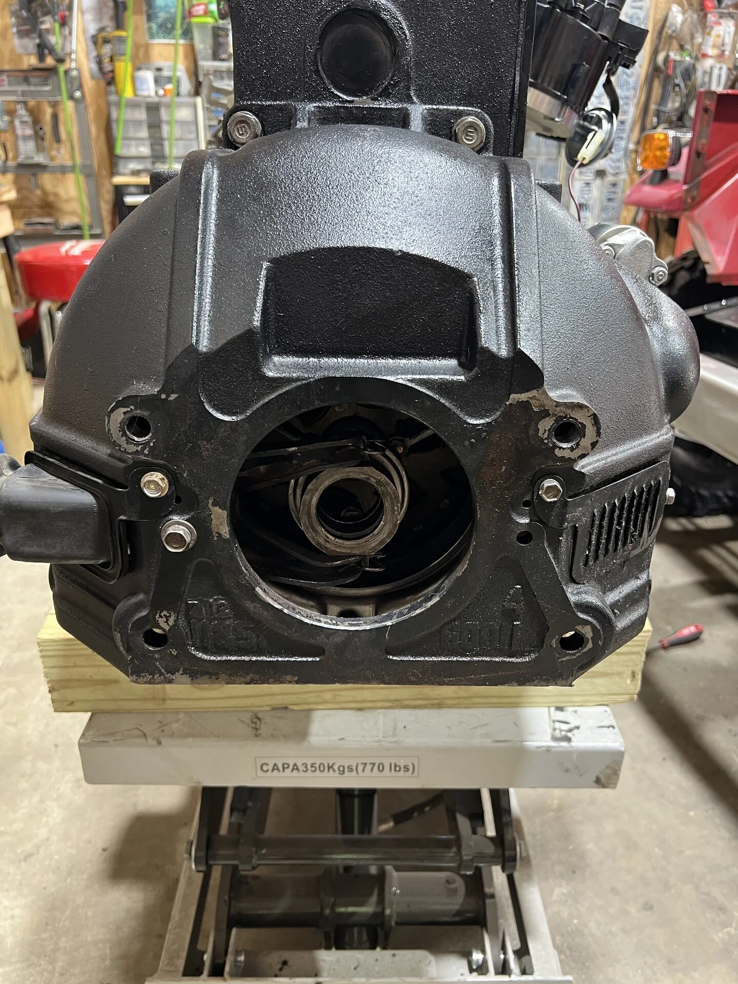

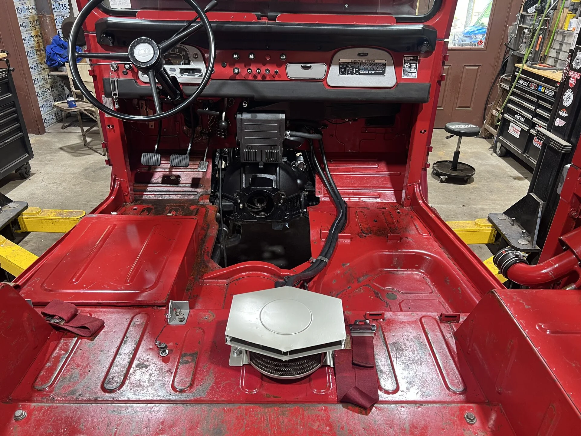

Clutch back in place
DUI and Toyota reman 60 starter in place

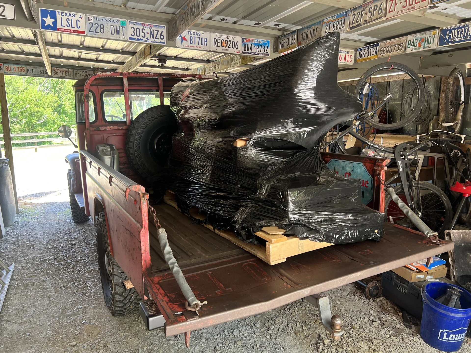

Had a massive pallet show up at Powder Keg and it’s Pork Chop Thursday at Lou’s so my morning was shot.

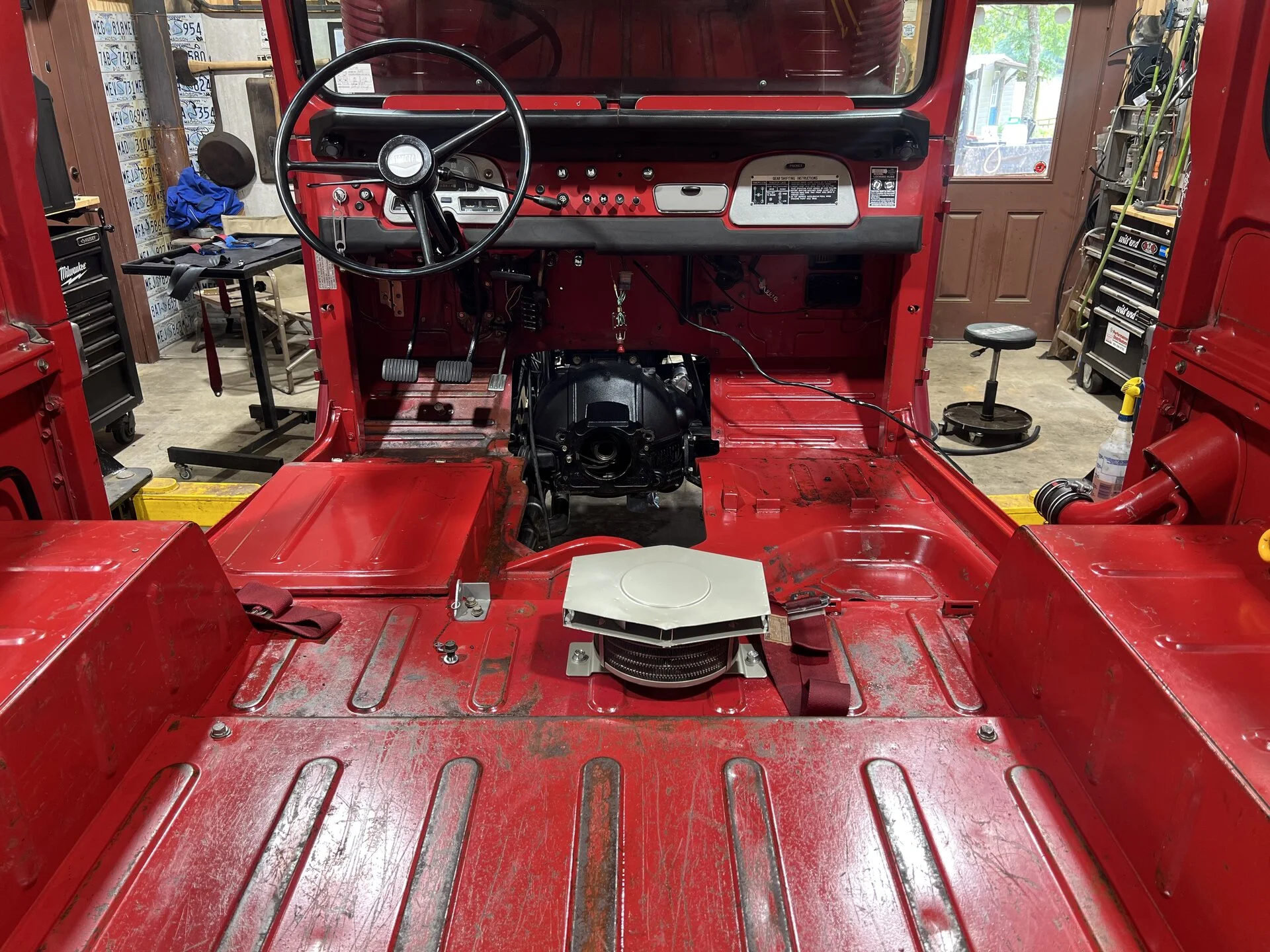

I made it back about 12:30 and got busy putting this thing back together
Lots of little stuff today.
Slept late with Red and then when I got to the shop my silly ass sister and one of her friends drove a 100,000 horse trailer into a ditch. It took a lot of winching and my big track hoe to extract.
Finally got on Rosie after lunch
Polished up the Bezel then installed the remaining lights from Toyota Matt

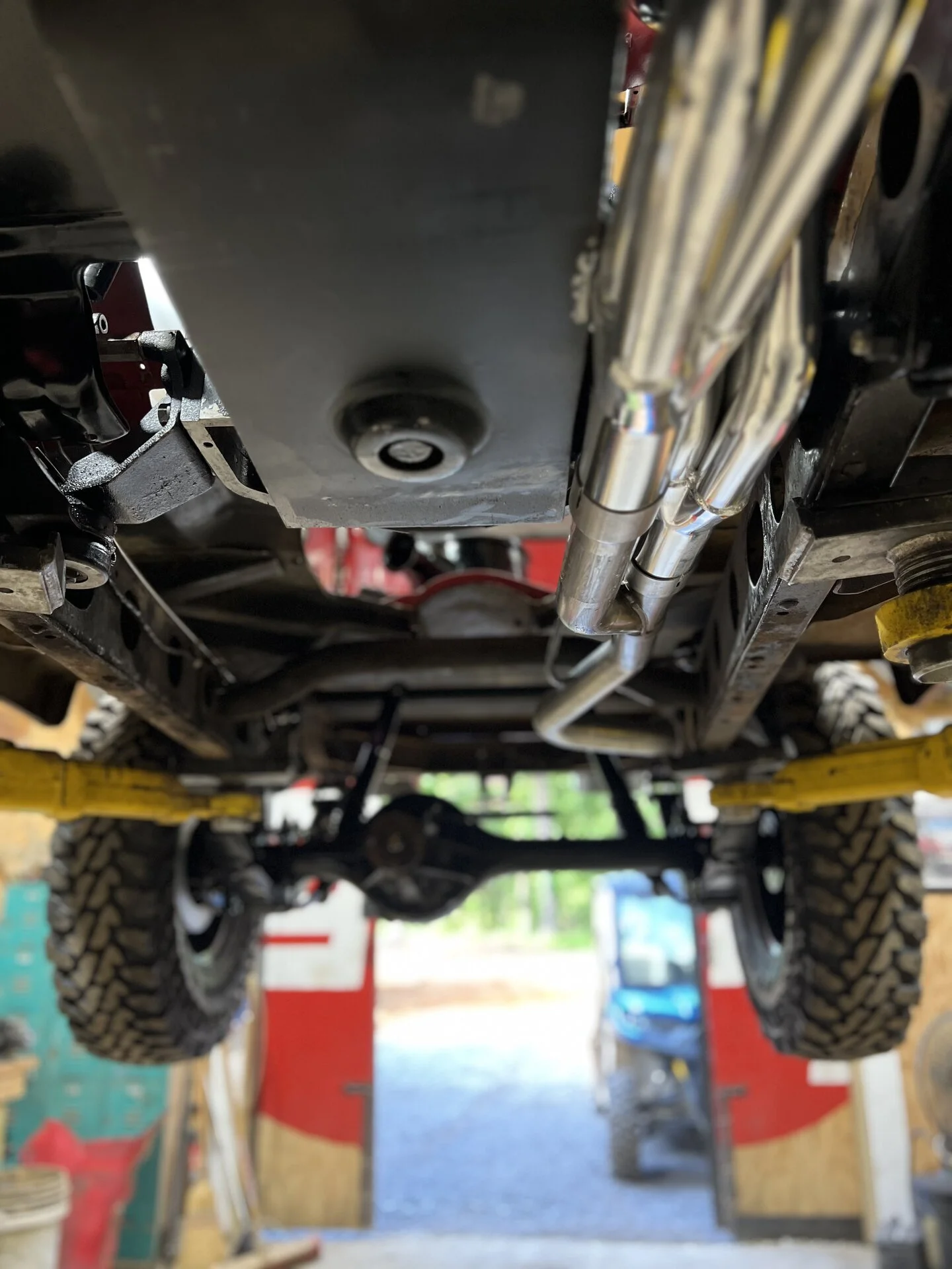

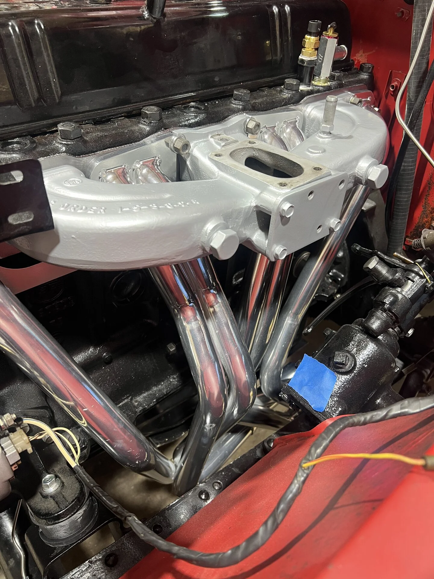

The Wizard came by and told me how much I suck and how s***ty everything is but he finally calmed down and settled on a plan for the exhaust. Hopefully he can get started Middle next week
Got the new adapter in from TSM and got the last caliper installed. Then I plumbed the master and Proportion valve into the new lines. Pressure bled it. I think the brakes are good to go.

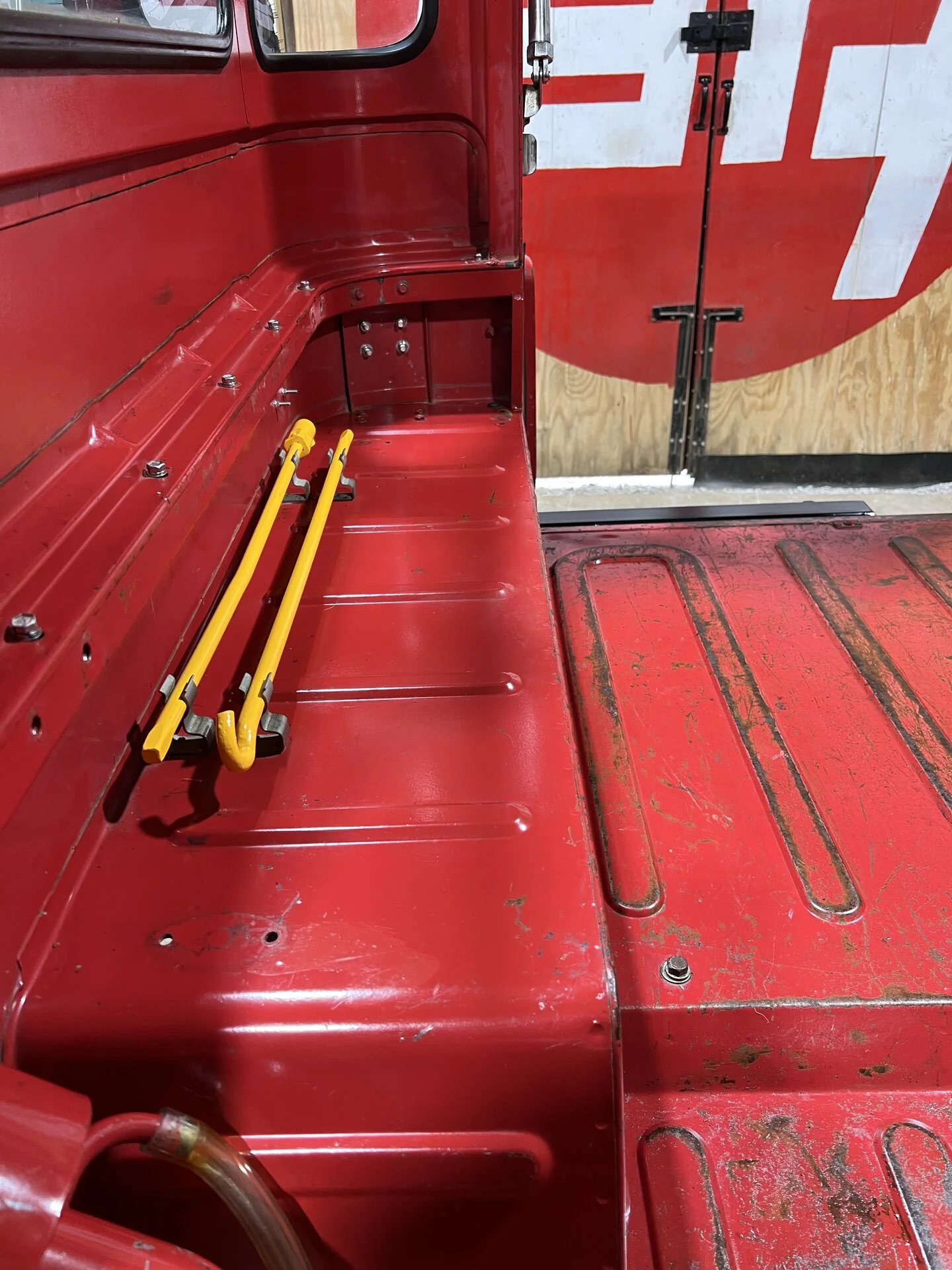

I had the jack handles powdered properly as well and installed

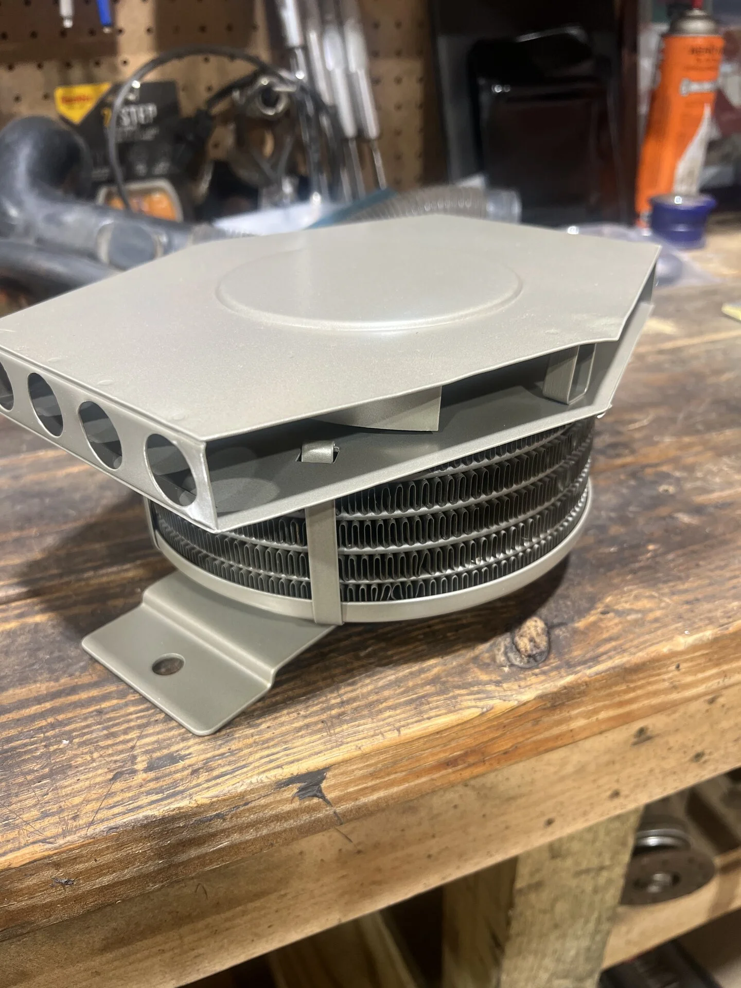

I tore this thing to pieces and had it powdercoated and it’s ready to go in place. Once it’s in I can finish plumbing

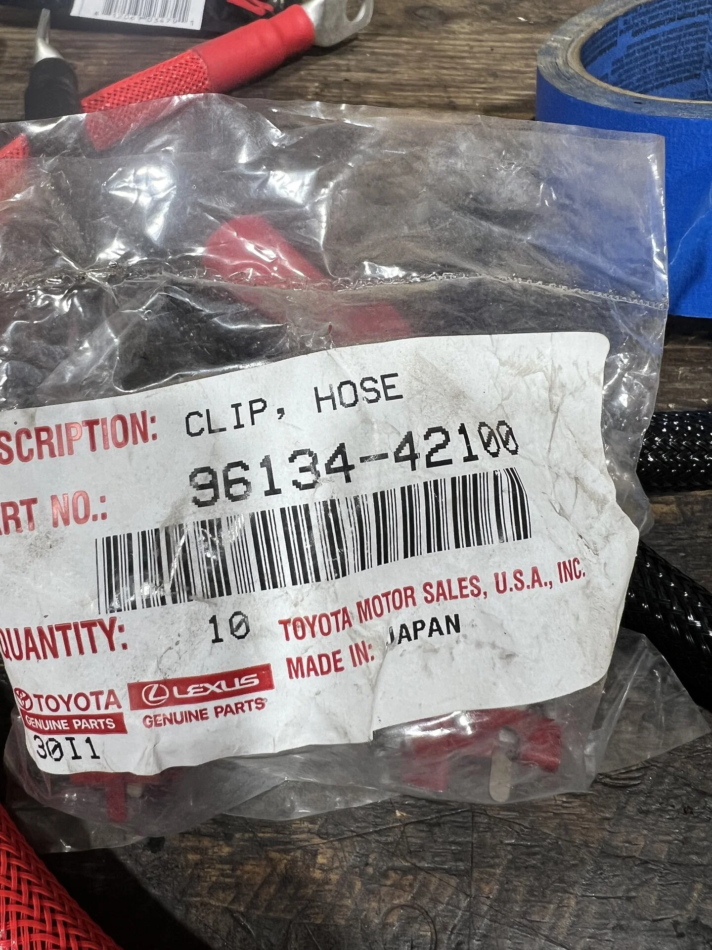

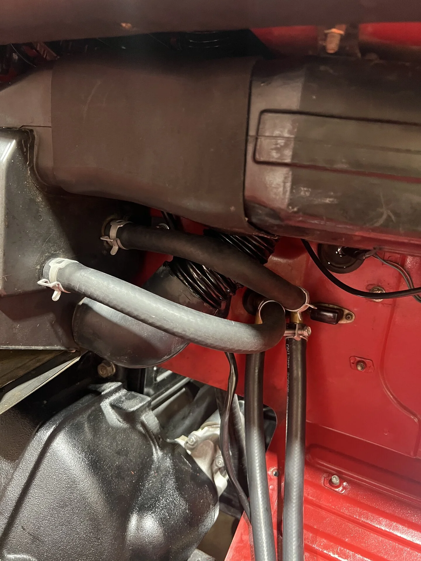

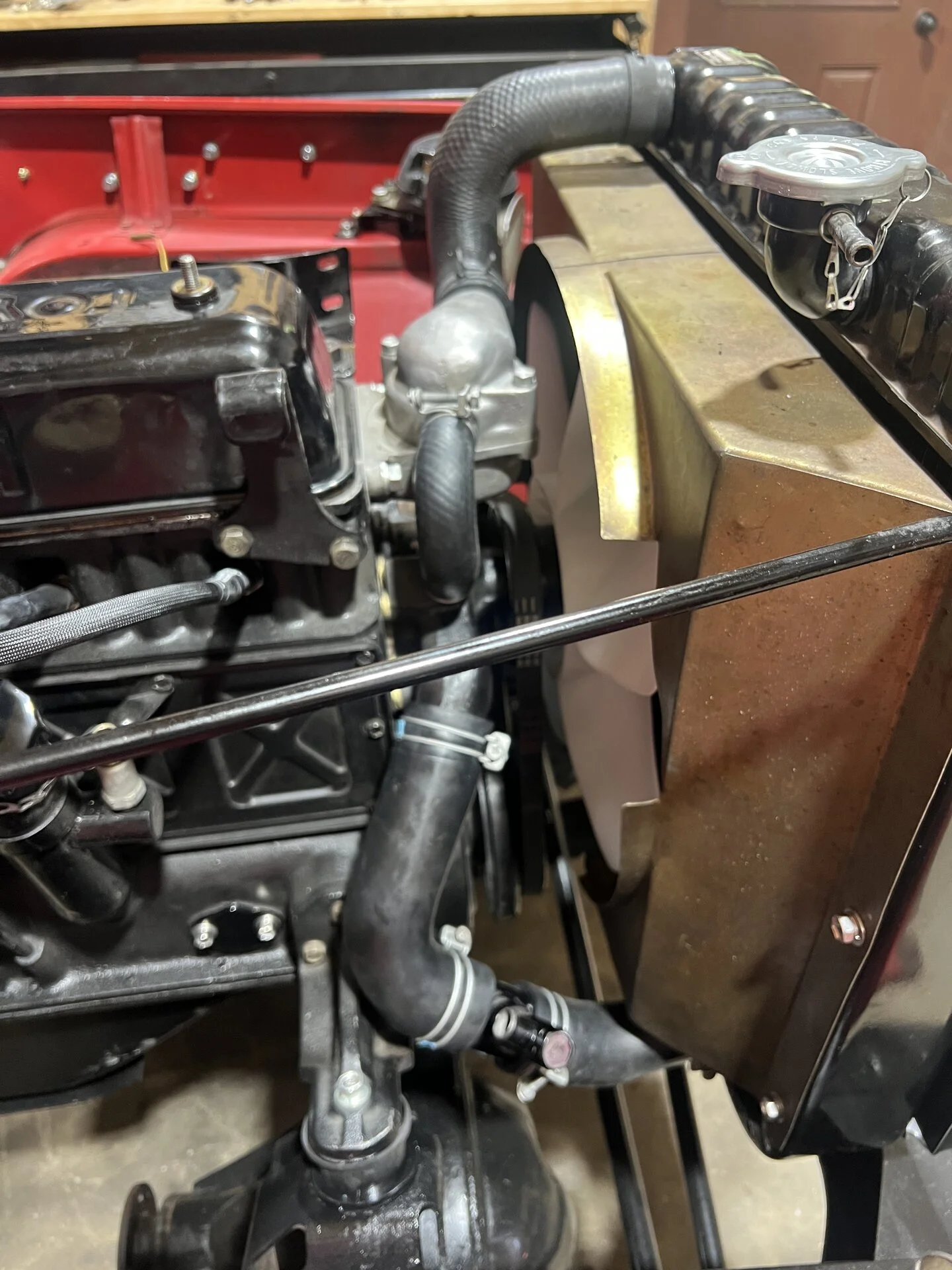

I like these little clips for 5/8” hose work. @OGBeno got me started using them. Great for tight spots.

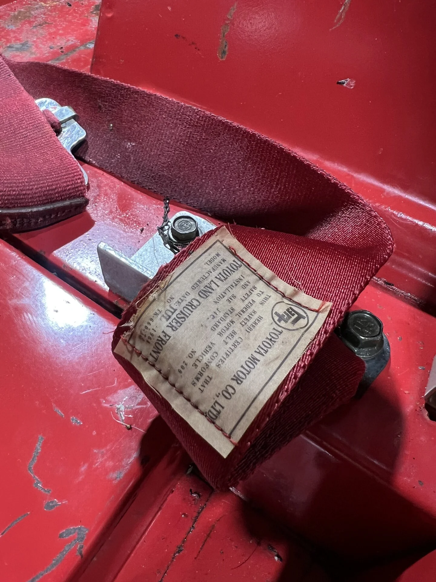

Also found some original red belts.

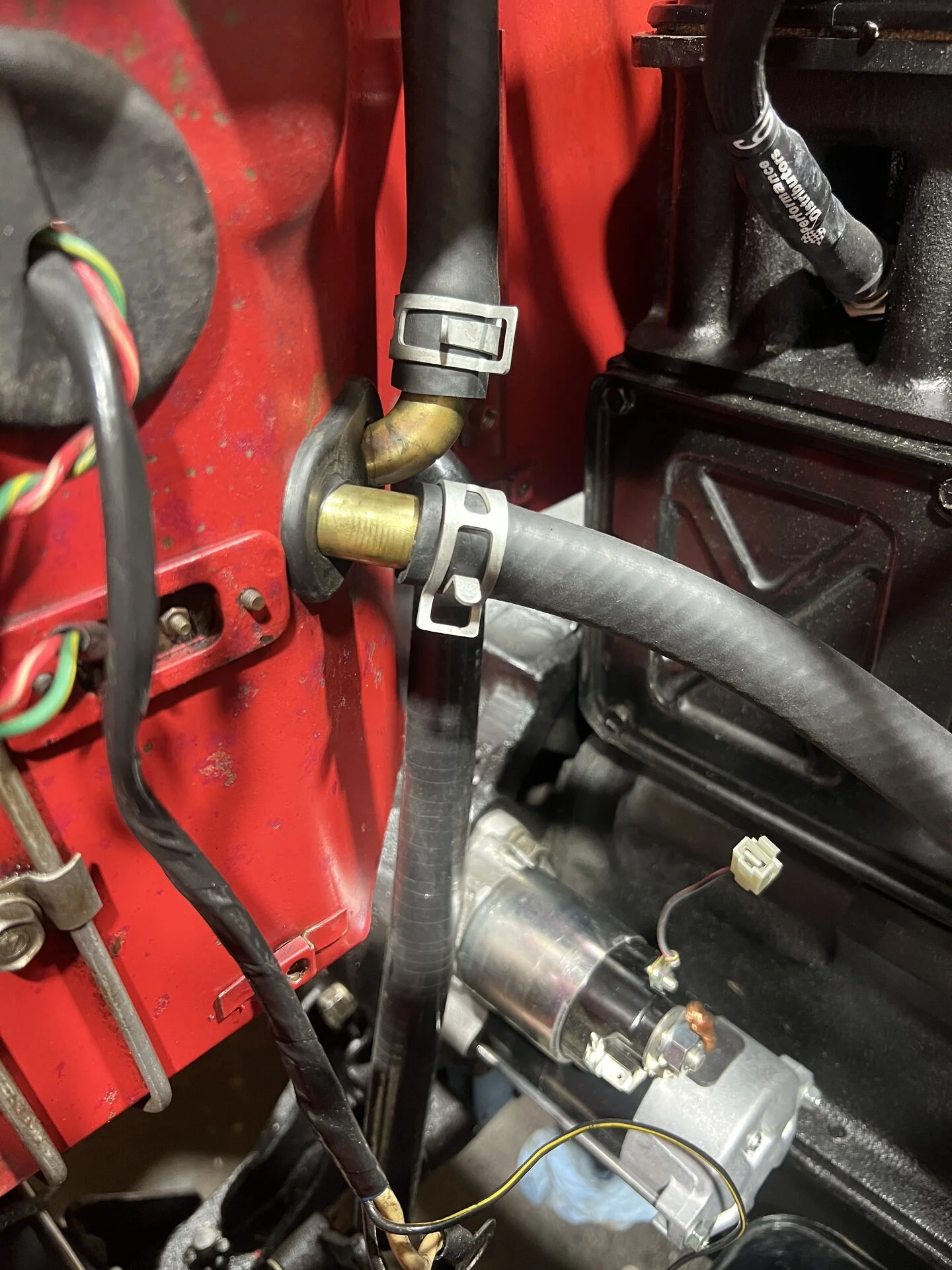

Heater back in. New hoses via SOR that actually fit.
The rear heater uses 1/2” hose versus the 5/8” the rest of the truck uses. I’ve honestly never installed one, just uninstalled them over the years.

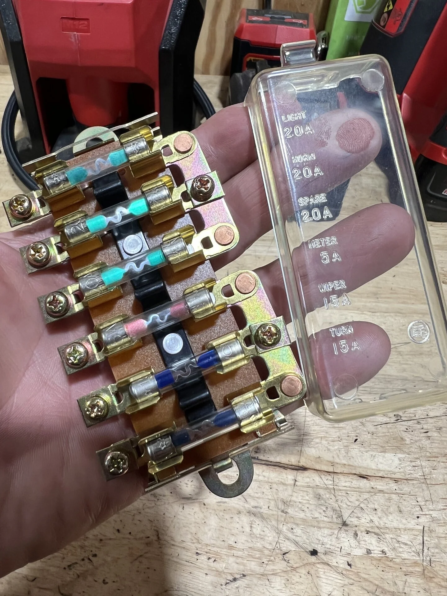

About to add this beautiful OEM fuse box into the truck.
@Fourrunner cables
@cooleman Fusable link since these years did not have one

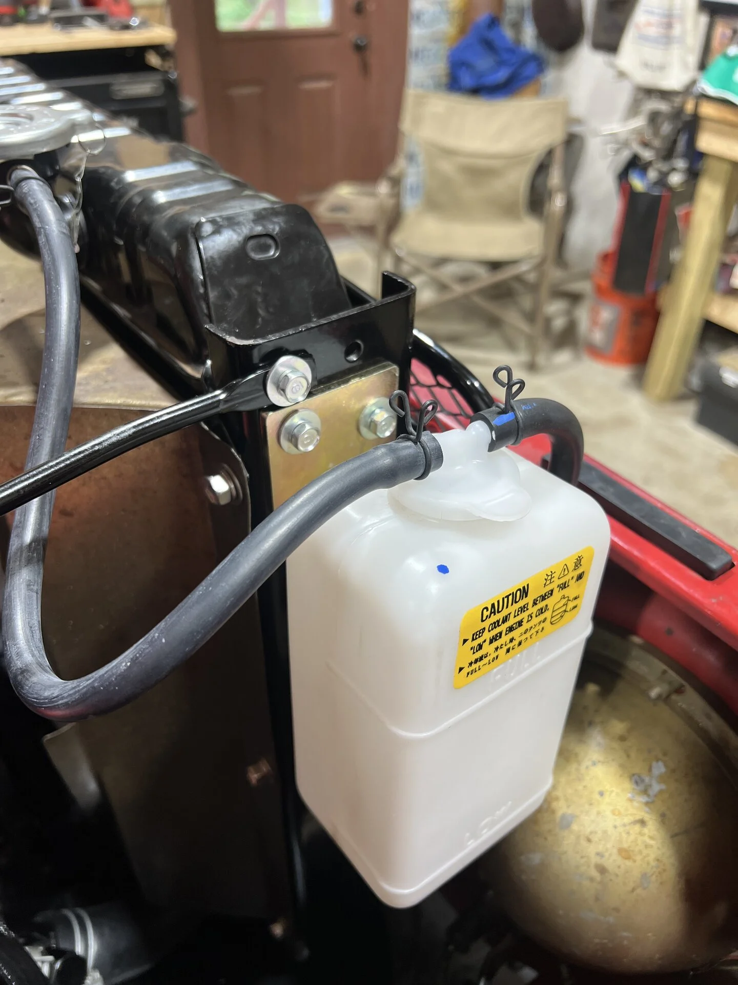

@ToyotaMatt overflow bottle
