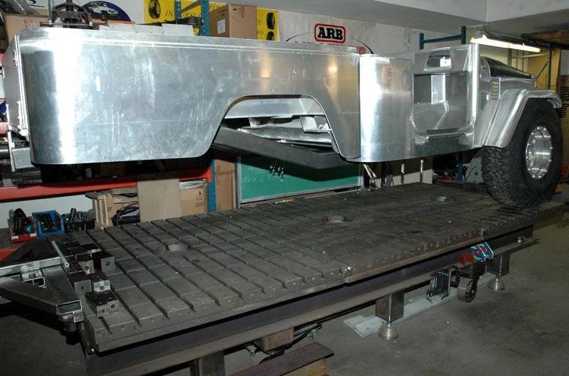

Im not sure on weight yet, but I cant see it being too heavy..
Frame rails are only 3/16", body is all alluminum, 6.0L HO Gen III Vortec has Alloy heads and composite intake...

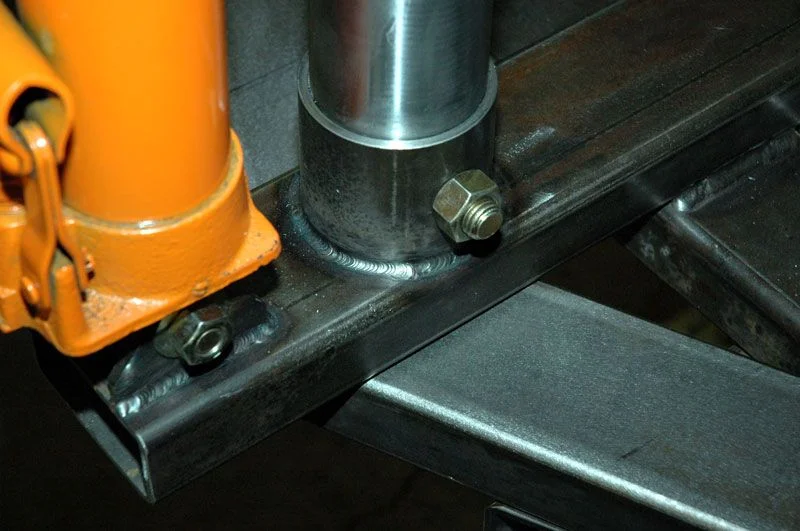

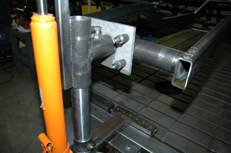

WE can adjust rake on vehicle with this and set the ride height.

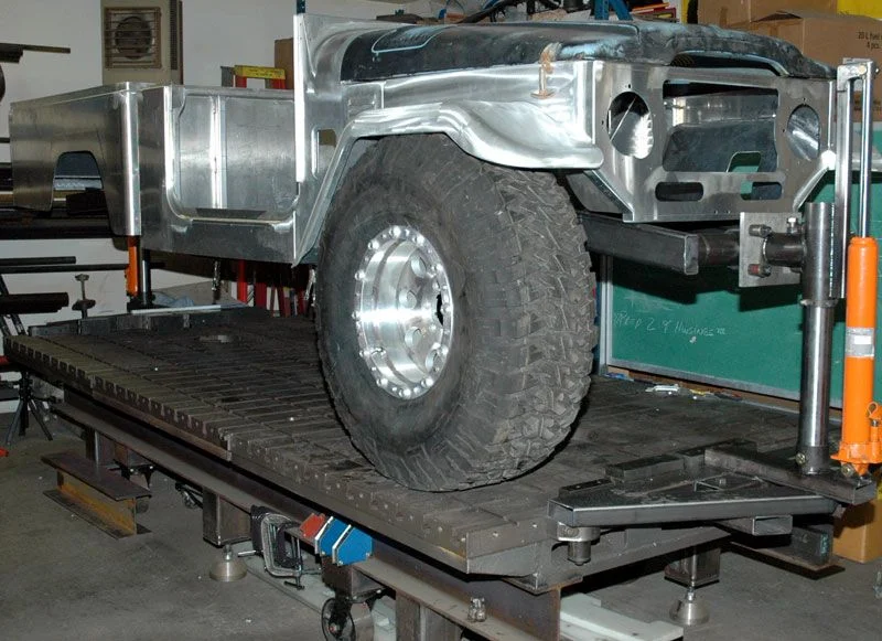

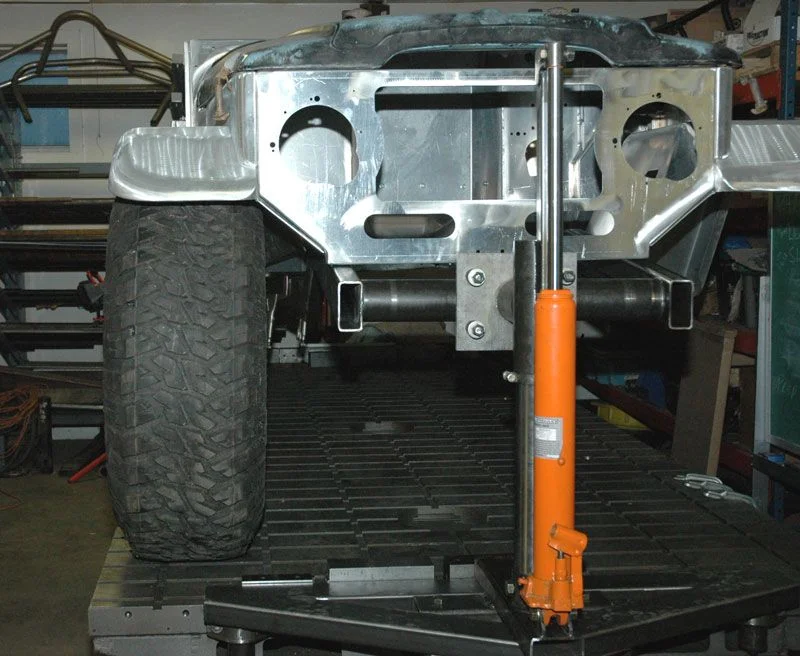

The goal is to fit 40's...so the trial fit begins. We will be cutting, chopping, building new panels, whatever it takes to get the look/stance that I want....like a Chip Foose or Troy Trepanier ride.

That is a 40" MTR:cool:

is the frame at ride height with the tires tucked under? I see a LOT of trimming!

Woody: Not yet...soon

beaufort-fj60: The rim is an Axxis 17", I am using these for mockup because i have a set laying around in my other building. They are a good rim.
