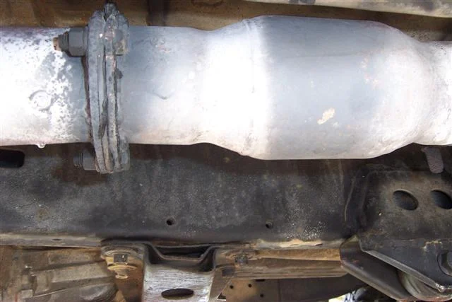

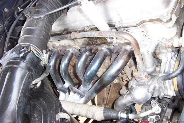

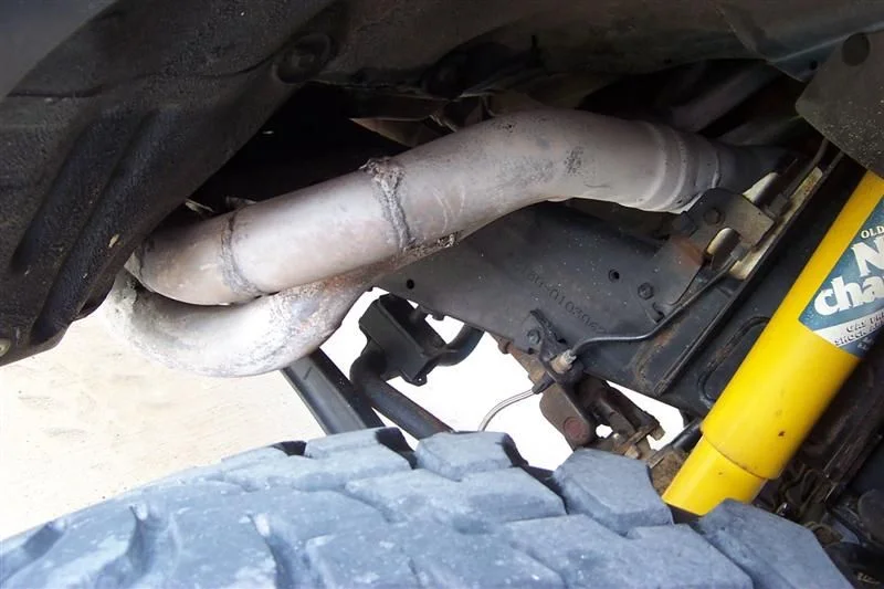

Try swapping out the two stock cats for 1 high flow dynatech. I also went with 3" pipe from the headers back tucking all much higher up under the body and next to the frame. I noticed a significant difference in power. I am starting to wonder about adding one of those superchargers. Was it tough to install?

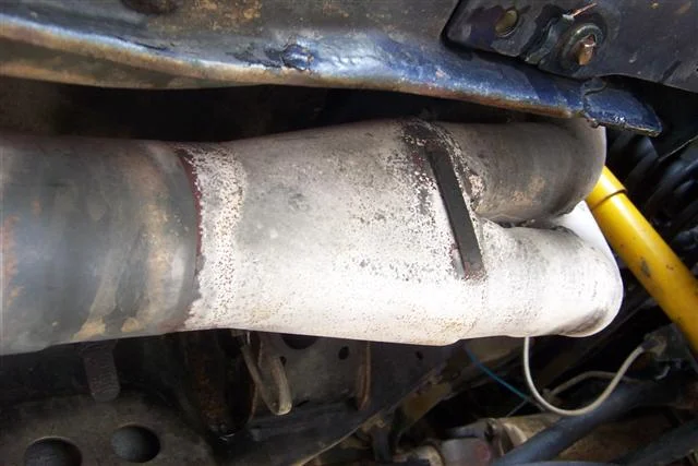

Did you have to do anything special with the O2 sensor?
We installed the forward, pre-cat O2 sensor in the flowmaster y-connector. If you look closely in the pic you can see a wire barely looping down from behind the y.
Jegs had an O2 sensor nut to weld in.

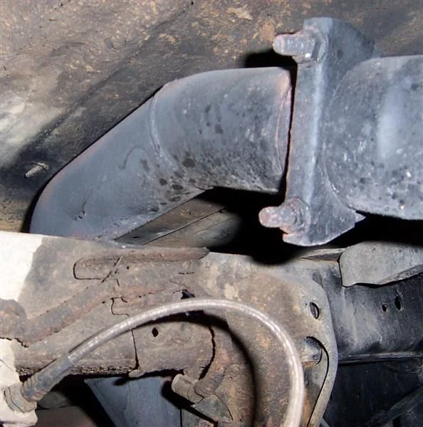

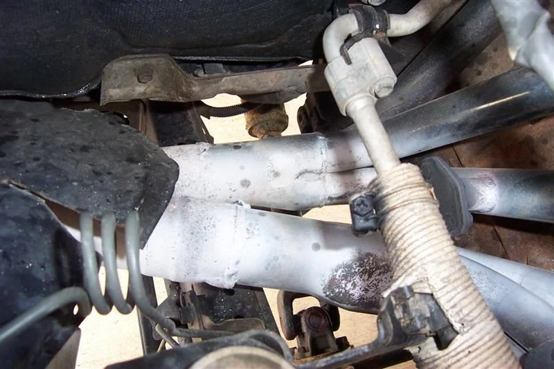

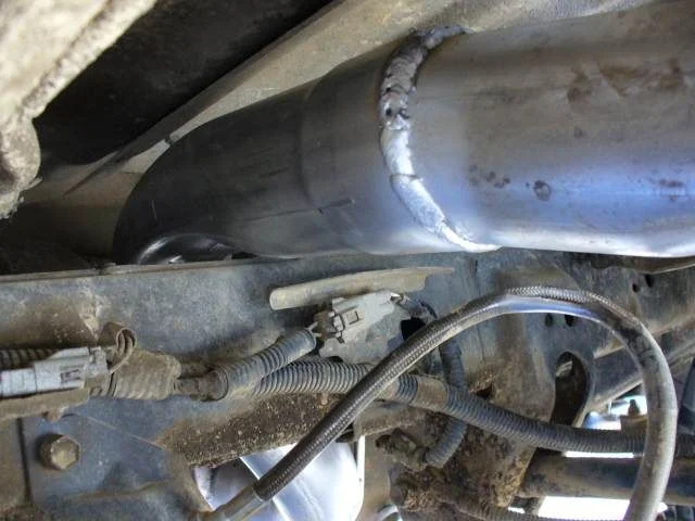

Here are pics of the routing of the pipe over the Frame. It comes out the back behind the tire. I might cut that back and angle it down though (Christo's suggestion)
It's crimpes a bit over the frame, but there is at least 2" of flow vs. the 1" crimp that was there.

3" pipe w/mandrel bends... http://www.man-a-fre.com/pa2/3inchceramiccoatedcatbackexhaust.htm
Information obtained at the time indicated that with the headers, high flow cat, and custom collectors 4.5 liters is the minimum displacement for 3" back without having a negative effect on low end response. Higher RPMs is where I feel some nice pull.
Ken
You better do something about that brake line as its getting too hot and melting like :eek:
Good catch, I will take care of that.
