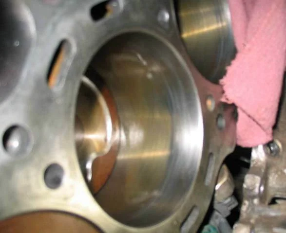

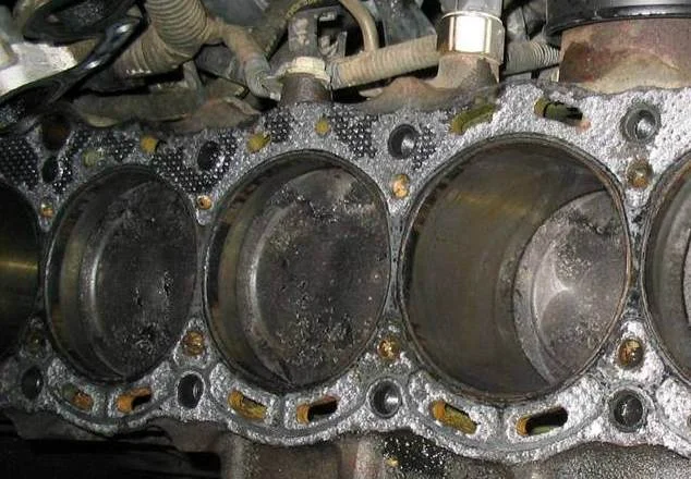

When I was changing the starter contacts I noticed my PHH was in bad shape. Robbie had previously said he saw signs the Head Gasket was going, I also had been wanting to change out the Fuel Injectors. It was running OK, but I wanted to get it in great shape. So I took it to Adventure Off Road and had the following work done:
Head gasket setreplaced, New Spark plugs, Distributor cap and rotor replaced, Spark plug wires replaced, fuel filter replaced, EGR gasket replaced, Distributor O-ring replaced, Water pipe gasket replaced, Fan Clutch replaced, Thermostat and O-ring replaced, Throttle body cleaned out and the PHH replaced.
When the head came off I was told there was tremendous buildup of carbon, more than normal for my engine. The pictures below show the before and after shots.
The head was also slightly warped and the valves needed to be resealed. The head was milled .011. It was running pretty good for all that crap. Must have been the computer compensateing. It runs great now.
The PO must have run cheap oil and did not change the oil when they should have. They probably ran cheap gas as well.
Great service and I would highly recommend Adventure Off Road. You probaby know it by another name, Robbie.
Like I said, who needs the Head Gasket DVD when you have Robbie.

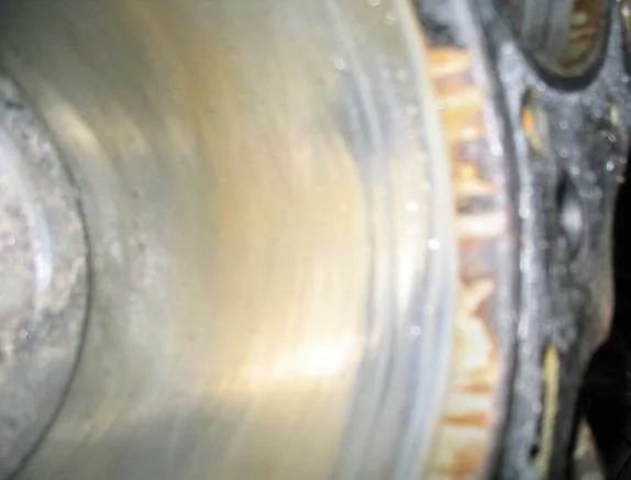

The only remaing problem is Robbie said the carbon build up behind the rings. allowied the rings to push a little more into the cylinder wall, creating a little ring groove. Don't know if you can see it in the photo.
The engine will still run fine for quite sometime and I should be able to get well over 200,000 miles on it. Currently at 114,000 miles. I run Red Line synthetic so that good oil should help and the grooves hopefully won't be a problem.

How did Robbie get it so clean? That engine block looks really great with the carbon cleaned off. 10 hours of shop time is not as bad as I thought.

Andrew I use a combination of scraper, and scotchbrite pads on a air grinder, with some hand work inbetween. The one mistake Ken stated is the job is a flatrate of 15 hrs. He had some extra time involved with the wiring and fan hub, injectors, thermo stat. A little extra work, but it is the way I think it needs to be when you pull the head off. I learned head jobs on big diesels and in those days you used sand paper and wire brushes and used cylinder plugs to keep the sand out of the engine.Oil is also used to clean the cylinder walls and any depree from the cylinder walls before the head goes back on.
