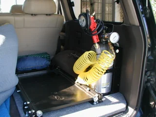

Angle mount and in the rear corner of the cargo area. Check out my ROTW.
SAm

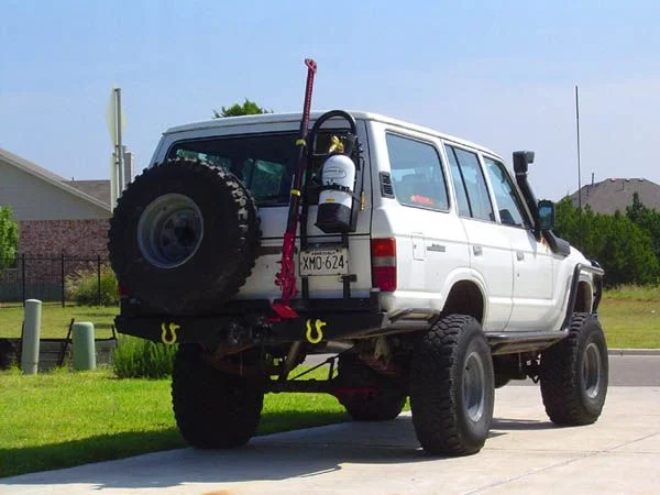

I don't run a roof rack all the time, so I mounted mine on the rear bumper's ladder. Bought a couple of clamp mounts of the type used to mount accessories to roll cages, and drilled four new holes on the mount. Works well, it's hard to see in the picture but there's still enough space to use the ladder. I have a neoprene cover with a velcro cinch that covers the valve, works great so far.
Seems like the perfect place, out of the cargo area which is usually taken up and off theroof rack. The ladder is usually only used for loading the rack, so seems like the perfect spot and you can still get around it. Great rig.

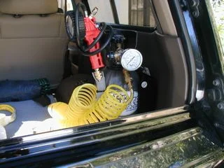

See page 4 of this thread.
https://forum.ih8mud.com/showthread.php?t=63375&highlight=co2
It shows both Beo's platform and what I did. My pics include the bracket by itself and with the CO2 tank installed.
If you'd like something separate for your FAQ, let me know and I'll write something up to post.
