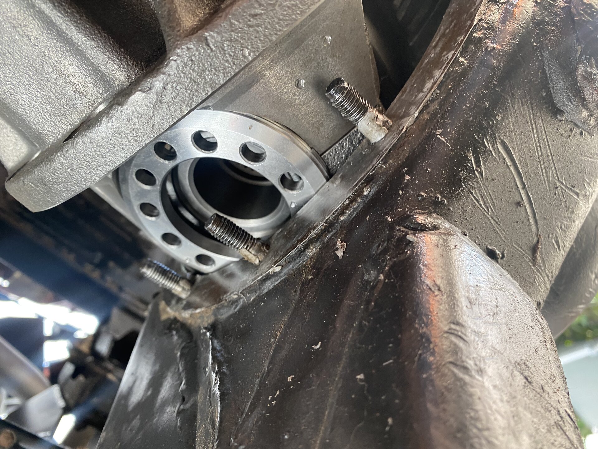

Swapped my low pinion ARB for a new HP ARB. Was going to put the LP from the front in the rear to replace the detroit that I can’t stand. However, The job took a lot longer than I expected because I had to grind a few areas to get the diff in. 5.29 LP fit fine, but the 5.29 HP wouldn’t fit at all.
Both sides needed grinding.
Also top and bottom for the gears and carrier

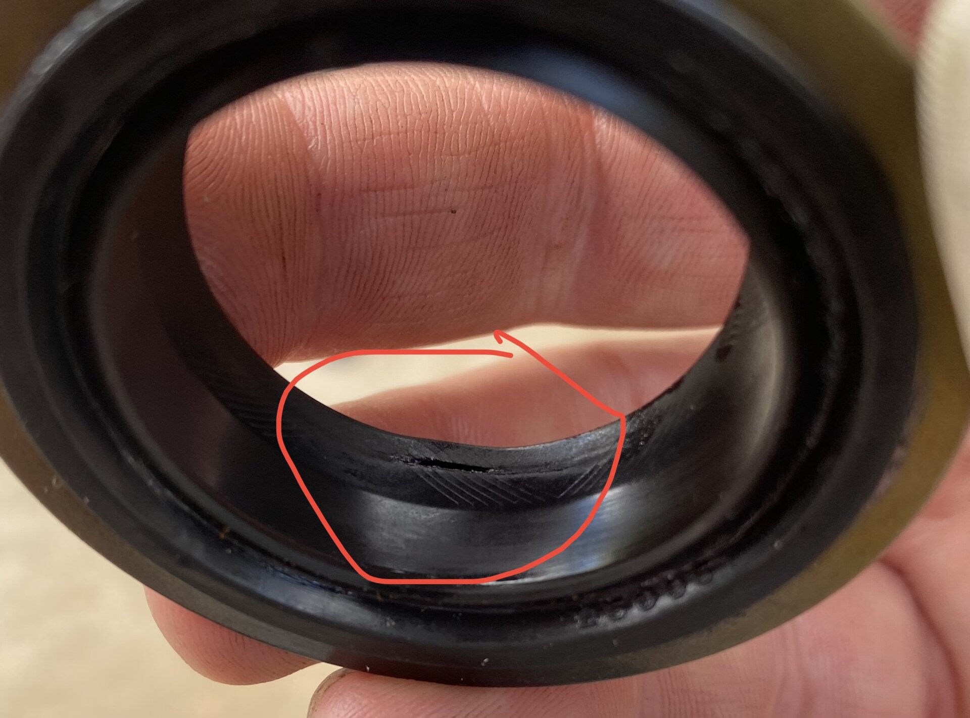

Also addressed my bad inner axle seal. Had the whole chocolate milk on driver side. Hoping this mark (was at the top) was original and wasn’t made when removing the seal. I think I may have boogered it up when putting that out of spec RCV in and out ~10 times late last year.
Fingers crossed the housing isn’t bent
Yeah...........you just gave me flashbacks of finding out I had to grind while I was holding that heavy sucker up trying to stab it. Gonna be nice when you're done. I hope it's not bent too.
I went through the same woes today 😂
I got my technique to hoist the diff into place down pretty well by the end of the day, that’s for sure.

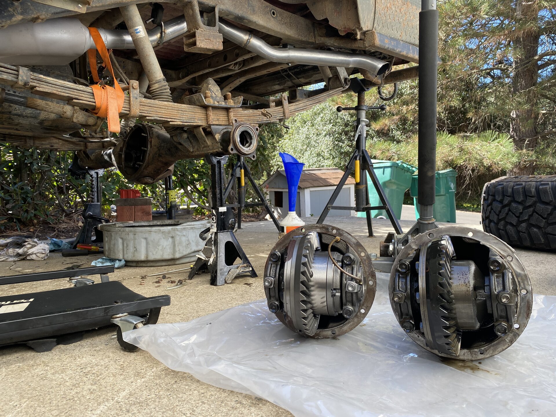

So on diff talk - you and I were discussing the detroit a few months ago and I feel like I didn’t articulate my gripe well enough. Here’s a clip of mine to explain.
And here’s a clip of the locker operation.
My assessment is that the roughly 1/32 turn of play or whatever you can see between the collar is translated into about 1/8 of turn when applied through 5.29 gears. In a rig with less deep gearing and with an automatic to absorb the load, and keep the face loaded, it probably isn’t so bad. On dirt in low range it isn’t terrible, but on pavement in high with a manual, I can’t stand it.
You mentioned something along the lines of “if you don’t like it, change it” — that’s exactly what I’m doing right now.
Keep in mind I said that because you seemed on the fence about spending the money for the HP ARB but "Hated" it. Not to be a smart ass. I didn't want to see you regret keeping something you hate on your build.
I had Detroit Lockers on several of my field service trucks. 5 speed trans and 2 speed rears. Big trucks compared to our Yotas. They definitely took some getting used to and could be annoying but I seldom got stuck on job sites. Once or twice in deep sand river beds. Never saw that kind of backlash on any of them. They even had them in both axles of underground loaders at the mine I worked at. I never saw one break. I've seen pictures but never personally.
I'm glad you went with what you really wanted.
To add, I'd like to see if anything is broken in the Detroit. That is a lot of backlash.

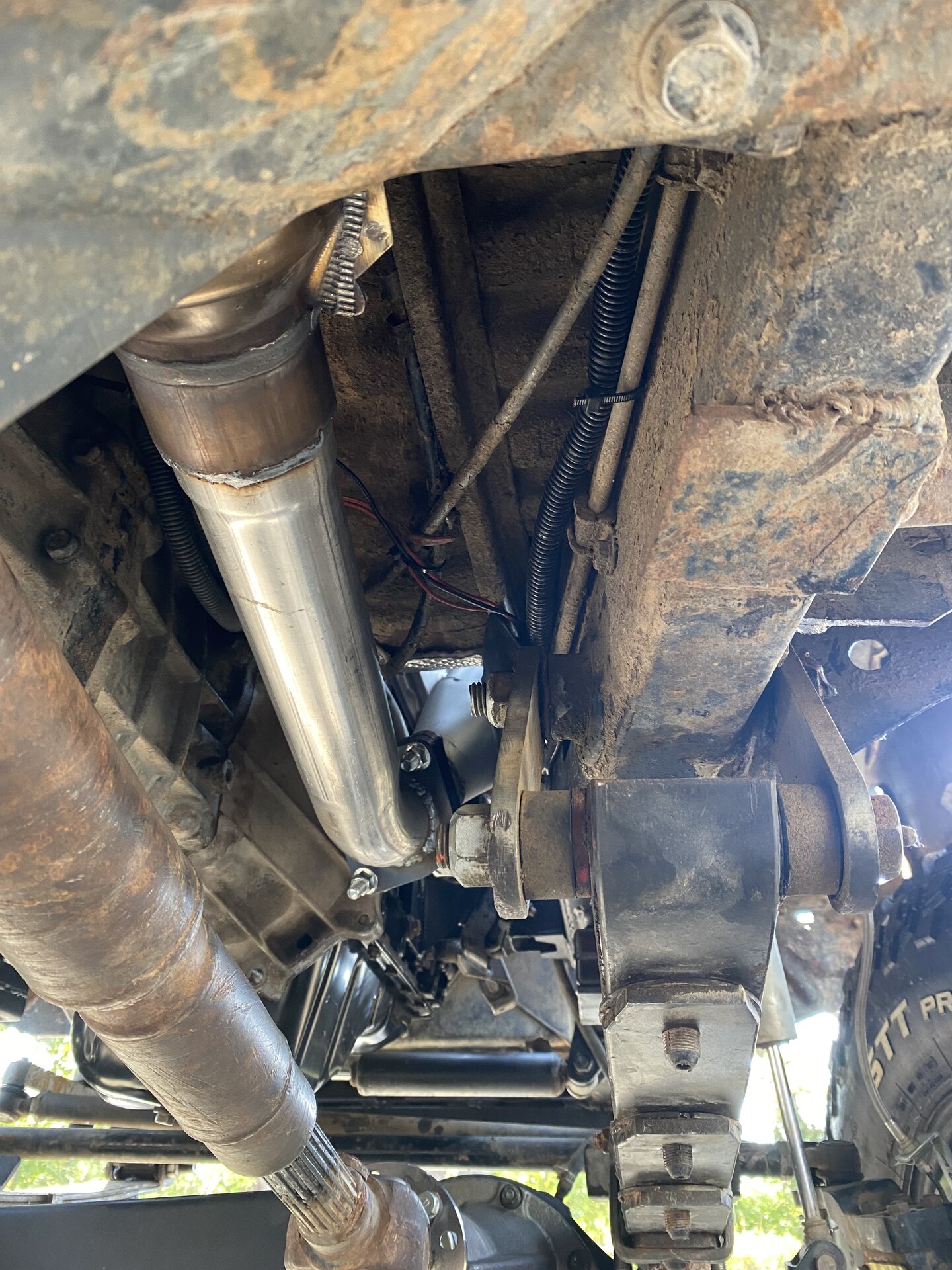

Massive day. Towed it to Casper’s Muffler in Diamond springs. They did an excellent job putting the cat between body and cross member and then wrapping behind t case. I went for a flow master. It sounds pretty good. Definitely a little on the loud side for me, but I like it so far. If it gets annoying I’ll swap it later. It sounds really good coming down hills decelerating. Has a nice deep gurgle without popping.

Here’s a few of the exhaust routing. Casper’s muffler and hitch in Diamond springs did great. If anyone is in Sac or El dorado county, don’t hesitate to use them.

I swapped the Detroit out on Friday for the ARB that was up front - the one I replaced with the HP ARB.
