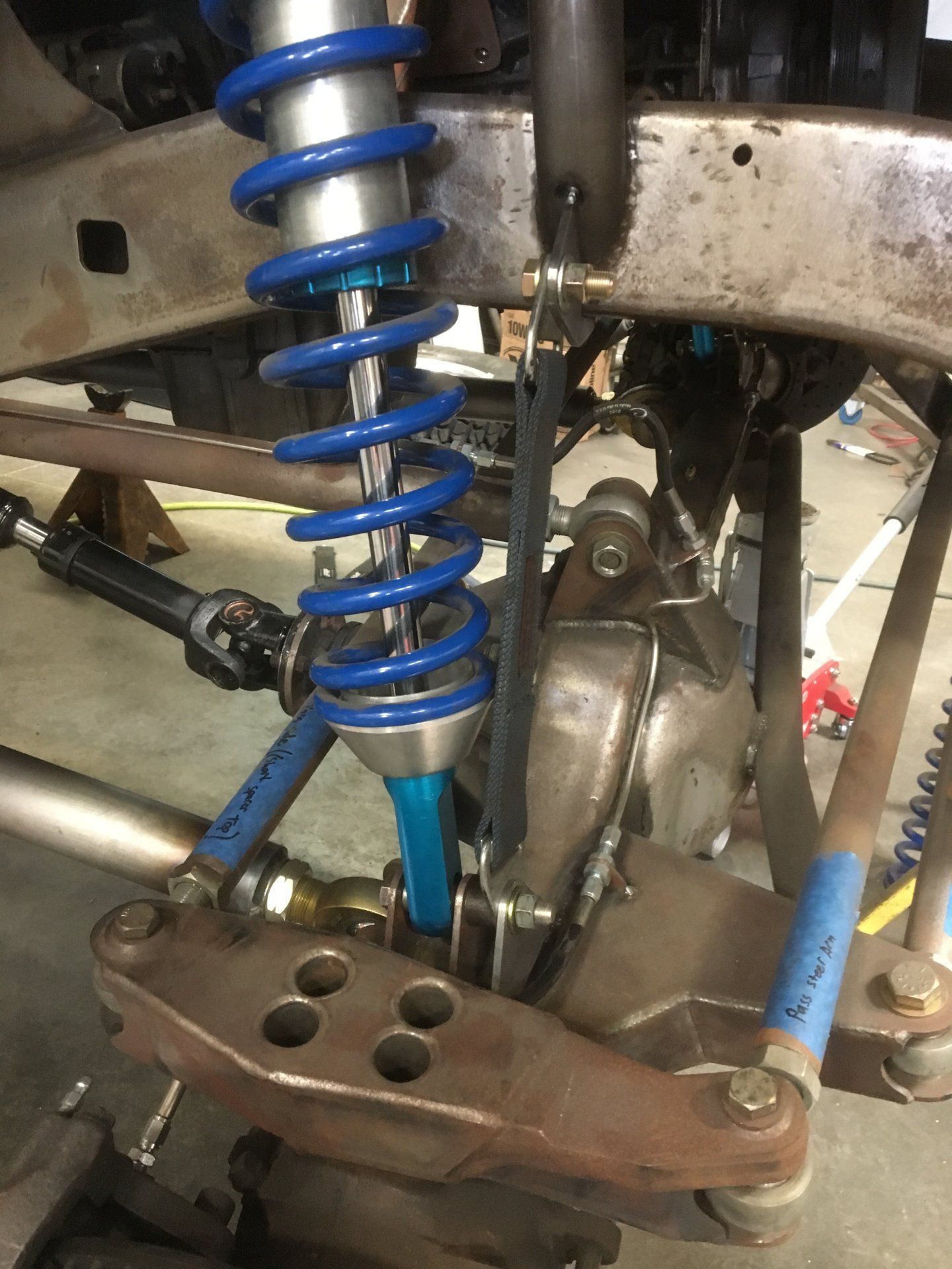

New front link mounting point on frame done.

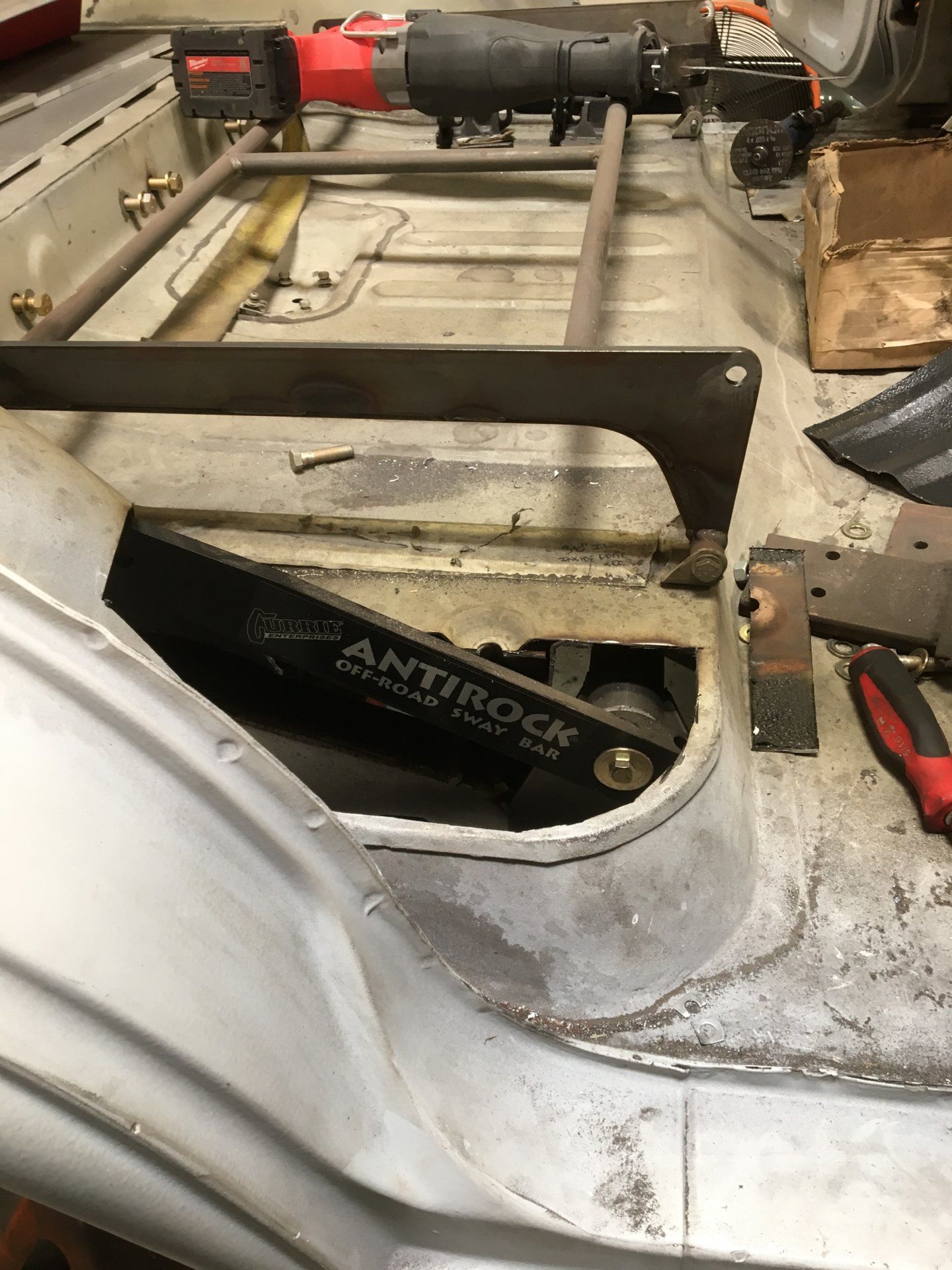

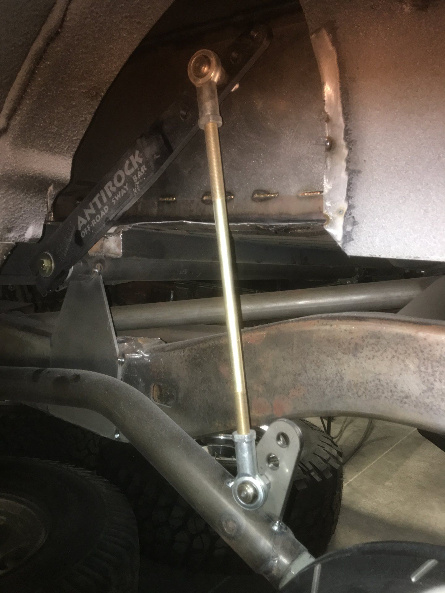

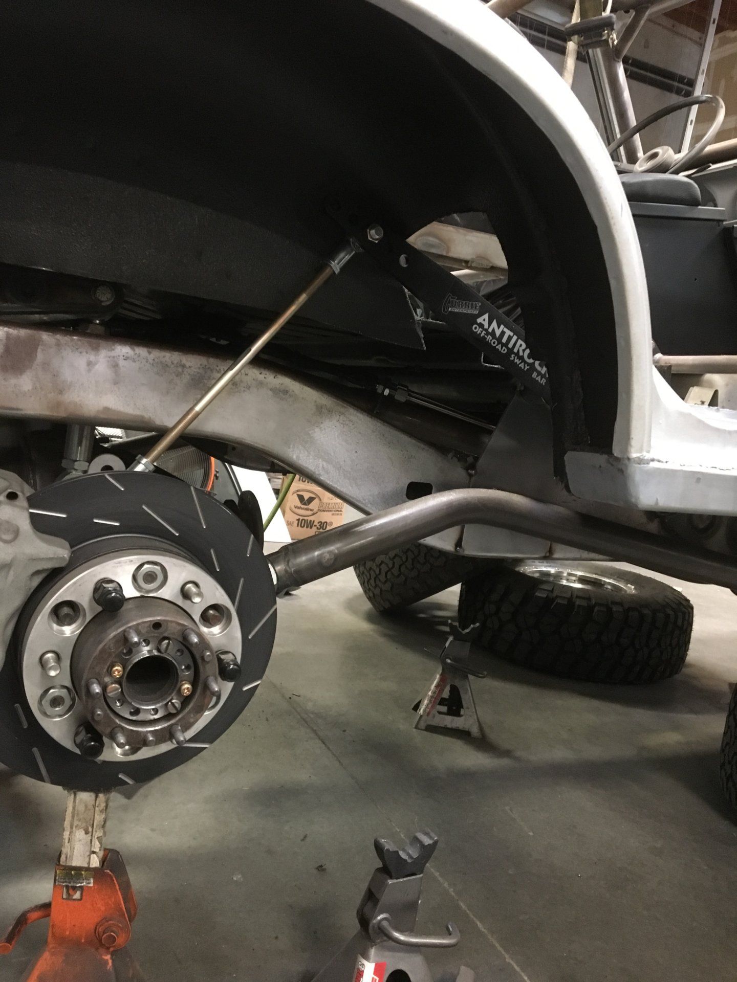

Think we’ve got space for the Currie Anti-Rock Sway Bar. These links going to axle look a little weak. I’ll be making beefier ones once we determine the length..

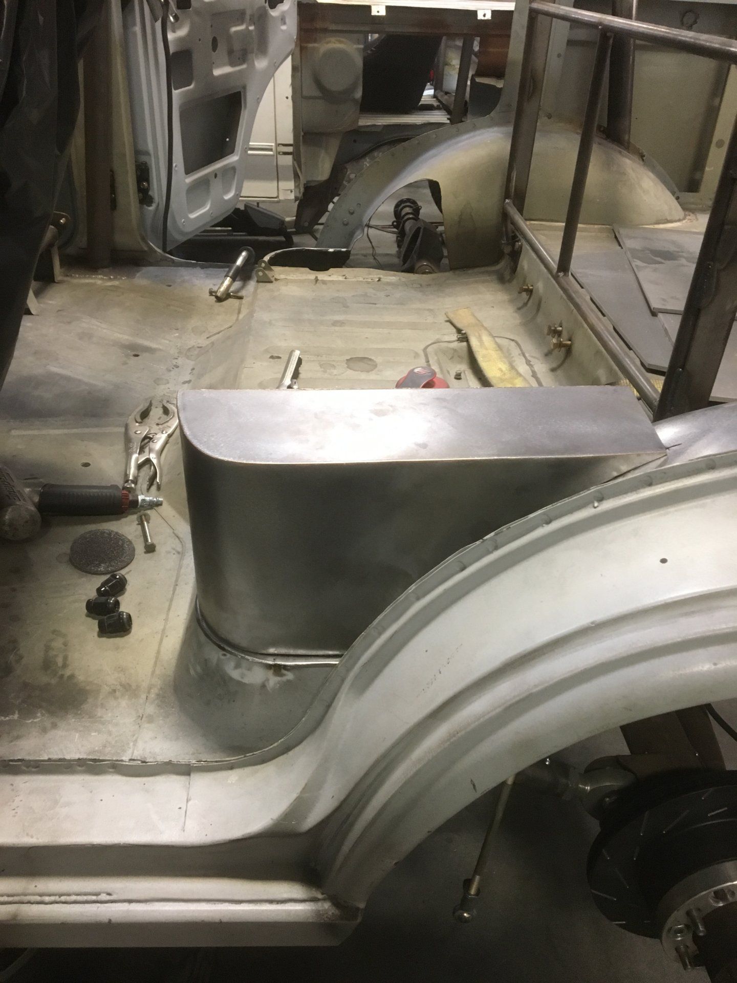

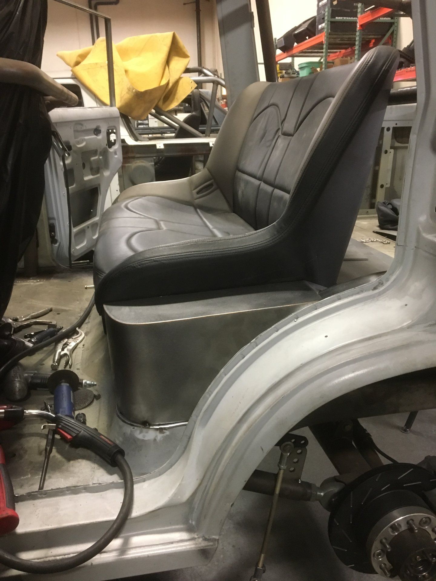

Had to open up wheel well to clear arm, but now we’re going to build and arm rest with cup holder in it since we need to do some sheet metal work anyway. Keeping the passengers happy since 1971!!!
Got cover pc mocked up. Seat fits pretty well. I’ll make sure to radius all edges. Gonna take a pc of tubing to make the cup holder pocket.. link mounted to lower arm instead of axle.
