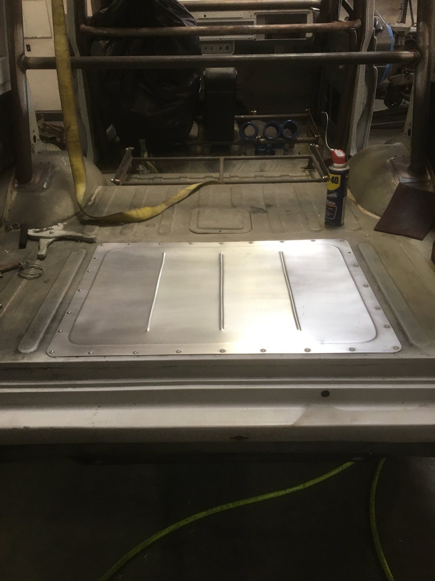

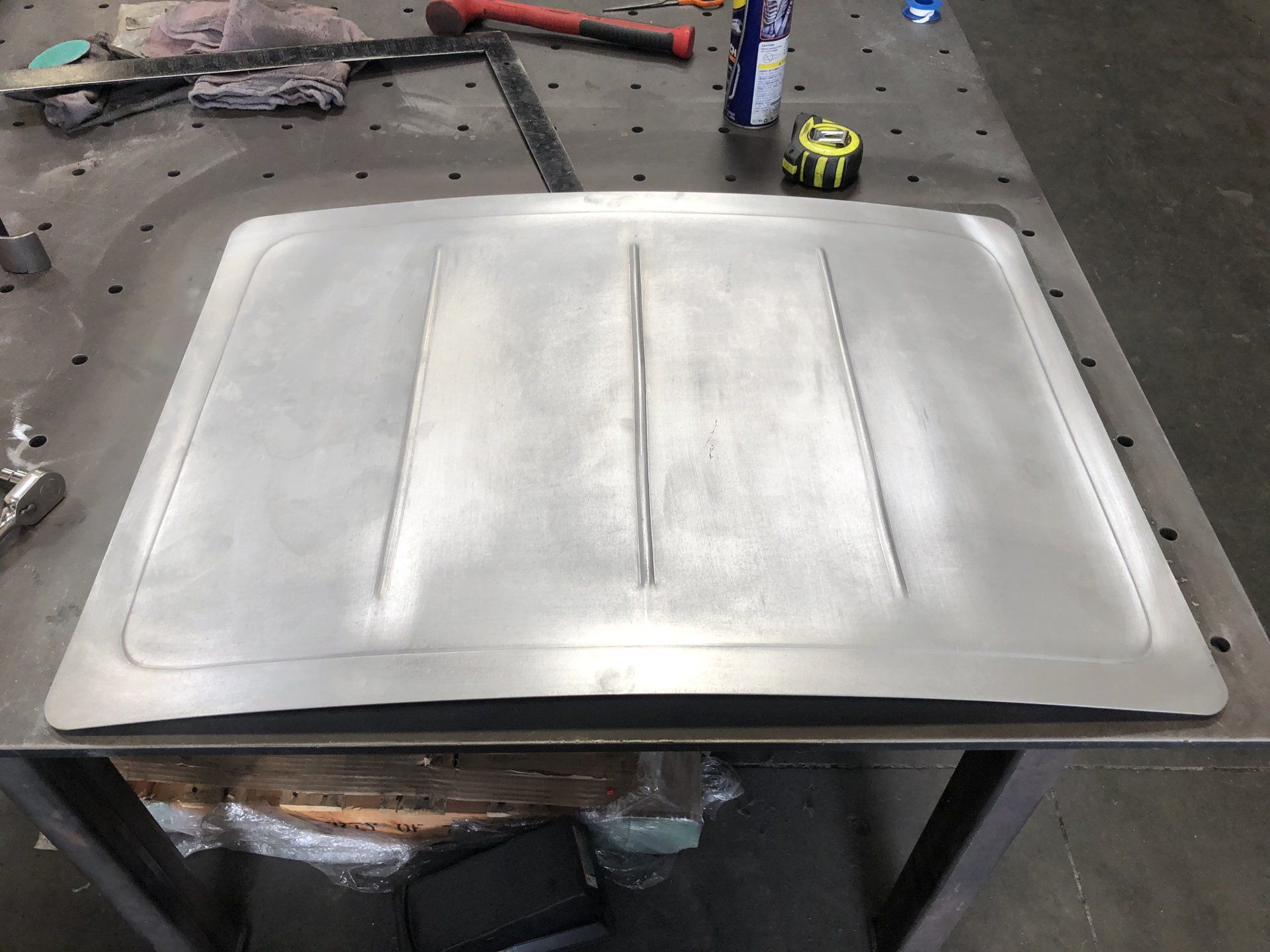

Rear access panel coming along. We’ll probably make an aluminum rect flange to help keep flat and seal properly. It’s all getting spray on liner too...
I dont know what liner you are doing but I am really impressed with the Raptor liner I put in mine.
I think you're going to make the Party! When's the painting starting. I would be bumming out thinking about taking it all apart to paint. Hopefully you can delegate that part out. Keep at it!

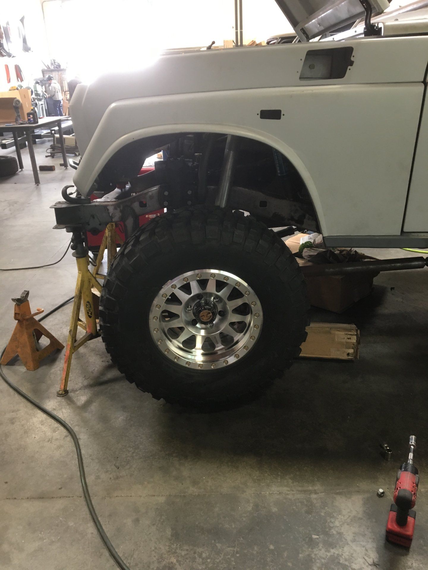

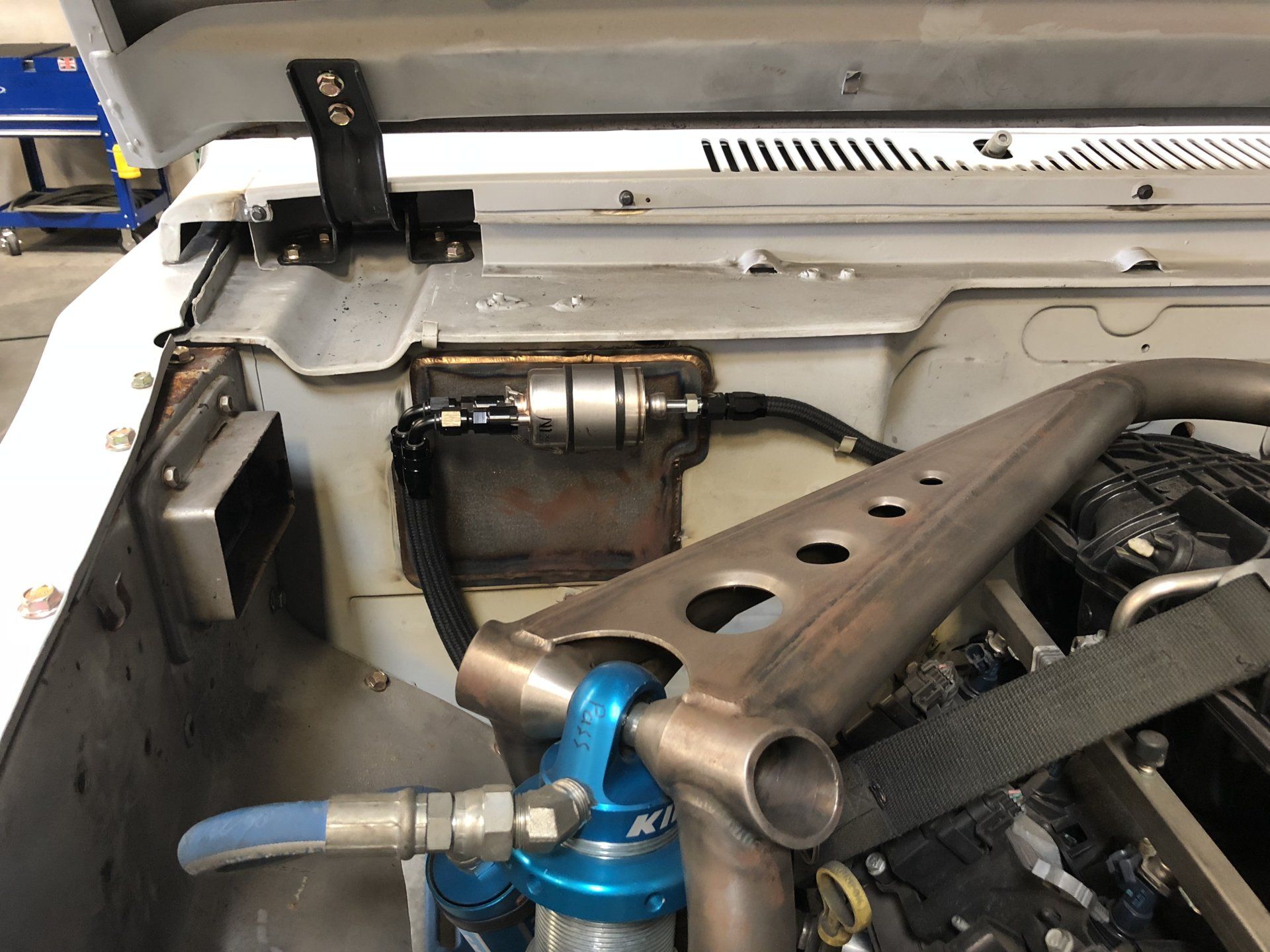

Plumbing for fuel and brakes complete. Front driveshaft ready. Wheels and tires ordered and coming to check all clearances at bump and droop. Limit straps and bump stops coming soon
Looking really good @landcruisnman I haven't been by the shop in awhile, I need to go check it out. Did you order 37's? That's what I've always planned to run on mine also but I'm not going to trim the rear either. I still plan on having custom front fenders made though. Once I weld in the patch panels on my stock fenders I will take them down to have the molds made.
