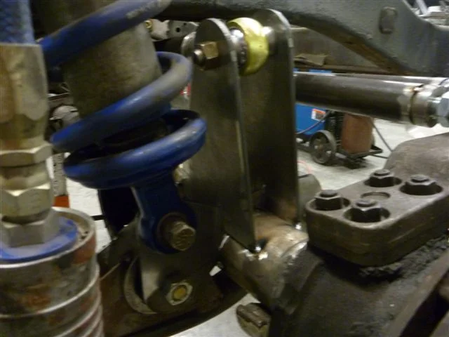

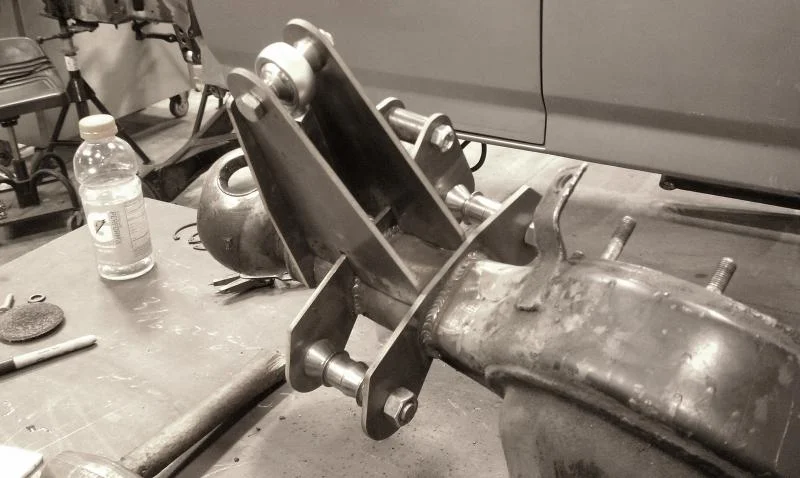

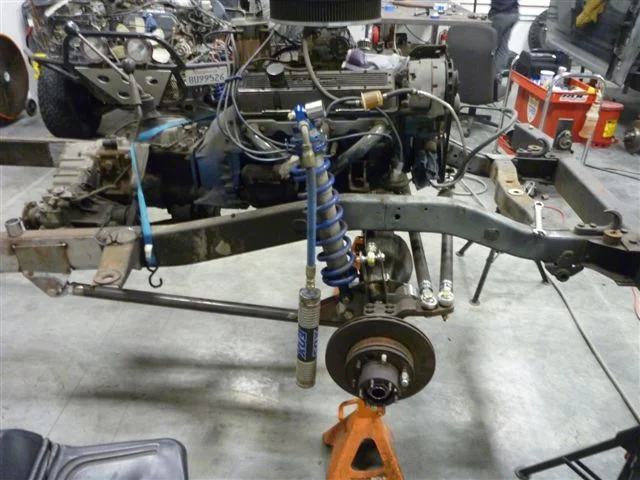

We've got the lower shock mount located. Made a new bracket that holds the link bushings and incorporated a tab for the shock. All this stuff is only mockup. Once we've got it figured out, we're going to burn everything out of Chromoly and box it all it. Shock hoop coming soon....:)
Are you going to support the other side of the bolt for the bottom of the coilover shock???
Yes. We're going to make a new bracket for the panhard mount that has a tab for the other side of the shock/bolt. Should have it made this week and will post pics.....
Yes...having them back from wheel center a little should give us around 13" of travel....we should be able to articulate it later this week, but I need to put the body on for weight. I'll post some more pics soon. You have a beautifully inspiring wagon by the way:cheers:
Thanks! Any ideas what spring rates you are going to run? Are you doing a dual coil, with a slider and stop, or a simple single rate?
Thanks,
Ryan

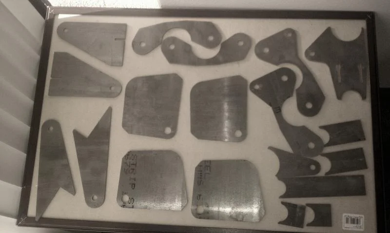

Plate parts Waterjet
We've got all the tabs and brackets cut out for the front end. Used .190"th 4130 sheet. Waterjet for clean holes....gonna weld these up Monday. I'll post more.....:popcorn:

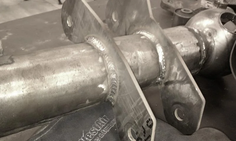

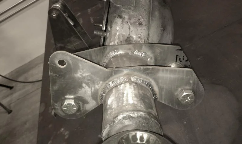

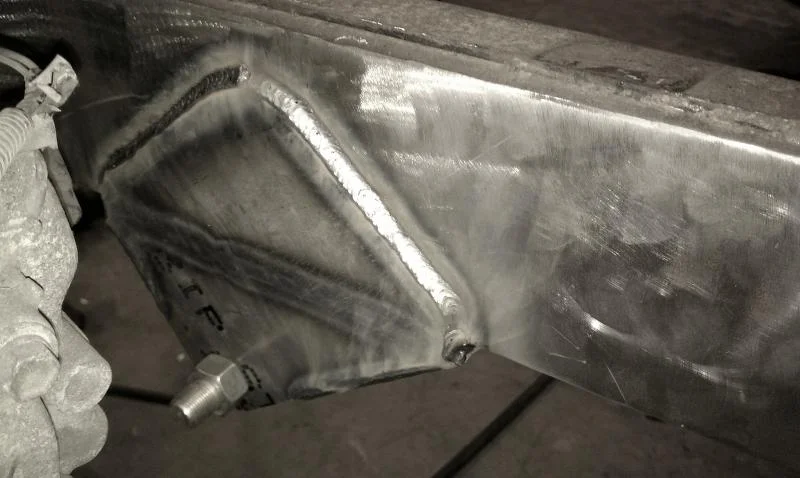

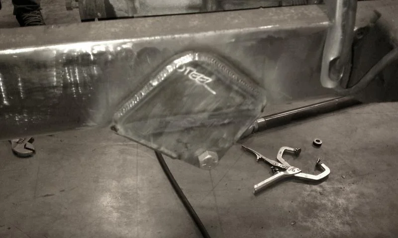

Welding has begun..
We've got some of the front end fully welded now. It'll all be boxed in and strong as ****. Post more as I get em..:wrench:
