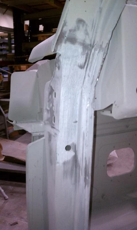

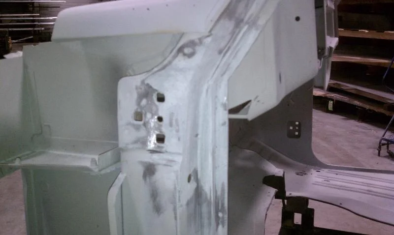

DS front door jamb fixn

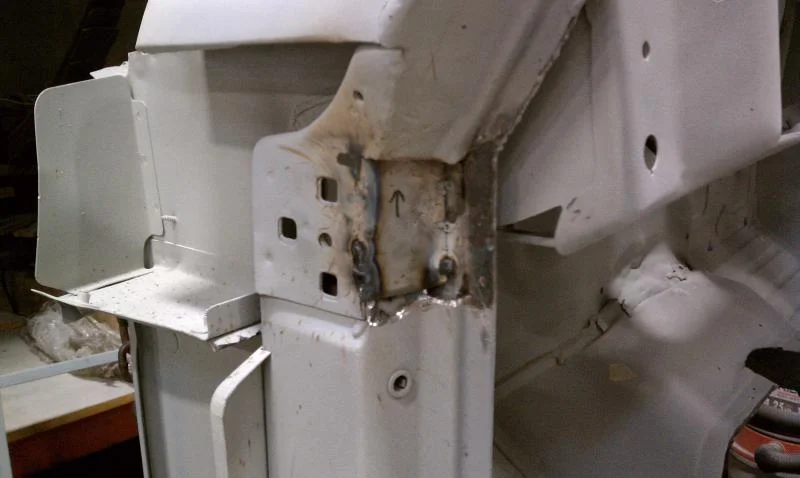

This was a nasty spot. Welded in some sheet metal and now fiberglass. Should be pretty nice when done. Won't even know :o:hhmm:

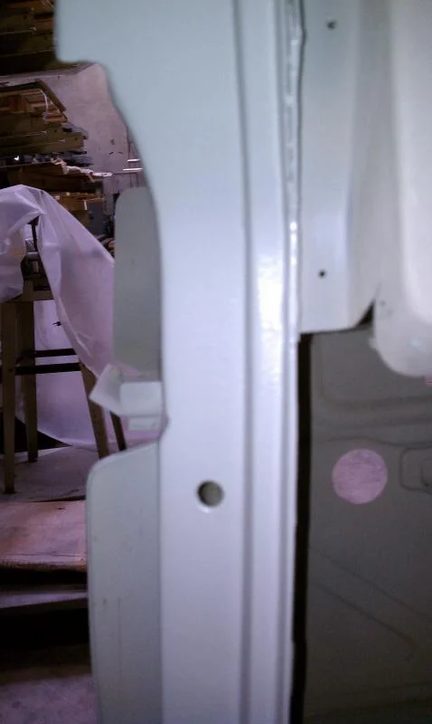

Door Jamb Done

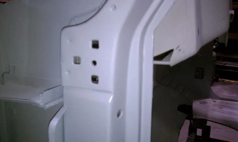

:D:DDoor Jamb is ready now for paint. The guy helping me with the bodywork is going to be gone for 2-3weeks, so I have to focus on the chassis.

Did you do any door fitment prior to painting and finishing? I had to fix my A-pillars as well. I don't think I did a very good job because the bolt heads on the door hinge are taking off my paint in several areas. :frown:
We did do some door fitment.... I'm going to double check now that you mentioned that....before we finalize anything. That would suck if the bolt heads hit:crybaby:

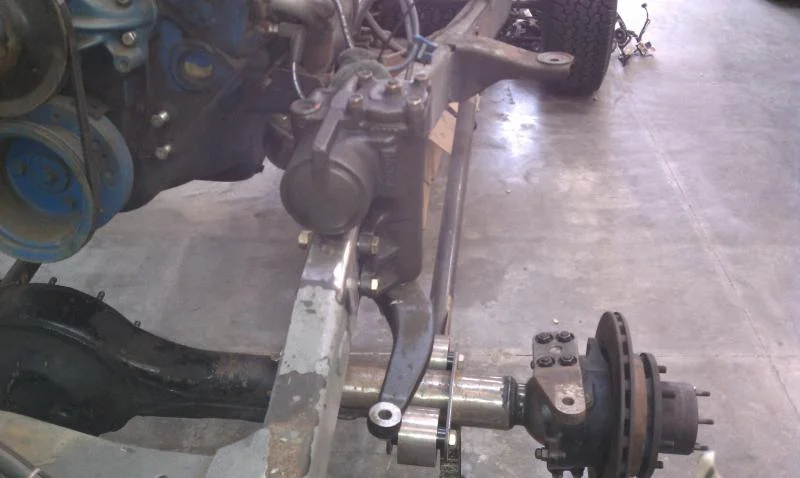

Steering next

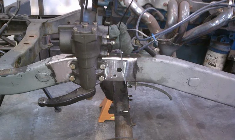

We've got the box mounted. Going to still plate the frame for more support. Steering linkage next. Using Chromoly tube with Heims. Panhard should be fun:crybaby:

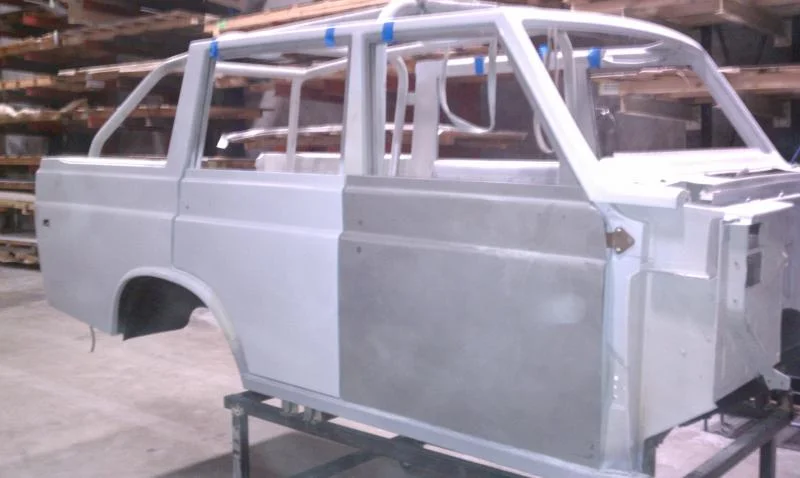

Well done sir. Very impressed with the turn out. Some day I would like make the body on pig that clean. I have been watching this thread for sure. If my rear window fights me more I am very tempted to plug in the sawzall and remove the need for the tailgate window to roll up.

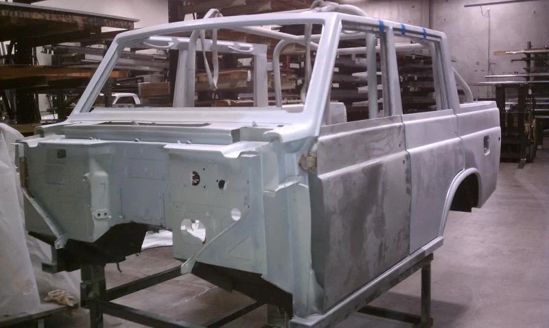

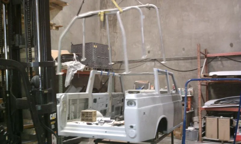

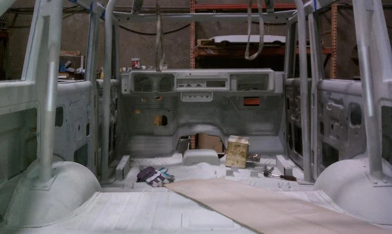

Old Roll Cage is out!!!

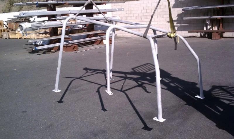

We'll, unbolted the 20yr old roll cage made from 1-7/8"OD x .190"wall 304 stainless pipe........ what?? Going to replace with a 1-3/4"OD x .095"wall 4130 Chromoly Cage. Not going to go overkill, but needs to attach to the frame in a few spots.. It will create the shape of the new soft top I'll have made.. Keeping it kinda fastback looking, but with some room in back.:cool:
