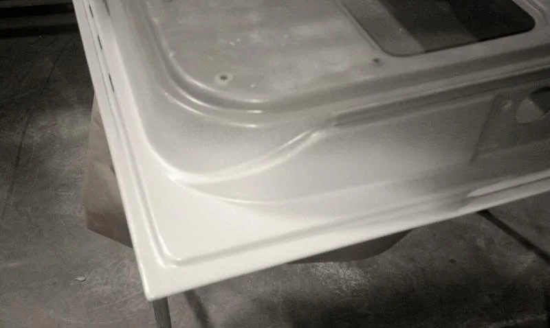

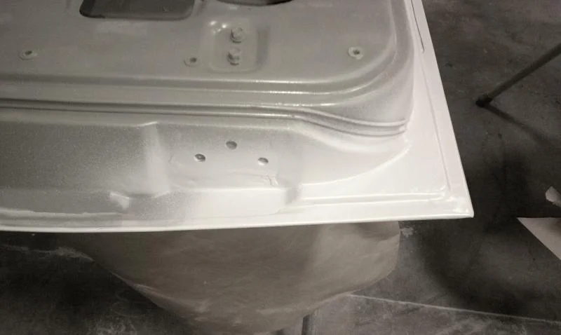

Got the front doors pretty much ready. Small piece below grill in front and grill behind hood in front of windshield and it's time:p

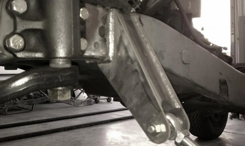

Fab work continues after I make some upper shock mounts to weld to the hoop. Will post pics as I go..:popcorn:

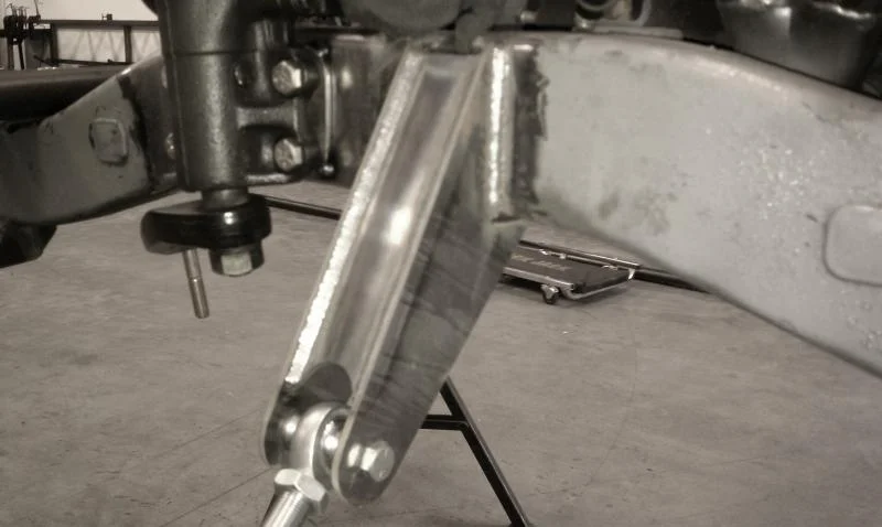

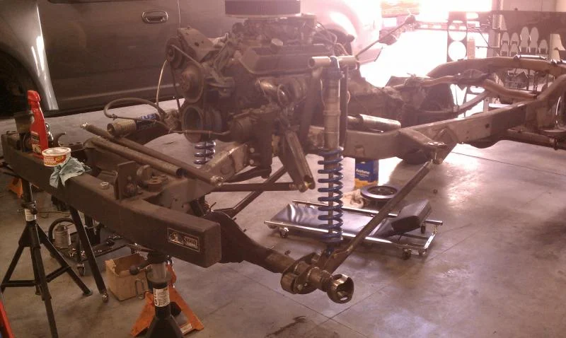

Front Shocks being mounted......

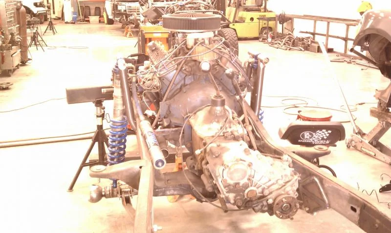

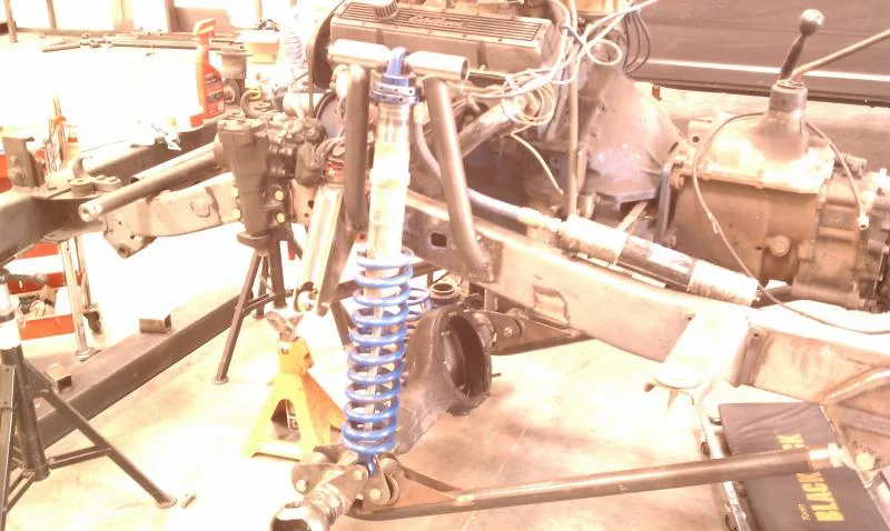

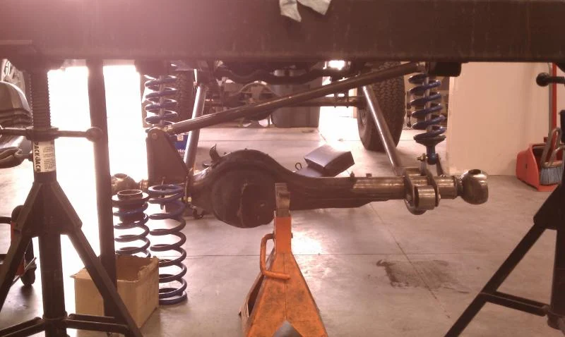

:)Well, we've got the beginnings of the shock hoops tacked up. Had to machine the mounts the tubes weld to. Going to have an engine cage where we connect the tops of the hoops together. Will be very strong. I need to decide if I'm putting in a TPI so I can make the cage clear the top. Would be higher that the carbed motor. TPI:p:p

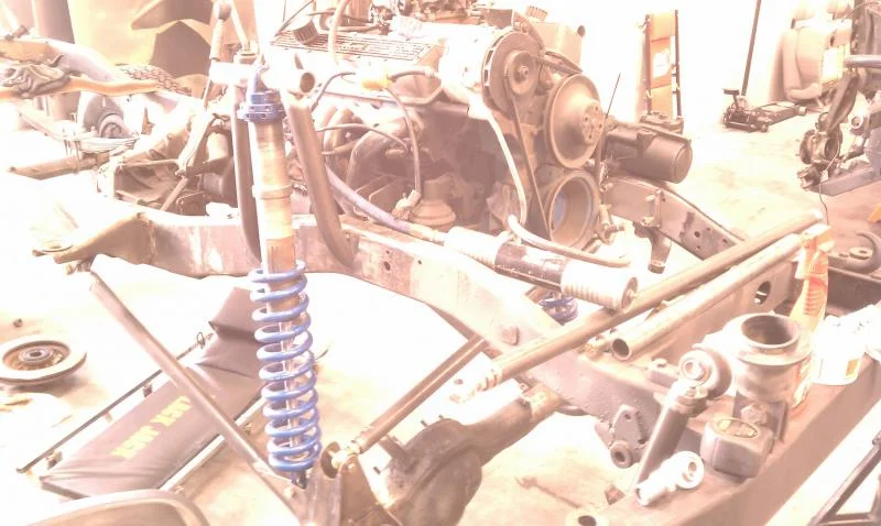

more pics
pictured at full droop. Will put some limiting straps and some bump stop thingies...:D I still need to cut and turn that bad boy.

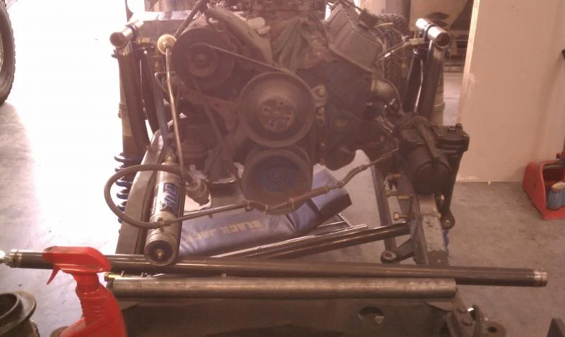

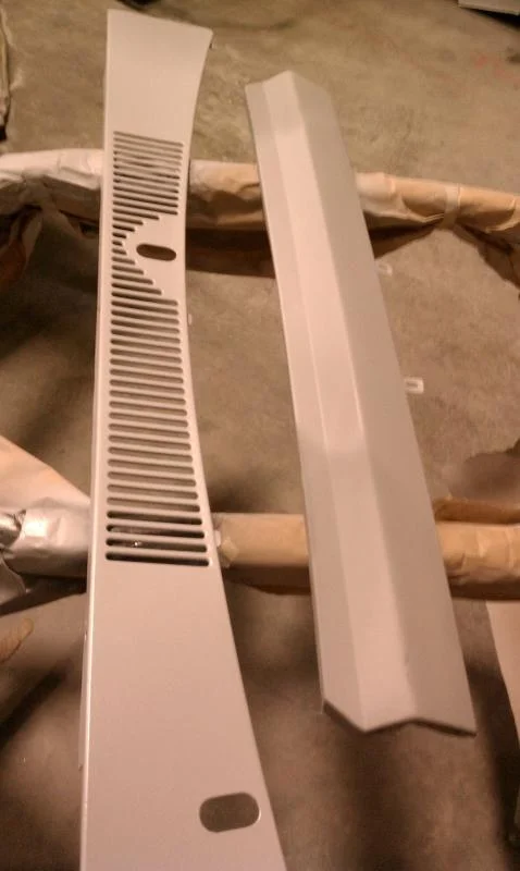

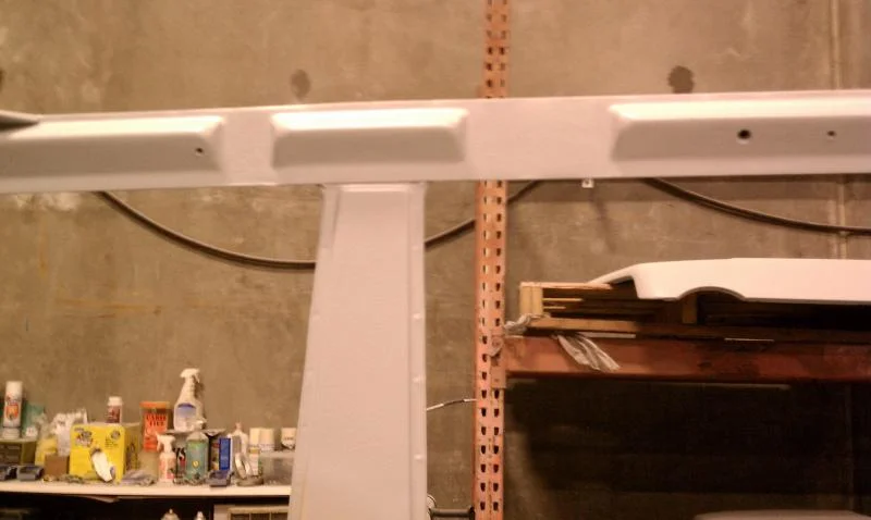

Body work done!!!!
Now all he has to do in longboard block the body and panels to find any low or high spots. Then it's Line-X the interior and paint booth. I'll be putting the body on the frame soon to get the cage made and new body mount fabbed. Will post as I continue........stay tuned.:D
