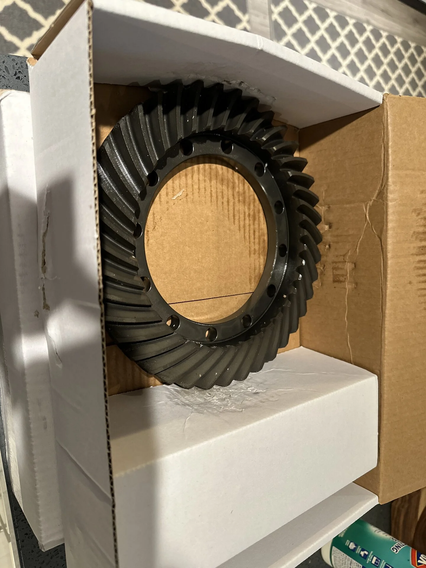

Thanks for posting. Not sure if the inventory is depleted or not but ordered a set. No real intention to regear but why not at that price.
