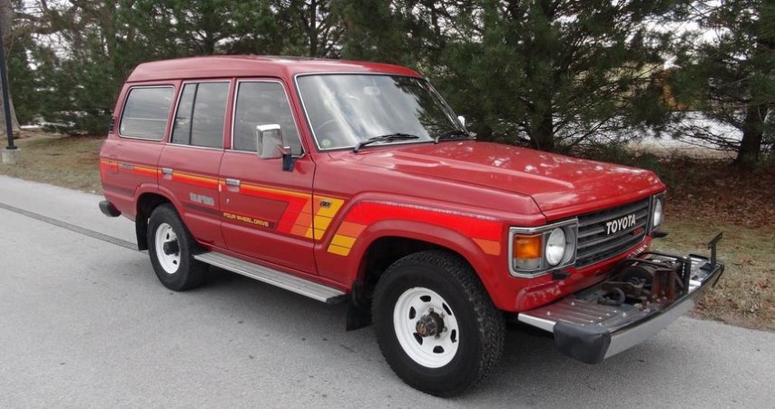

I picked up this 1987 HJ61 last year from our partners at Land Cruisers Direct. In what I consider a moment of weakness, I agreed to sell my favorite BJ74, Righty. It wasn't the most pristine specimen and it certainly wasn't built up or ready for adventure but it was just fun to Cruise around in and always turned heads. Steve and discussed listing it and if found a new home, admittedly one that is taking off-road thus it really is seeing a better life.
So why a 60 Series? Well, I've had a few FJ60's and an FJ62 but none that I've really kept long term yet I really love 60 Series and they are one of my favorite all-time looking Land Cruisers. I'd had my eye on a few diesel imports over the years and none really scratched the itch... until the Red Dragon appeared. Steve sent over a few pics and I said "lets do it", it was on it's way to SLC. If I didn't fall in love, I knew it wouldn't take long to find a new home for it, what is the risk? It's a neat truck, a 1987 HJ61 with factory lockers and a PTO winch. Fairly low miles, the 12HT is strong and the H55F shifts tight and smooth. A perfect platform!

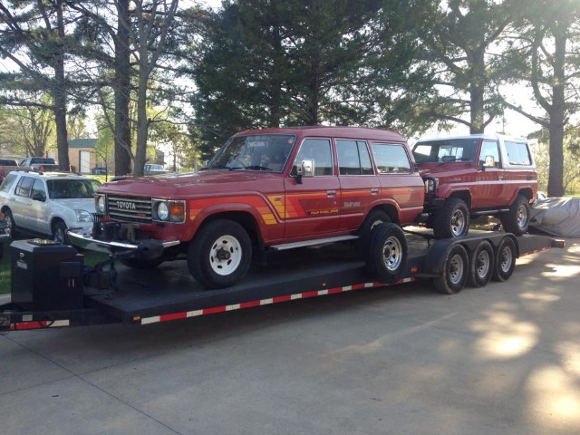

Loaded up for SLC. The BJ74 that would eventually become Woody's is on the load too.

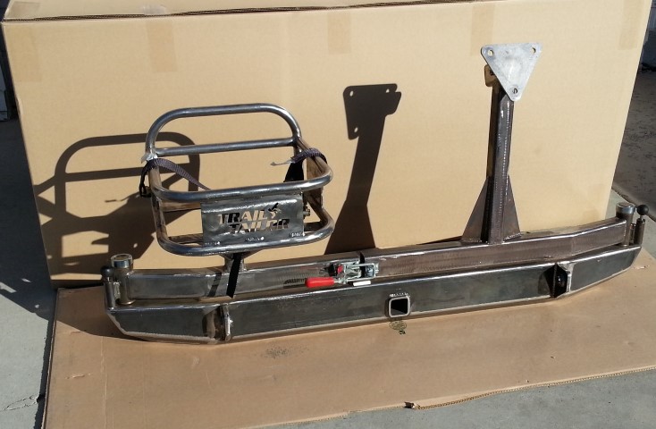

Out back I opted for Trail Tailor Rear Bumper & Sliders. I've worked with Jason at Trail Tailor on a variety of projects and when it came time for a rear bumper option on this project he was my first contact. There are some neat offerings out there on the market but Jason had recently build one for another customer of mine (Casey Smith) and I really liked the way it turned out and the craftsmanship of the assembly. Jason was kind enough to drop them by while in SLC and brought along a pair of his newly finished 6x Series sliders to show-off as well, yup... "I need those too, go ahead and leave them here." That was easy.

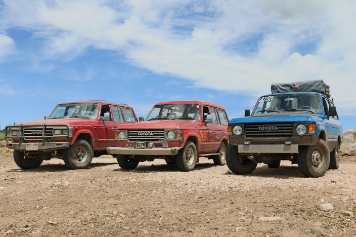

This is the 60 Series section after all, how about some 60's
:popcorn:
Awesome Kurt! Bring it on the Outlaws Run this year so I can check it out! :)
I very well may. I took it on the Relic Run/Retro Ramble event last year and had a blast driving it around in the mountains. The suspension needs some MAJOR love and the accelerator is super touchy, combine the two and it could get pretty bounce-lurchy. I have a new Denso accelerator spring from @Mr Tibbs that I need to install, that should settle the bounce down.

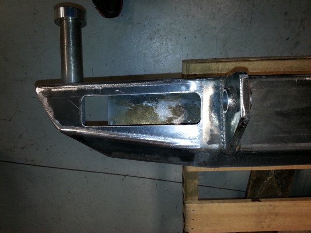

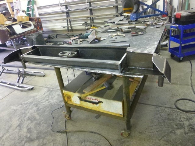

Before the bumpers and sliders go to powder-coat, I wanted to take advantage of the bare steel to make some minor tweaks. My goal was to use the same Aussie standard LED combination rear light found in Kaymar and others down under and also used in our 7x rear bumpers here in the US.

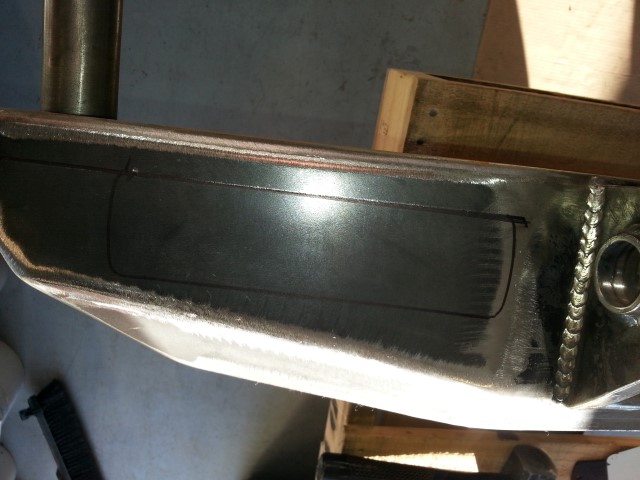

I started by laying out the lights on the bumper for a good aesthetic look:

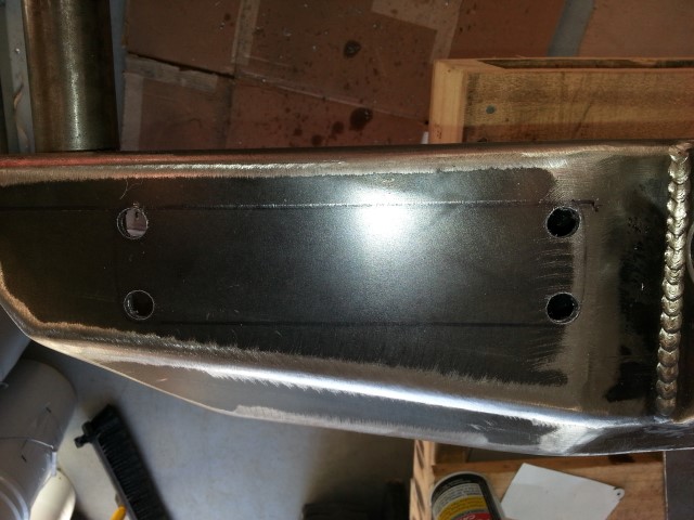

I then drilled the corners:
Next up was to plasma from corner to corner and clean up:

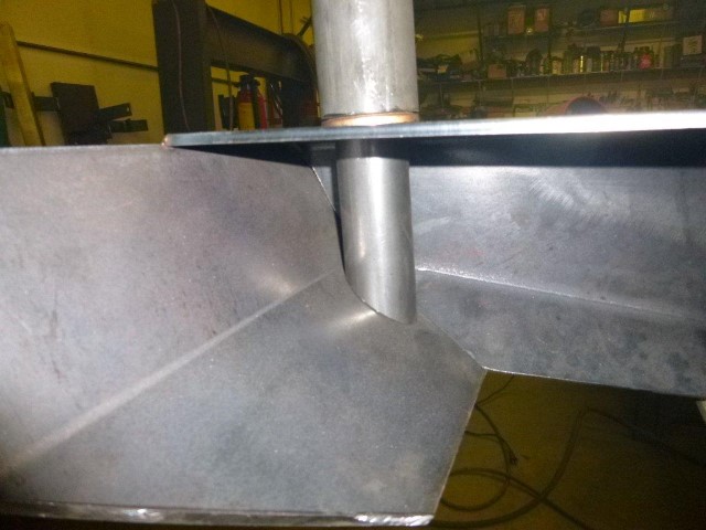

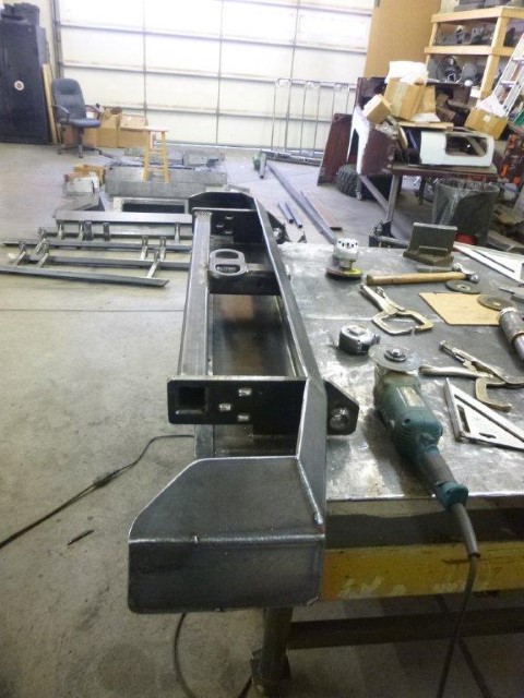

I added a flat strap inside of the bumper to provide the backer for the LED light assembly, I'll get some pictures of that added down the road. In the meantime, how about some build pics of the rear bumper from Jason
