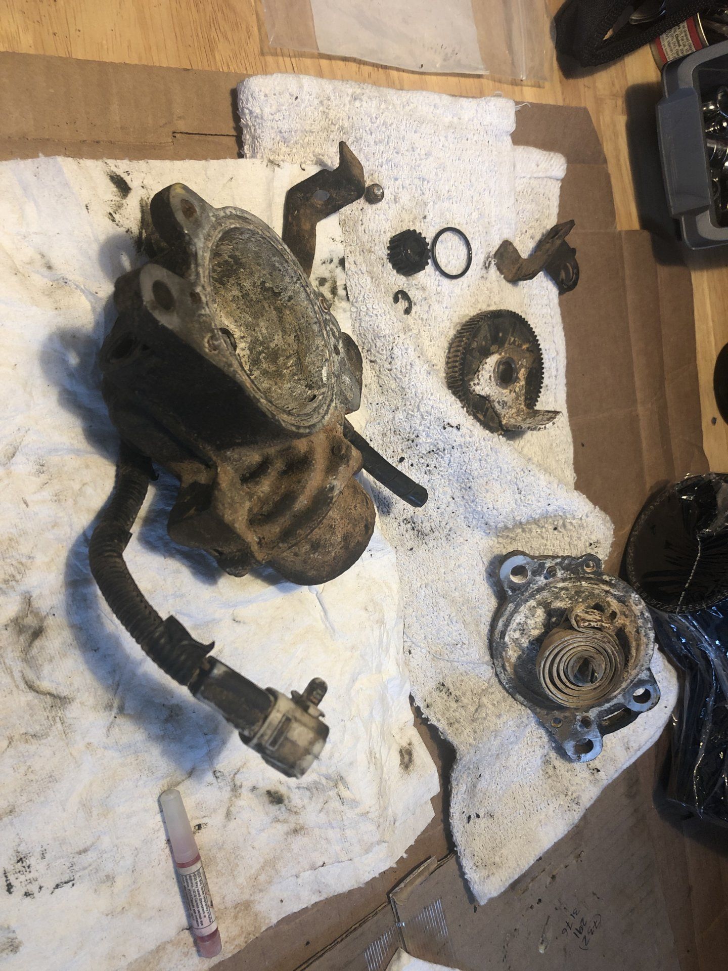

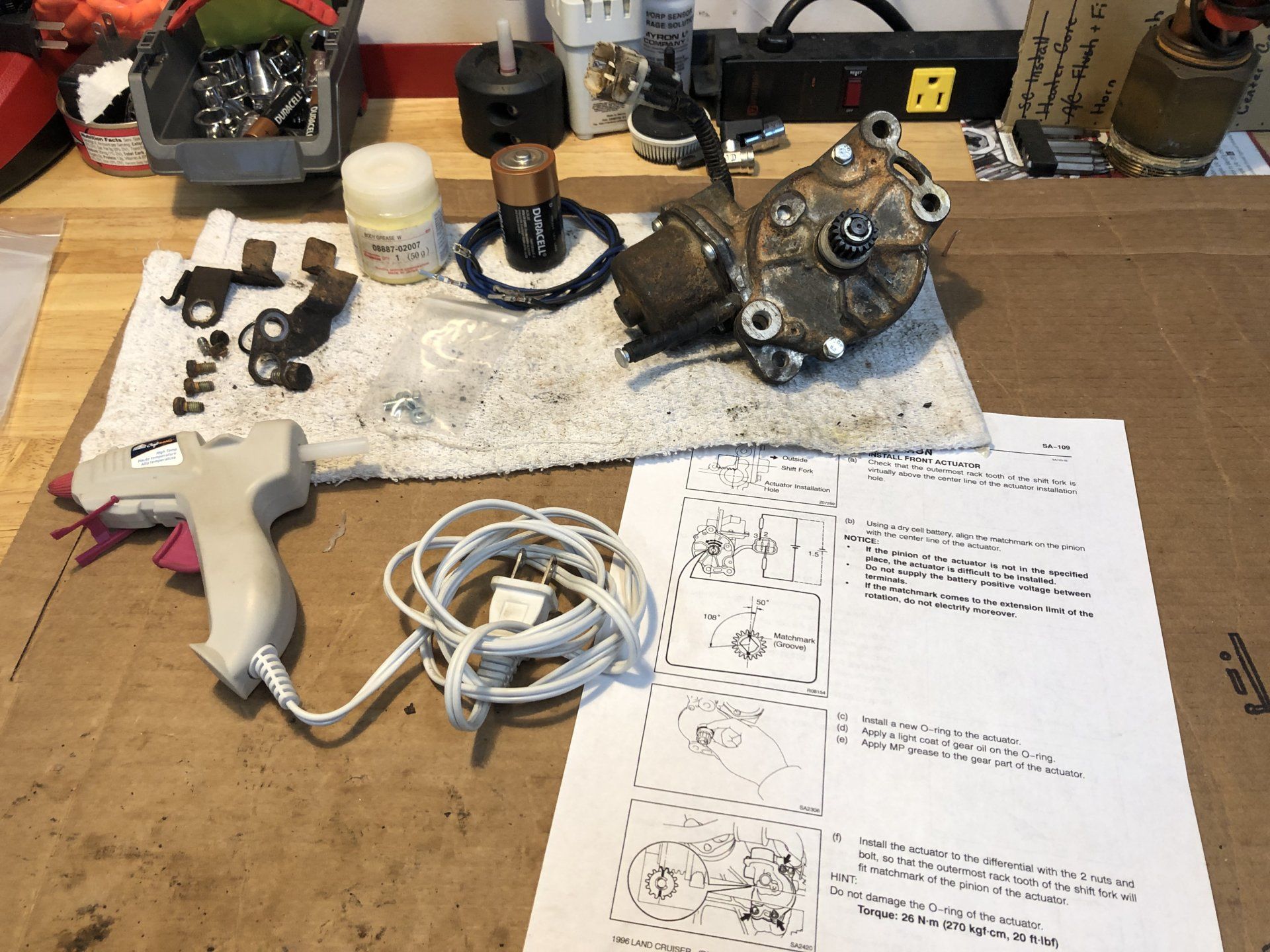

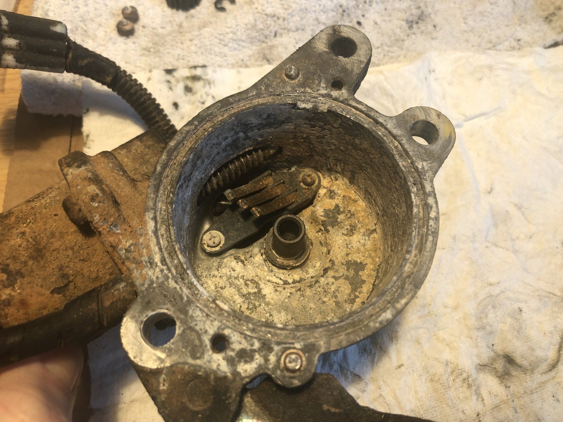

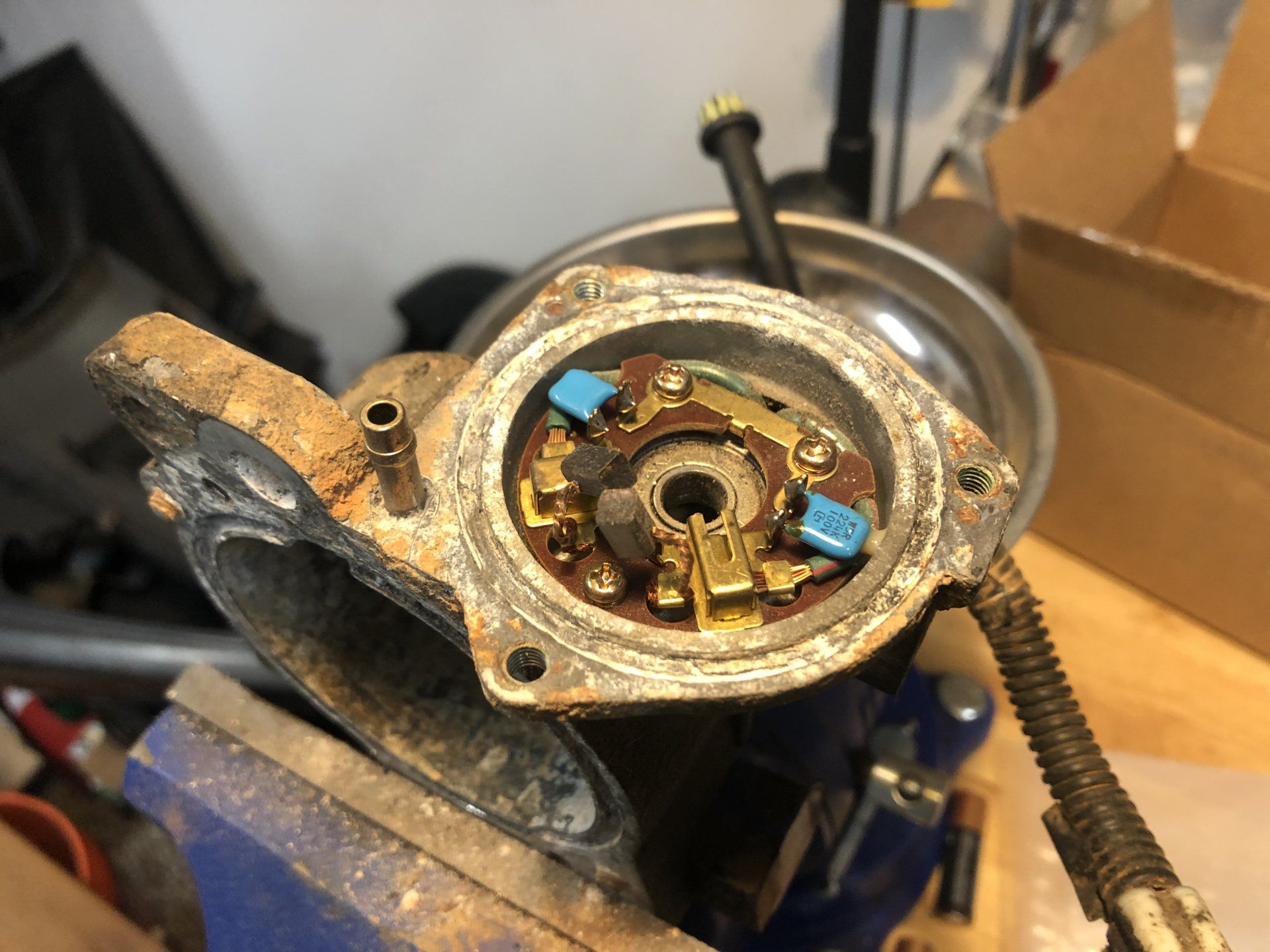

Currently rebuilding my front:
Yeah he did but he said he doesn't do it anymore hopefully I can find somebody who will do it I think I can do it it's just having the time to do it would be my biggest issue
not promissing anything, but I retire in 3 years and my wife might inspire me to start it again.
