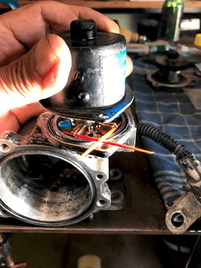

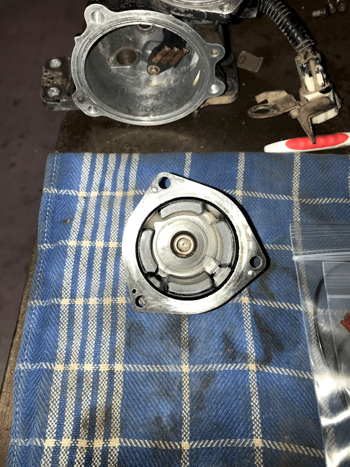

Thanks Joey they are workign and were not rusty i did put Corroseal to treat themin the surface areas an painted the housing with POR-15.If you do decide to repair yourself:

Biggest issue by far is rust. If it’s not rusty or broken it’s not that bad.

mechanic and got mine working with a kit form NlxtacyI like the use of the toothpicks.
