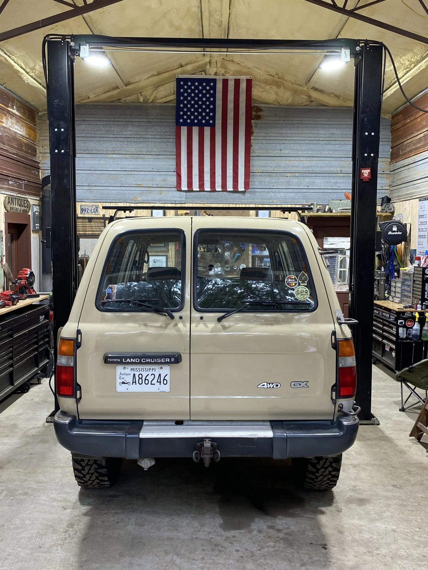

Rear Window Tight Fit?

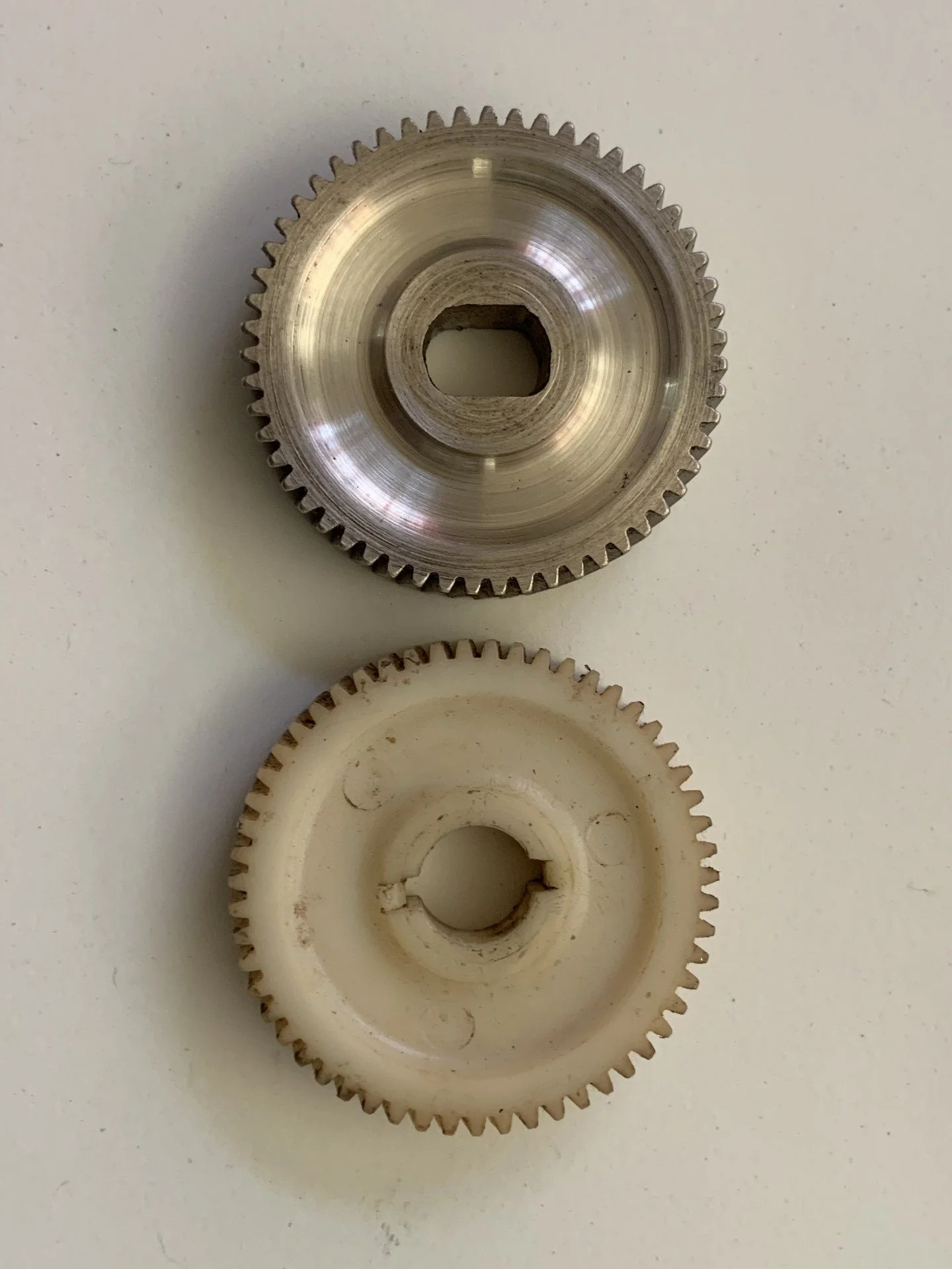

Just what I was typing. I wouldn't ruin your cover. That gear was one from MId Organic or something, he didn't have the groove put in. Maybe use a dremel and groove out the brass.
As Bob would say "There's a reason" that groove is in there and Toyota went through the hassle of making the cover to fit, but I don't know it.

Probably not the best solution, might want to take a second look at that if you haven't already started grinding.
Something has to give. I have not done it but I’m not sure what else to do besides pull this gear (for the 3rd time) and have it machined with a ridge.
I have read posts somewhere in MUD where they had the same gear and did machine the groove in as in the factory plastic gear. A pain but probably the right way to do it.
Option (A) send me the gear and I’ll machine it for you.
Option (B) find a local machine shop and have them machine it for you.
Option (C) get a die grinder or Dremel tool and whittle a grove in the gear yourself.

Ive got it in my mind I’ll go through all this and it will still be jacked up.
I did not mention the fact that I had to go get another mechanism from a parts truck because I broke the one frim my truck digging out the brass gear the second time.
