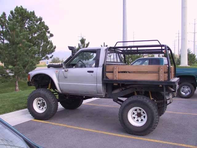

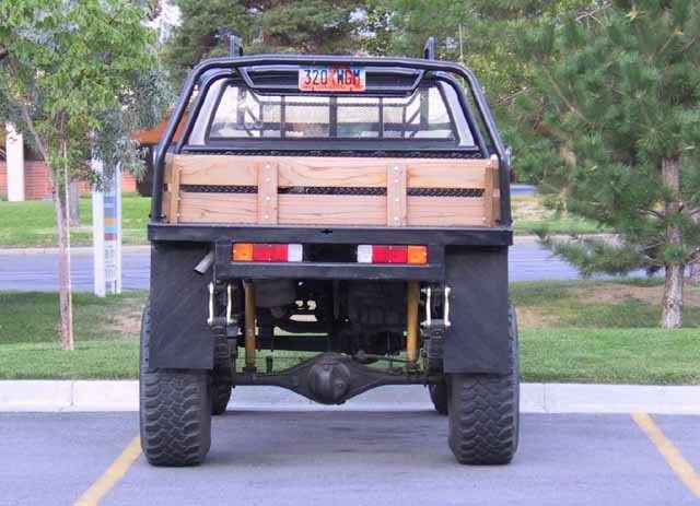

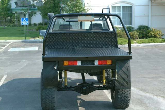

Rear tray for my rusty '86 pickup
That makes me really tempted to hit my chassis with that stuff. That truck looks beautiful!
Thanks, it's really a rattle can job. I just wanted to put some life back into it. The chassis is solid, so I decided to make good by coating it. It's now good for life.
Fuel tank and skid are in. So are the emergency brake and electrical for the rear.
I also will remove the front wheels to be able to properly coat everything with chassis saver. And I have to do some touch ups on the bolt heads that I just installed. Other than that, I think it's all good to go.
And here it is out of the garage, finally...drives wonderful. Can't wait to get the darn tray on.

Hey, that's a great looking rig. That's one of the pics where I got inspiration from! Google Toyota pickup tray and it shows in Google images.. That's a great looking rig!! I dig the snorkel. Have u a build thread?
Sorry no build thread. Built this truck before build threads were a thing.
