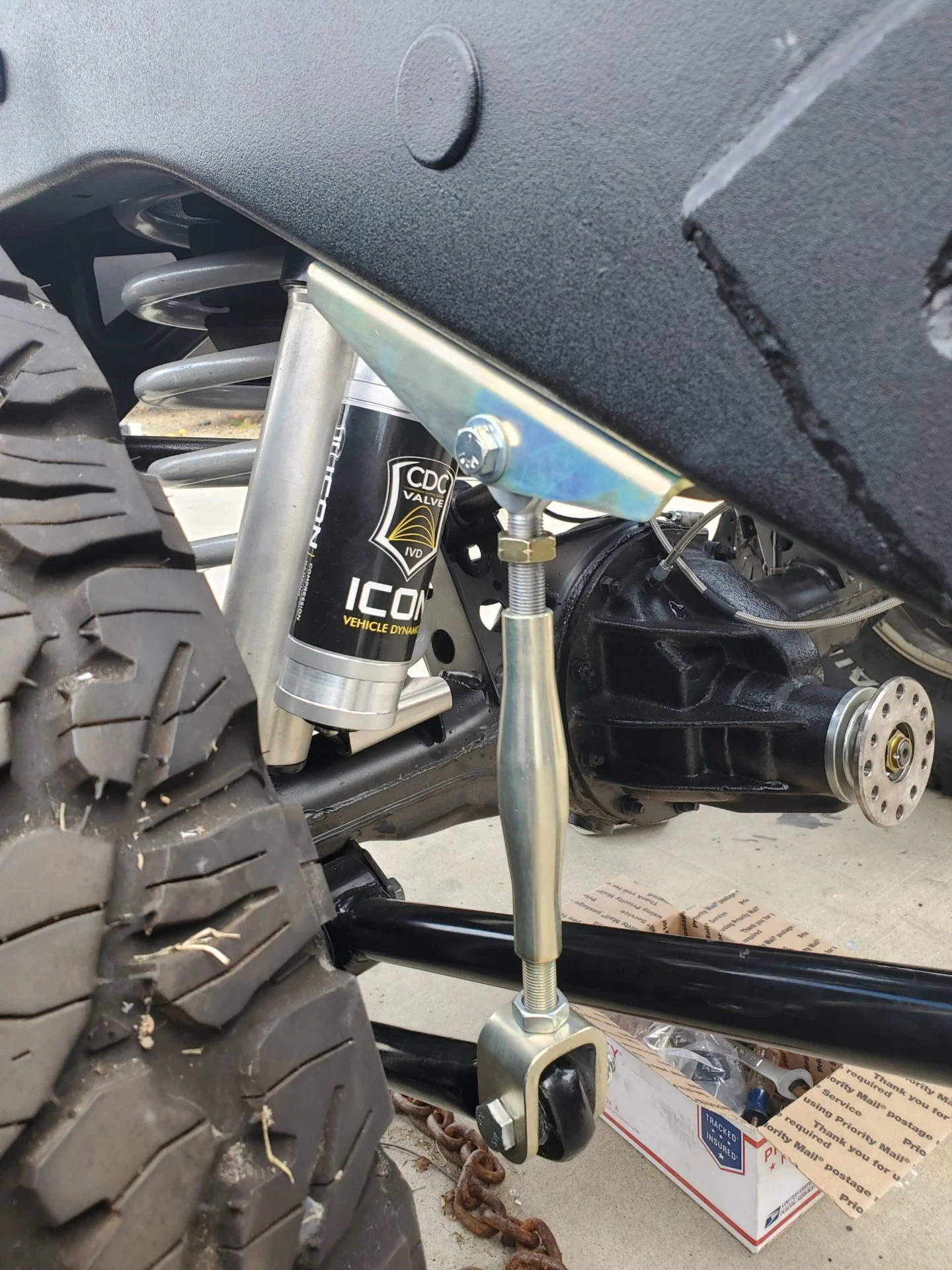

That's an awful lot of thread showing on those ends... Enough that I'd maybe be concerned about too little thread engagement. I'm assuming this shot was taken before you had a chance to tighten the jam nuts, and that they are tight now? How much lift do you have? Does @LandCruiserPhil have options for longer center links?
There are different length options.
Yes

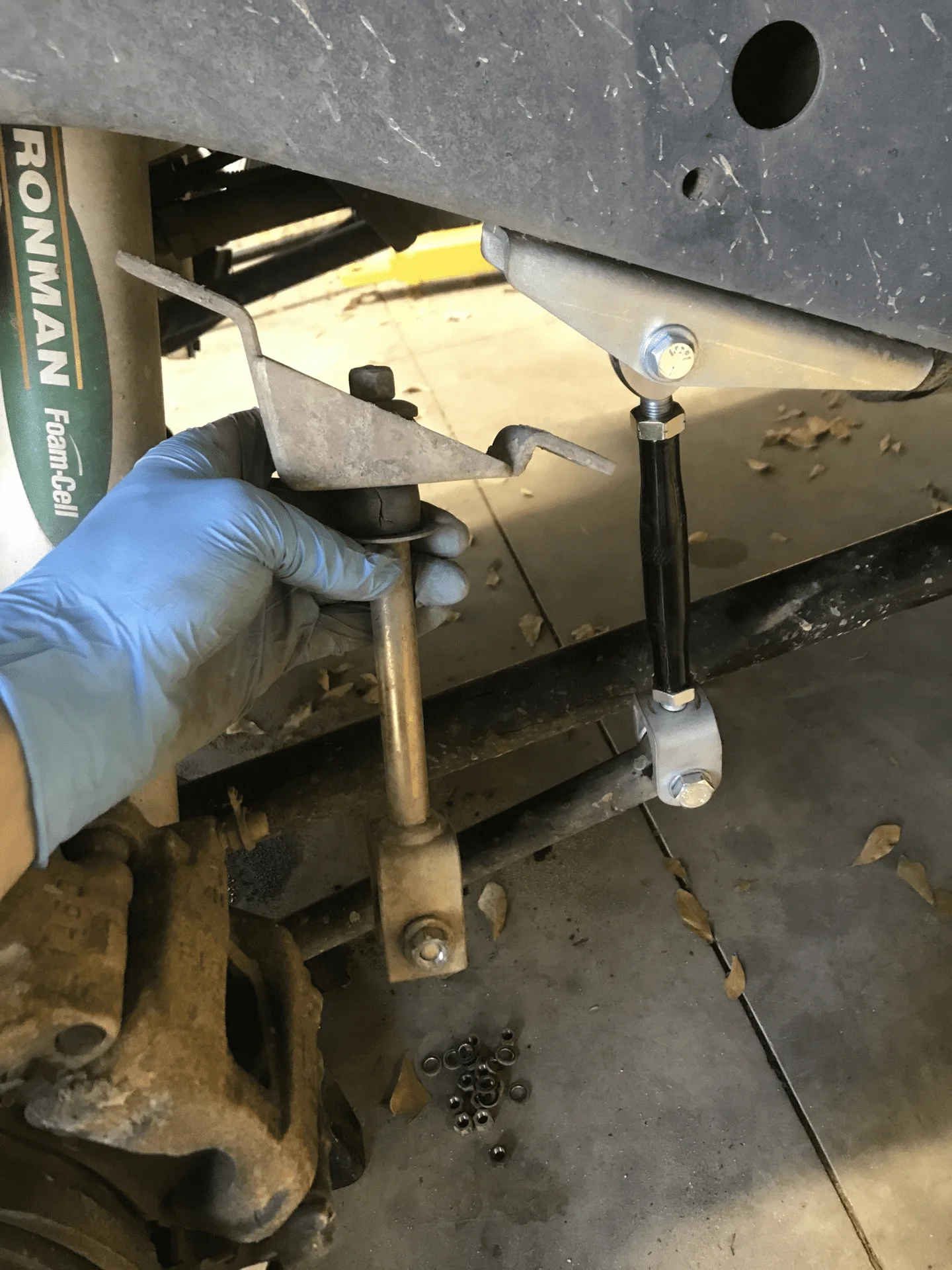

Some install question answered -
Text book install below
Ideally you want the sway bar parrella to the lower control arm to avoid rock contact.
I find using a 3/4 wrench along the side of the heim will keep it centered when tightening.
You can remove the lower jam nut if needed to make the link shorter

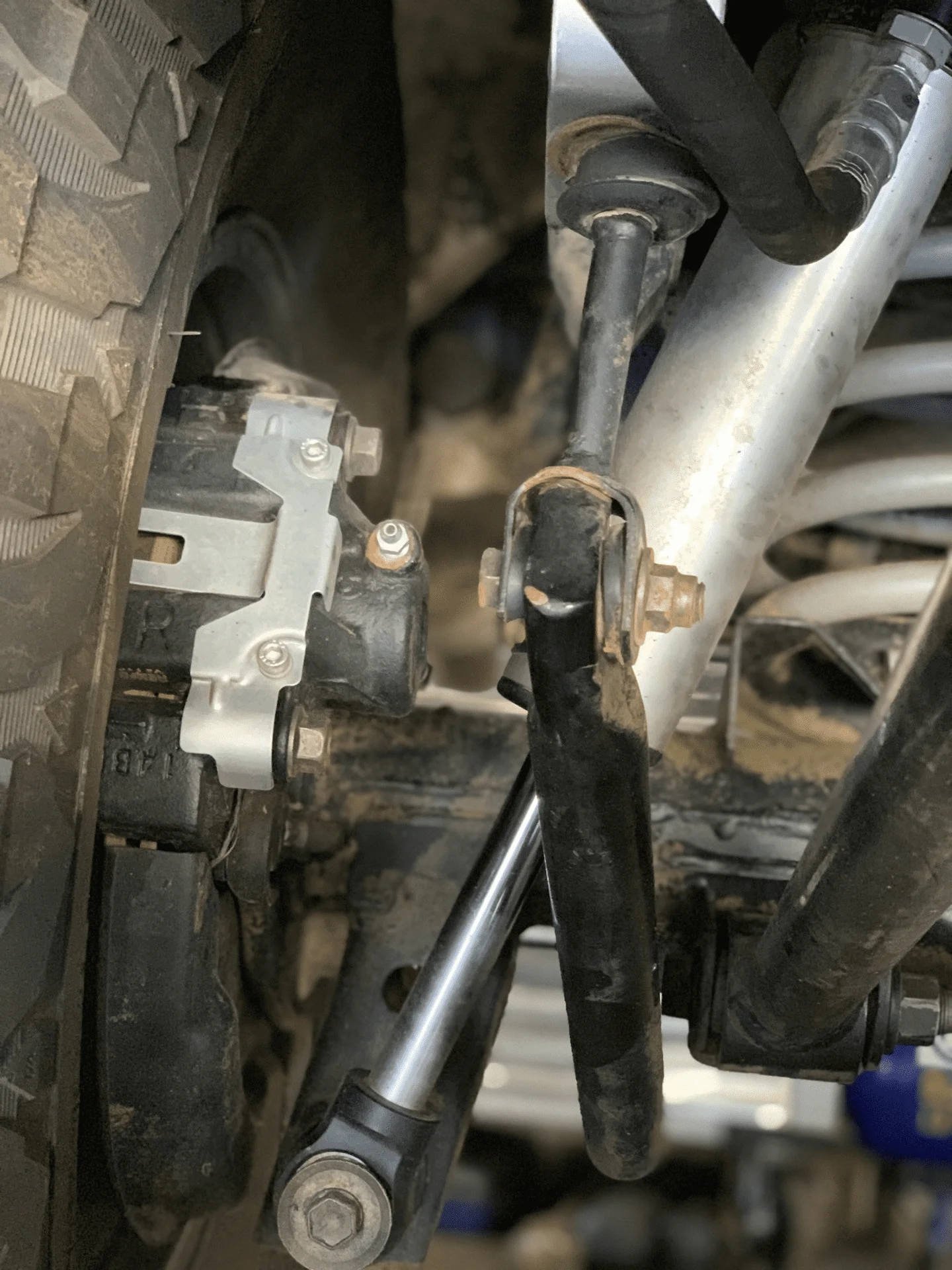

Grinding the sway bar is not needed for clearance with our links

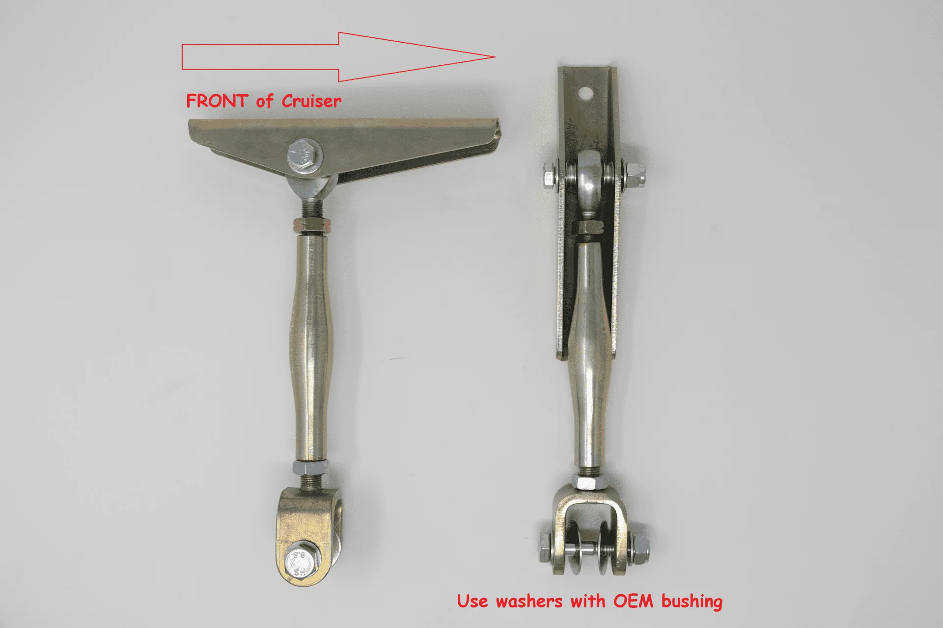

Below is the finished product going forward all parts get a 5 tank zinc coating.
Our links will never look like this no matter how hard you wheel if they do contact for replacement
