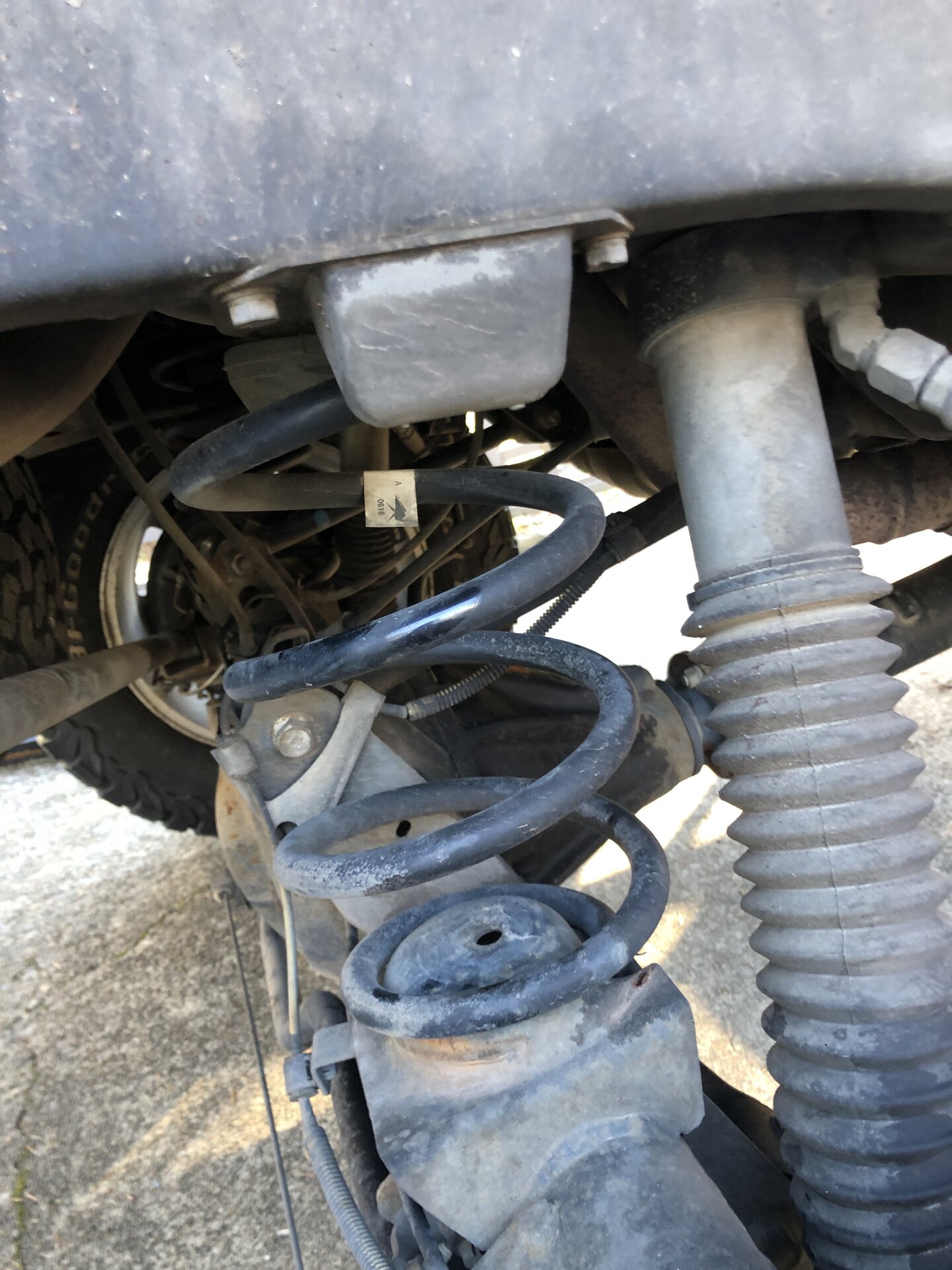

Also...would anyone be able to tell what kind of springs these are from this "A 0616" sticker? Or how much height they're giving me over stock?

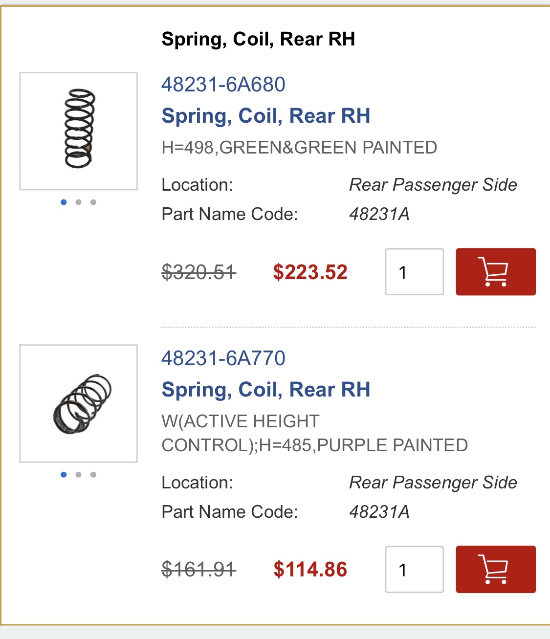

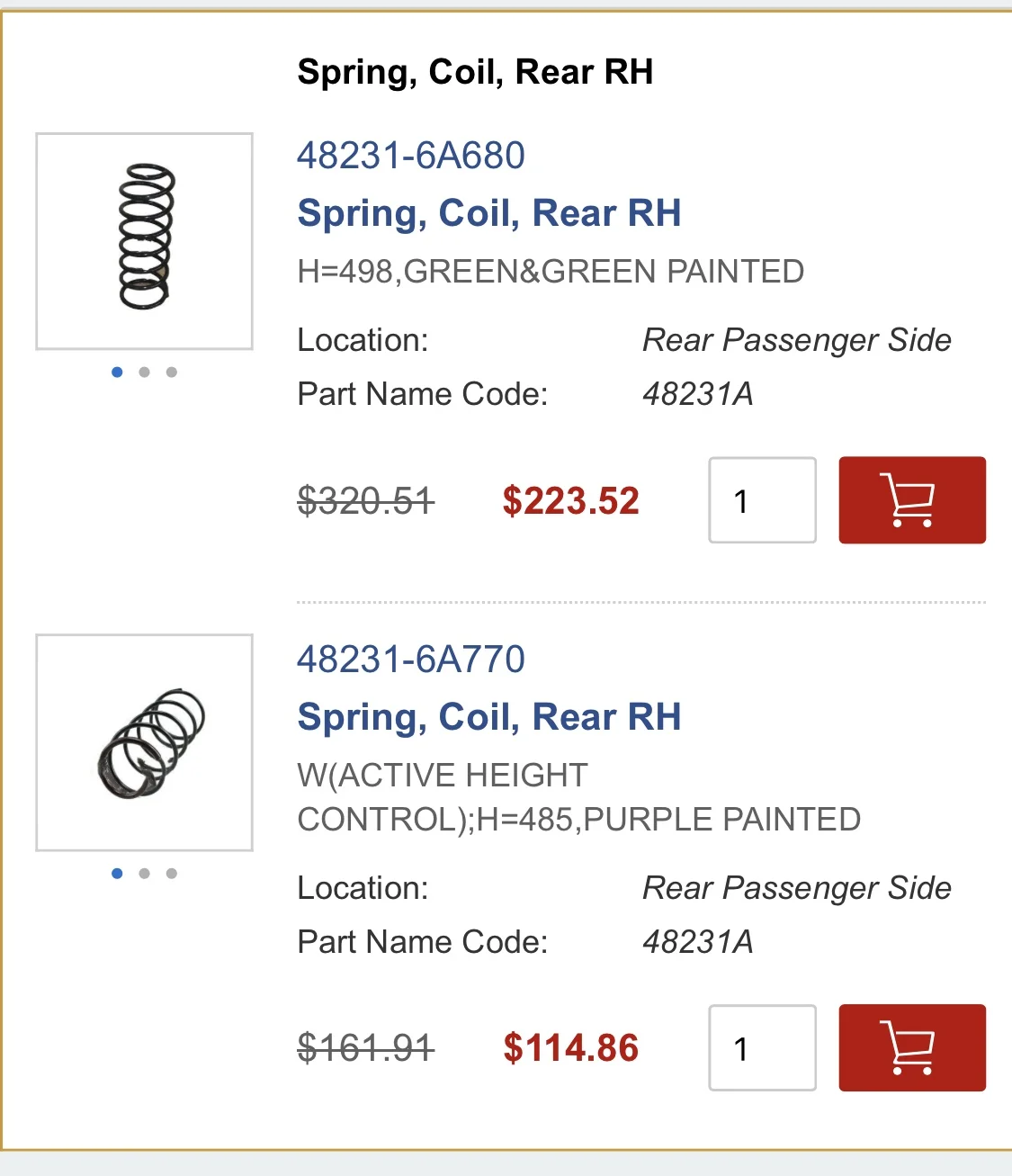

Might it also be a difference of AHC vs non?
Regardless, it seems like a fair question since parts.toyota.com says all of the following are a fit for the right rear of an 06. Entering those back into toyota partsdeal shows it's probably safe to assume they're returning results for an RHD even though I enter my LHD vin.
48231-6A780
48231-6A680
48231-6A690
48231-6A770
(More informative) image here from toyotapartsdeal.com
