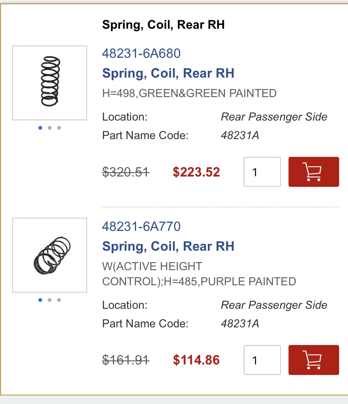

Regardless, it seems like a fair questions since parts.toyota.com says all of the following are a fit for the right rear of an 06:
48231-6A780
48231-6A680
48231-6A690
48231-6A770
(More informative) image here from toyotapartsdeal.com
I’m pretty sure 99 is pre AHC. Mine is conventional.

I’ve heard this from one other source. Is this it!?
Yep, that's it. You can also check out a few videos on youtube that all state it this way. Also install instructions show it.
