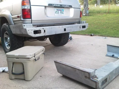

I'll get some departure pics with it all mounted up. This bumper protrudes out about 1/2" past the rear crossmember. Allows for more swing-arm clearance, and doesn't require removing your rear crossmember.
As for the rear skid, that may be an option. The version of this bumper that I am building for my personal rig will incorporate a rear winch.

Too bad you didn't do this a year earlier :(

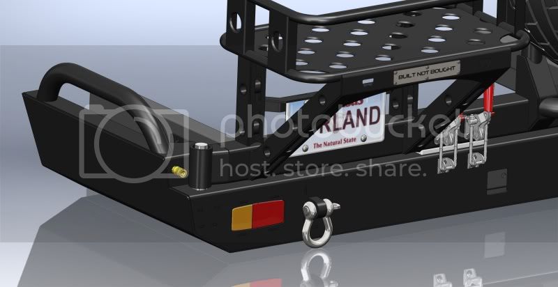

Forgot to add that all designs going forward will incorporate air quick-couplers to tie into the vehicle's onboard air system.

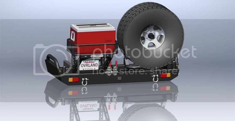

Here is the bumper that's being cut/formed tomorrow:
Changed spindle location slightly to give more room around the air coupler, and changed the overall width a bit.
I'll update again tomorrow.

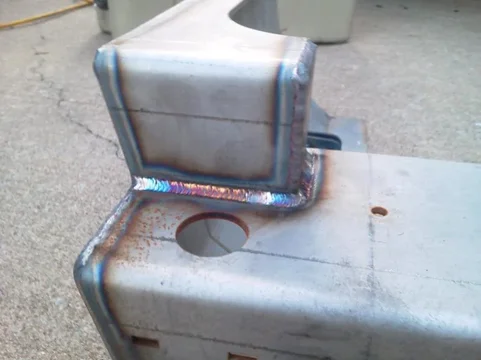

:cheers:Great looking bumper Beautiful welds also. I like the extra lights - will those replace or work with lights on the truck ? Personally I enjoy having the lit up at night - easy to see me. Do keep the pics coming & the hardwork looks like it has payed off already.
Looks great!
For the flareless, do the sides go all the way forward to the wheel well or stop short where the flare should be?
What are the little rectangular holes around the lights and near the corners for?
If you start prices, I'd be interested in a bare shell with no spindles/arms and the little hoops tipped out a few degrees.
